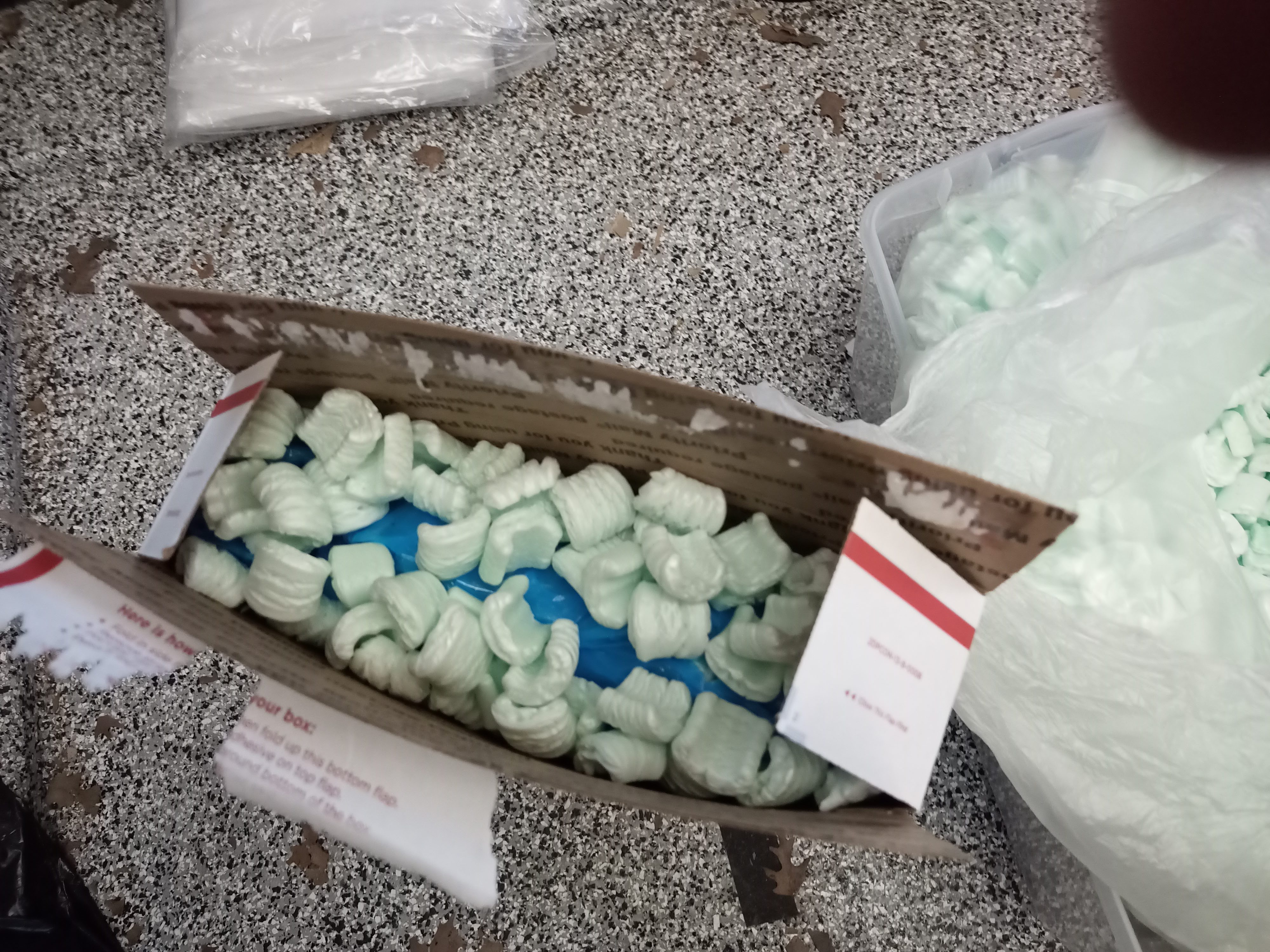

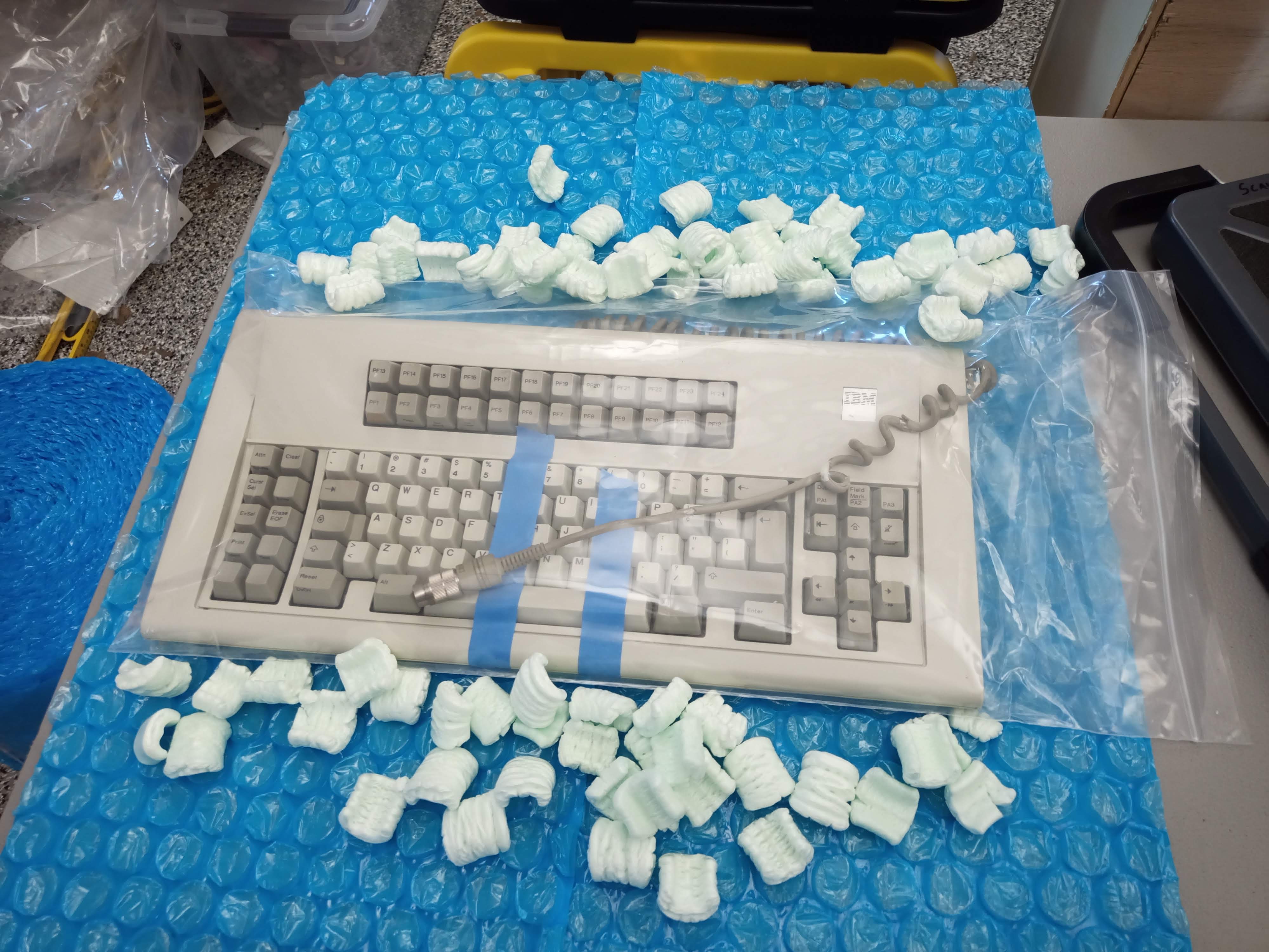

Packing these keyboards is really hard. I wanted to share my current standard for packing, using an Unsaver as a model.

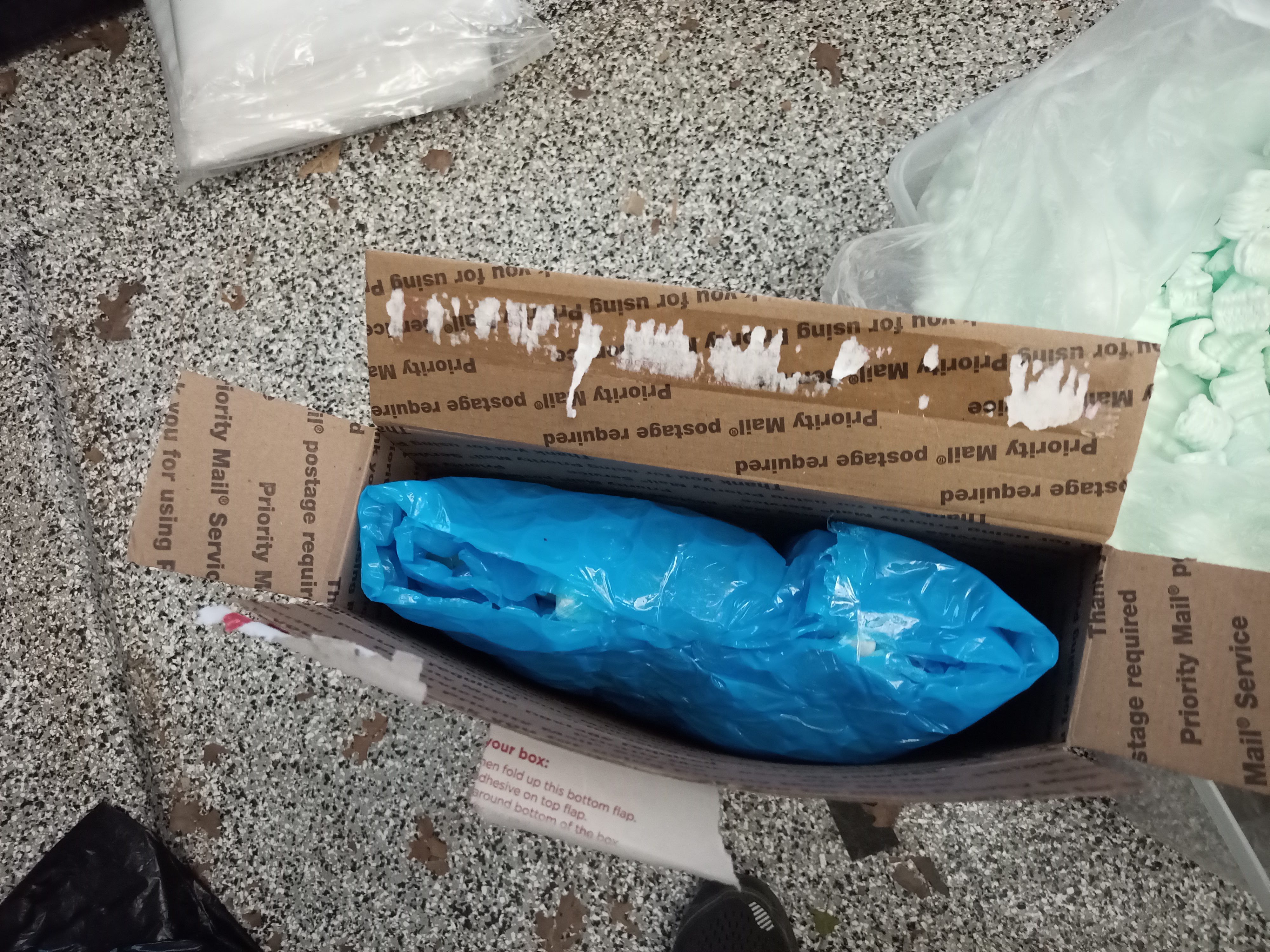

Tape down the Space bar with mailing tape. Wrap the cable connector with packing paper or small bubble wrap (not shown). Place the keyboard in a large zipper bag to prevent water damage en route. Wrap with about 10 square feet of large bubble wrap. Wrap large packing peanuts in with the board to protect the top and bottom edges.
Wrap the bubble wrap around the board. Tape the ends of the bubble wrap so the board doesn't slide out.

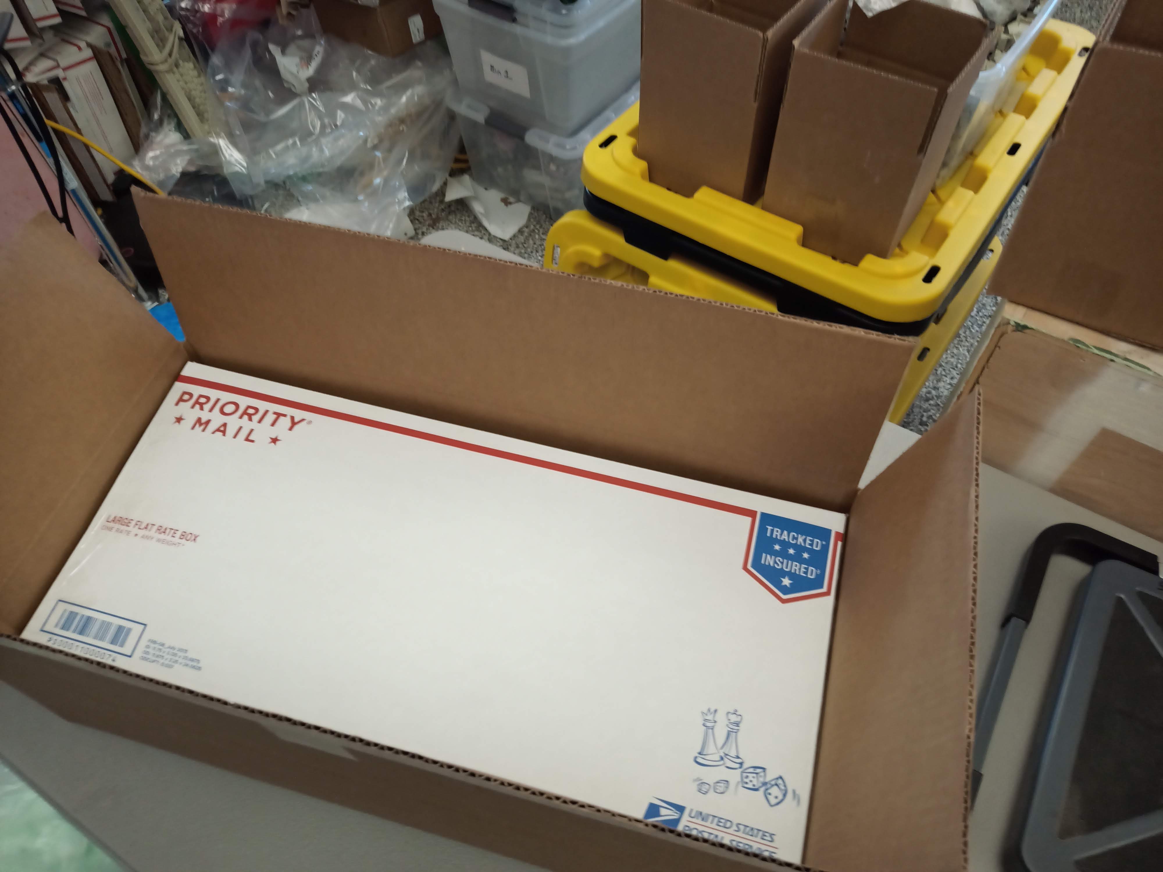

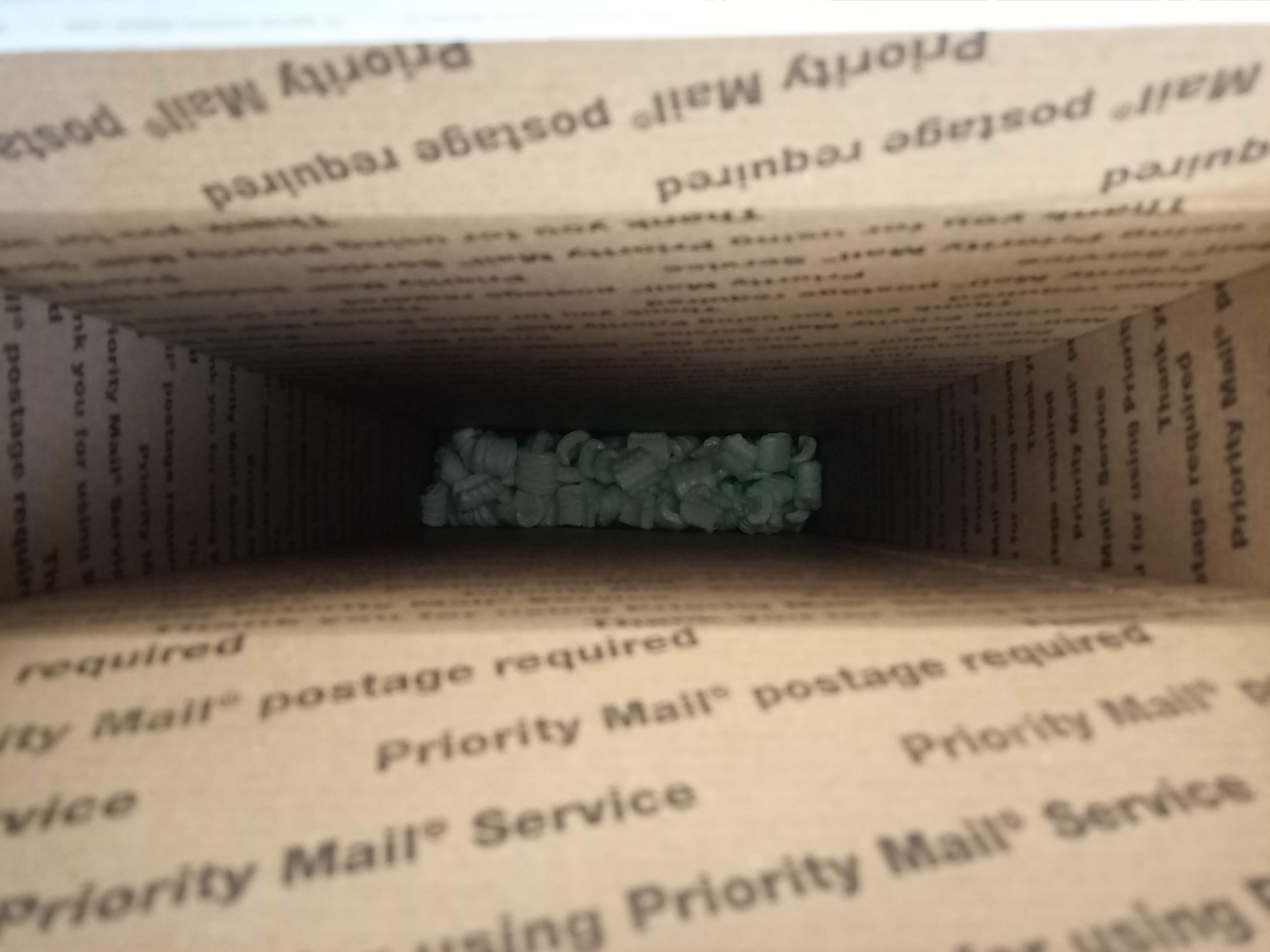

I double box the board. The inner box is a USPS Priority Mail Board Game Box for larger boards, and a ULine or similar keyboard box for smaller boards. For the board game boxes, assemble them, and put packing peanuts in one end. This protects the ends of the boards.
Insert the board...
...and then put packing peanuts in the top end before closing the box.

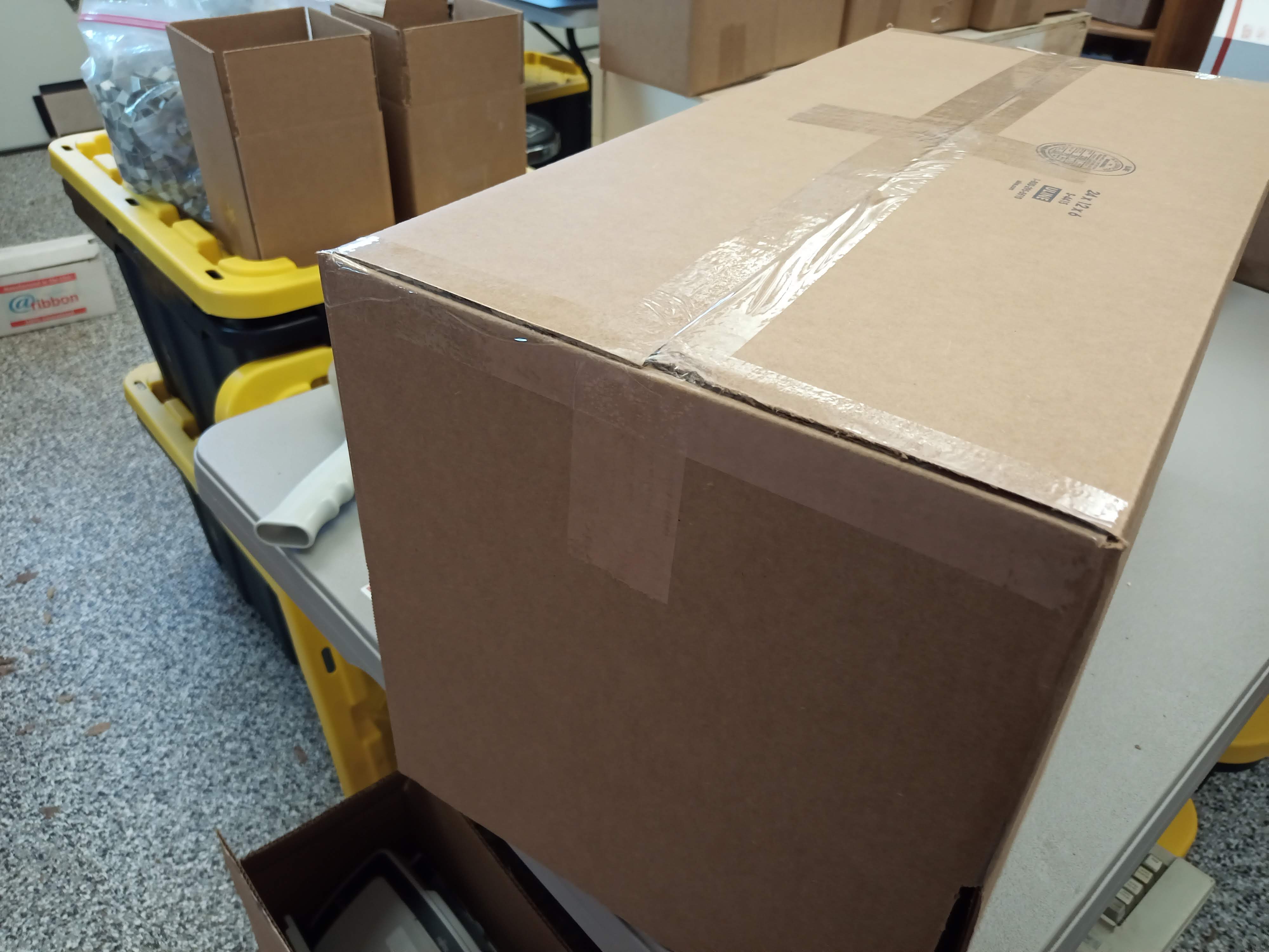

Assemble the outer box. I will use a ULine 24 x 12 x 6 inch box. I will seam seal the bottom of the box...
...as well as do an inner seal on just the bottom of the box.
Then I make a sandwich: packing peanuts, inner box, and more packing peanuts all go into the outer box.
Finally, I seam-seal the top of the box same as the bottom and give it a few good shakes.
