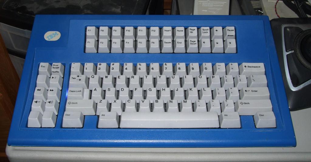

I made this in 2011 and has been my daily driver since. Typing on it right now.
It doesn't show well in the picture, but the Caps Lock key has blue LED indicator under it.

wcass wrote: 17 Apr 2021, 05:14 I made this in 2011 and has been my daily driver since. Typing on it right now.
Beautiful!

This is lovely. I think one of the things I'll be doing with my F77 is sticking some indicator LEDs under various keys for lock lights etc. Only thing being I'm not really sure where to light for Scroll Lock on an F77. I'd probably go for upper nav cluster on a bigger layout, but I intend to flip back and forth between num lock and nav functions on the RHS grid. Perhaps I could just put both Num Lock and Scroll Lock LEDs under that grid, but use different coloured LEDs for each.
I wonder how easy it would be to figure out how to get a functional Compose key LED going on it... I would assume that they only exist in Set 3 boards but apparently there is a setting to light the Compose LED on WinCompose, which I have to assume means that it's doable!
wcass
05 May 2021, 01:43
i posted how i did the lighting for this back in 2011 on GeekHack. For anyone interested, ... https://geekhack.org/index.php?topic=21436.msg406236
