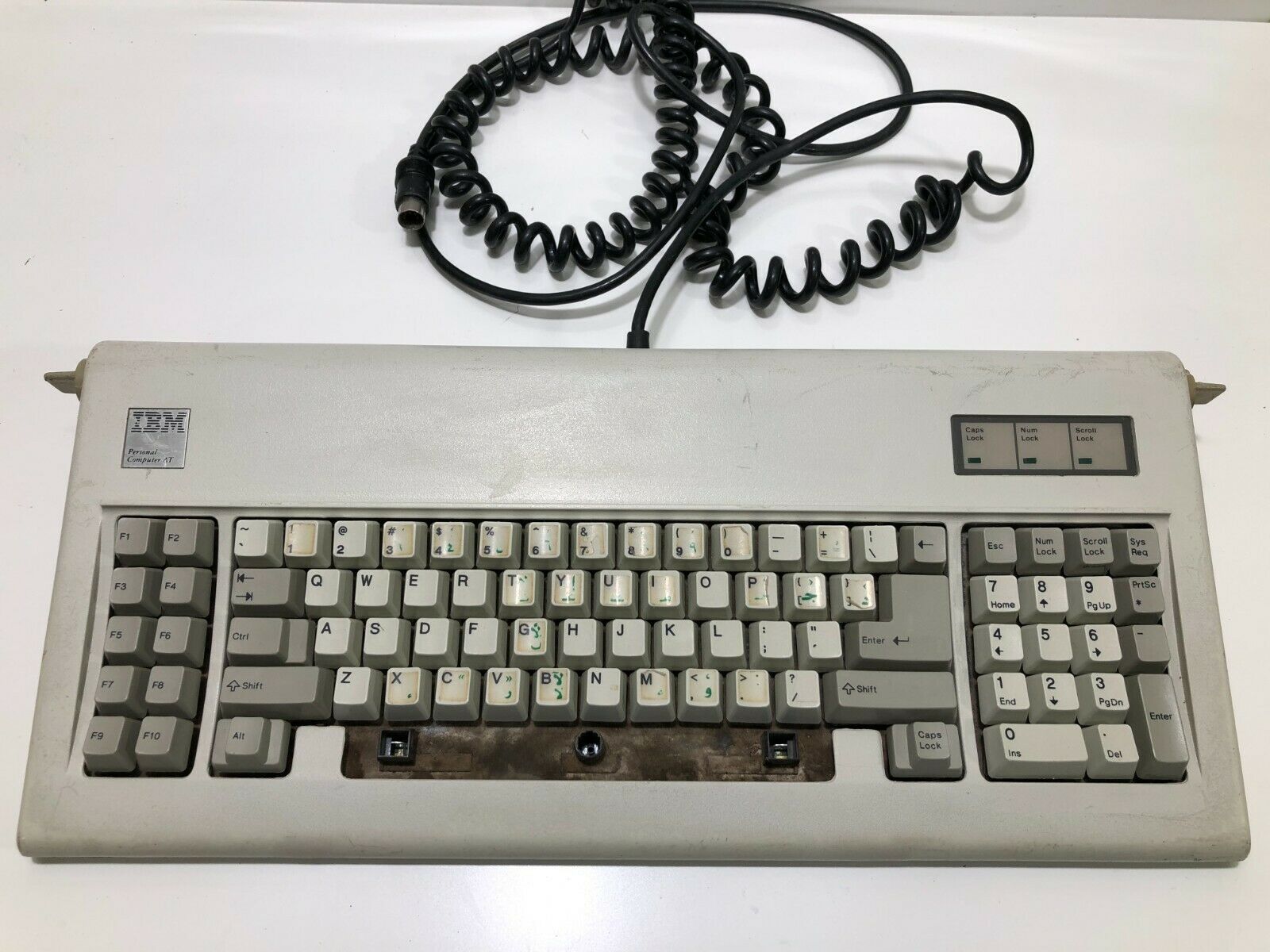

I've been meaning to pickup an F AT and I finally found one I could afford. $240 shipped and missing the spacebar. Because of that I think it's an excellent candidate for an ANSI and 7u spacebar mod. The numpad + has already been replaced with Enter, so I think it's meant to be.
What is the best way (I don't want to torch a complete M) to get the following keys?
  • 2u backspace
    1.5u backslash
    2.25 enter
    2 * 1.5u Ctrl
    2 * 1.5u Alt
    7u Spacebar
    2u +
    1u *
    1u /
From what I understand the F keycaps are one piece while M keycaps are 2 piece, so should I order a complete set from modelfkeyboards and wait or should I scavenge instead? If anyone has a couple F barrels + flippers and any keycaps they're looking to sell let me know. What have other people's experiences with modding F ATs been?

Two piece M key caps will work on this board just fine.
I believe I have all of the keys you seek, send me a PM. You can get barrels and flippers from modelfkeyboards.com.
29 Mar 2021, 11:37
They'll work fine but they'll be a bit taller, and look a bit different. Depends where you stand on the price vs. perfectionism scale!
Great find for an ANSI mod, though. I'd absolutely do that in your position, too. My AT's remaining flaw is that over-long spacebar. I actually love the heavy weight, but my thumbs are forever reaching for those phantom mods!

Muirium wrote: 29 Mar 2021, 11:37 They'll work fine but they'll be a bit taller, and look a bit different. Depends where you stand on the price vs. perfectionism scale!
Good to know. I guess I'll get some readily available caps now, and if the height difference bothers me I can swap the keycaps with a complete new production set once the backlog has cleared.
I really like the feel of the XT I tried, but the layout is hard to adjust to so I'm looking forwared to having an F I can really use.

So like XMIT said we probably have all the keycaps you need. I'm in the processing of sorting out what we've got so I can set them aside for you as I find them. To verify though, since I have a lot of variations of keycaps, would you prefer solid one-piece keycaps or two-part ones? For the ones bigger than 1u I tend to have both types, though again I'm still sorting and cataloging. And I'm assuming you're looking for flat, not stepped Ctrl and Alt?

MrsXMIT wrote: 31 Mar 2021, 21:43 So like XMIT said we probably have all the keycaps you need. I'm in the processing of sorting out what we've got so I can set them aside for you as I find them. To verify though, since I have a lot of variations of keycaps, would you prefer solid one-piece keycaps or two-part ones? For the ones bigger than 1u I tend to have both types, though again I'm still sorting and cataloging. And I'm assuming you're looking for flat, not stepped Ctrl and Alt?
Thanks for responding, I was a little worried my message had gotten lost (it's hard to see what messages have been sent but not yet replied to).
I would prefer 1 piece caps when possible, but either flat or stepped Ctrl and Alt would work. The flat ones look more modern, but if I use stepped ones they will match the stepped ones that are already on the board and better reflect it's original appearance.
I'm a little worried the board I receive will have a few caps damaged in transit that I may have to replace as well, so I won't know exactly what I need until I know what survived the trip from Cairo.
Do 1U numberpad plus, minus, / and * exist? My numberpad plans depend a lot on what actually exists :lol:
