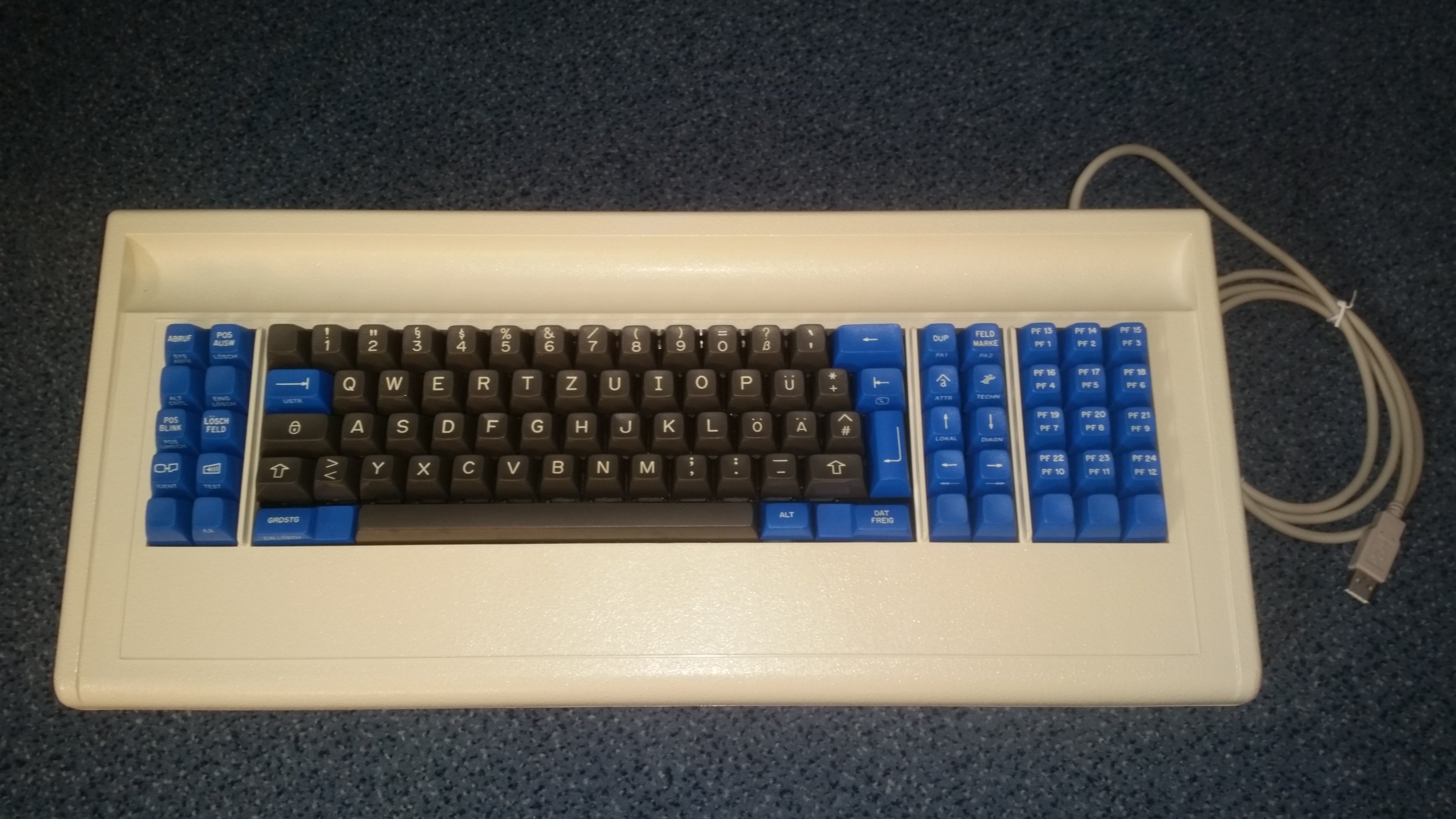

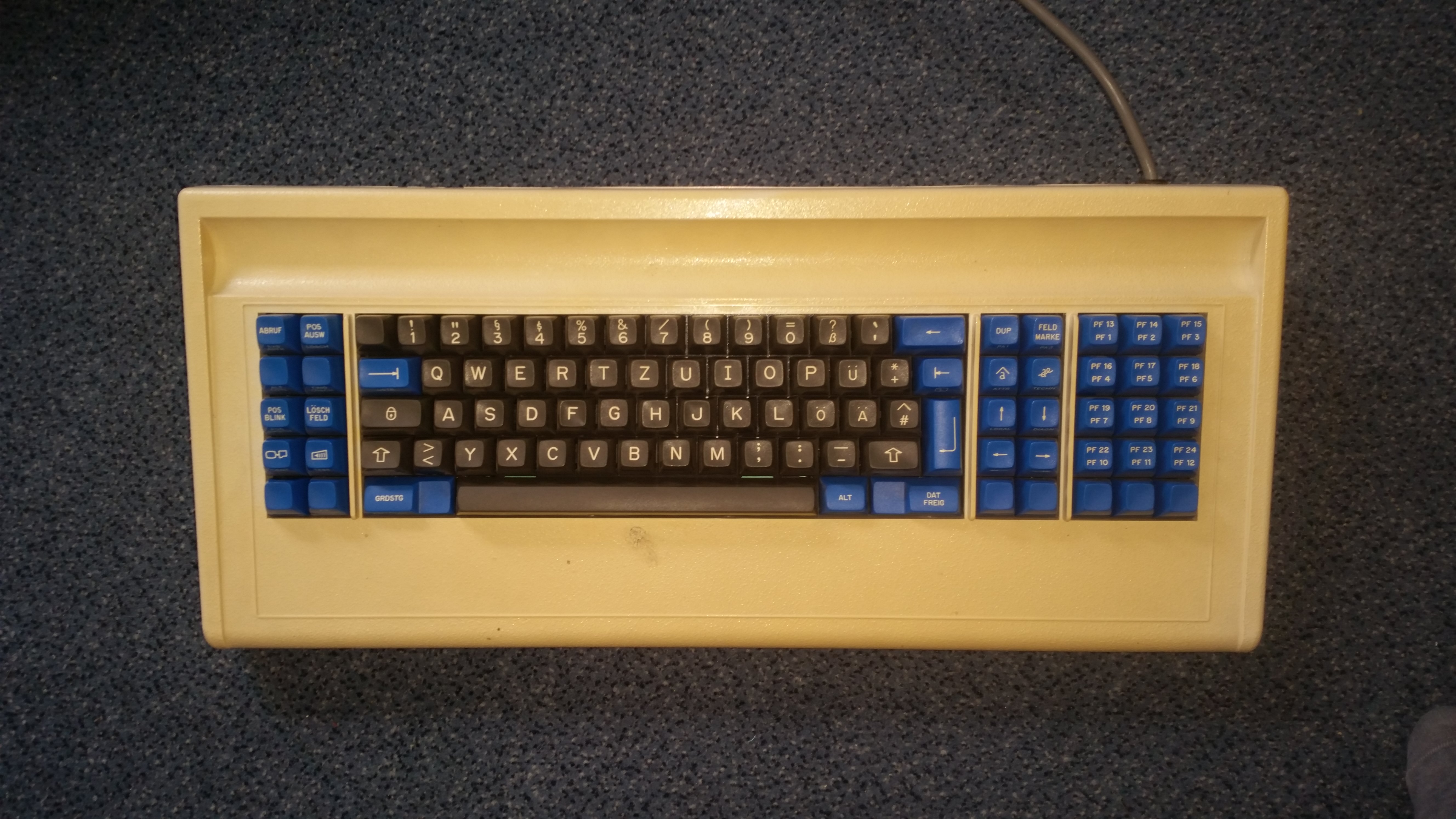

I found this keyboard on a local flea market, it was love at first sight. When I got it it looked like this:

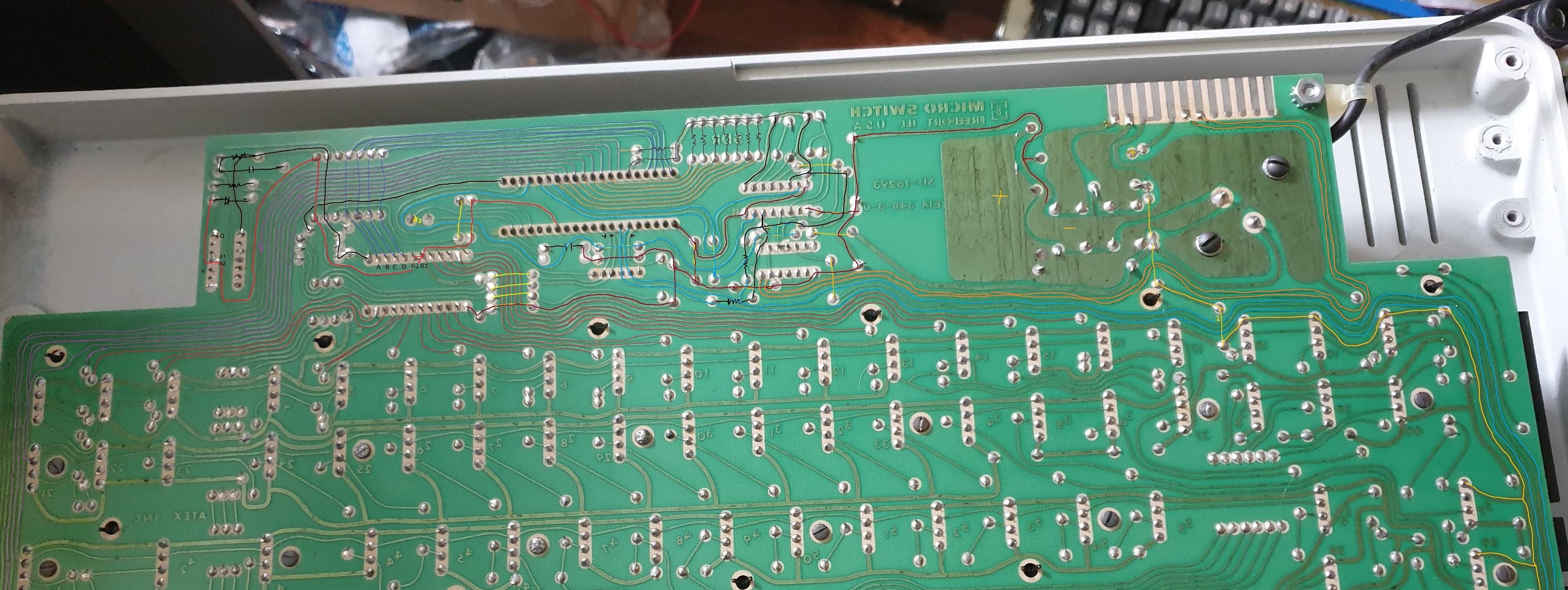

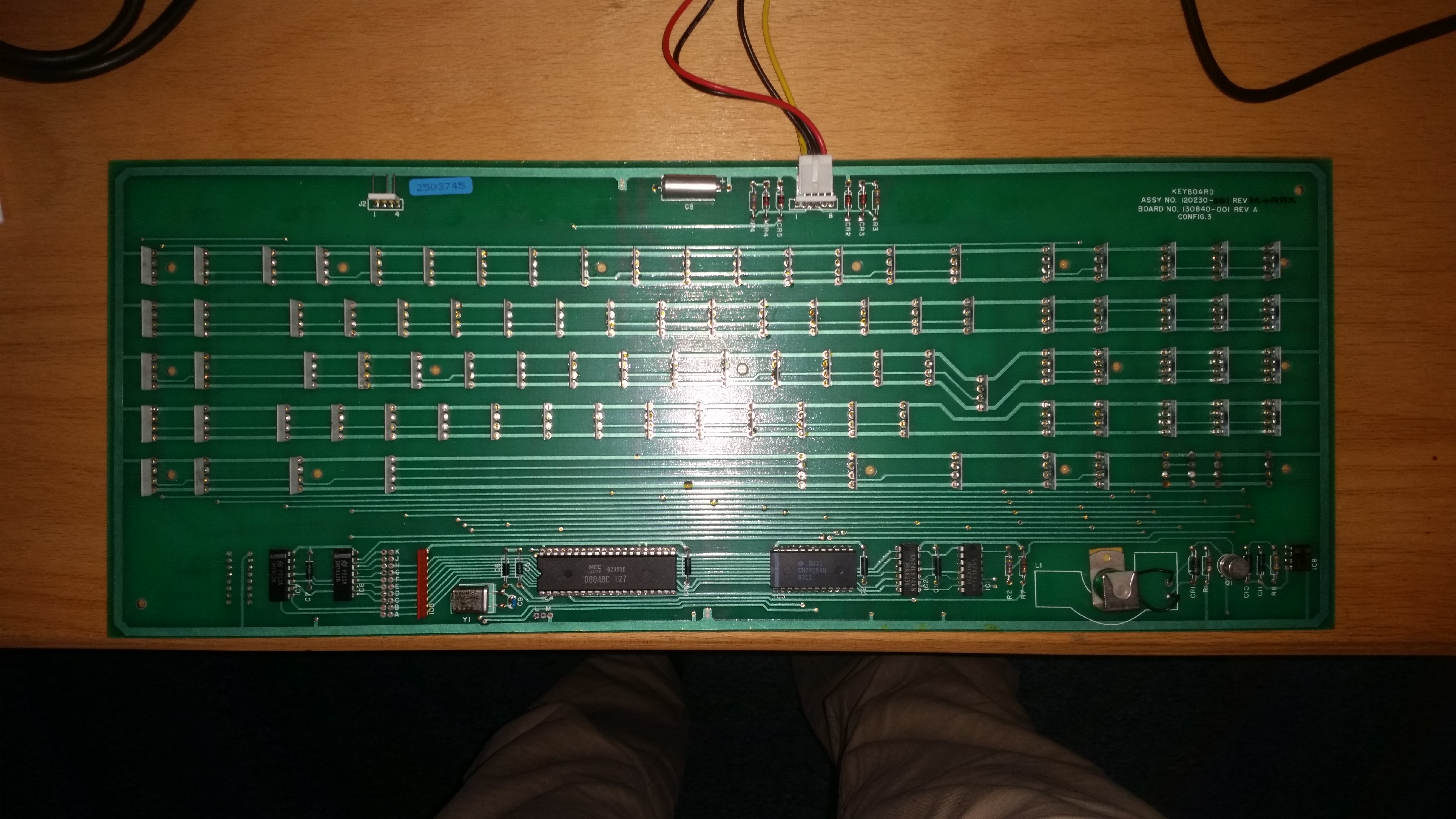

Maybe a little bit yellowed, but overall in good condition, nothing a good old retr0bright can't fix. But before that I wanted to get that keyboard up and running, so the first thing I did was to disassemble the unit to get a glimpse at the PCB:
You can easily spot the Hall Effect sensors, which are arranged in a matrix of 13 columns and 8 rows. Other than that there isn't much going on here, the big IC in the middle is an Intel 8048 compatible microcontroller. 4 of its pins are connected to a demultiplexer located to its right which is used to strobe the columns of the switch matrix. The demultiplexer expects the column index through a binary encoding from its 4 input pins. This means that the microcontroller can strobe all columns with only 4 of its pins being used! For sensing the 8 rows of the matrix are directly connected to the microcontroller.
A nice side-effect from this design is the fact, that this board supports inherent N-Key Rollover. This is nothing I really need, but it's cool to see and for a Hall Effect keyboard I think such a feature is quite rare. Another useless but nevertheless really cool feature is the solenoid located on the lower right of the board.

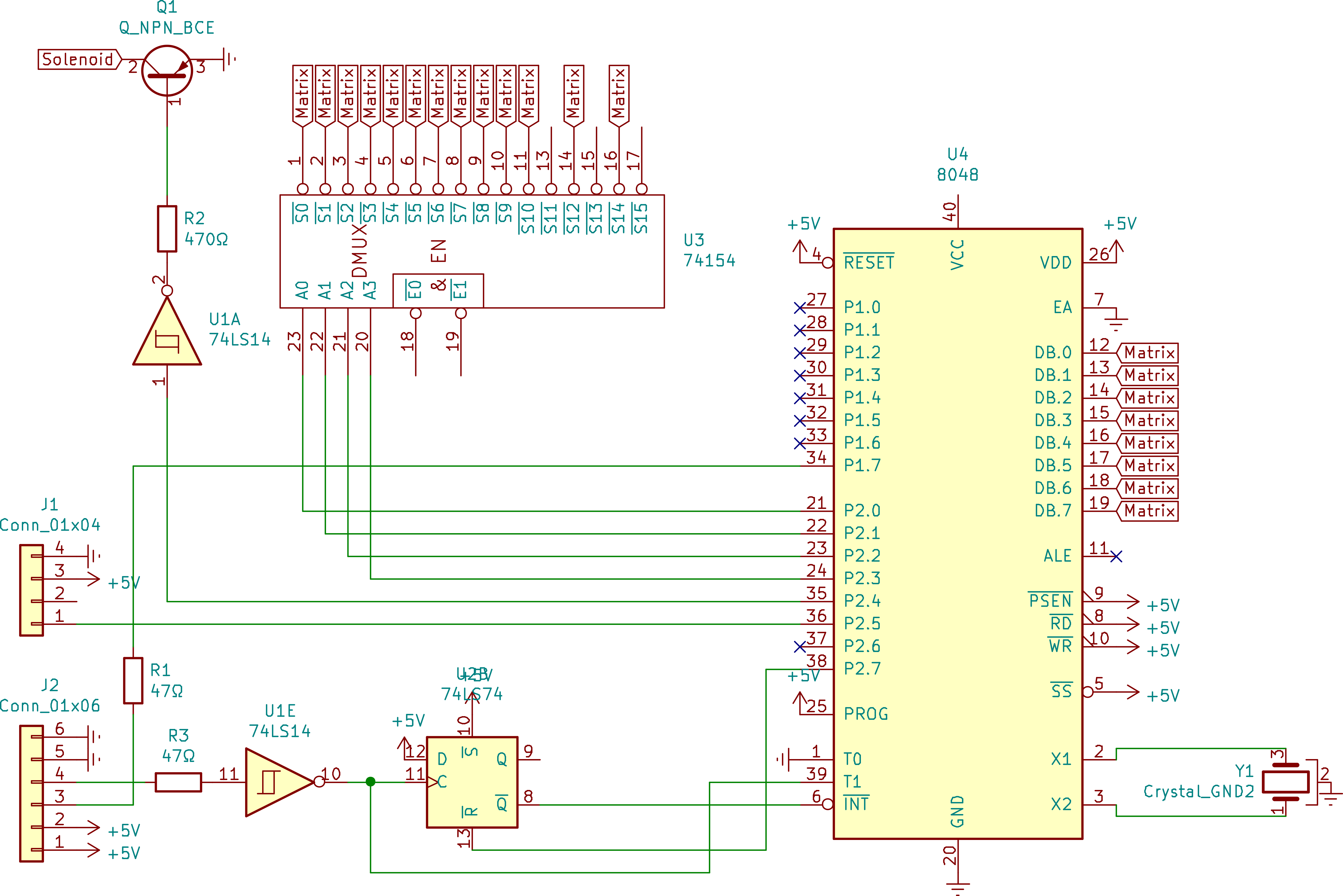

In order to record my findings and to make working with this keyboard easier, I created a schematic of the circuit:

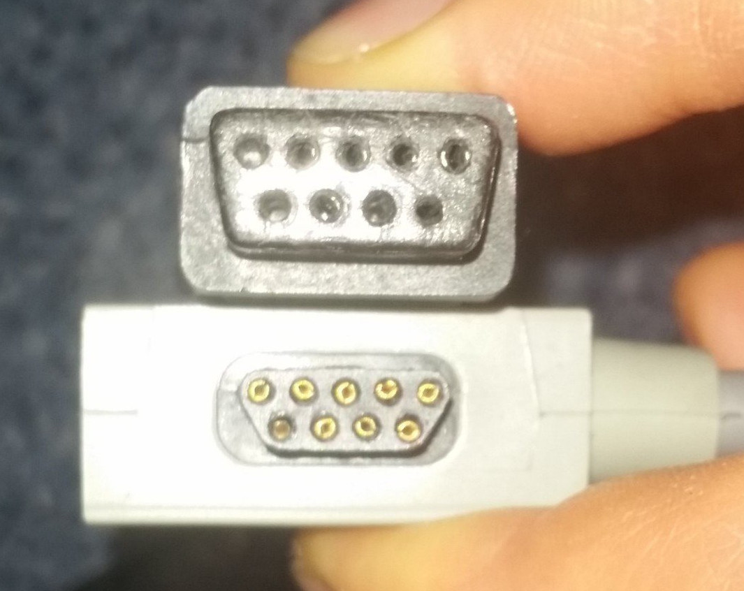

My first idea to get the keyboard working was to build a converter that can be plugged into the original cable. The original cable used a Micro D-Sub connector, something which I have never seen before, look how tiny it is compared to a regular D-Sub connector!

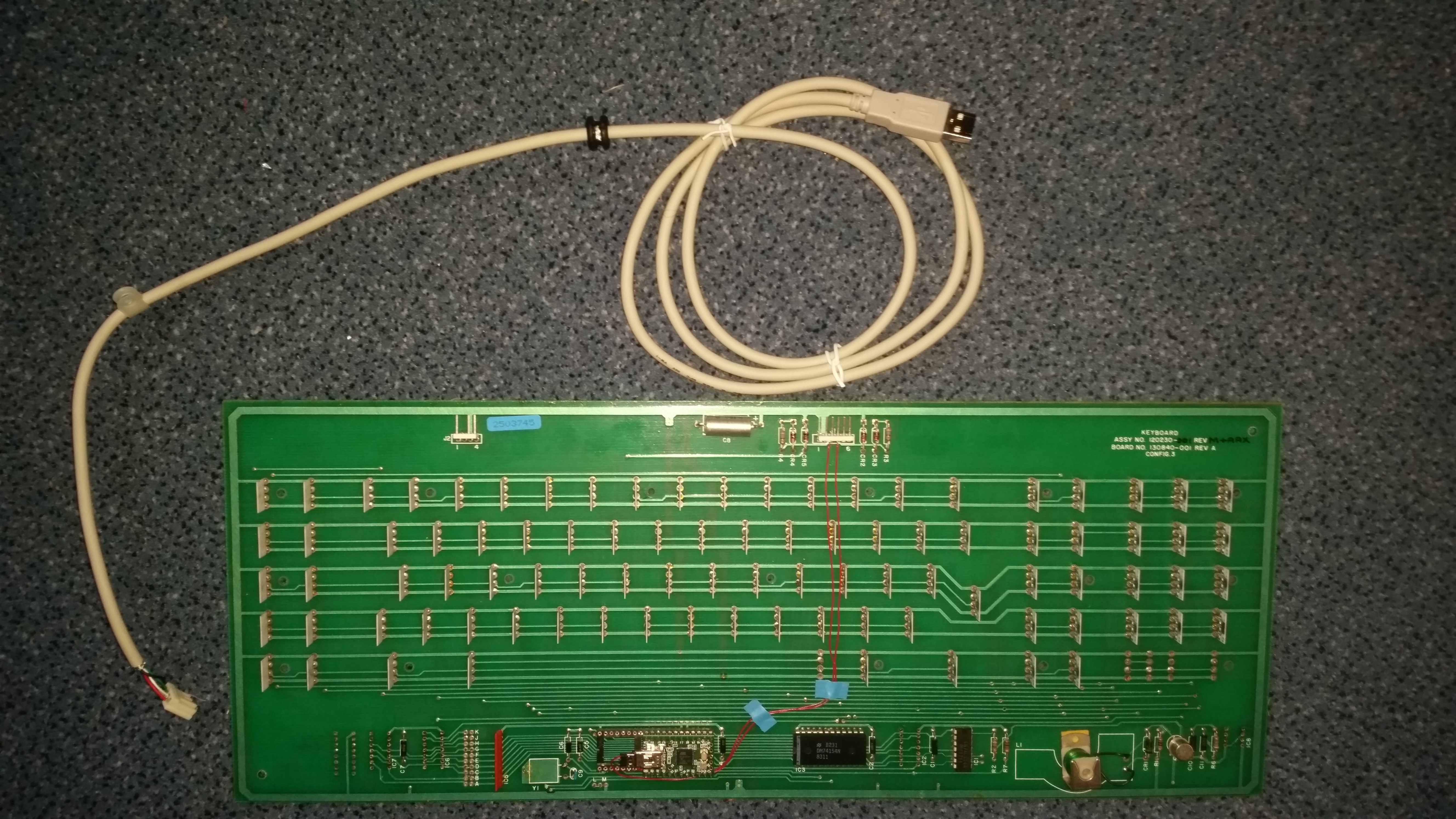

I decided to utilize a Teensy 2.0, because it has so many IO ports, that I only had to reroute a handful of signals and could leave most of the traces untouched. I also repurposed the connector on the board for a custom USB cable. Software-wise I decided to use the TMK Keyboard Firmware Core Library, which made everything pretty easy, especially when compared to reading antiquated 1970s assembler code. In the end the board looked like this:

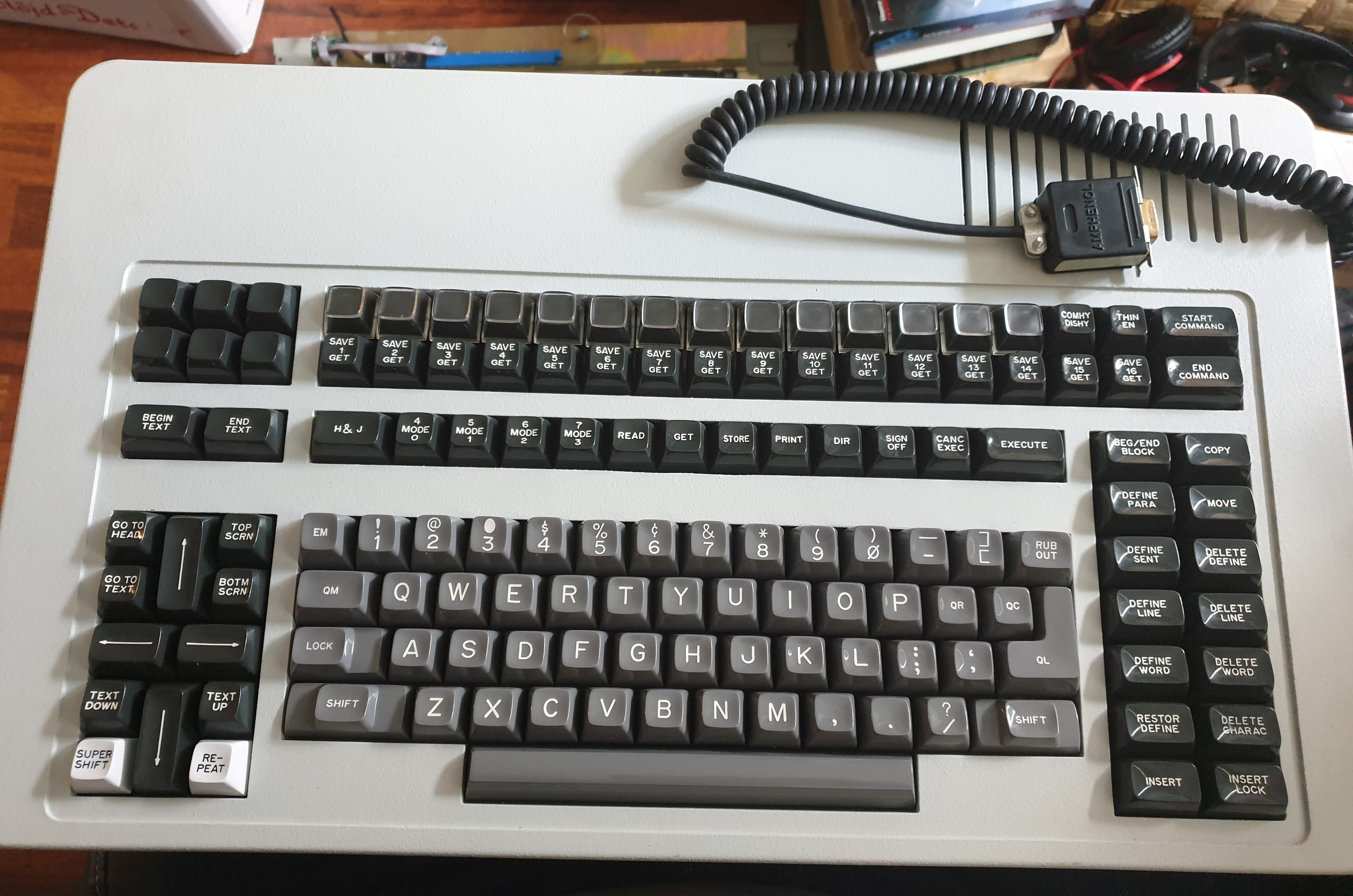

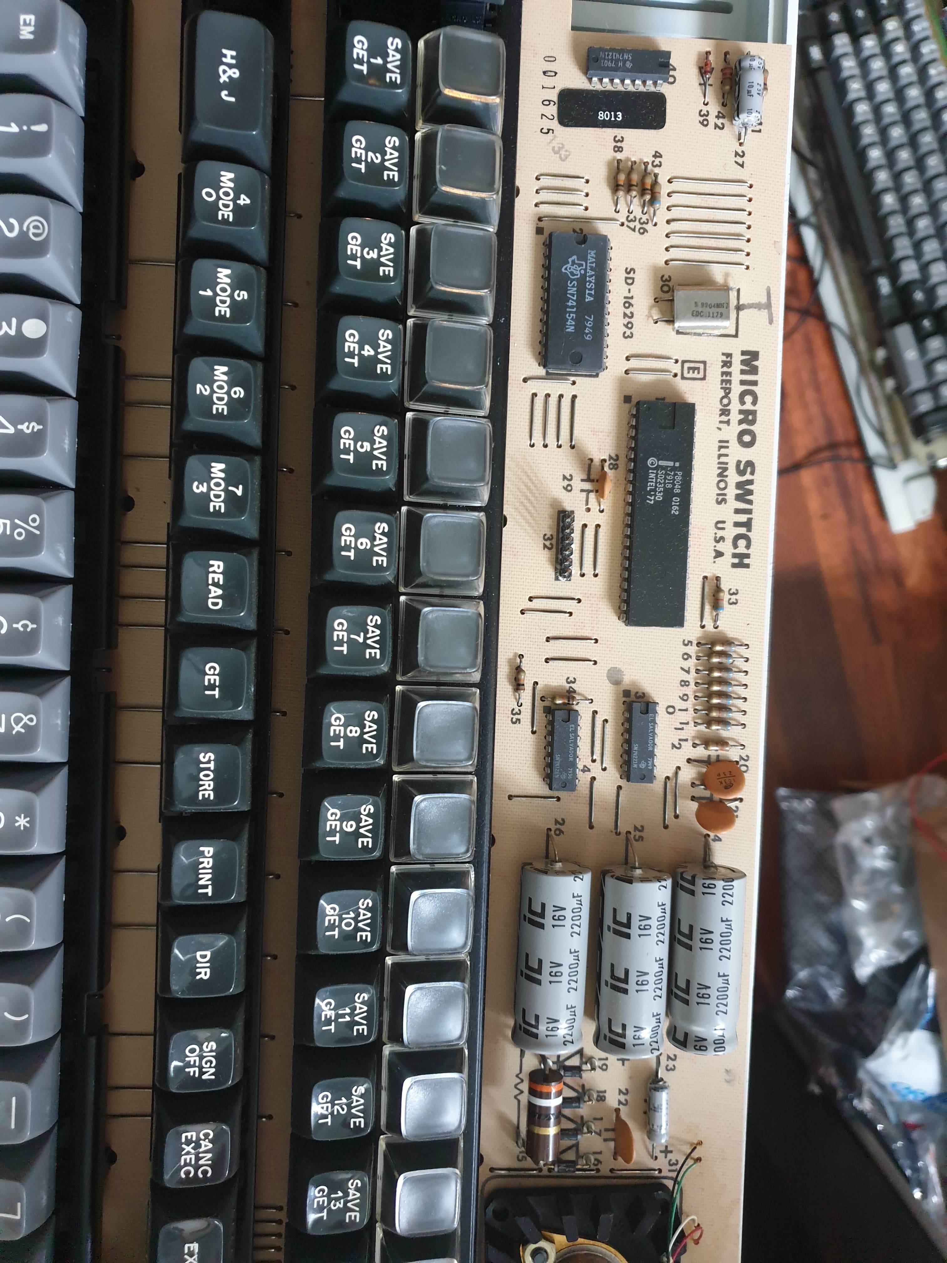

I have the same type of switches (broadly speaking), 4B3S, so logic scan switches. I also have the same type of controller with the same type of multiplexer. Very similar set up. The chips around are a bit different, but most are redundant when converted to USB in my case as well as far as i can see.
Is IC1 used for anything in your board? I do not have a chip like that in my board as far as i can see. If i have not misunderstood my circuit, strobing of the multiplexer are driven from a 74121 as a "clock" circuit. Are the G1 and G2 inputs of your multiplexer driven by the teensy?
The matrix is 16x8 in my case. Do i have to modify your code to get all the columns working? I guess i have to do some modifying anyway as the layout is vastly different, but i would be happy just getting an output for starters. The rows have pull up resistors in my case, is it necessary to remove these or should i keep them? I cant see any on your board.
Some help would be very appreciated, i am a bit green yet on this.

Hi, if I remember correctly I only use IC1 to drive the solenoid, so don't worry if your board doesn't have it. If your board works like mine you can probably leave the resistors in place. Also I THINK G1 and G2 are connected to ground on my board, but don't trust me on this. But anyway, just make sure they are low when you read the matrix.thor435 wrote: 24 May 2021, 16:39 I have the same type of switches (broadly speaking), 4B3S, so logic scan switches. I also have the same type of controller with the same type of multiplexer. Very similar set up. The chips around are a bit different, but most are redundant when converted to USB in my case as well as far as i can see.
If you want to use my code as a base, you first have to change the MATRIX_ROWS macro in config.h. The code to actually drive the matrix is in matrix.c. Since my wiring also theoretically supports a maximum of 16 rows you shouldn't have to change much (if you use the same pins). You definitely need to change select_row though. There I skip rows 11 and 13 since they are not connected on my board, I think you should remove that. Maybe also try to understand the rest of the function, since I'm not sure anymore if it's specific to my board or not
BTW, very nice board you procured there, I wish you luck with your conversion
