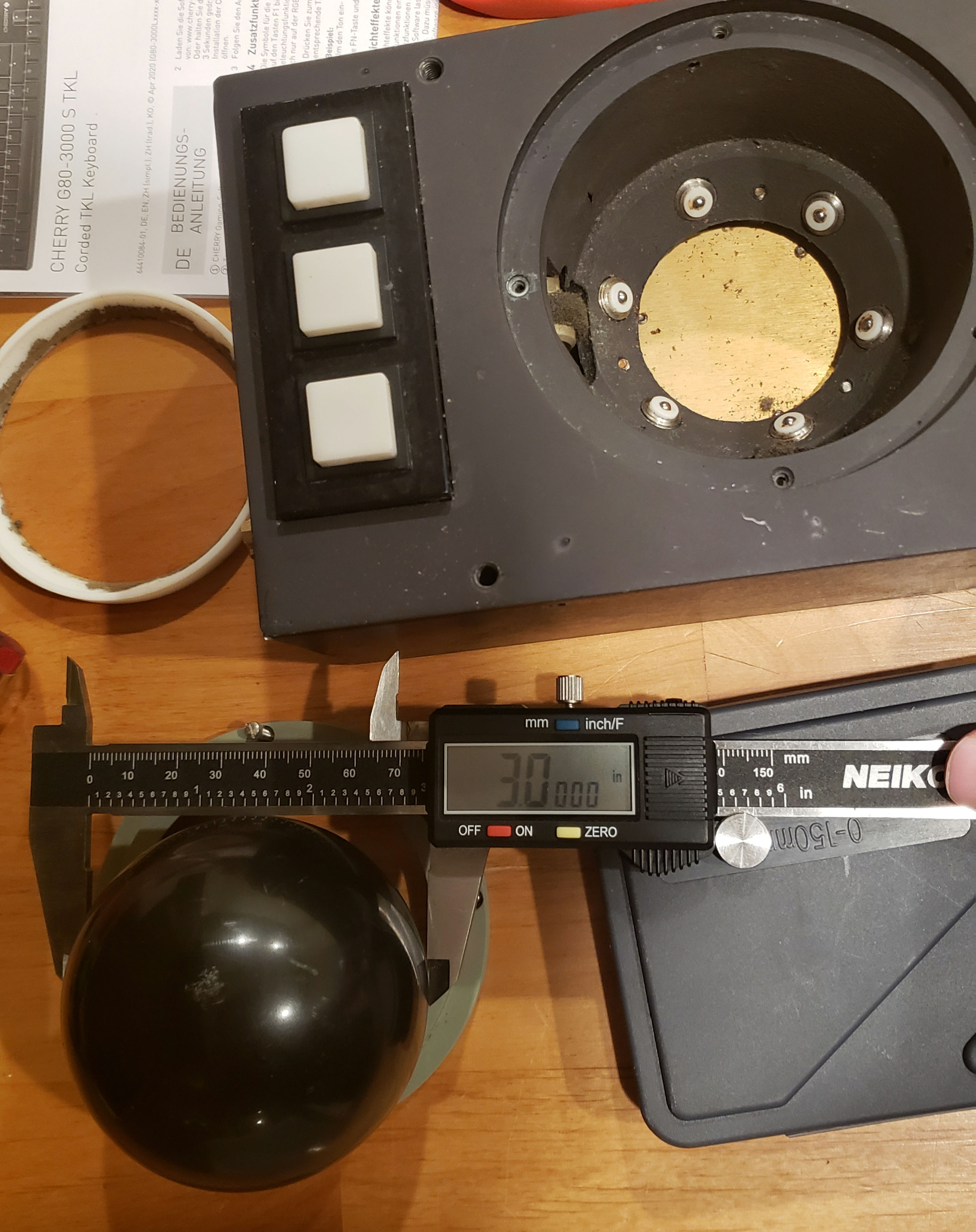

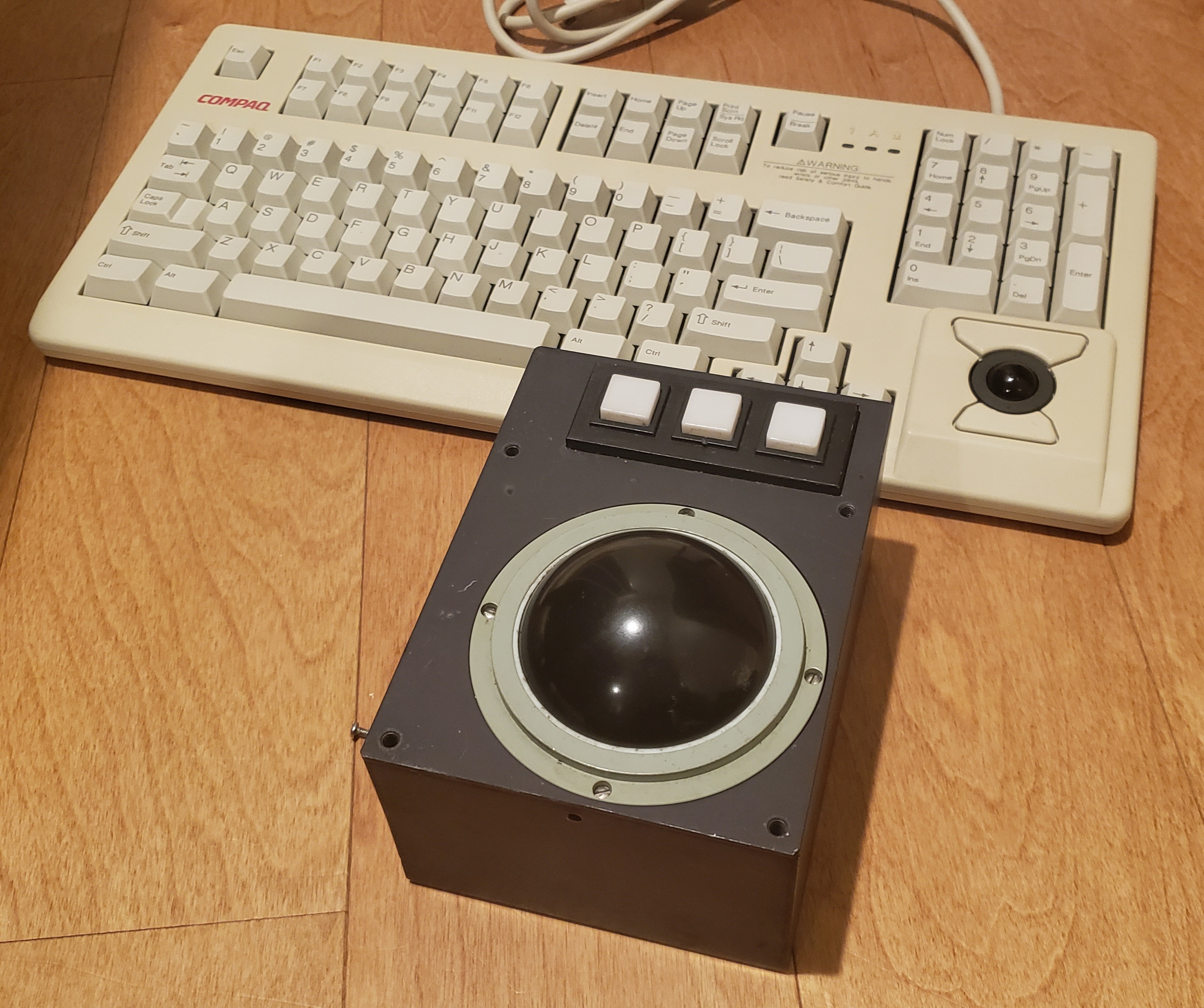

4" L x 2.3" H x 4" wide. Trackball is 3.328" diameter. That's pretty big.
I saw mention of a Measurement Systems trackball in the great finds board, and being who I am I spent the next few hours comparison shopping. After purchasing a completely different device (A RAM Optical Instrumentation control panel), a seller of a significantly cheaper Measurement Systems ball tempted me with a small discount. I was powerless to resist.
The listing quoted the size as 2.5" in diameter and the housing featured buttons. The ball I received was 3" like the other listings.
The ball is massive compared to the Compaq 11800
The build quality of the device is the real appeal. The lower shell is welded aluminum, the top plate is a machined casting, the buttons "plate" is machined, the switches are massive, click, and seem to have lights to illuminate the white buttons. The mechanism is also different from conventional track balls as it uses servos(?) or some other sealed component instead of spoked wheels and optical encoders.

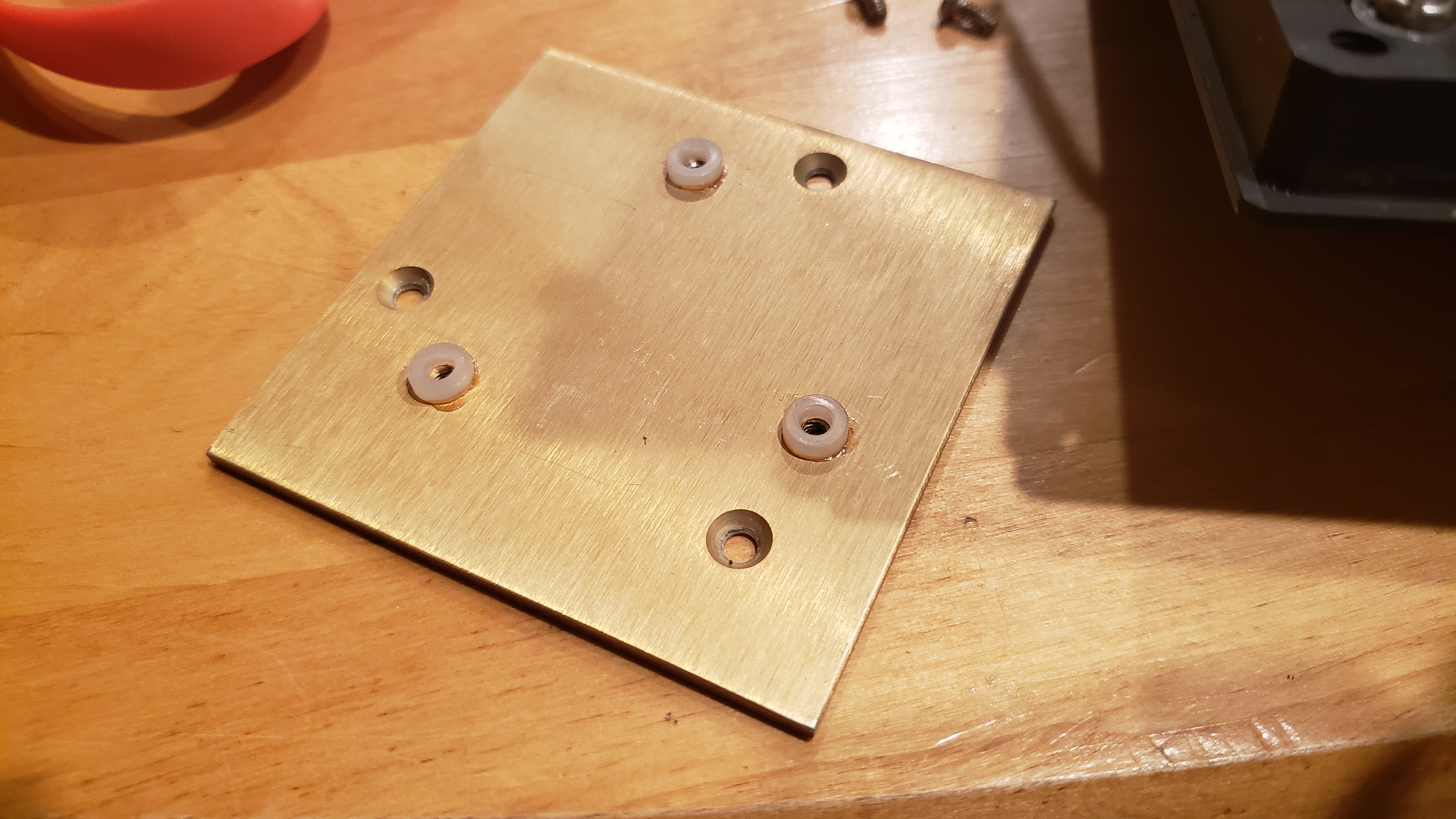

A brass plate is installed between the top assembly and the PCB with screws and plastic standoffs.

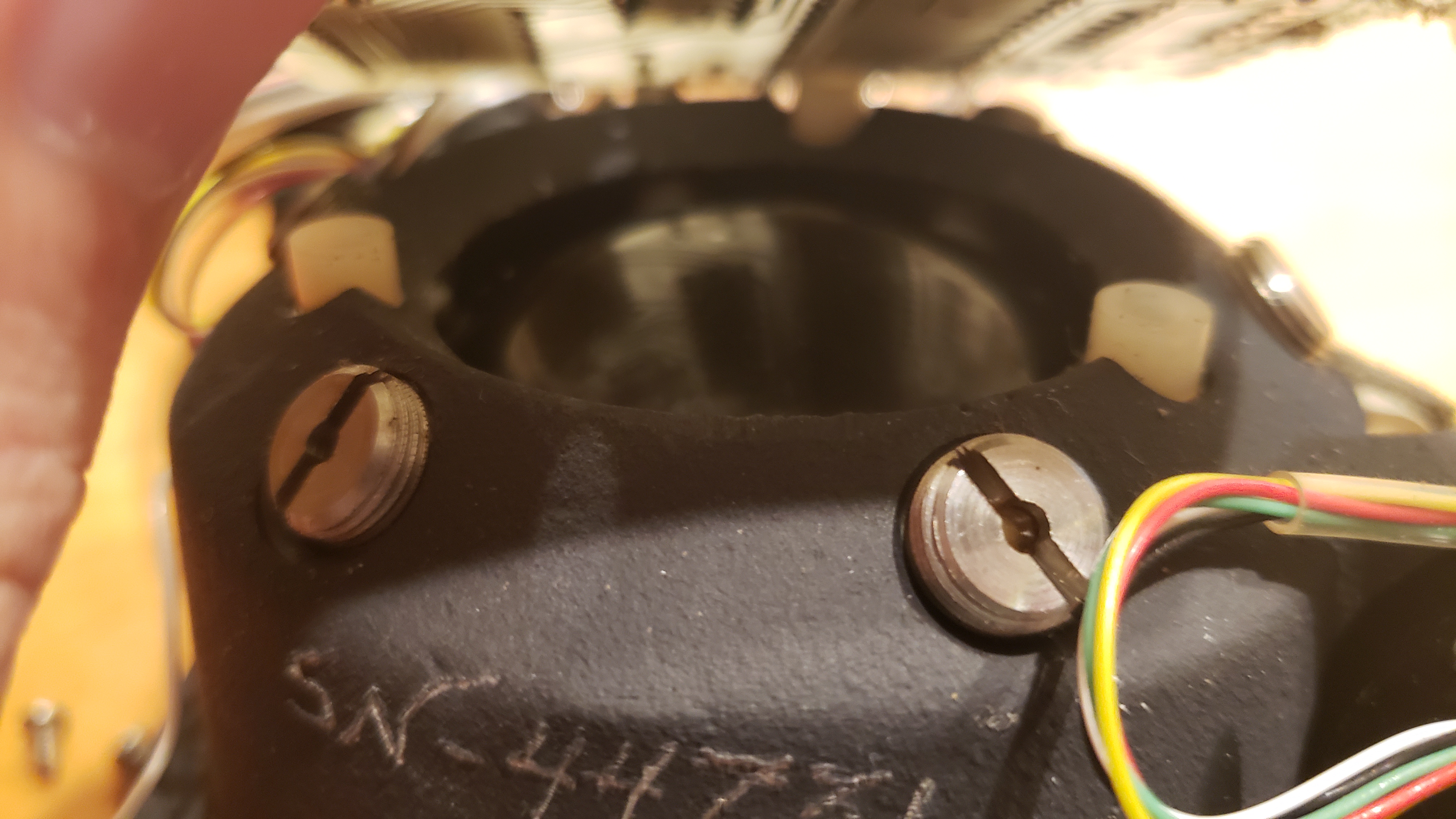

The ball spins on a total of 6 bearings, which are tightly screwed down, but it is possible to clean some debris off them from the other side when the ball is removed. Some lubrication and or new bearings would likely make it even better.
The ball is uncomfortably tall when placed on a desk, and the top of the housing features threaded holes and the button assembly and retainer ring have pronounced ridges, so I believe this module was designed to be installed inside of a desk similar to modules installed into some arcade machines. I am not sure what protocol this device uses (only some of the pins on the connector are used, so it might be serial or something completely proprietary. In any case there is more than enough space to hand wire the components to a teensy or internally convert it.

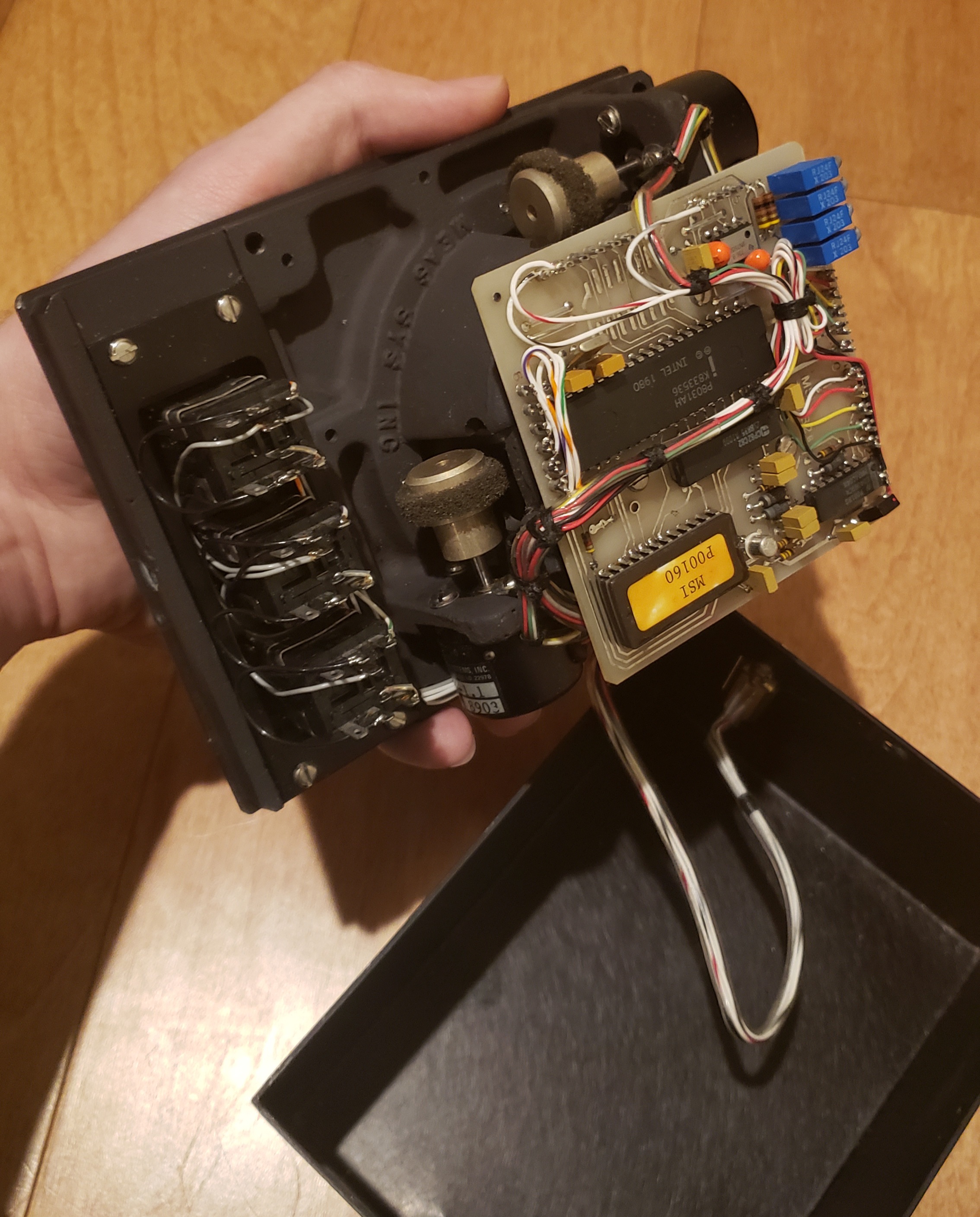

Rayndalf wrote: 14 Oct 2020, 08:44 The mechanism is also different from conventional track balls as it uses servos(?) or some other sealed component instead of spoked wheels and optical encoders
Actually, no difference here. They're the same quadrature encoders, just in different (sealed) form, like this:
https://www.bourns.com/products/encoder ... l-encoders
You've got an interesting model: my 2.5" Measurement Systems XCL-250 trackball uses 3 bearings, not 6...

It's bizarre to me that the internal wiring is tied down with finely braided cord (like dress shoe laces) complete with a slightly oily/waxy texture.
It was military/industrial standard for ages. Cables were prepared by dedicated worker and passed to the assembly line in "ready to solder" state, with appropriate length for each wire.
Did you manage to get yours working? I'm hoping it's serial, but if it's something else it should still be doable.
Mine have quadrature output (raw signals from encoders & switches), and works just fine. Conversion to USB and review on my blog is scheduled for this year... :)

Rayndalf wrote: 15 Oct 2020, 11:01Do you mean replacing the controller with a microcontroller or reading the outputs at the plug?
In case of quadrature output, there's no controller in device typically - so I'll have to add one.

Mine seems to have a few chips inside, but they might for be the buttons, guess I need to break out a voltmeter.

The bearings should be replaceable/serviceable but they were screwed down tight (and I don't have a screwdriver big enough to rotate that tight without damaging it).

Rayndalf wrote: 17 Oct 2020, 00:21 The bearings should be replaceable/serviceable but they were screwed down tight (and I don't have a screwdriver big enough to rotate that tight without damaging it).
The bearings will pop right out on their own sort of. No need to unscrew anything. If you rub a ball bearing a while it will loosen up. Once you have one rolling free enough take a magnet and you should hopefully see the ball bearing lift up a bit Well at this point you should be able to pry the bearing out if you have long enough fingernails. I was able to pop most of mine out.

Rayndalf wrote: 16 Oct 2020, 19:09 Mine seems to have a few chips inside, but they might for be the buttons, guess I need to break out a voltmeter.
The only quadrature trackball with microcontroller I'm aware of is DT-225 where Microchip PIC16C55 is used for axis rotation, pulse rate (i.e., sensitivity) change, and button function handling. In your case, pictured Intel 8031 with separate ROM chip have way too much power for simple operations, so I'm pretty sure it provides some complicated protocol output, most likely serial.
BTW, identical controller is used in my Fulcrum Trackball Plus, where it's capable to emulate almost anything:

Only 5 of the pins in the connector in my ball are actually connected to the controller (which is consistent with integrated balls which eventually terminate to a 9 pin plug and use serial).
Similar to your Fulcrum ball (I love that chunky bezel, it reminds me of chording keypads like the BAT), the connector has a total of 15 pins instead of the 9. Hopefully it still uses a standard serial protocol (and isn't relying on a strange pin for additional power). I really need to get a decent serial to USB converter, I have too many boards with serial balls or track points that I need to get working.
Are you familiar with any smaller active serial converters that could be installed inside a device so that the keyboard + trackball connections could be internally converted and combined using a small USB hub so the whole thing would only use 1 USB port? I wonder is a promicro could serve as an active PS/2 converter and a serial converter as the same time (and remove the need for a USB hub as well).

Rayndalf wrote: 20 Oct 2020, 05:30Are you familiar with any smaller active serial converters that could be installed inside a device so that the keyboard + trackball connections could be internally converted and combined using a small USB hub so the whole thing would only use 1 USB port? I wonder is a promicro could serve as an active PS/2 converter and a serial converter as the same time (and remove the need for a USB hub as well).
IMHO, most elegant solution would be, to replace trackball's serial controller with PS/2 one (for example, use old ball mouse as a donor), and connect its output & keyboard to the standard cheap dual-PS/2 to USB dongle. With connectors and shell removed, it's pretty small - no problems to mount inside. You'll get single USB output without any hubs that way.
