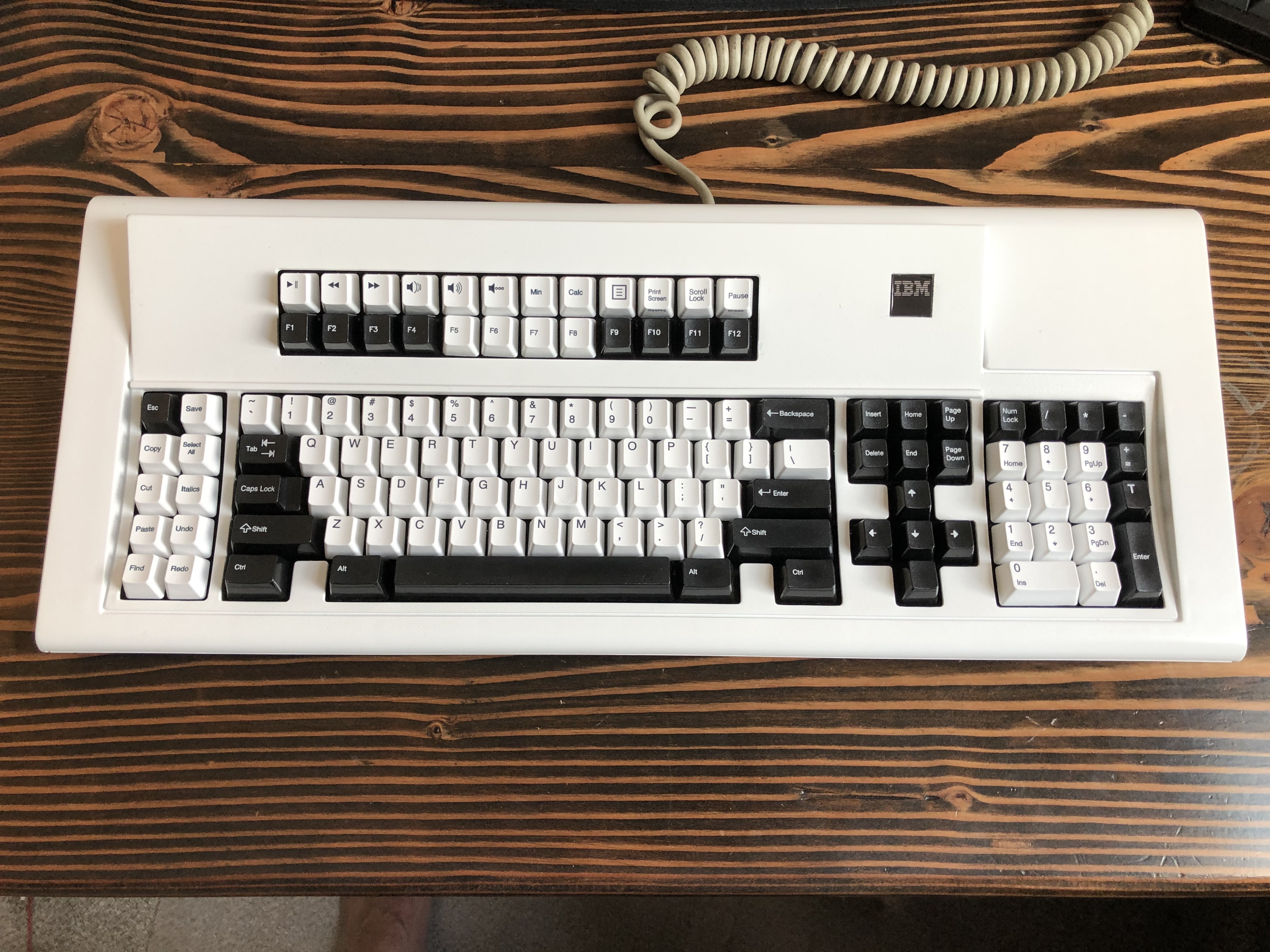

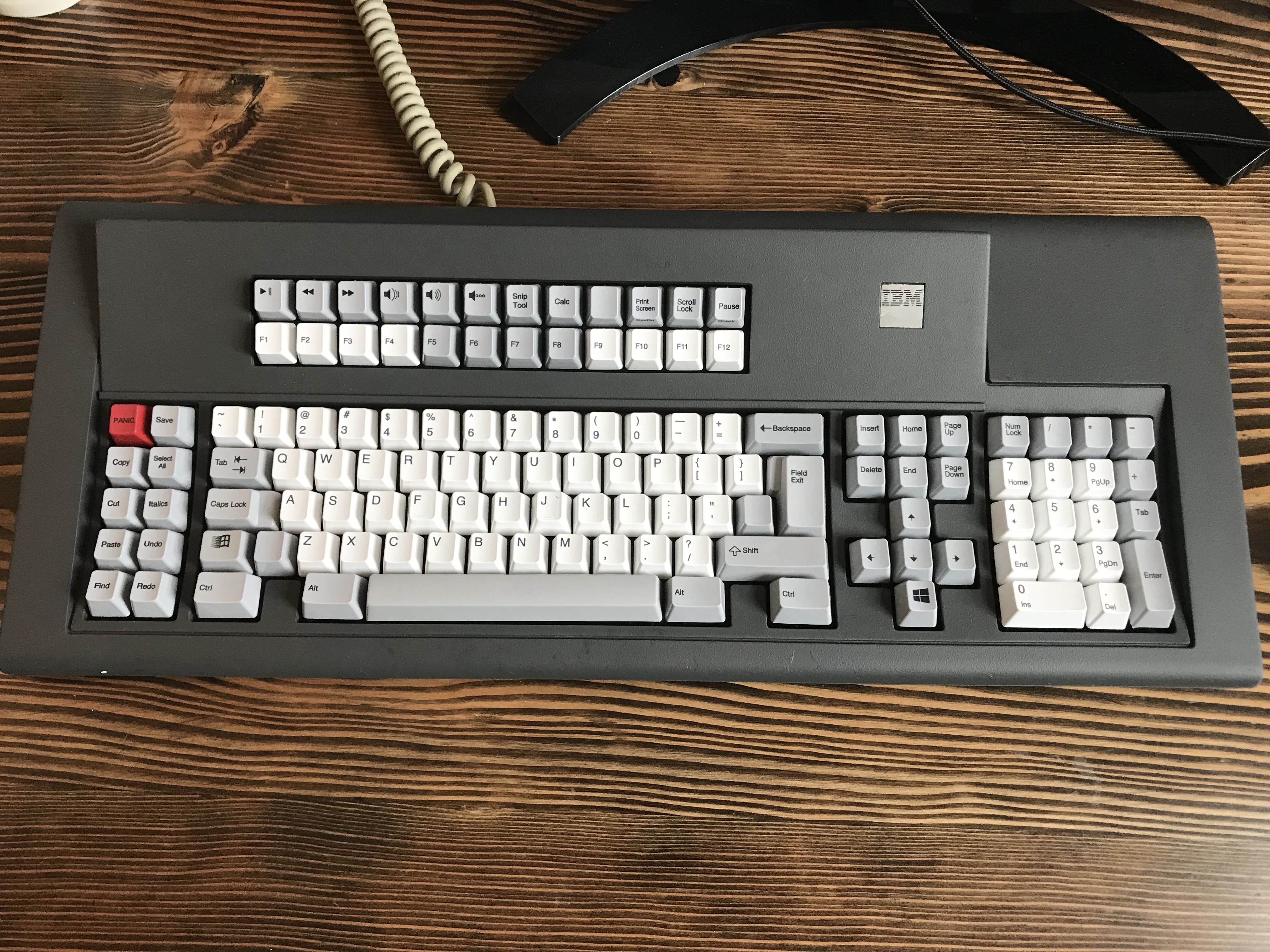

I've spray painted a few cases before. It an look great if you do it properly. The drawbacks are that it's not a durable, ie, it's susceptible to dings and scratches. You can spray a layer or two of clear coat which helps with that but it gives it an undesired sheen. Ultimately, it you can make it look good, I think it's worth it.
I'll share two of my spray jobs.
Not as durable as I didn't clear coat it but it looks better. Note the ding in the lower left on the front of the case
F122 after.jpg (3.8 MiB) Viewed 3974 times
I wanted to do for a brilliant white on this one. More durable with the clear coat but note the slight sheen.

Wow, that looks great! Edit: How did you dye your keycaps black? That looks soooo good with the white case
In terms of the clear coat leaving a sheen: I use matte clear coat and spray on 3-4 coats of very thin layers, and I typically get no sheen =)
For my "idiot proof" method...I just use 3% or 12% (if you want it to go faster) Hydrogen Peroxide and completely submerge the case. I then use my immersion cooker to heat the water to about 55 degrees C and let it run for a few hours.
