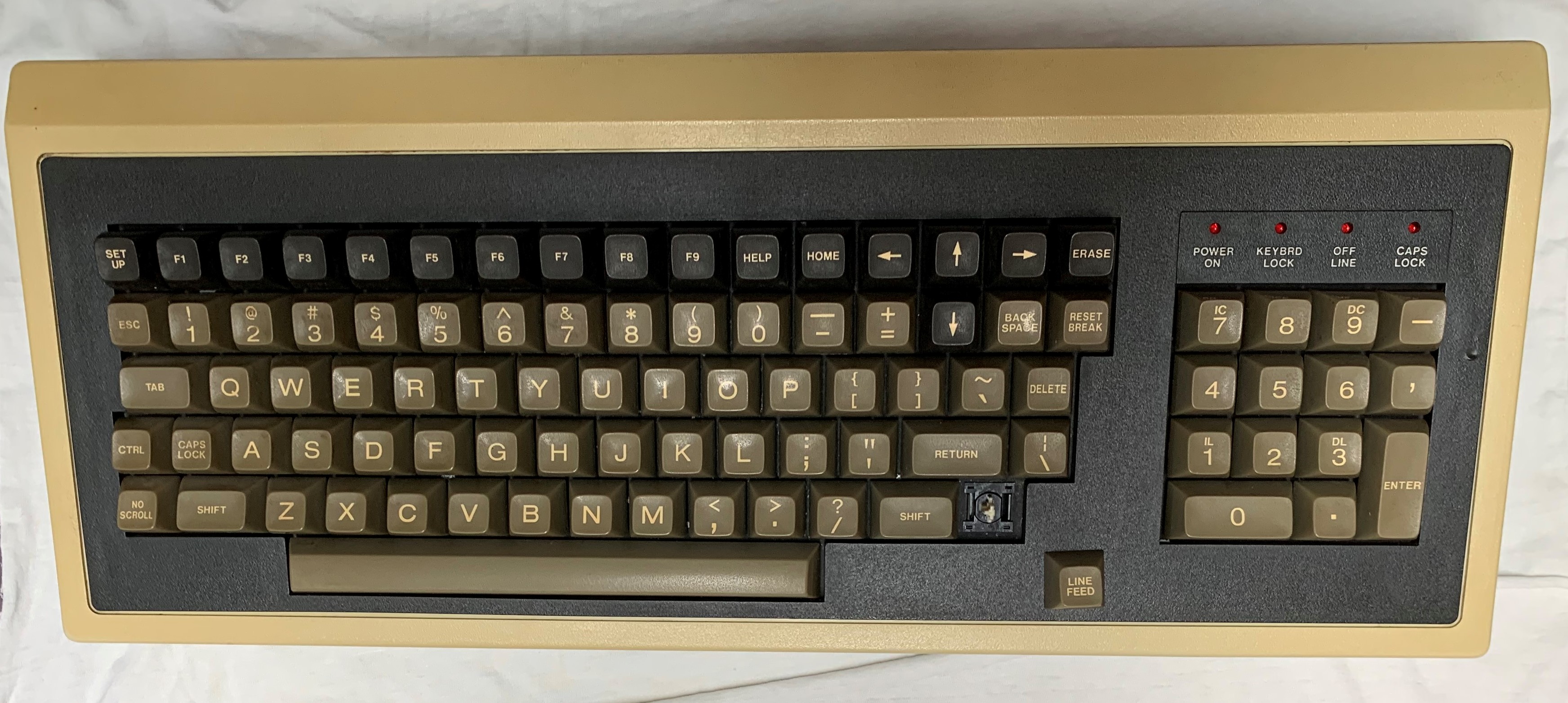

This keyboard supposedly came from a Morrow MDT-60.
I have no reason to doubt that, but as far as I know there is no difference in the keyboard itself between that and a Zenith Z-29 or a Heath H-29. The layout is a bit like a VT100, but tries having the arrow keys poke out from the differently colored function row into the top row of the normally colored keys. It has Alps SKCC Cream switches, so it's still pretty nice to type on.

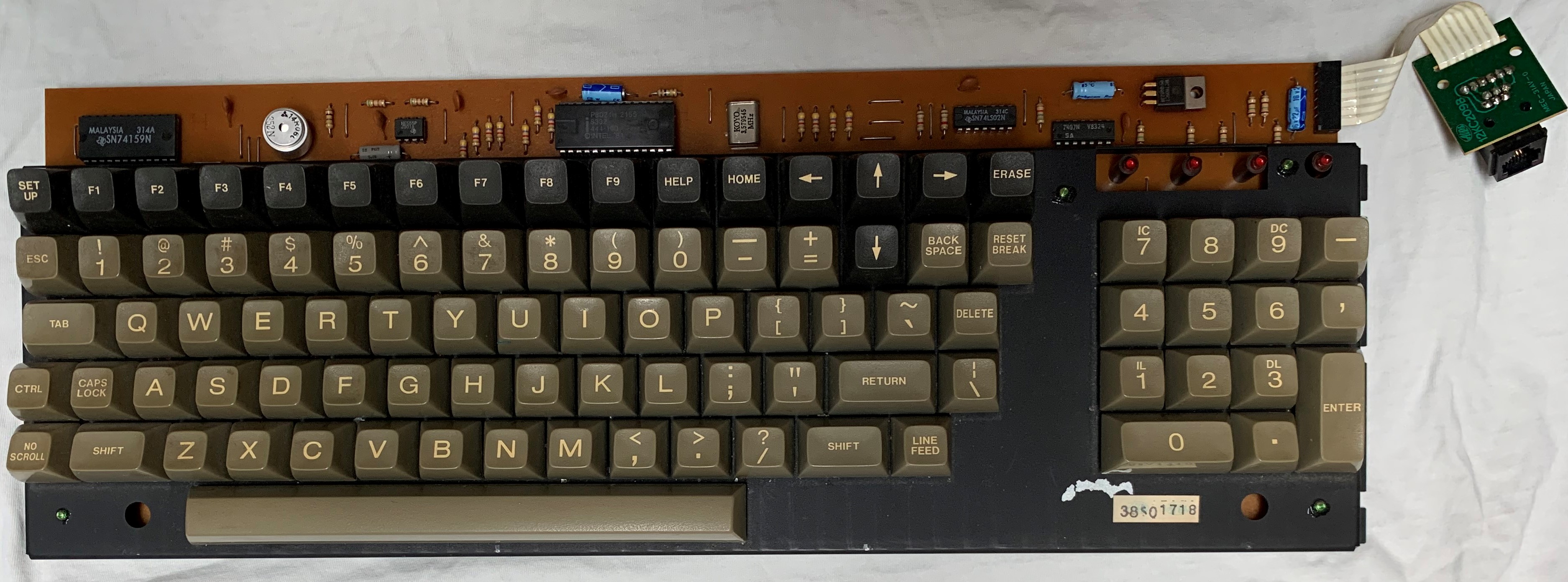

The controller is an 8021 and it has a 5V regulator. The Service Manual variously says 8V and 9.6V. It doesn't really matter and I'll power it with 12V, because that's what I have here.

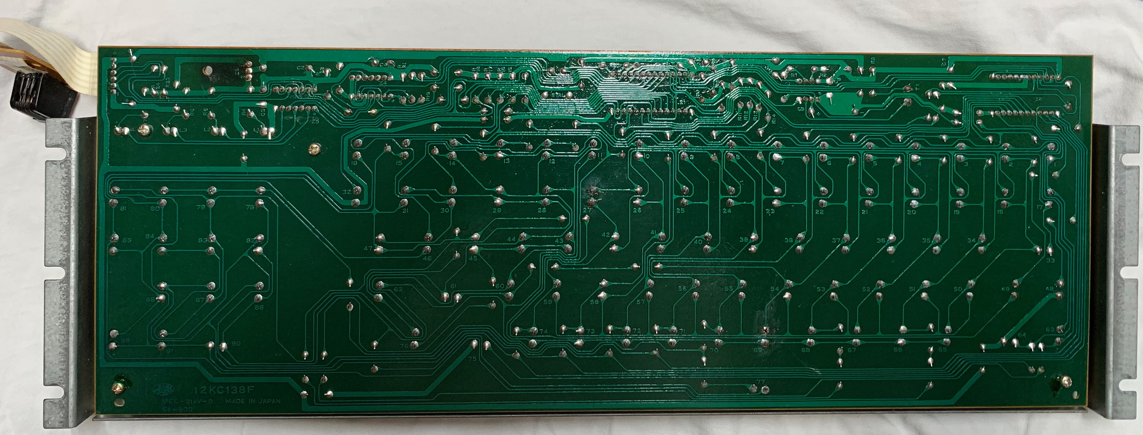

The PCB 12KC138F does not have any other branding.
The soldering job isn't great. I don't know whether one soldered in the switches with the Heathkit version or it came already assembled from Japan. It also turns out the F7 key doesn't work on this one, so that'll need to be dealt with at some point.

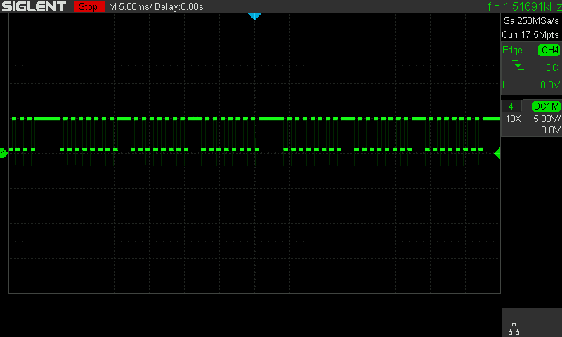

Powering it without anything other than a scope attached gives this on the transmit line:
Which appears to be the keyboard trying hard to get the terminal to notice transitions on the XMIT line. So that aforementioned handshaking needs to be taken care of.

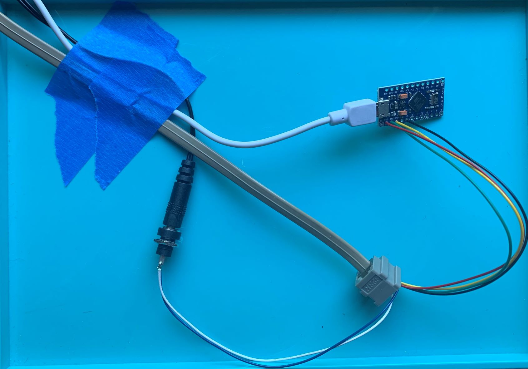

So the converter ends up looking very much the same, up to exactly which wire goes where.
