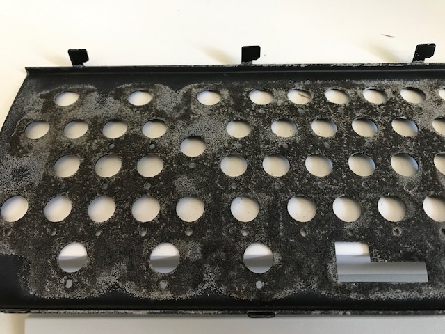

I just got a Model F XT (year isn't written/stamped; "IBM Personal Computer" badge). The foam has turned into an evil, sticky, black goo and that goo has spread to the bottom of the metal barrel plate and even to some of the springs. Additionally, the bottom case and barrel plate, both top and bottom, have a good deal of rust, so it's goo+rust.
How can I clean this?

When restoring Model F i find it best to just use
on all the goo and rust on the barrel plate and spray paint it afterwards ;)
Prefer to prime it with some rust stopper before some layers of black paint. Leaves you with a like new a surface :)

Agreed with above comment, I am restoring my F XT and sanding the goo from the foam (and the paint) and then repainting is the way to go.

Soaking the plate and barrels in warm soapy water for an hour or overnight will get that residue off without much manual effort.
Soaking in vinegar water will get the rust off, but will leave it subject to immediate new rusting unless you get it painted. I love Rustoleum and read the label, many of their products are specifically rust-inhibiting.

This tool would be the most economical diy way to clean up a plate to prepare for paint. You could also sand it by hand but that is very time consuming. Even better would be to have it sandblasted, at least that's what I did back when I had access to one.

I think sanding is going to be fine for the top of the barrel plate, it's just the gooey side made me ask for an alternative. I've seen those wire brush things before, but I've never knew what they were for.
I've seen a couple of Model F restorations on this 'board mention that they've used vinegar to good effect, but I've also seen comparison videos that show that Evapo-Rust, and some of their competitors, work better on other metal things.
I stopped cleaning on the Model F when I cleaned some of the white spots and saw rust. I do know that soon after you sand something metal, it should be primer-ed or painted, or it'll immediately start re-rusting, so I'll stand down until I get stuff from Amazon. I won't run out of projects: I've got an NTC clone that I need to work on and, provided my Model M 122 doesn't sell on ebay (I purposely priced it high), I have a Soarer's Converter that I need to program.

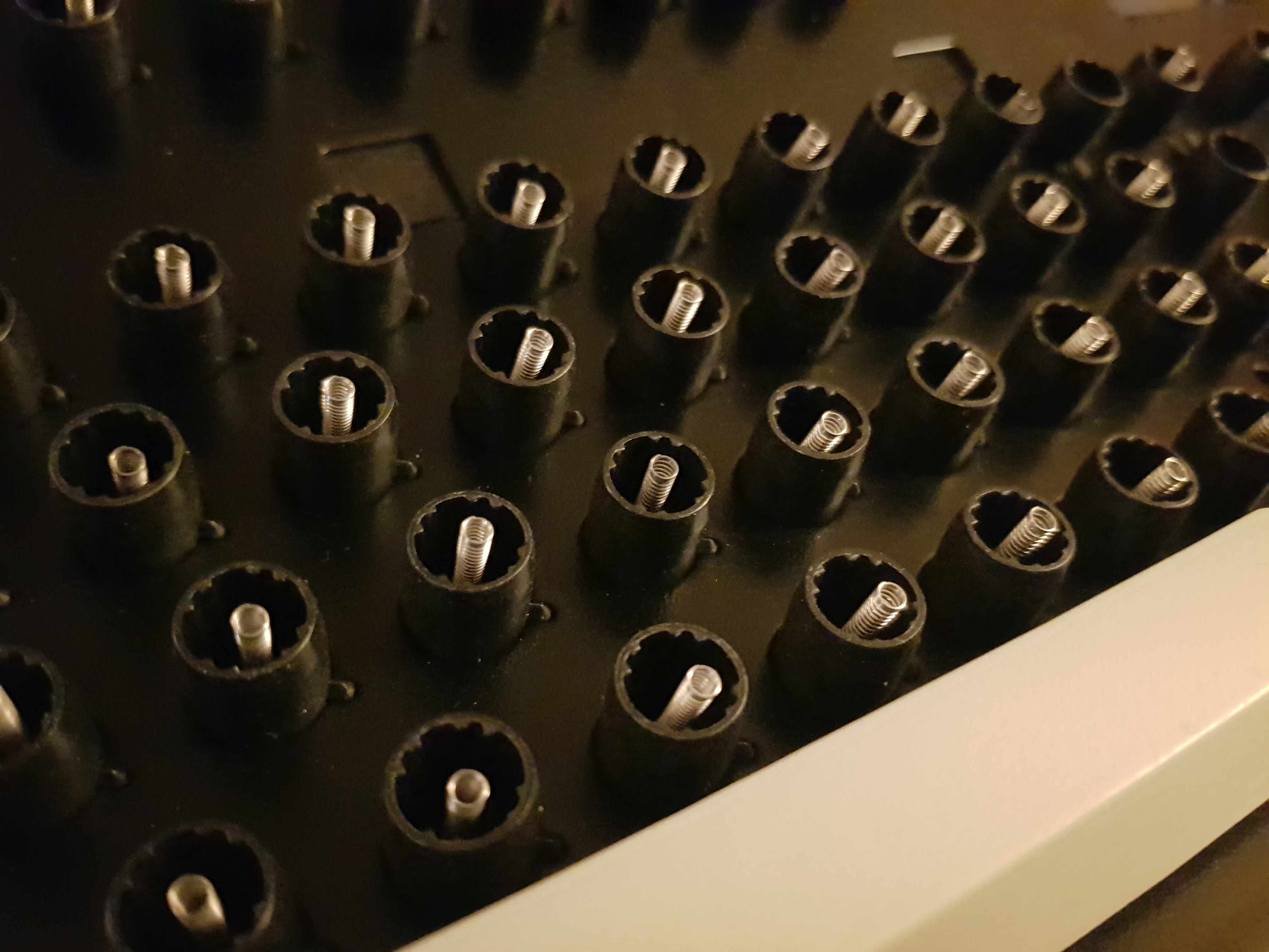

hellothere
08 Jun 2020, 01:30

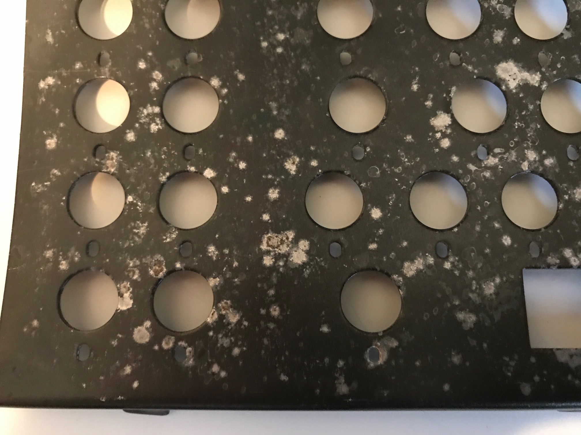

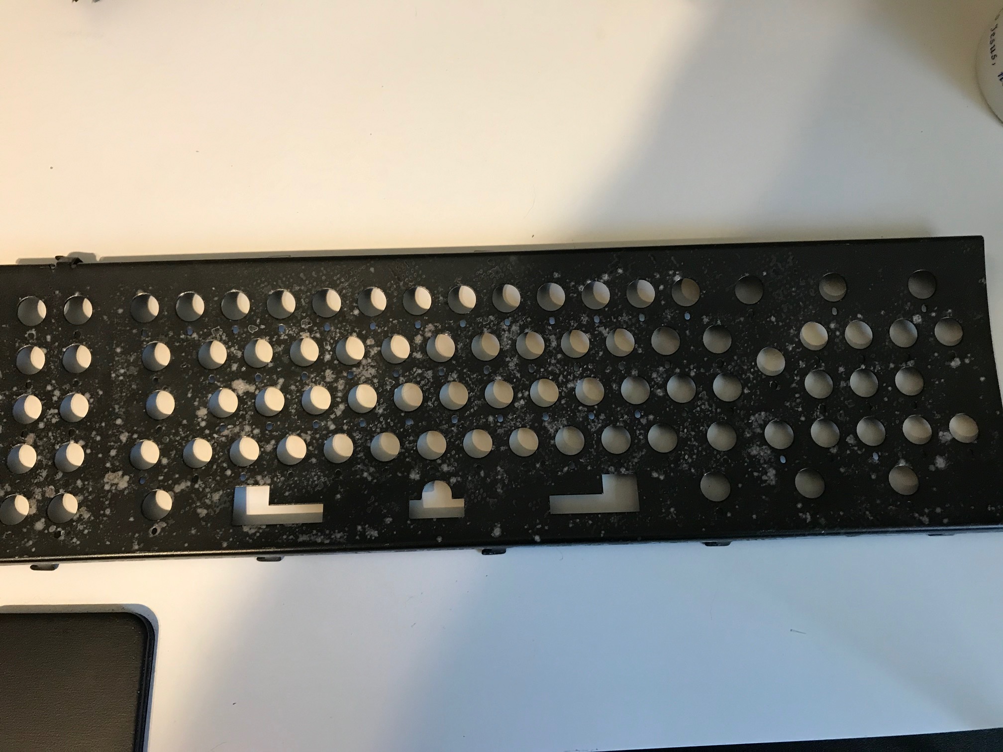

It's coming along. These are pics of the barrel plate after soaking in Evapo-Rust for about 7 hours.
I was able to see some improvement in about an hour. All the raised white spots are now bare metal. Evapo-Rust isn't a miracle, though: the brown rust spots are pitted and need to be sanded down a bit, but it'll be a lot less work than I originally thought. Immense thanks to JP! for the recommendation. I've also bought a can of Rust-Oleum Rust Reformer and a can of Rust-Oleum Ultra Cover for repainting.
On a related note, I tried Evapo-Rust on the springs for about an hour. It didn't do anything. I rinsed them with water and dunked them into some Simple Green for an hour or so. Still didn't do anything. The springs are still springy, as is noticed by a couple of them shooting across my room while I was working with them. I ended up doing a light oiling with PTFE oil. They're currently sitting on a paper towel to soak up any excess oil.
hellothere
11 Jun 2020, 17:02

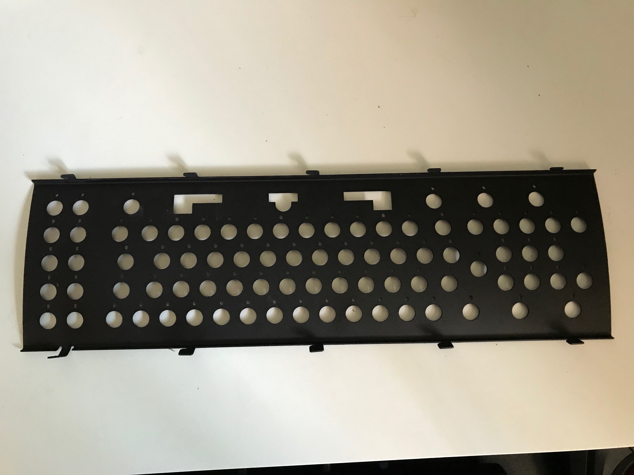

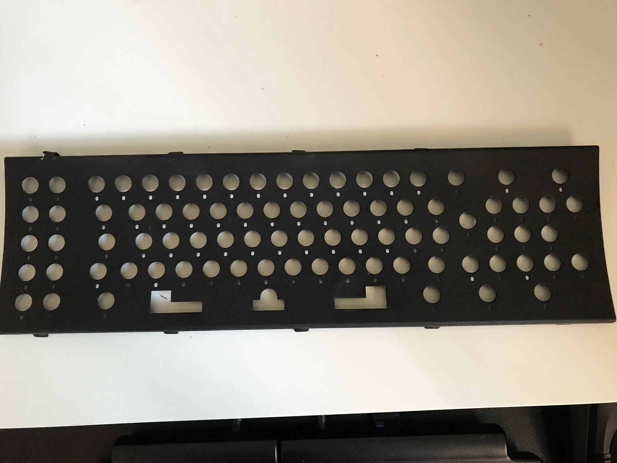

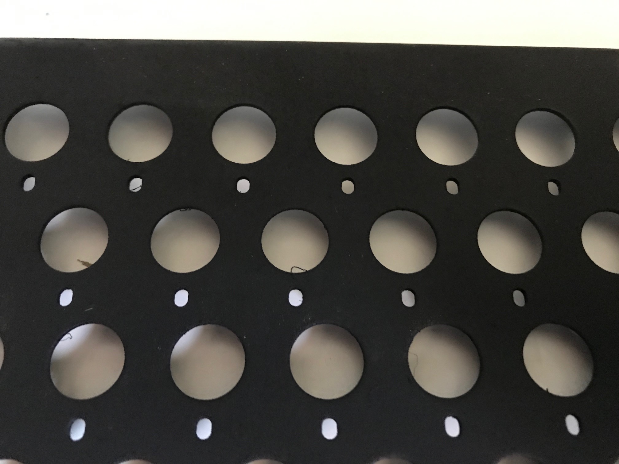

Finished product. Both sides have two coats of black Rust-Oleum Rust Reformer and two coats of black Rust-Oleum Ultra Cover Paint + Primer. No sanding. No wire brush.

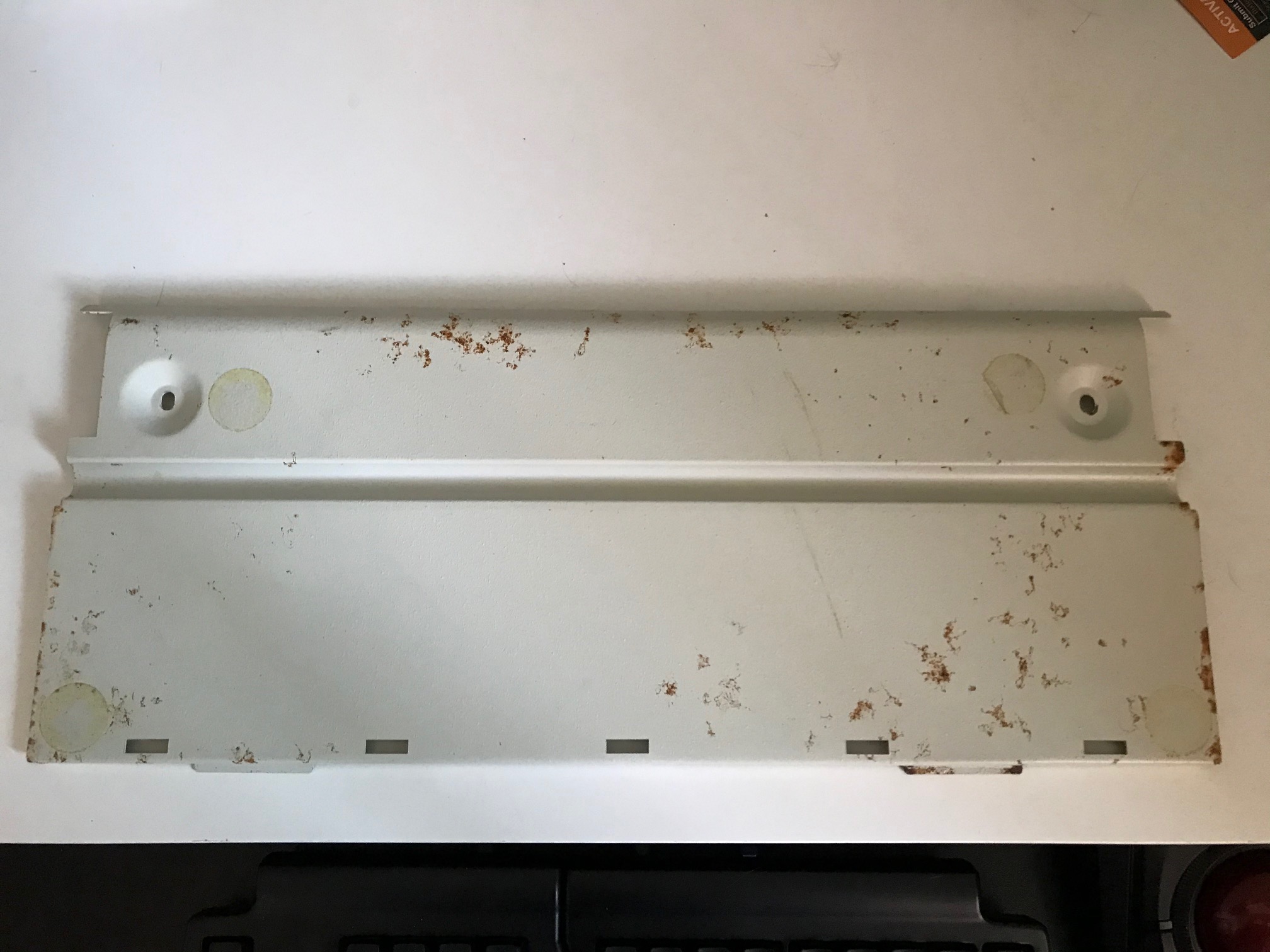

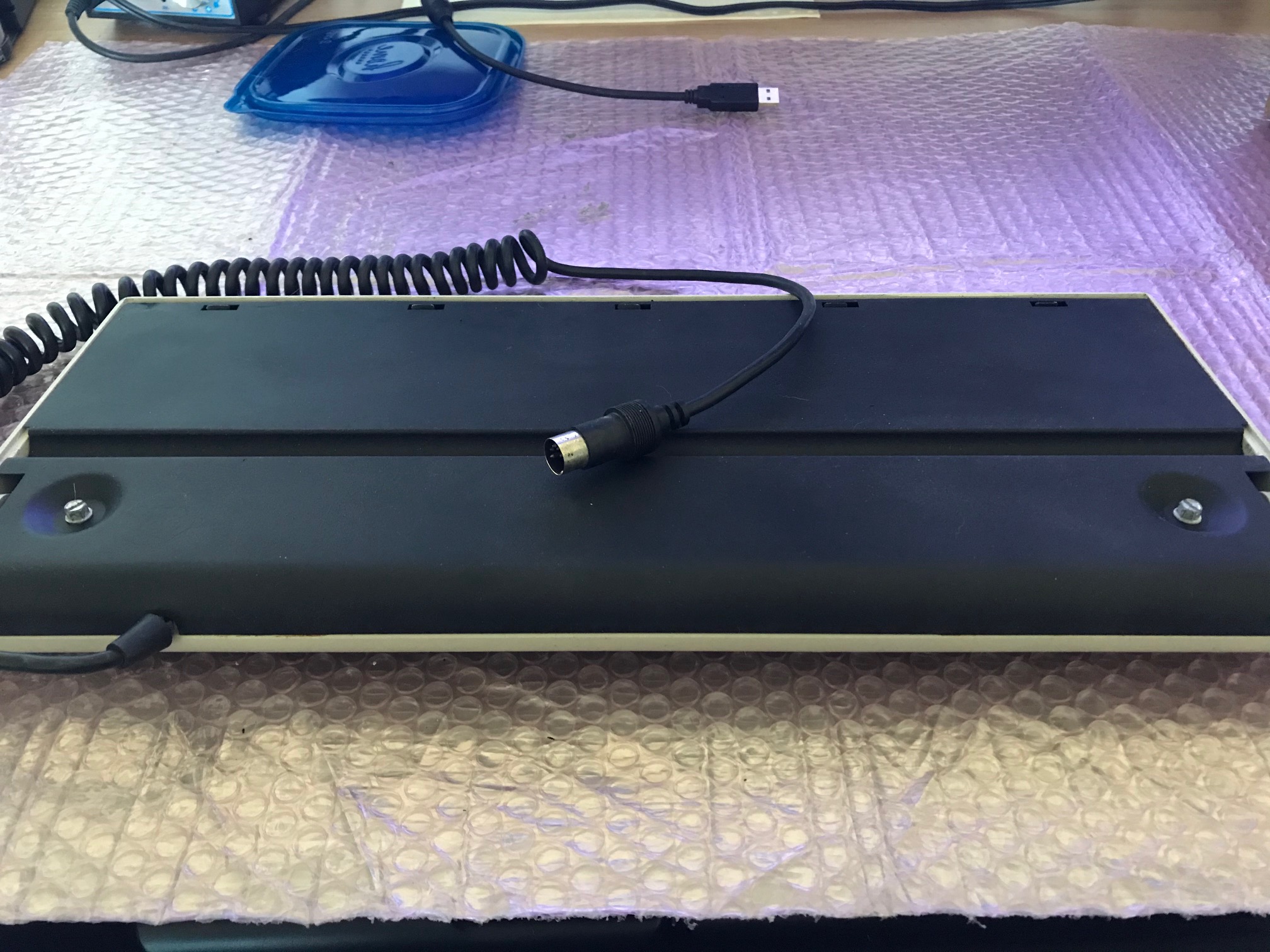

However, I still have to deal with the bottom case. This is how it looks after two days of Evapo-Rust:
In other words, no change at all. So, I'll be sanding that down.

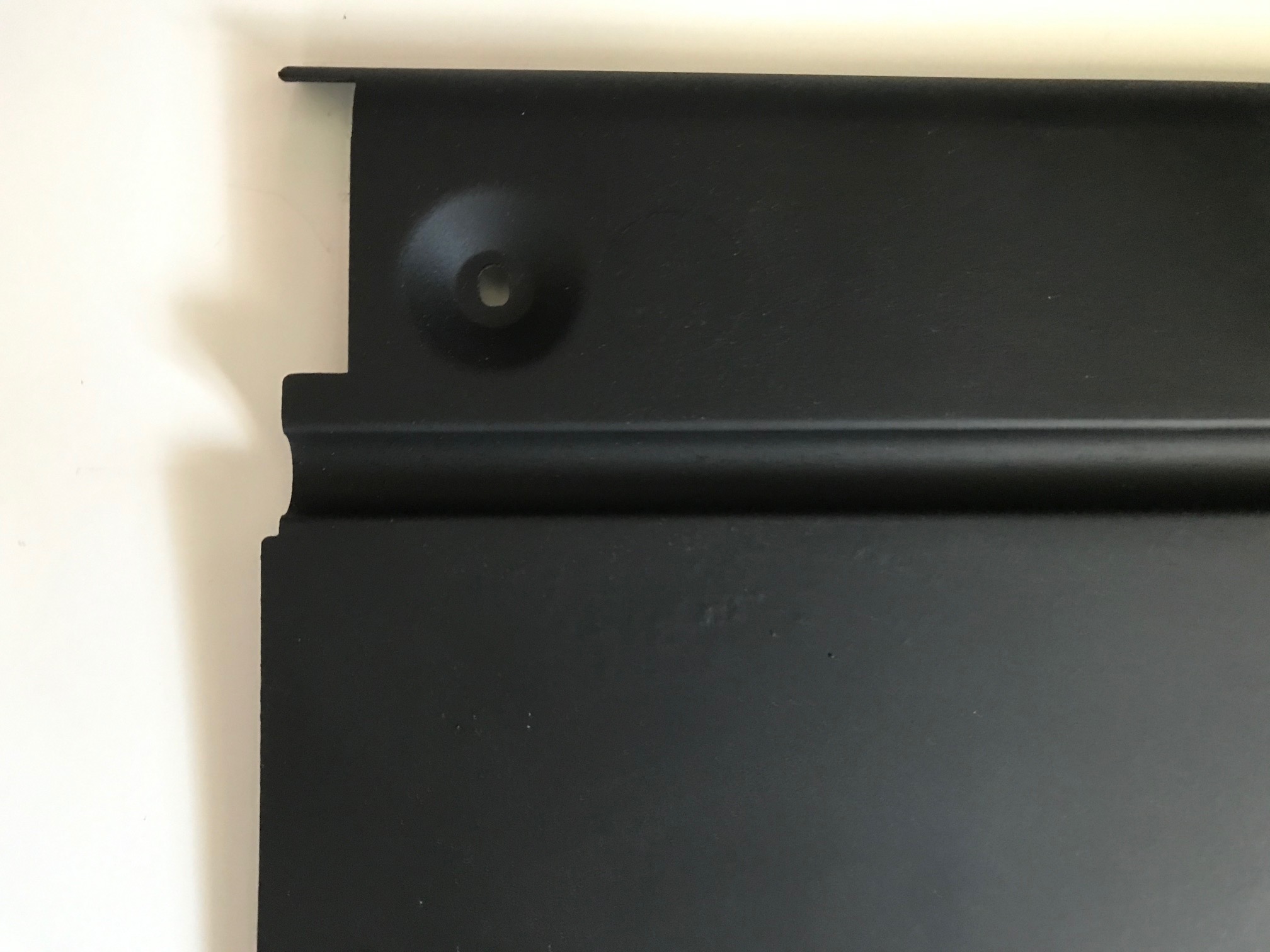

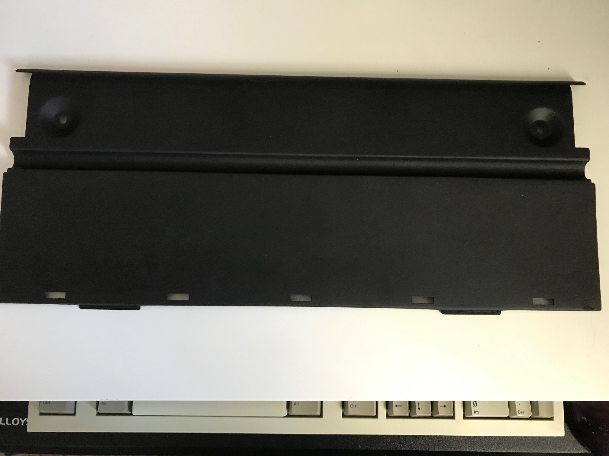

My current photographic area is currently covered by a pan of keys being rest0brighted, so I can't take a picture, but the bottom case responded very well to being sanded with a little Black & Decker "Mouse" detail sander that cost me all of $20. After sanding, I did the same two coats of black Rust-Oleum Rust Reformer and two coats of black Rust-Oleum Ultra Cover Paint + Primer as I did on the barrel plate.
I used black instead of white because I knew I wouldn't be able to match the white case. I'm also relatively sure I've seen Model Fs with black bottom cases.
If this Model F does work as well as it promised when I tried it pre-overhaul and I decide to keep it, I might decide to get several sheets of metal-grade (IDK what they're called) sandpaper for the Mouse sander and maybe some acetone or whatever can remove all the paint, then re-Rust-Oleum and repaint. Now that I have more of a clue what I'm doing, I think I could do a better job.
I should also mention that the paint is matte and not shiny. It's a matter of taste, but maybe an enamel bottom cover would look even nicer.

Thought I'd chime in with my barrel plate before and after too, decided to with a dark 'battleship' grey primer for my finish.
hellothere
18 Jun 2020, 22:21
Here we go! (My adventures in Rest0Bright were interesting and I'll try to post later in a different thread.)
So, a couple areas are a little rough, but it looks very decent overall.
