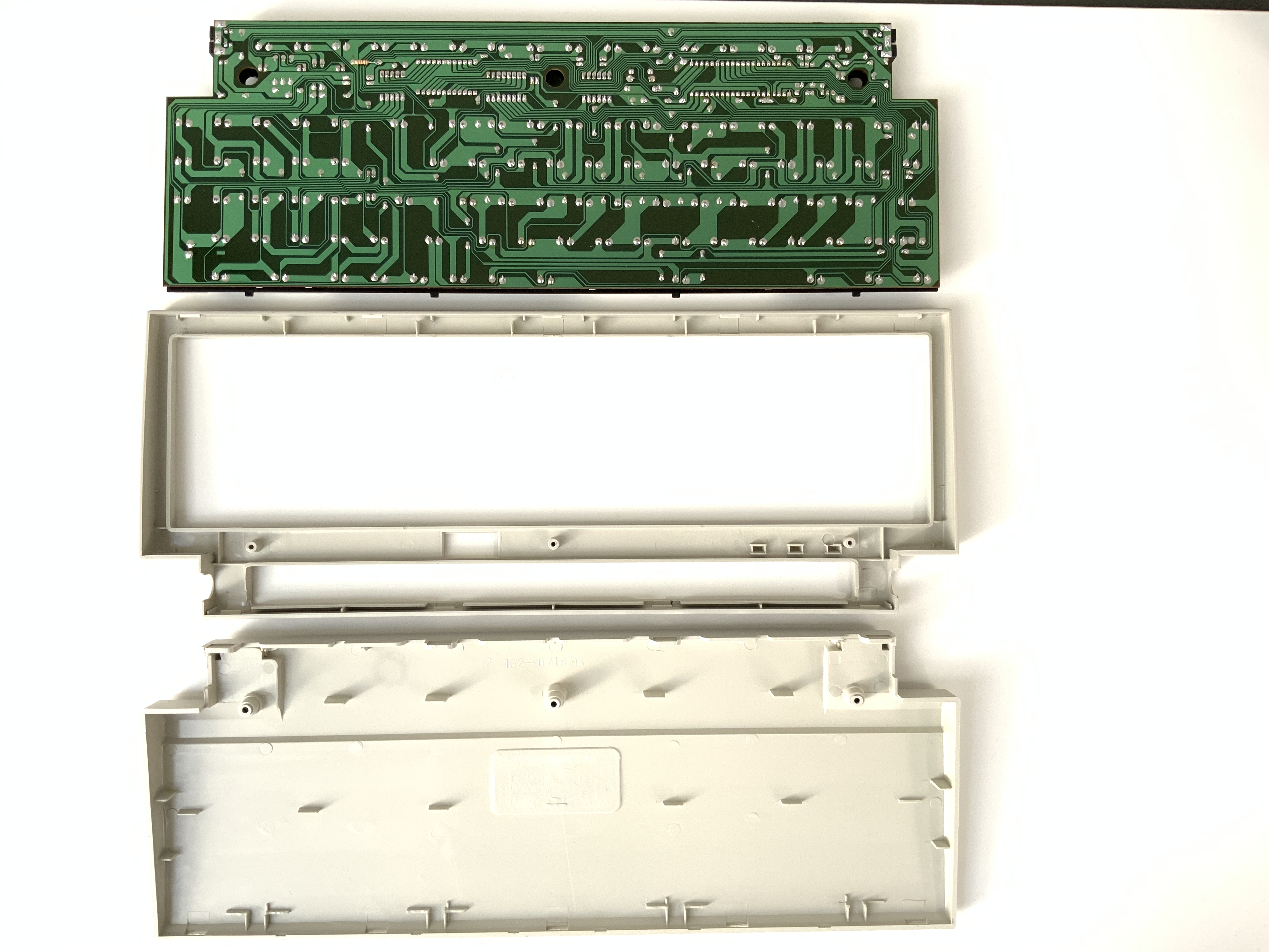

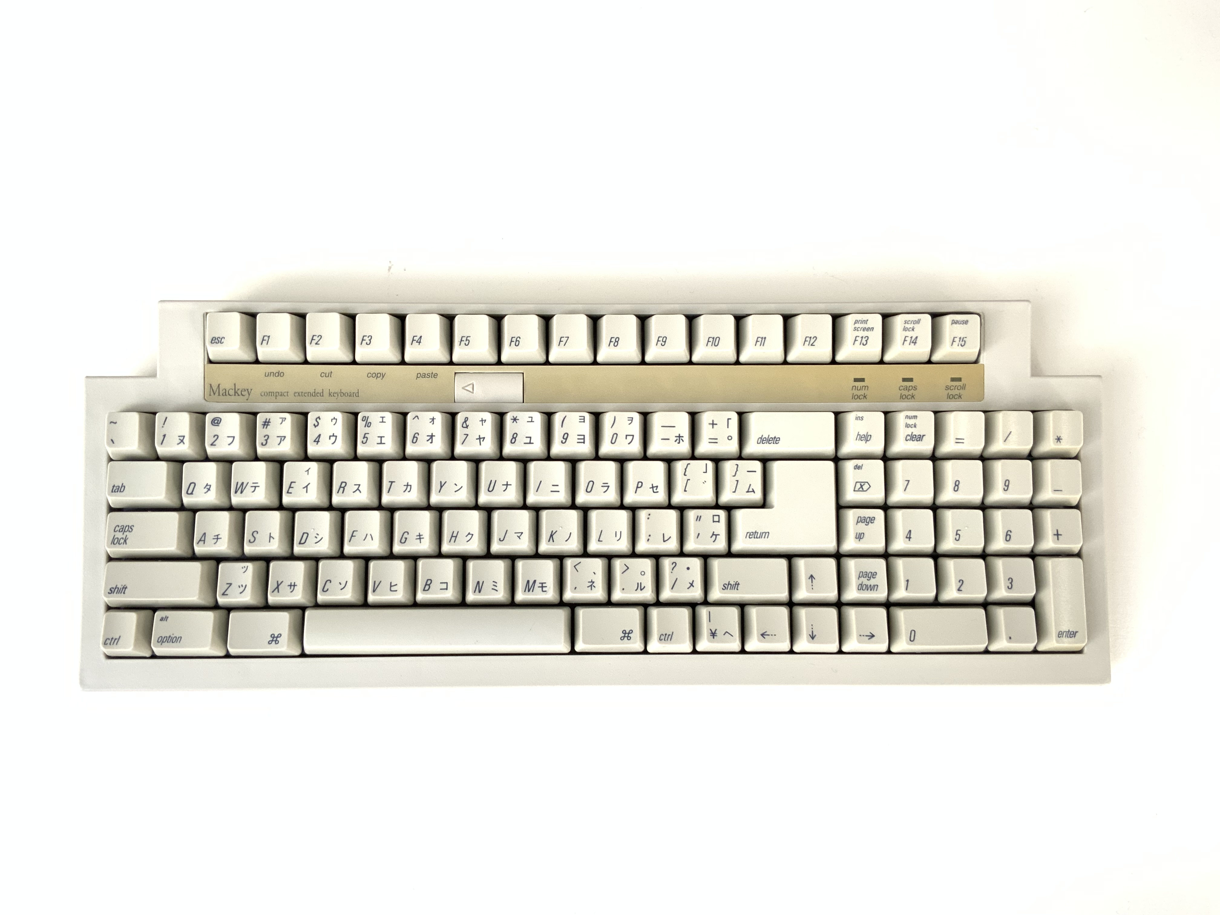

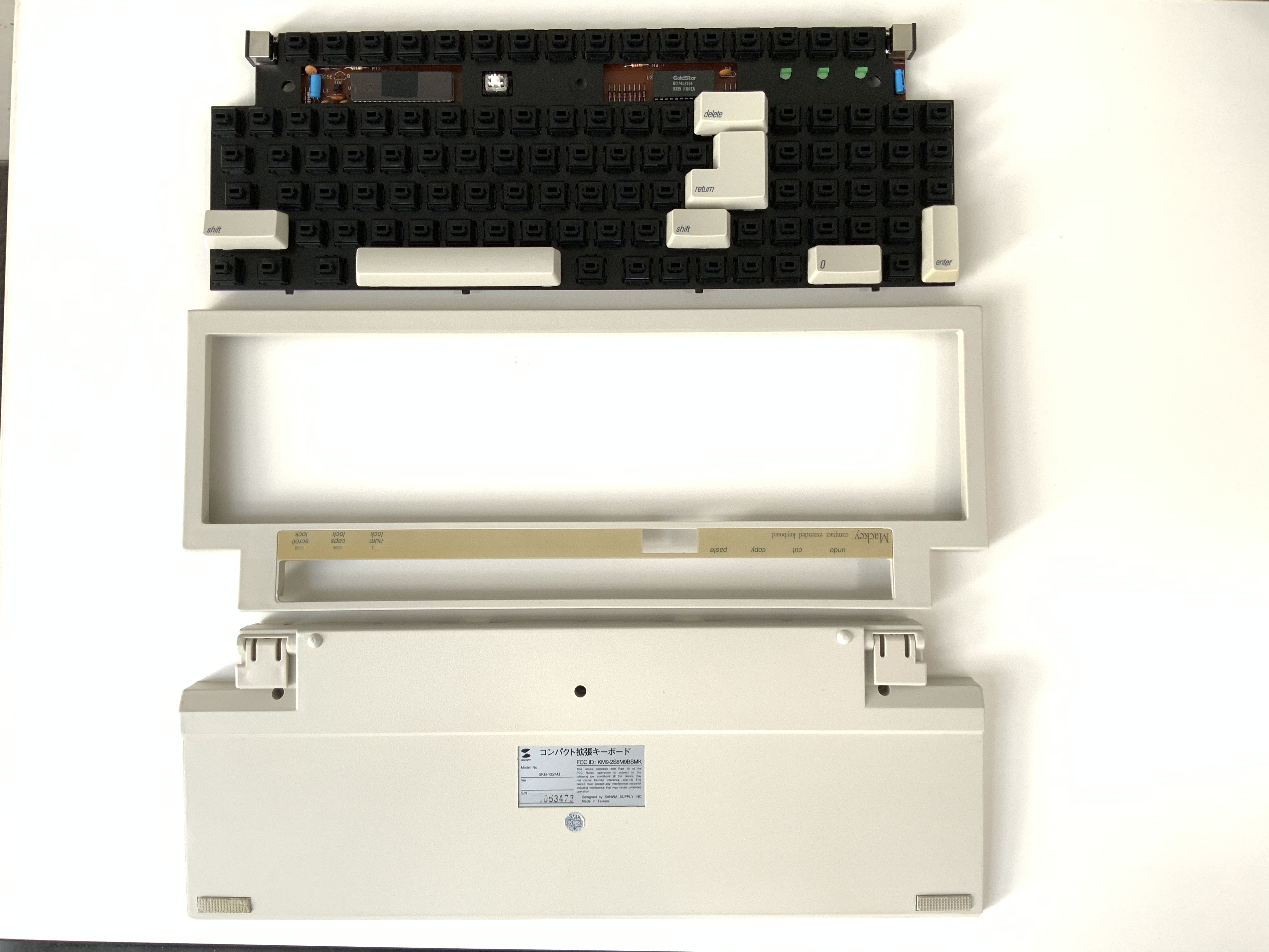

just managed to score an almost immaculate "Mackey compact extended keyboard", ADB interface, model SKB-102MJ. Branded "Sanwa Supply". Sold in Japan, early nineties.
Tip for tearing it apart: you have to pull out the first two lines of keys from top. You then have the possibility to disengage the "master" latches keeping the two clams together.
Plastics are thick and sturdy, but I wouldn't bet they can survive much brute force.

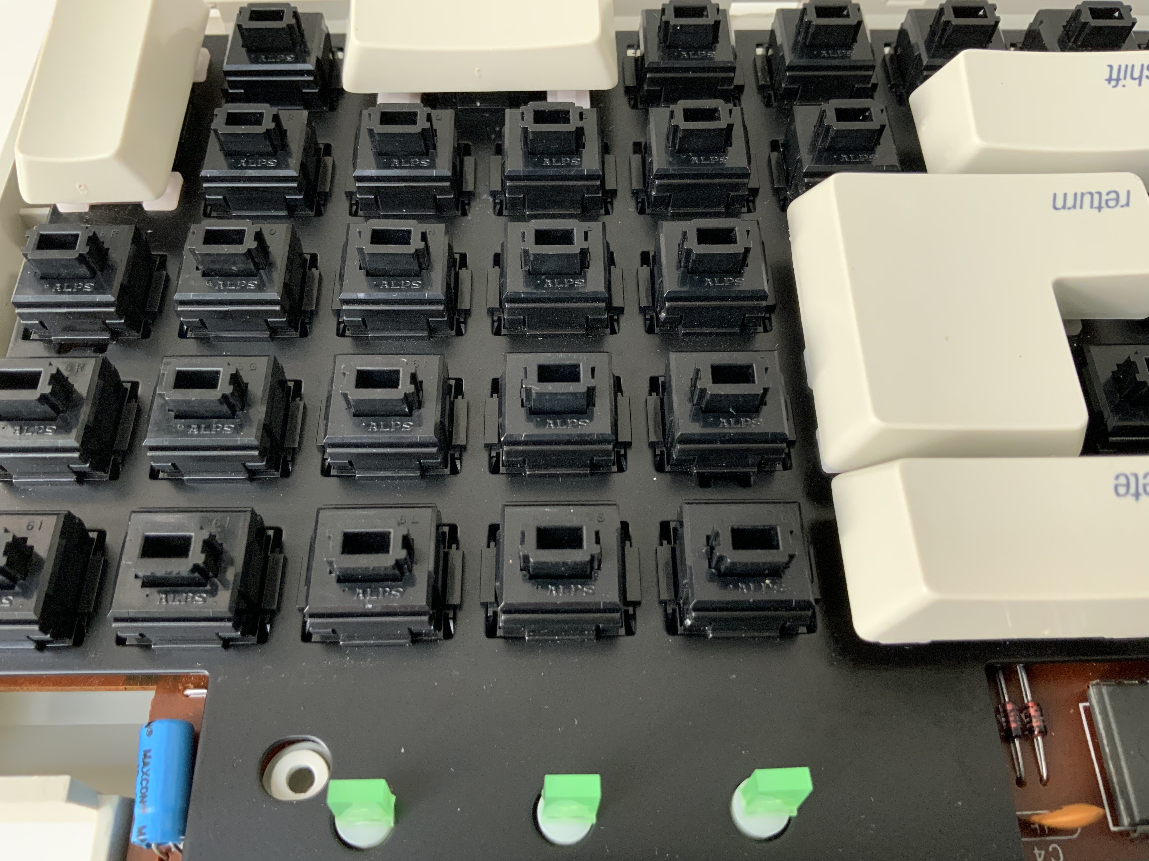

Anyhow, keys are definitely Alps, black, not able to tell the series.
Unit that I got was not fully functional, the ADB connectors were somehow mangled and I had to replace them.
All the rest built so well it didn't need any extra care.
Only the power button feels "out of place", in terms of ergonomics and build quality.
Anyhow, it immediately replaced my Apple Extended Keyboard II as my preferred unit for vintage Macs.
By my tastes, though, a tad too noisy for working in shared spaces.

p_b
23 Jan 2022, 01:43
Thanks for sharing that, especially the tip on opening the case!
You got to disengage the latches at the top working from the inside, it’s much easier, safer for the plastics and you will leave no marks on the visible side. Second line of keys shall be removed as the packaging is so tight that you would not be able to lift the upper frame, as it’s hinged at the bottom.
The three screws are just for securing the board to the bottom shell.
Sounds complicated, but it’s doable.

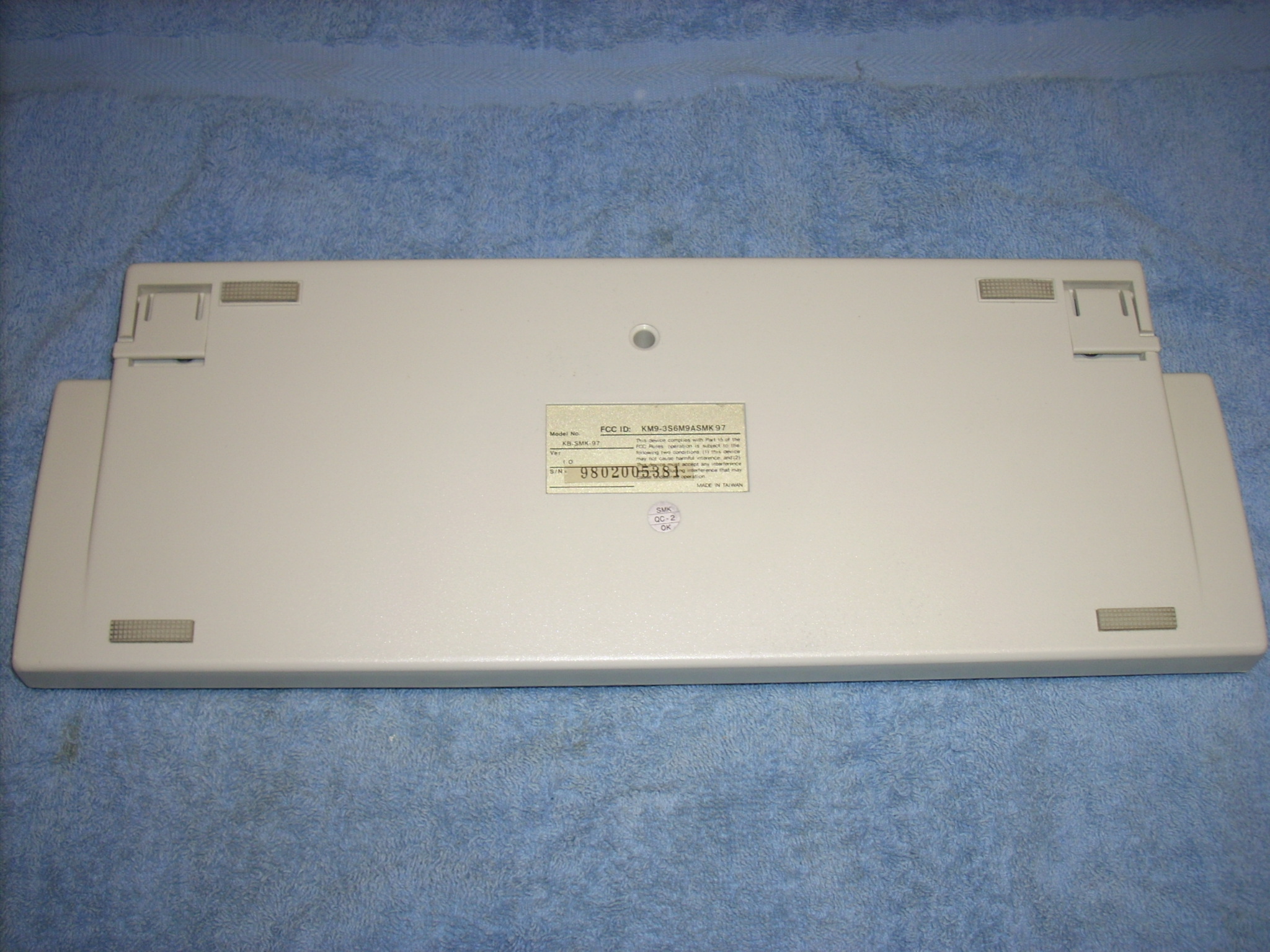

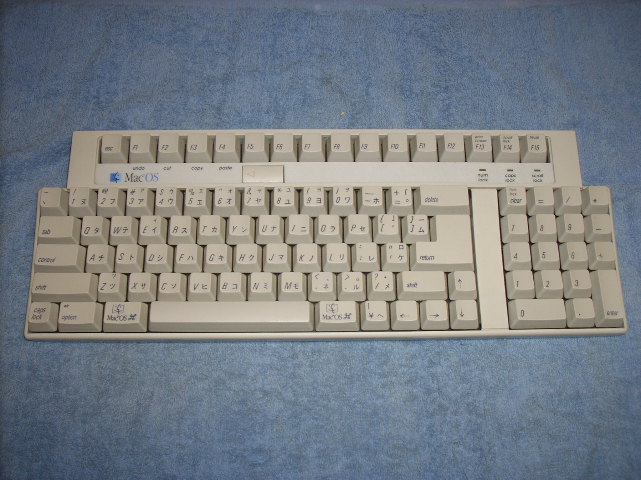

Mine arrived incredibly quickly from Japan. Immaculately clean and unyellowed. Switches are white simplified Alps. Printed caps, as expected. I haven't tested it yet, or tried to open it up (hopefully no reason to), but I'm really happy with it. Here are a couple crappy photos.
edit: Thanks again for the warnings and tips about opening these! I took mine apart today to fix a sticky Return key, and somehow I managed to avoid breaking anything. This one was definitely built after The Cheapening. Without help there's no doubt I would have damaged something. The upper case is two pieces on mine, and the upper part comes off separately after removing the three screws on the bottom, and the tiny screw on the back edge. That one took some persuasion by lifting with an Xacto knife while unscrewing. No clips on the top piece on this one, but I did remove the top row of caps to be sure. The filler between the alpha and numpad blocks had to come off to release and reset the stabilizers on the Return key, and the clips on that seem pretty fragile. I gently pushed the upper tab towards the front edge until it released. I didn't remove the lower part of the upper case, so that will be a future adventure. It's as clean on the inside as it is on the outside, so besides the SKBM switches and the cheap construction it's as good as it could be. Now I need to dig out an old Mac to see if it actually works!

The keyboard seems to work perfectly. CapsLock at the bottom left corner is a bit awkward, I keep hitting it with the palm of my hand, otherwise I'm quite happy with it. Alps SKBM switches are pleasantly pingy, not as subtle or light as early SKCM, but I'm going to leave them in there, for now at least.
