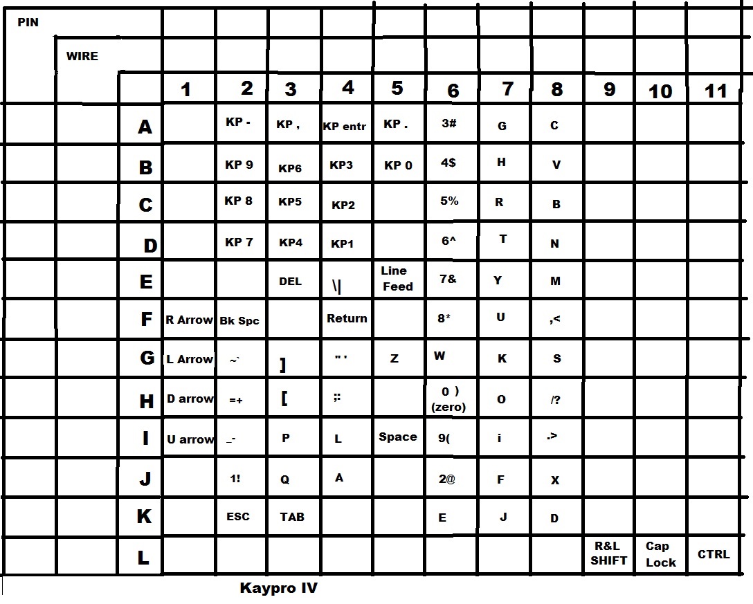

I have a Kaypro II that used vintage (tall stem) Keytonic F&F. Used xwhatsit to convert.
Post here: https://geekhack.org/index.php?topic=92 ... msg2505876
I probably have the IC pinouts for the rows/columns somewhere - if yours is also Keytronic F&F and if that would be helpful.
Also have a Kaypro IV with SMK J-M0404 switches that i converted with a Teensy.
Post here: viewtopic.php?f=7&t=17173&hilit=kaypro
I do have the matrix I came up with for the Kaypro IV (SMK J-M0404 switches):
