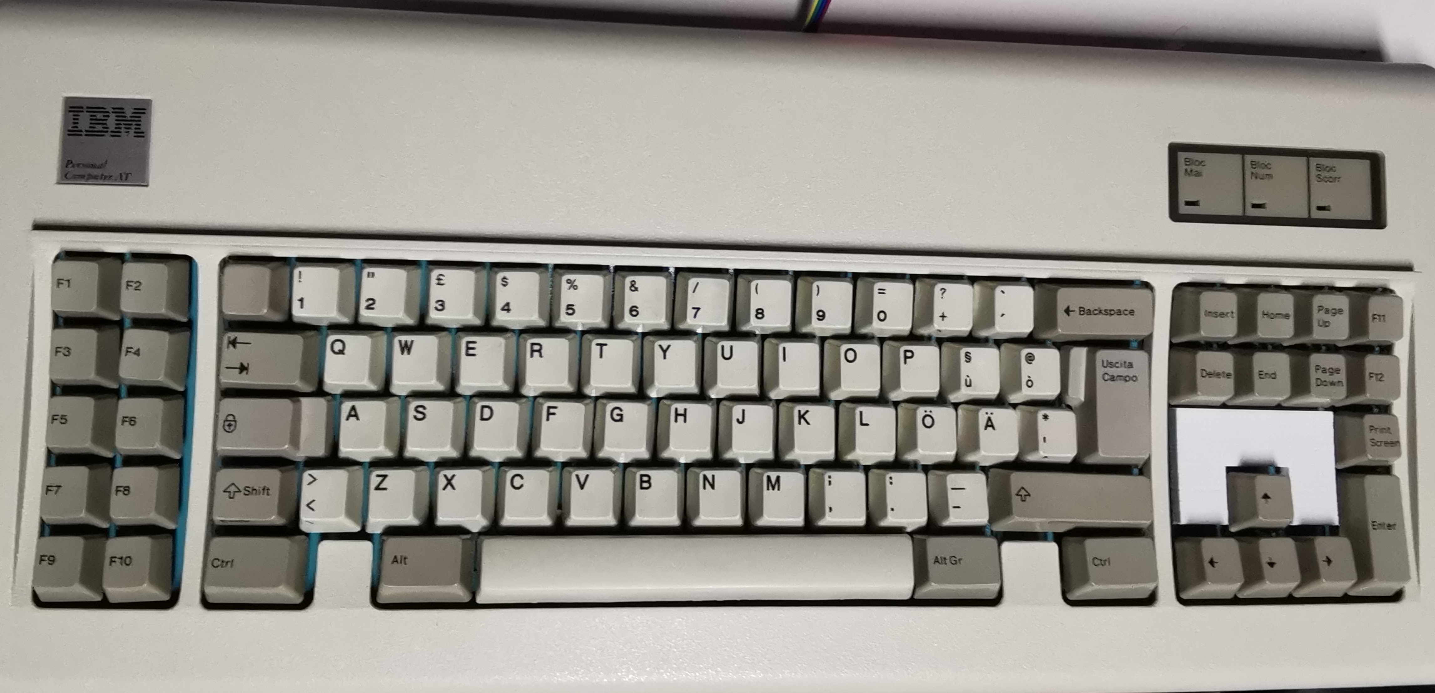

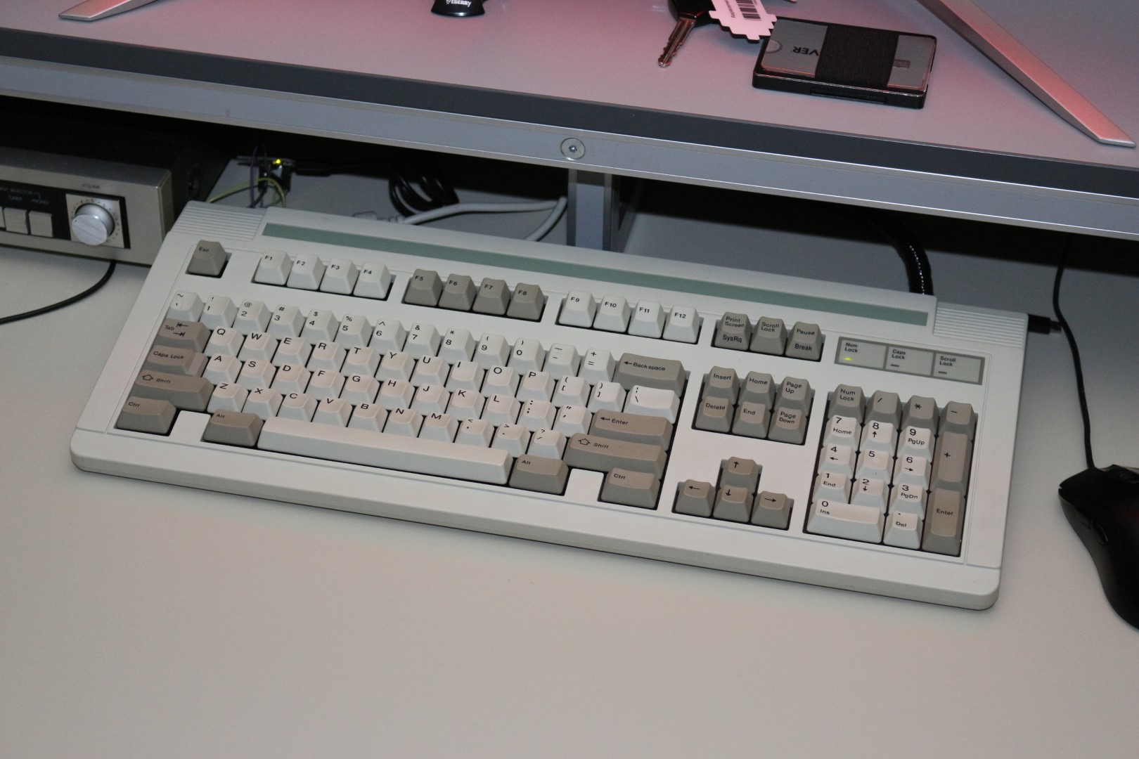

28 Jun 2020, 13:00
I'm in the process of restoring a model f at for everyday use, and was thinking of using this, but i have modified the layout to suit my usage, and have verified, that the following Soarer's remap works:
remapblock
EXTRA_LALT      LALT    # extra pad lhs of space
EXTRA_RALT      RALT    # extra pad rhs of space
EXTRA_EUROPE_2  BACKSLASH       # extra pad lhs of enter
EXTRA_INSERT LEFT       # extra pad lhs of insert
PAD_0 DOWN
PAD_PERIOD RIGHT
PAD_2 UP
PAD_4 DELETE
PAD_5 END
PAD_6 PAGE_DOWN
PAD_7 INSERT
PAD_8 HOME
PAD_9 PAGE_UP
ESC F11
NUM_LOCK F12
SCROLL_LOCK PRINTSCREEN
INTERNATIONAL_2 EUROPE_2
endblock
How could i accomplish this with the tmk keymap editor?
hasu
29 Jun 2020, 01:29
I think if you do some trial and error on Keymap Editor you will know how to use it somehow.
What's your problem actually?
That remap looks to me really straight, though, I don't know much about how Soarer's remap setting works. You may need to explain me what you want.
frogmaster
29 Jun 2020, 09:14
Well for start, EXTRA_INSERT (0xb6) is missing from numpad (should be left of NUMPAD 0). What is the button i should select on the editor? Also, what are these mapped as on keymap editor keyboard? I was trying to grep these values in ibmpc_usb.c, but only one that showed up was 0xB6, which seems to be ignored in process_cs1, i don't know if it's the right place to look, or if the values should match with soarer's documentation.
Excerpt from soarer's codes:
EXTRA_LALT	0xB1	AT-F extra pad lhs of space
EXTRA_PAD_PLUS	0xB2	Term extra pad bottom of keypad +
EXTRA_RALT	0xB3	AT-F extra pad rhs of space
EXTRA_EUROPE_2	0xB4	AT-F extra pad lhs of enter
EXTRA_BACKSLASH	0xB5	AT-F extra pad top of enter
EXTRA_INSERT	0xB6	AT-F extra pad lhs of Insert
hasu
29 Jun 2020, 10:19
frogmaster wrote: 29 Jun 2020, 09:14 Well for start, EXTRA_INSERT (0xb6) is missing from numpad (should be left of NUMPAD 0). What is the button i should select on the editor?
First, flash firmware downloaded from Keymap Editor(without edit mapping). Then press the key on your keyboard to know what it registers on computer, you will need tool like Switchhitter or Aquakeytest often.
You should find a logical 'key' corresponding to what the keyboard registers on Keymap Editor, it is what you want to edit.
The keymap editor uses TMK specific codes(unimap code) internally to mapping keys, they won't match Soarer's specific internal defined codes(I think they are extended USB HID codes) or IBM XT scan codes.
0xB6 is not IBM XT scan code, Soarer's code. So it should be handled release code of 0x36, to be exact.
To know what scan code the key actually spits out you can use hid_listen tool with Soarer's or TMK converter.
hasu
29 Jun 2020, 10:26
What is your keyboard model? You refered only 'model f'.
Which key are you refering? Posting pic is helpful.
"EXTRA_INSERT (0xb6) is missing from numpad (should be left of NUMPAD 0)."

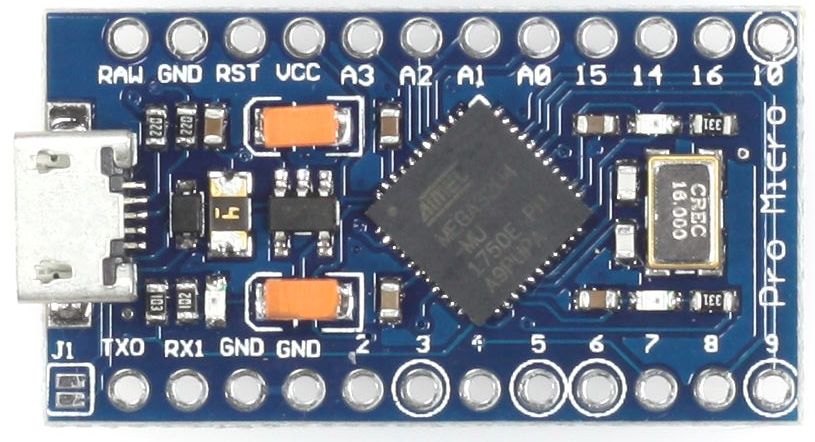

bsdice
29 Jun 2020, 13:26
Hey there,
I just built a TMK ps2_usb converter out of this Pro Micro clone from ebay:
At first I contemplated just buying a converter from anywhere, but I could already smell bugs with ISO-DE layout and non-configurability even before hitting the Buy-button. So I went with this. For better results I tweaked the whole setup a little:
  • Desoldered MIC5219 voltage regulator (the 5-legged IC), 2x 10uF (orange pieces), diode D2 (middle and right next to USB socket SMD pins). I recommend watching https://www.youtube.com/watch?v=CVsmwFAkf7I for good results without hot air.
  • Bridged J1, bridged the D2 pads. This connects USB 5V straight through to RAW and VCC pins.
  • Put a 105°C 5000h 10uF Europe Chemi-Con excellent quality "KY"-type electrolytic cap on RAW+GND (polarity is important) to replace the cheap tantalum caps' function. As a personal preference I don't like failing cheap tantalum or electrolytic capacitors.
  • Didn't need pullups on PS/2 CLK+DATA, so I left those out. Your boards may be different.
Since I wanted 100% control of bootloader I chose "Katiana" as bootloader from here https://github.com/m-kozlowski/Katiana with the following modifications:

I really forgot often to write make -f Makefile.32u4 so I modified the main Makefile instead. Modified USB VID/PID to be Sparkfun Pro Micro sketch ID (bootloader + 1). In unimap_plain.c there was a bug imho, should read UNIMAP_PS(...) for alternative layer. Also it took me a while to figure out that the Windows menu key (left of right ctrl) is used as a layer selector. Modified this layer to my liking, ymmv. For compatibility with Katiana bootloader I then edited the bootkey to be written at location RAMEND-1 and not 0x800. Finally edited "unknown" to read "Pro_Micro" in magic version output.
I flashed everything with USBASP adapter with firmware by PeterVH https://github.com/PeterVH/usbasp/tree/v1.06. Even bought two adapters, one to update the other. For reference (you should read out the original firmware first always and also check the fuses to be correct):
avrdude -v -c usbasp -p m8 -e -Ulock:w:0x3f:m -Uhfuse:w:0xd9:m -Ulfuse:w:0xef:m -Uflash:w:usbasp-v1.06-atmega8.hex:i
To flash everything (bootloader and sketch in one go) I use avrdude:
avrdude -v -c usbasp -p m32u4 -e -Ulock:w:0x3f:m -Uefuse:w:0xcb:m -Uhfuse:w:0xd8:m -Ulfuse:w:0xff:m -Uflash:w:Katiana.hex:i -Uflash:w:ps2_usb_32u4.hex:i -Ulock:w:0x2f:m
Later when you want to update the sketch using LAlt+RAlt+Pause key combination and within the following 8 second interval when bootloader waits I used:
avrdude -v -c butterfly -P /dev/ttyACM0 -p m32u4 -Uflash:w:ps2_usb_32u4.hex:i
As you can see avrdude here uses a different protocol and device "ttyACM0" which appears for 8 seconds after the magic key press. Very very handy especially if everything is boxed up or even integrated in a keyboard.
Finally big kudos to all authors of the employed softwares, and especially hasu: Open source at its finest!

Thanks hasu, got it to work. If someone get's stuck with modified IBM Model F AT 84-key, then i did the following remaps, i used 32u4 full-key keymap editor:
To get ISO enter, ISO left shift and standard caps, ctrl, alt positioning
LEFT -> ISO #
ISO # -> LEFT
INSERT -> RALT
LGUI -> LALT
RCTRL -> CAPS
CAPS -> RCTRL
LALT -> LCTRL
LCTRL -> CAPS
Hiragana  -> ISO \
For numpad to navigation cluster mapping:
ins | home | pg_up | F11
del | end  | pg_dn | F12
    |      |       | printscr
    | up   |       |
left| down | right | enter
used the following:
P / -> F11
P * -> F12
P - ->  PRINTSCR
P + -> ENTER
ESC -> INSERT
P7 -> DELETE
P8 -> END
P9 -> Page Down
Num lock -> HOME
Scroll lock -> PAGE UP
It would be much simpler to edit the 84-key instead of the Full-key, if it wasn't for couple of missing keys, present on ibm pc at keyboard pcb, but not on the layout itself.
Just for reference, when watching hid_listen, where can i look up, what the particular r<code> corresponds with, for example, i get r1C when pressing a, where can i look that up?

frogmaster,
Oh, AT keyboard. I assumed your keyboard is XT becasue you refered process_cs1.
I didn't realize missing keys on AT editor but I'll add them.
The misssing keys are 39 and 68 in scan code? Is there any other?
https://www.seasip.info/VintagePC/ibm_6450225.html
And can you post pic of your keyboard to show how it was modified?

bsdice wrote: 29 Jun 2020, 13:26 Hey there,
Try new IBM PC Keyboard Converter(ibmpc_usb) ! This thread is for it :D
Solder bridging J1 is just enough if you use VCC pin for power, not RAW?
This is my thought on Pro Micro power line.
https://github.com/tmk/tmk_keyboard/wik ... der-bridge
And its schematic for reference.
https://github.com/tmk/tmk_keyboard/wik ... #schematic
bsdice
01 Jul 2020, 09:03
hasu wrote: 01 Jul 2020, 07:51Try new IBM PC Keyboard Converter(ibmpc_usb)
Anything particular advantageous with ibmpc_usb for PS/2 keyboards over ps2_usb?
hasu wrote: 01 Jul 2020, 07:51Solder bridging J1 is just enough if you use VCC pin for power, not RAW?
I am using RAW+GND at the edge to replace cheap tantalums with better through-hole electrolytic capacitor.
As for desoldering the voltage regulator, I was skeptical with regard to parasitic current or oscillations, so I got just rid of it. I ever only use Vusb here and that is 5V.
frogmaster
01 Jul 2020, 22:04
hasu wrote: 01 Jul 2020, 07:25 frogmaster,
List of missing keys in AT 84key, for me at least, (in brackets is what i get when flashing clean unimap.hex):
39 (insert) right of space, to be used as RAlt
53 (left) left of enter, to be used as ISO #
68 (ISO #?) left of P0, to be used as left
KB as modified:
hasu
02 Jul 2020, 04:41
frogmaster,
Interesting. I understand how the numpad part is configured now.
Added the keys to keymap editor. It should make easier to remap hidden keys of IBM AT keyboard.
Can you try this? You can load your existent firmware file at "Base Firmware File:" section and the editor should display your mapping correctly.
http://www.tmk-kbd.com/tmk_keyboard/edi ... mpc_usb_at
Could you post hid_listen log output of starup?
I'd like to check how the converter recognize the keyboard.
Also LED indicators works well?
frogmaster
02 Jul 2020, 08:51
hasu wrote: 02 Jul 2020, 04:41
Brilliant, thank you, the LED indicators also seem to work fine, managed to get them all to light up with onscreen keyboard.
hid_listen output:
TMK:0ab0ebf8/LUFA
USB configured.
Keyboard start.
I706 wFF rFA A1711
PRT:10 ISR:FE90 rAA W2049 wF2 rFA R3052
ID:0000(2) S3052 wED rFA w00 rFA L3058
hasu
02 Jul 2020, 10:31
frogmaster,
Thanks for your feedback!
It looks ok, the keyboard is recognized as expected.(AT protocol with Scan Code Set 2)
