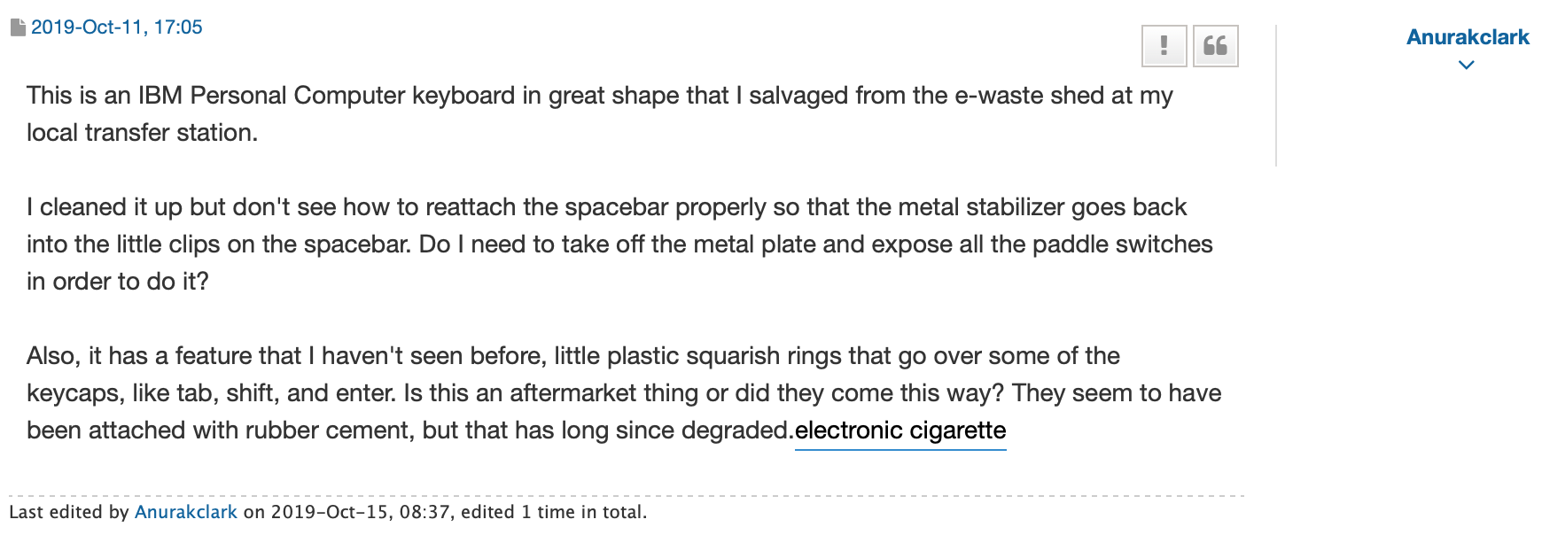

Anurakclark wrote: 11 Oct 2019, 18:05 I cleaned it up but don't see how to reattach the spacebar properly so that the metal stabilizer goes back into the little clips on the spacebar. Do I need to take off the metal plate and expose all the paddle switches in order to do it?

Anurakclark wrote: 11 Oct 2019, 18:05 Also, it has a feature that I haven't seen before, little plastic squarish rings that go over some of the keycaps, like tab, shift, and enter. Is this an aftermarket thing or did they come this way? They seem to have been attached with rubber cement, but that has long since degraded.

hypkx wrote: 25 Nov 2019, 13:21 Quality spam post.
Don't reply to them: report! I'm tempted to report your post too!
Honestly though: it's just a button. Right there. Just for this purpose.
Edit: Actually, well noticed, I didn't realise it was a sneaky late edit. Great spot!

Note the dates: this was several posts further back in the thread. Actually: the OP! And the spammer came back to edit in their payload after several days. Bastard.
Bet there's more of these lurking in old threads now. I just did a forum search for "cigarette" and didn't find any more similar to this one. But dumb repetitiveness may well be the way we can beat these spammers. Whenever we spot something, look for earlier incidents!
Edit2: Ha! Here's the original thread they simply cloned.
