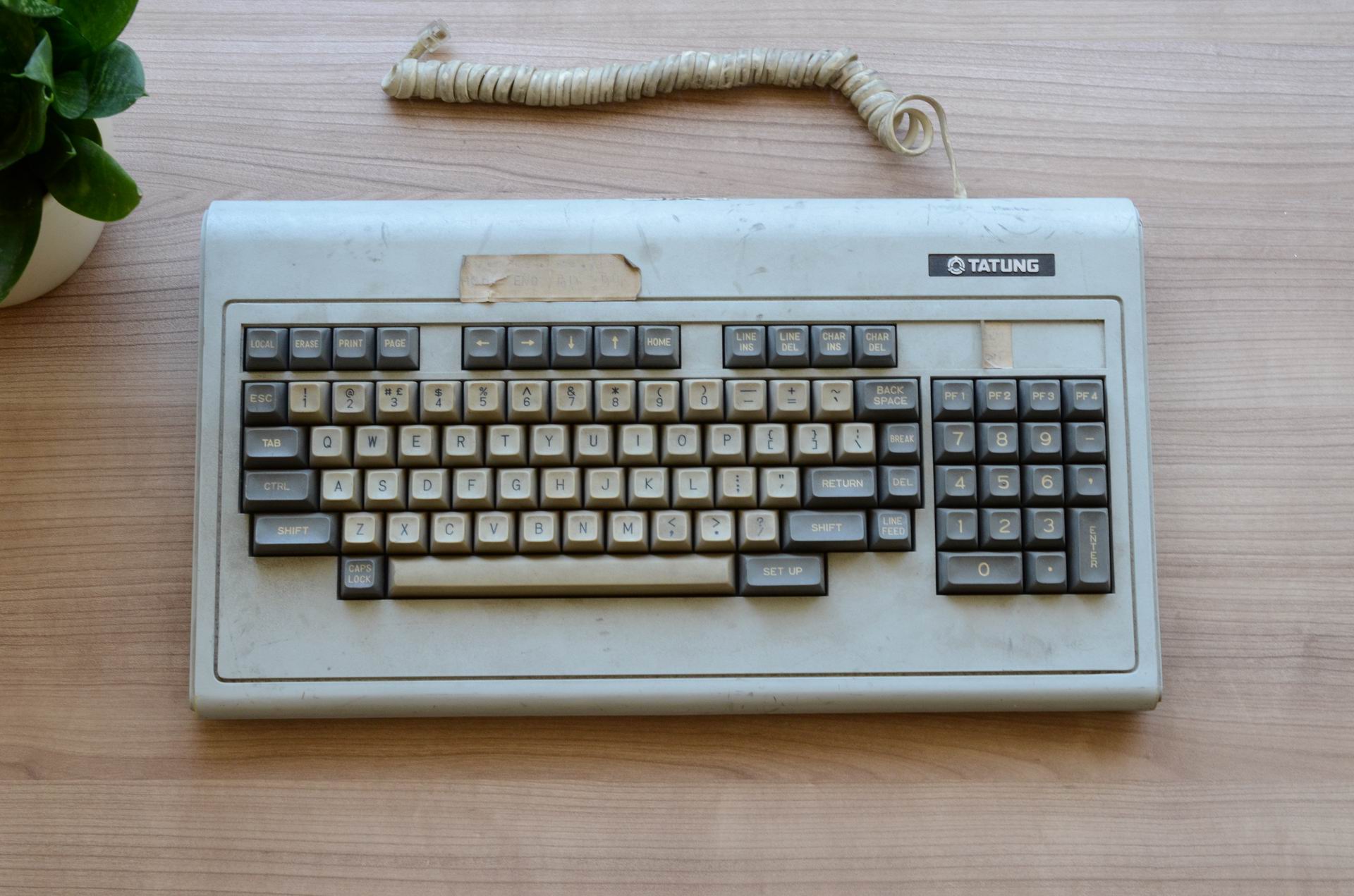

This is the board I have started to clean:

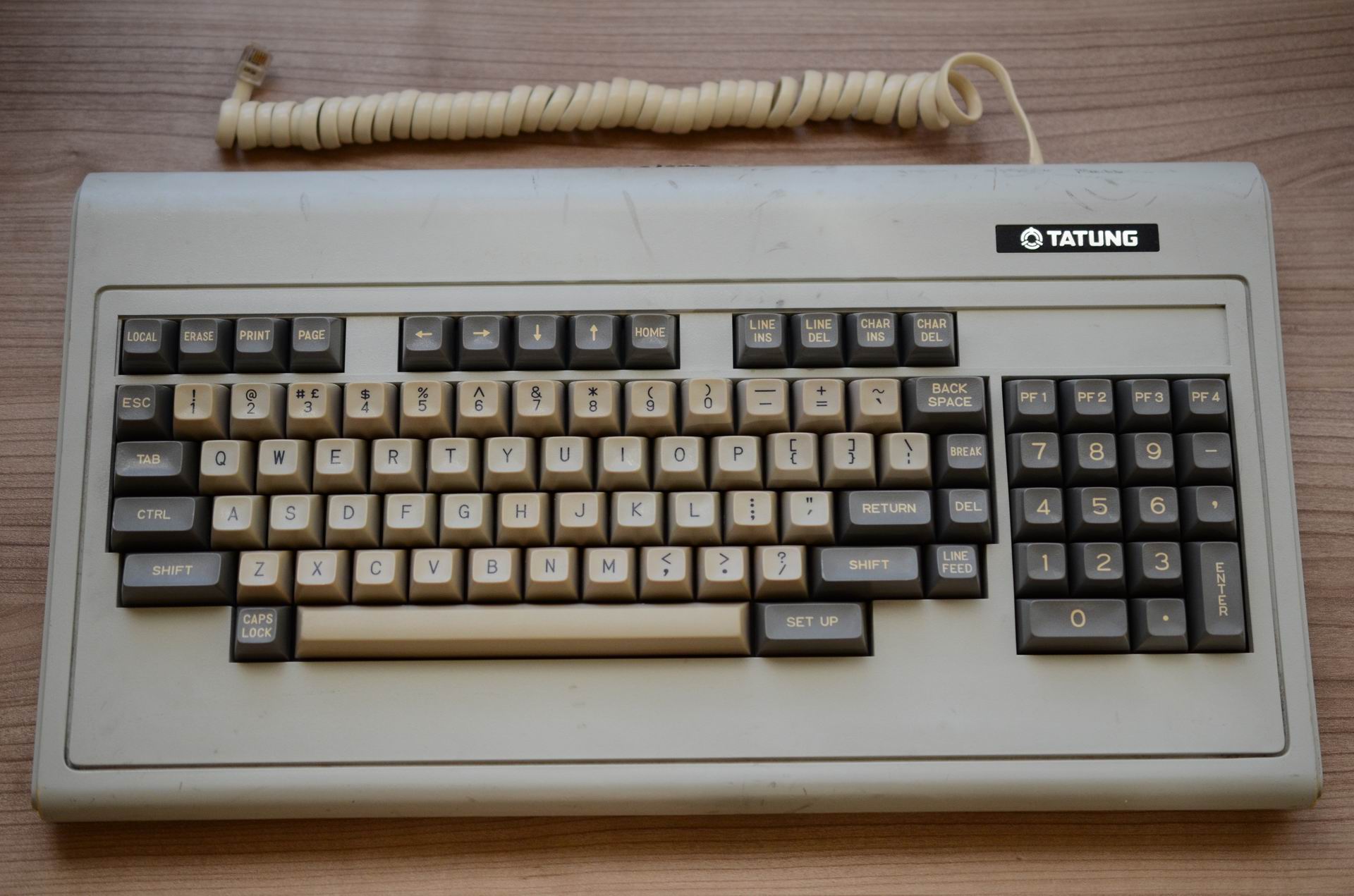

This is the result so far:

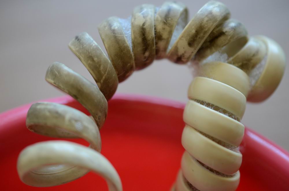

I'm fairly happy with how the cable responded to the treatment...
...but the same method (warm water + liquid soap, alcohol, toothbrush) doesn't work on the case. There are some scratches, but most of the stains seem to be the result of the dirty cable being wrapped around the board.
Any suggestions?

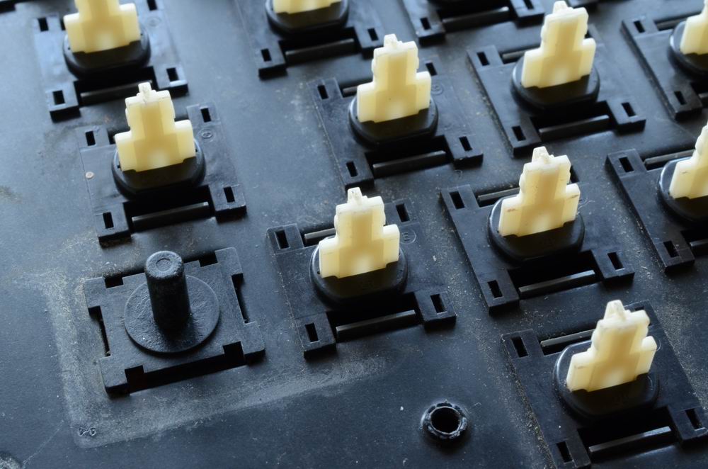

Thanks! I'm not really familiar with these kind of old switches, but here is a pic:

Some old cables can be very nasty indeed. My IBM Model F AT had a cable that had turned sticky, which I was happy to remove. I’ve seen them leave permanent indentations and marks on other keyboards. It just comes down to chemistry. A lot of evil reactions can go on, in years of storage.
The switches look like Alps vintage T. The same as on the 1984 Macintosh keyboard. Linear, loud, and a bit stiff; but with vintage charm.

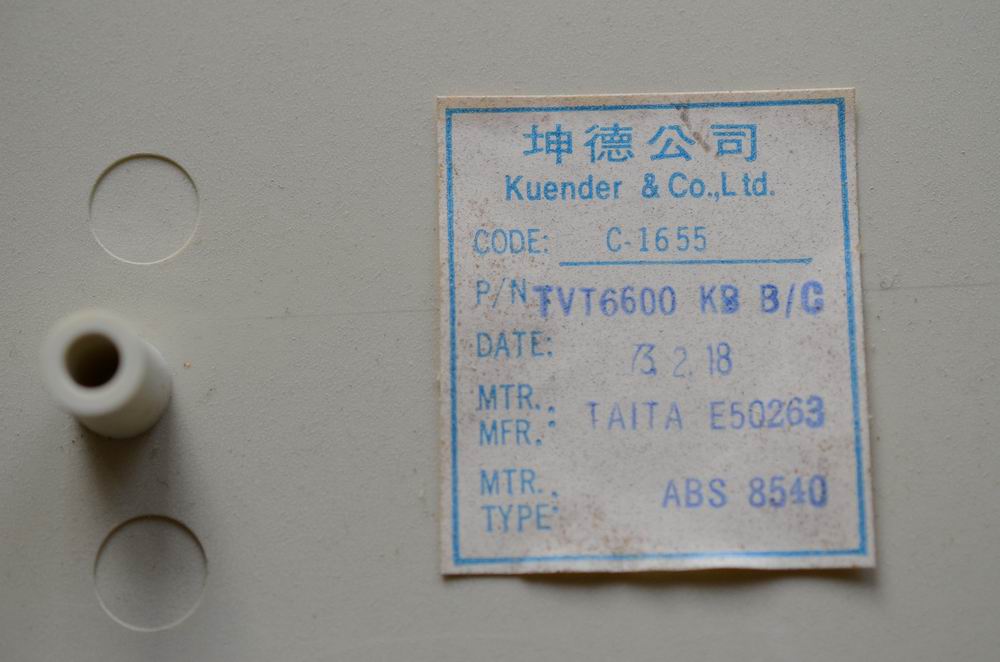

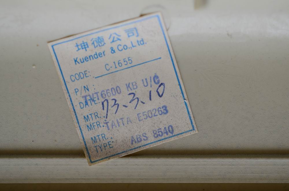

dovenyi
23 Sep 2019, 17:10
This one is from the upper part of the case.
And this one from the lower part.
Now I know this means 1984. Never thought of that, thank you!
