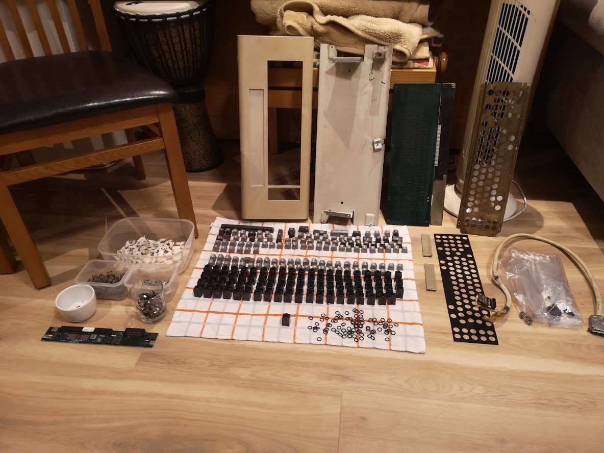

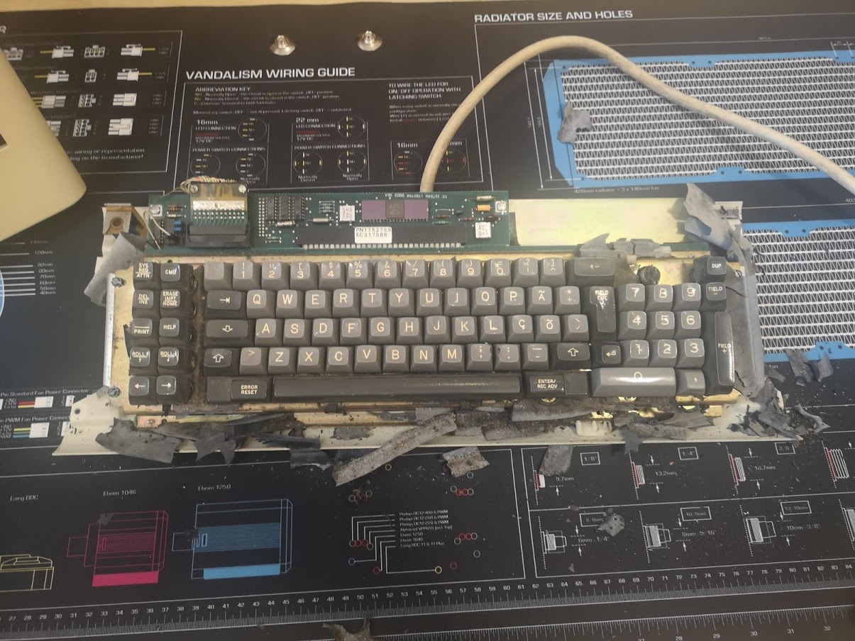

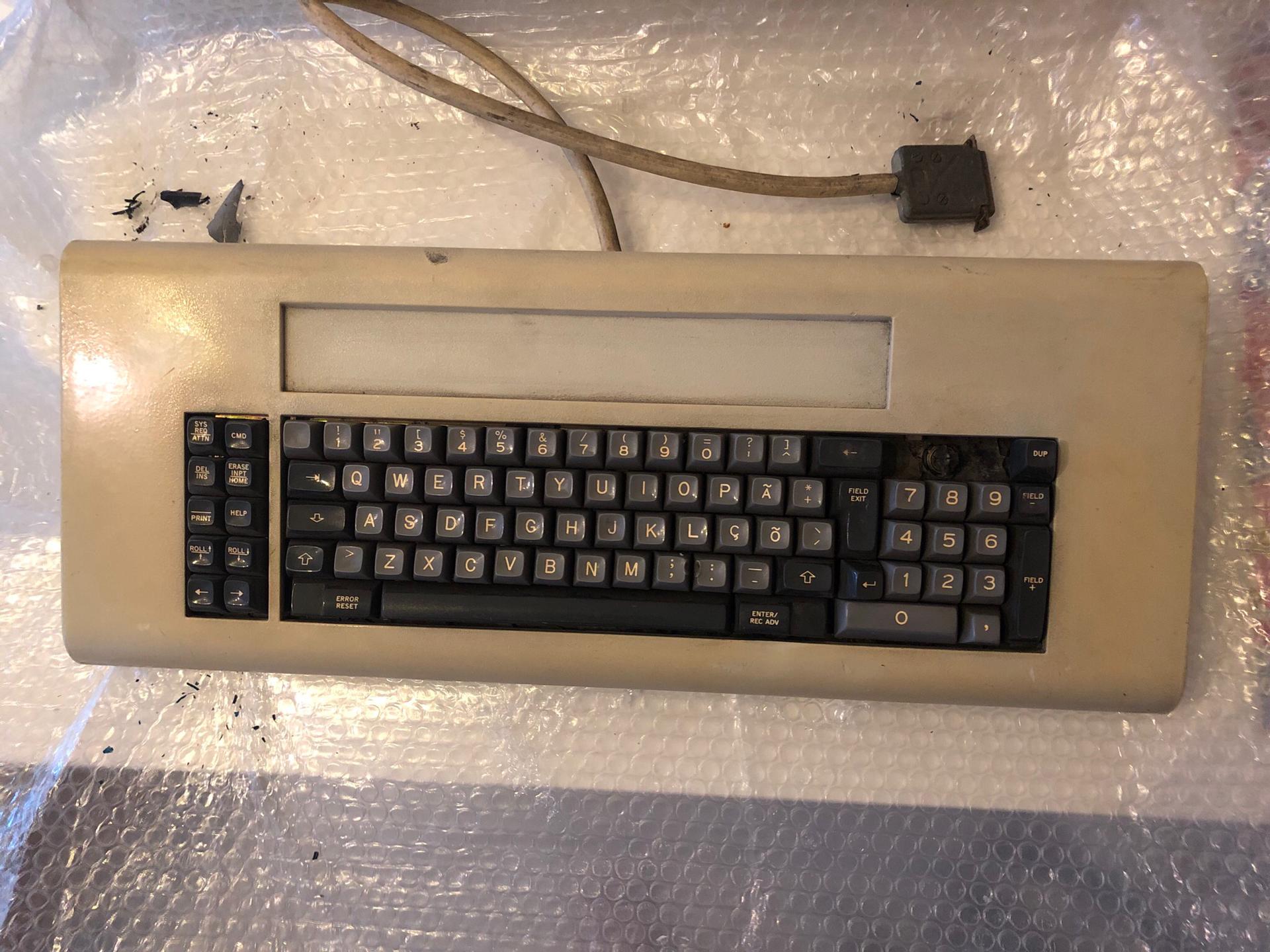

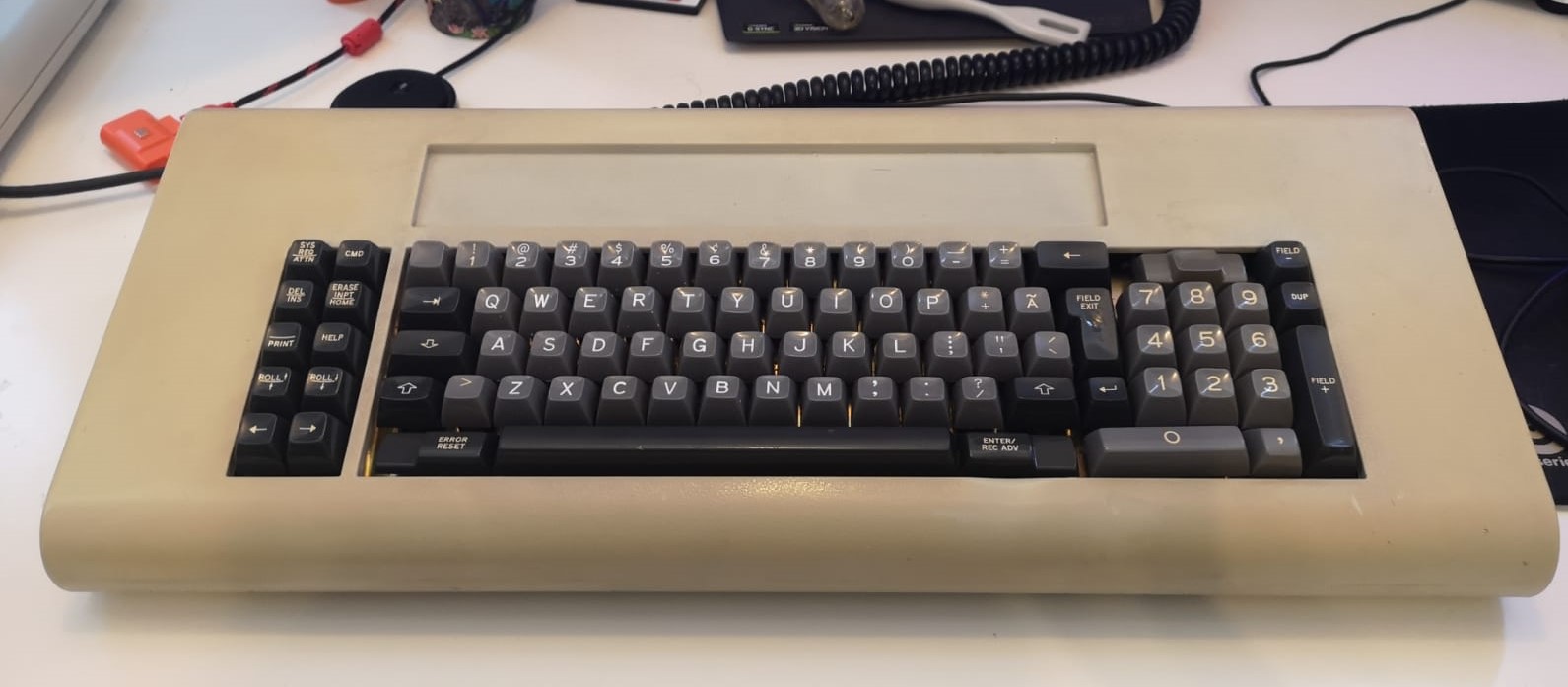

Hey guys so finally I have been able to source an IBM Beamspring Keyboard for a sub $1000 price. The keyboard needed a fair amount of work so here is the restoration log on the keyboard please let me know what you think.
How the Keyboard looked when I first received it.
How the keyboard looked when I first got it.jpg (316.79 KiB) Viewed 9601 times
Top case removed.
How the keyboard forst looked when top case removed.jpg (258.2 KiB) Viewed 9601 times

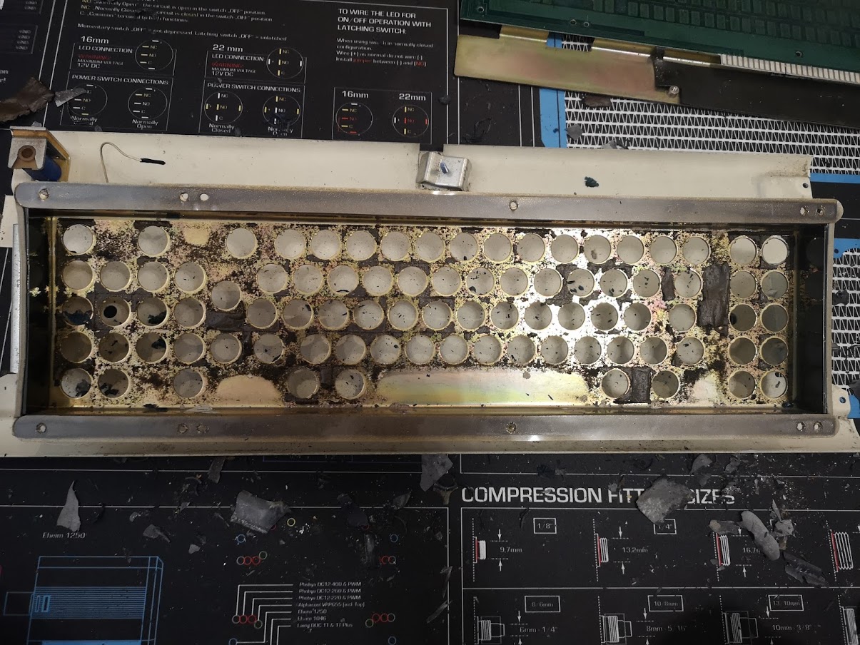

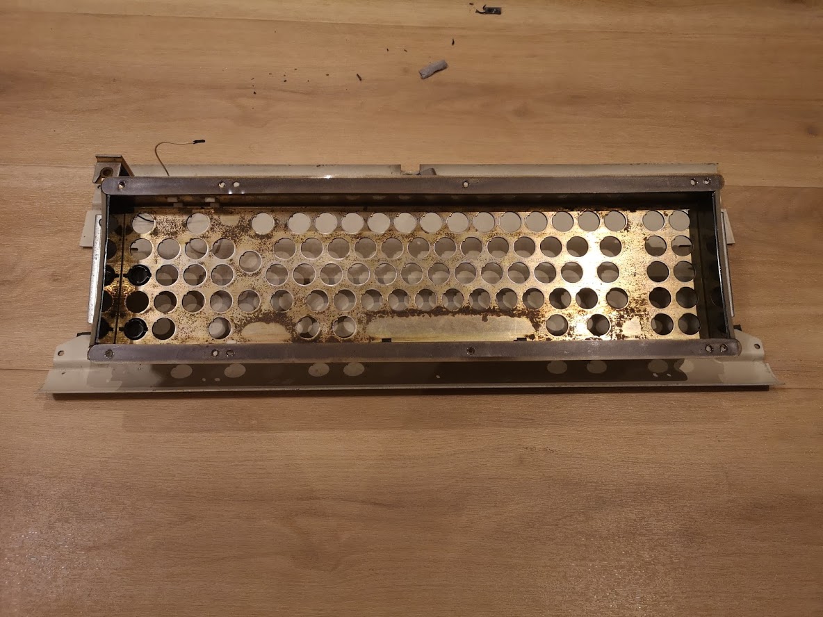

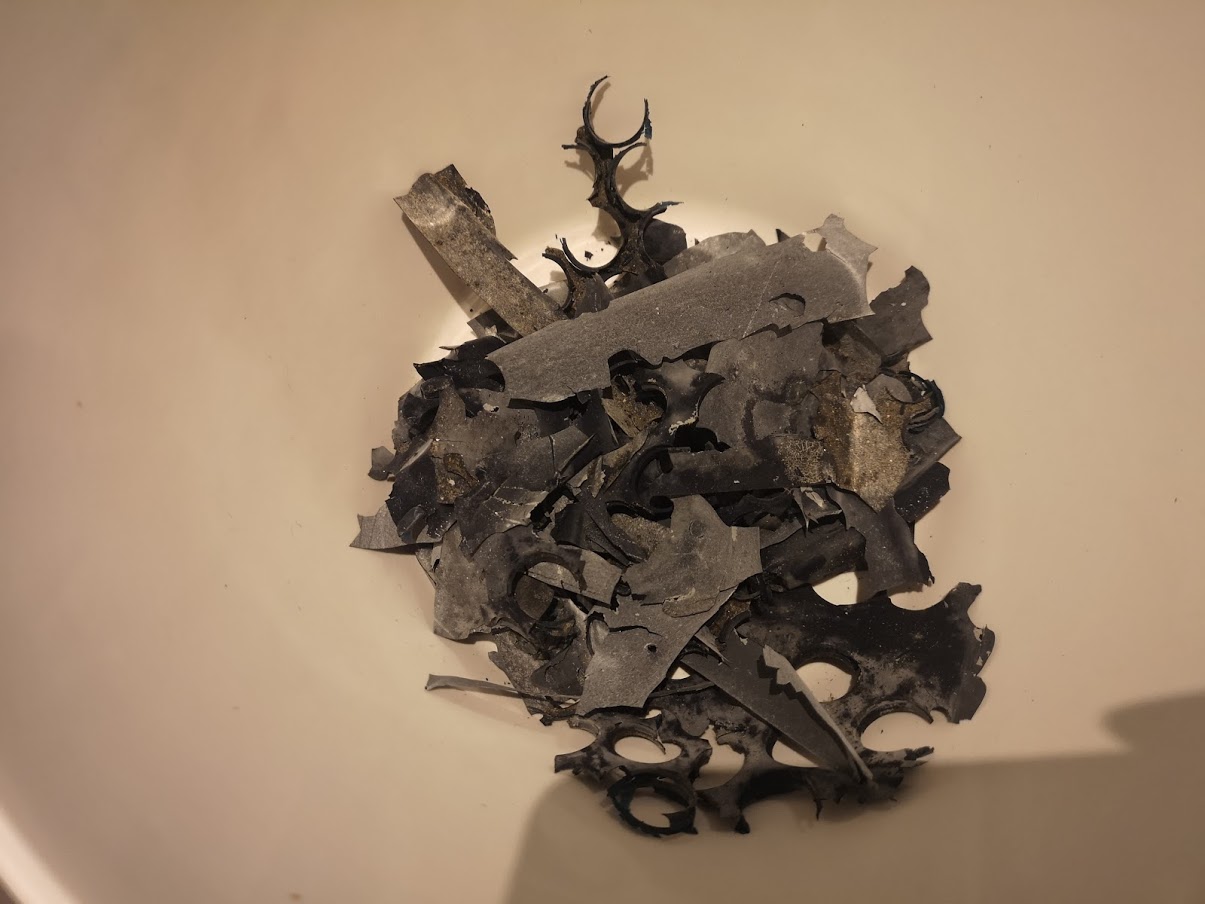

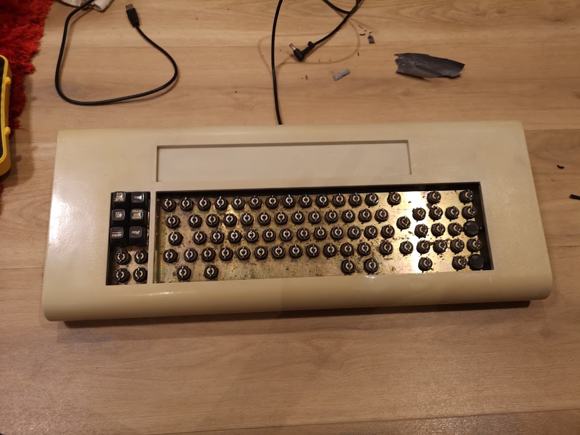

Removed the contamination shield.
disintigrated contamination shield.jpg (126.56 KiB) Viewed 9601 times

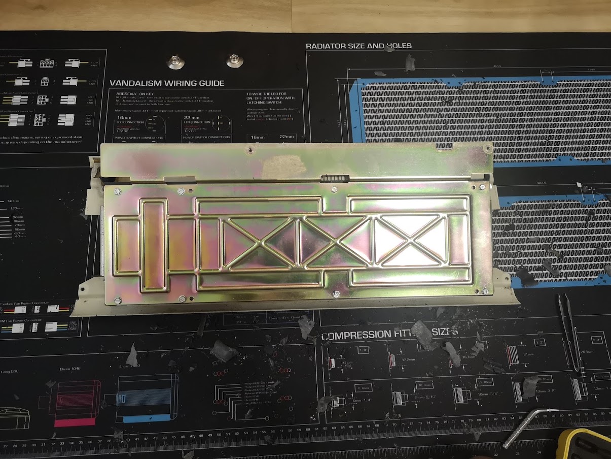

Backplate in great condition.
Backplate i great condition.jpg (271.42 KiB) Viewed 9601 times

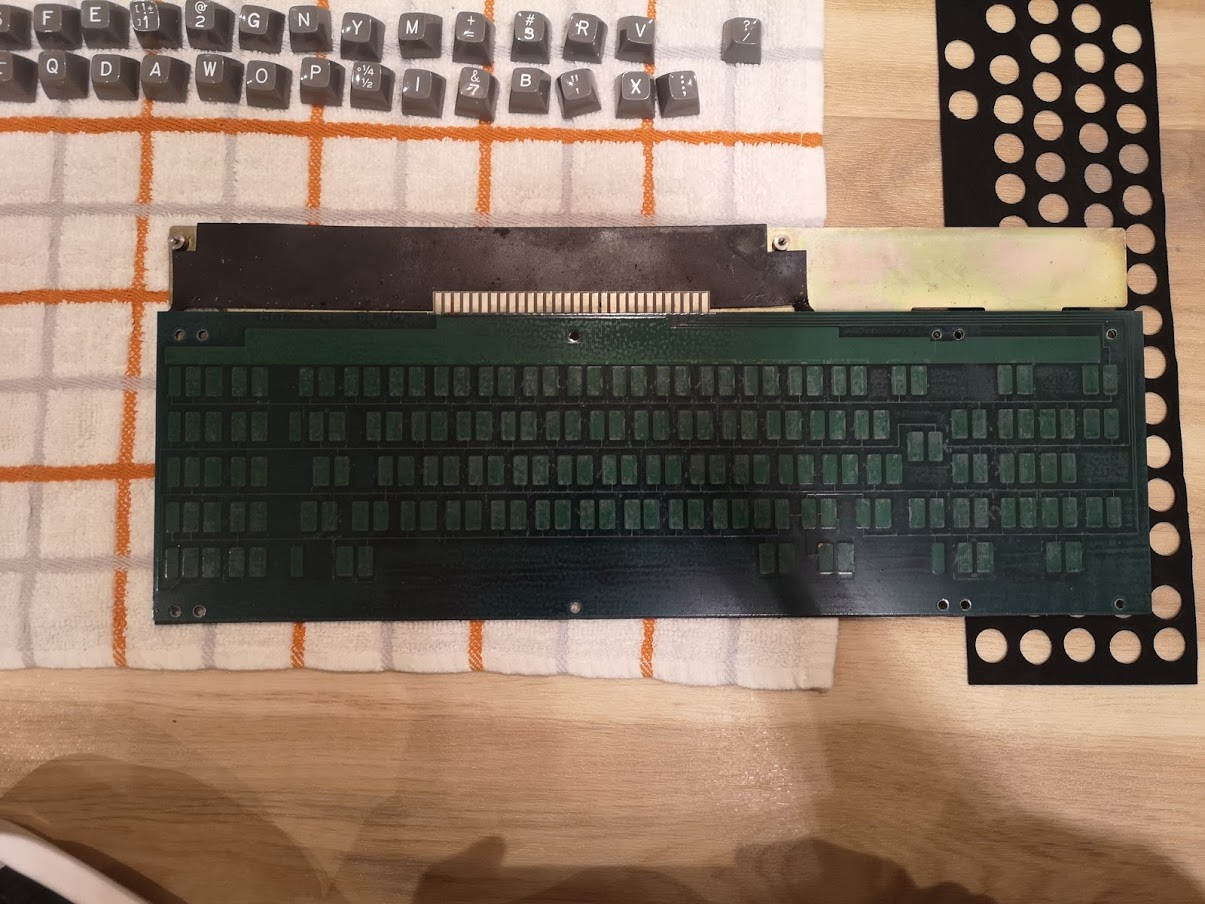

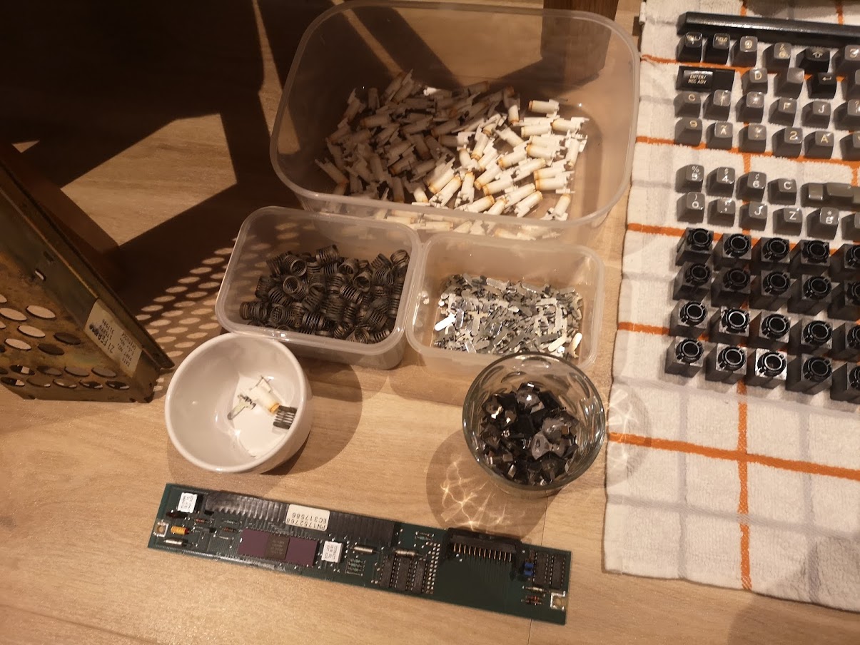

Image of the capacitive PCB.
Image of the capacitive PCB.jpg (211.38 KiB) Viewed 9601 times

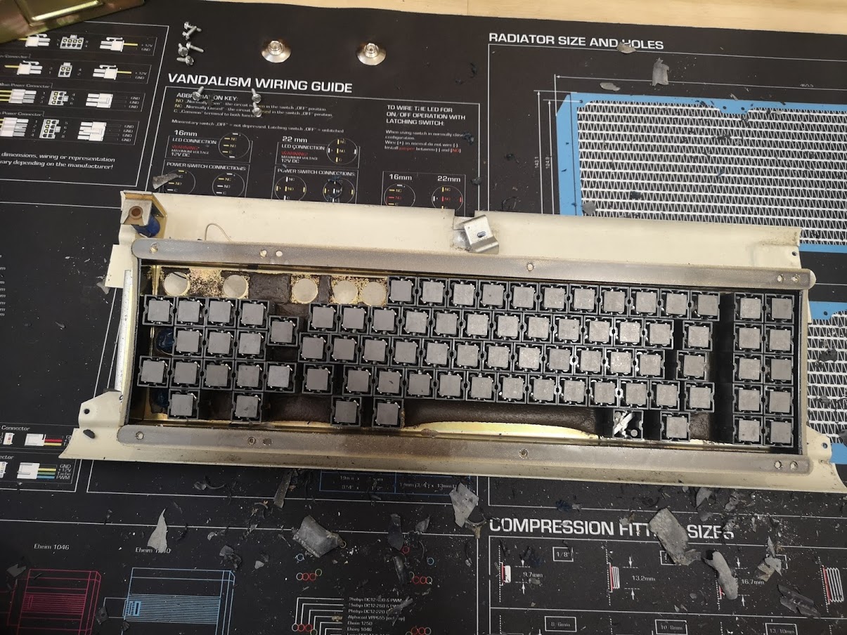

Starting to remove all switches.
starting to remove all the switches.jpg (318.94 KiB) Viewed 9601 times

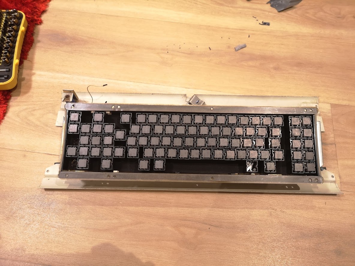

Sticky goo left on switch plate from old foam.
goo left over from old foam.jpg (305.14 KiB) Viewed 9601 times
Removed all the sticky goo from the switch plate using isopropyl alcohol then scrubbed it. Worked pretty well below is an image of the switch plate after the cleaning still some minor corrosion unfortunately.
switchplate completely clean.jpg (208.55 KiB) Viewed 9601 times

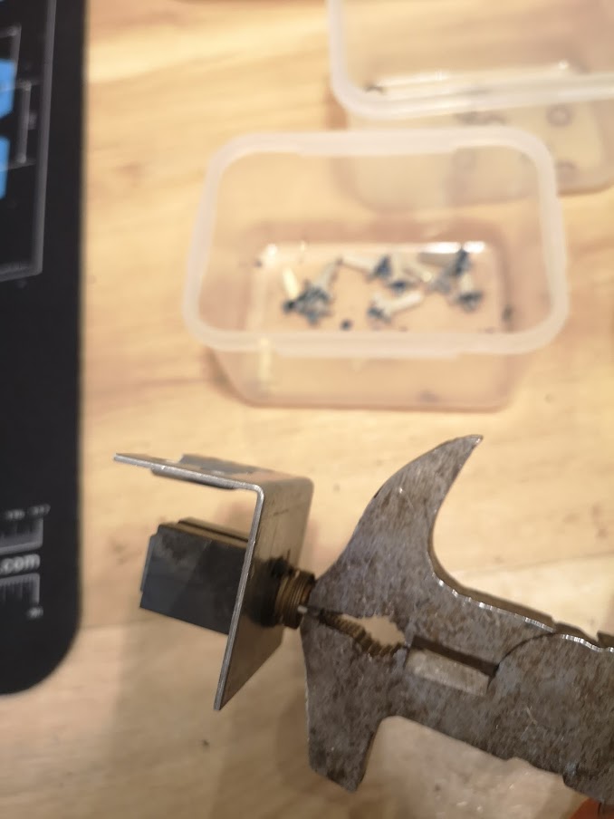

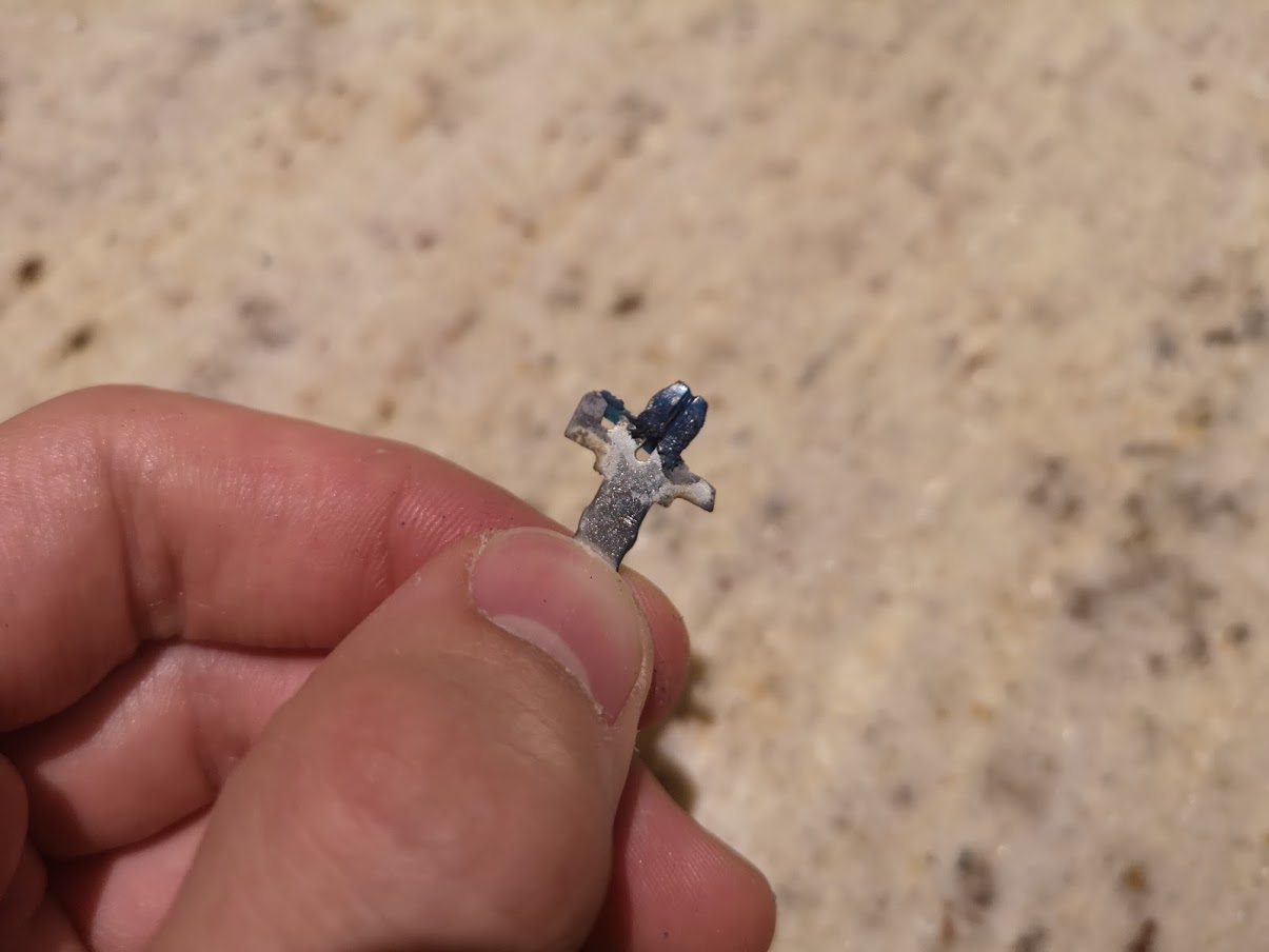

OK time to move on to the hardest part switch disassembly.
To remove the switch stem I used a piece of metal that had a hole that was the exact size of the switch mount. I then pulled the switch stem out with some pliers.
Here is an image demonstrating how that worked.
demonstariong how I pulled the stems out of the switches for the disassembly.jpg
demonstariong how I pulled the stems out of the switches for the disassembly.jpg (54.76 KiB) Viewed 9601 times

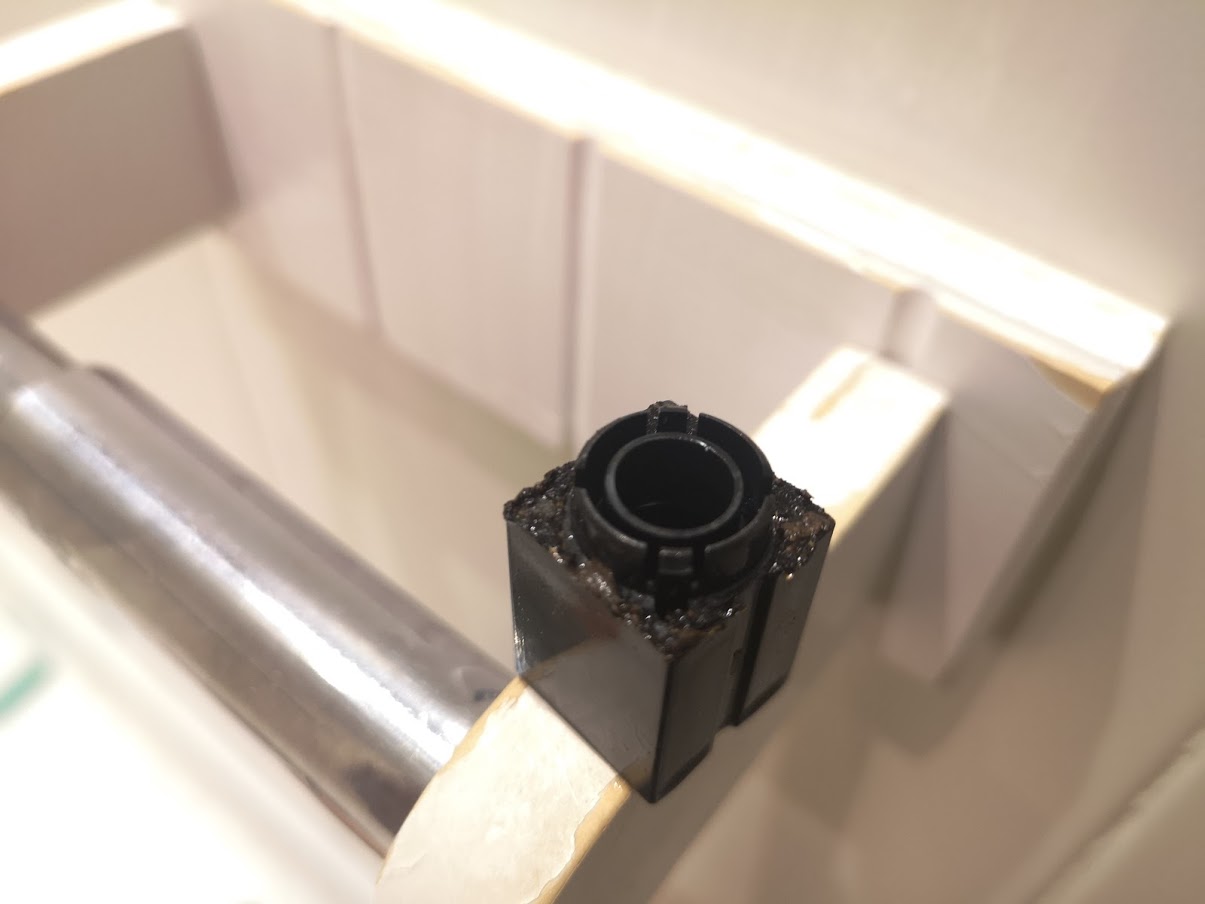

The switch stems also had a lot of contamination shield stuck to them that had to be painstakingly cleaned.
stems had a lot of left over contamination shield.jpg (69.67 KiB) Viewed 9601 times

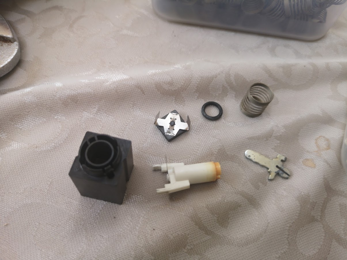

How one switch looks when disassembled.
How one switch looks when disassembled.jpg (183.62 KiB) Viewed 9601 times

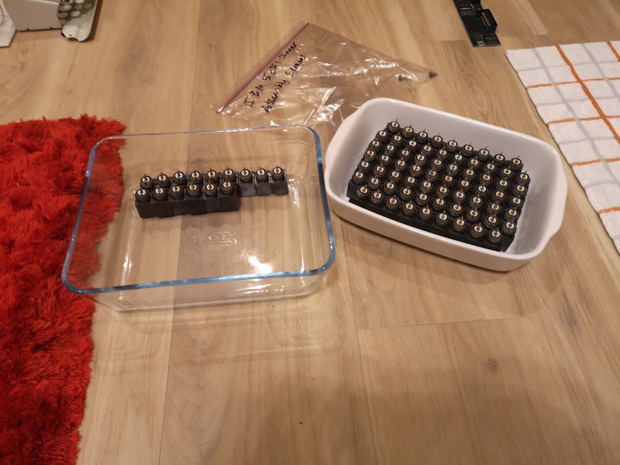

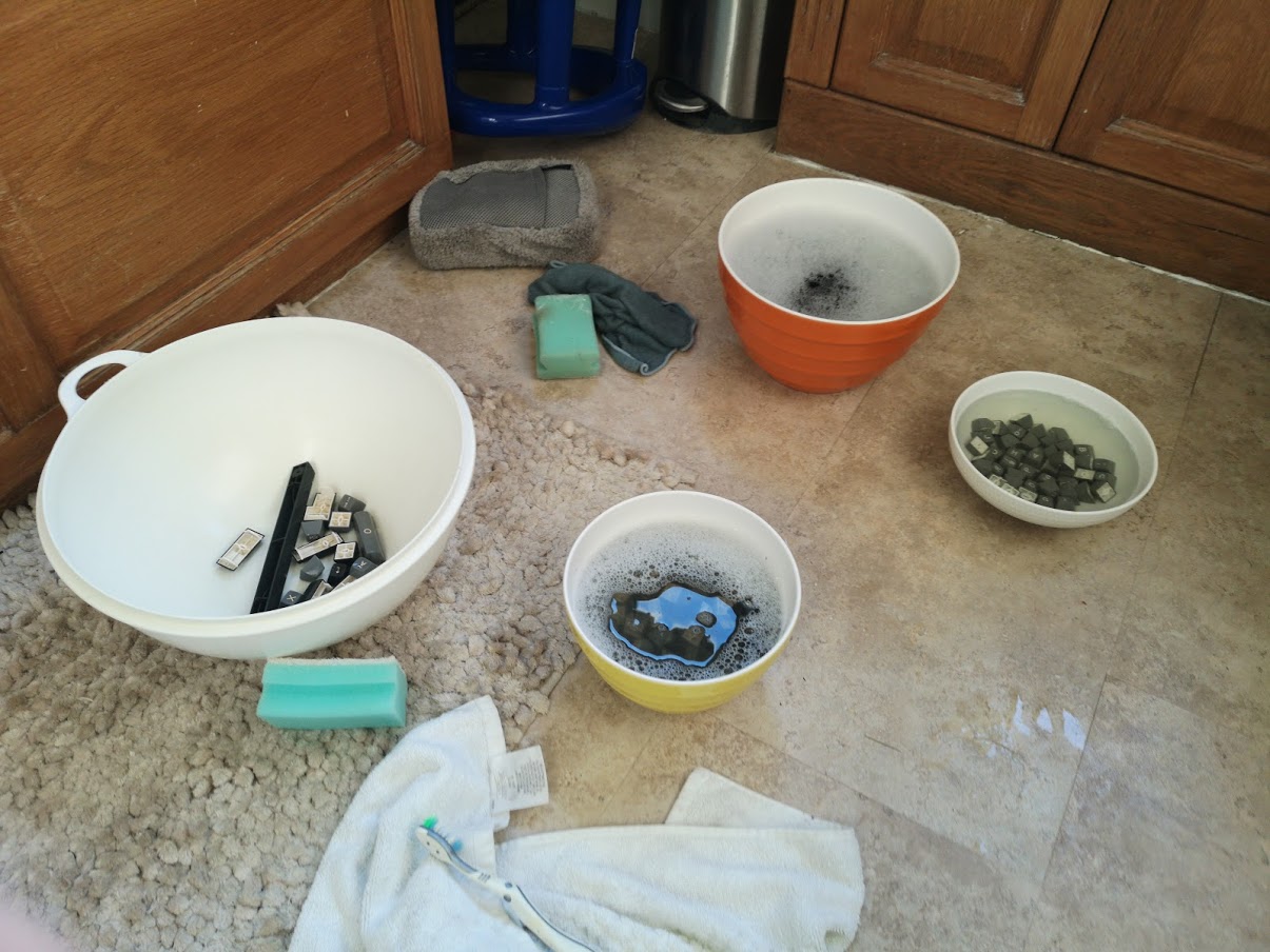

All keycaps and switch housings soaking in warm water with dish soap.
All keycaps and swith housings soaking in soapy water.jpg (192.07 KiB) Viewed 9601 times
Sticky goo from old foam also all over the switch housings.
Goo left on switch housings from old foam.jpg (63.14 KiB) Viewed 9601 times

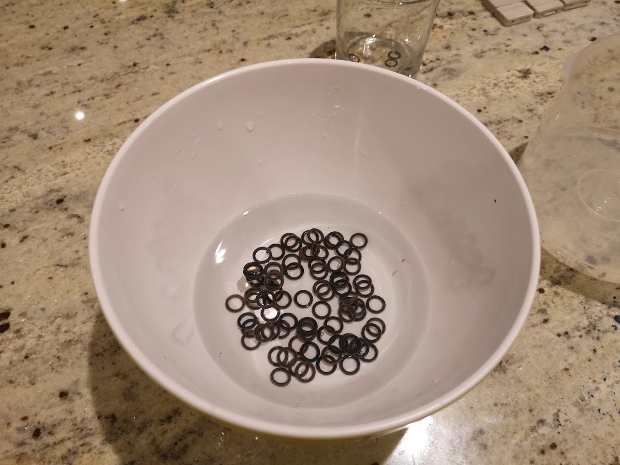

O rings soaking in soapy water too.
IBM 5251 washing o rings.jpg (161.48 KiB) Viewed 9601 times

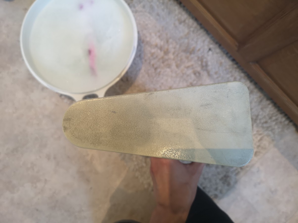

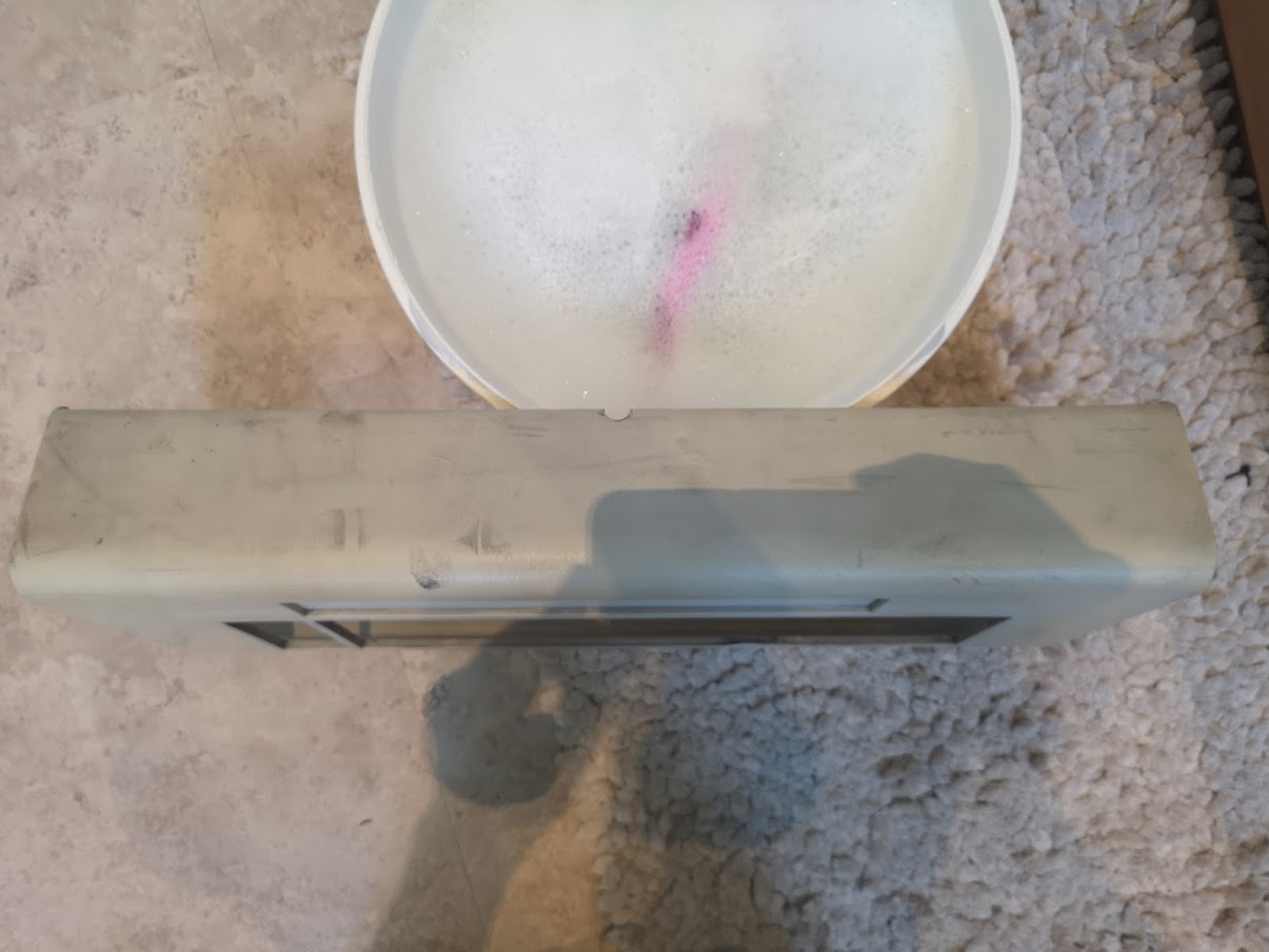

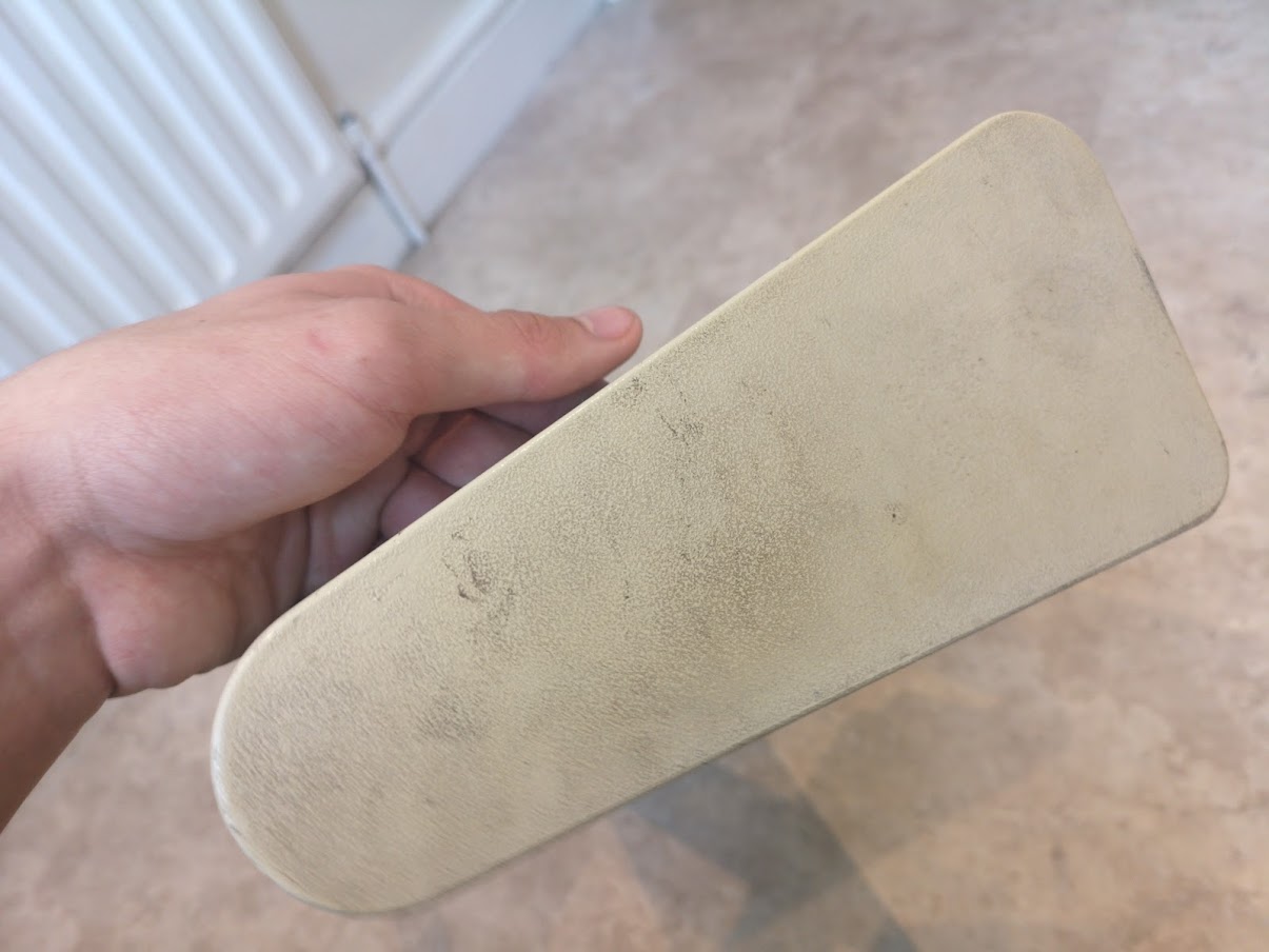

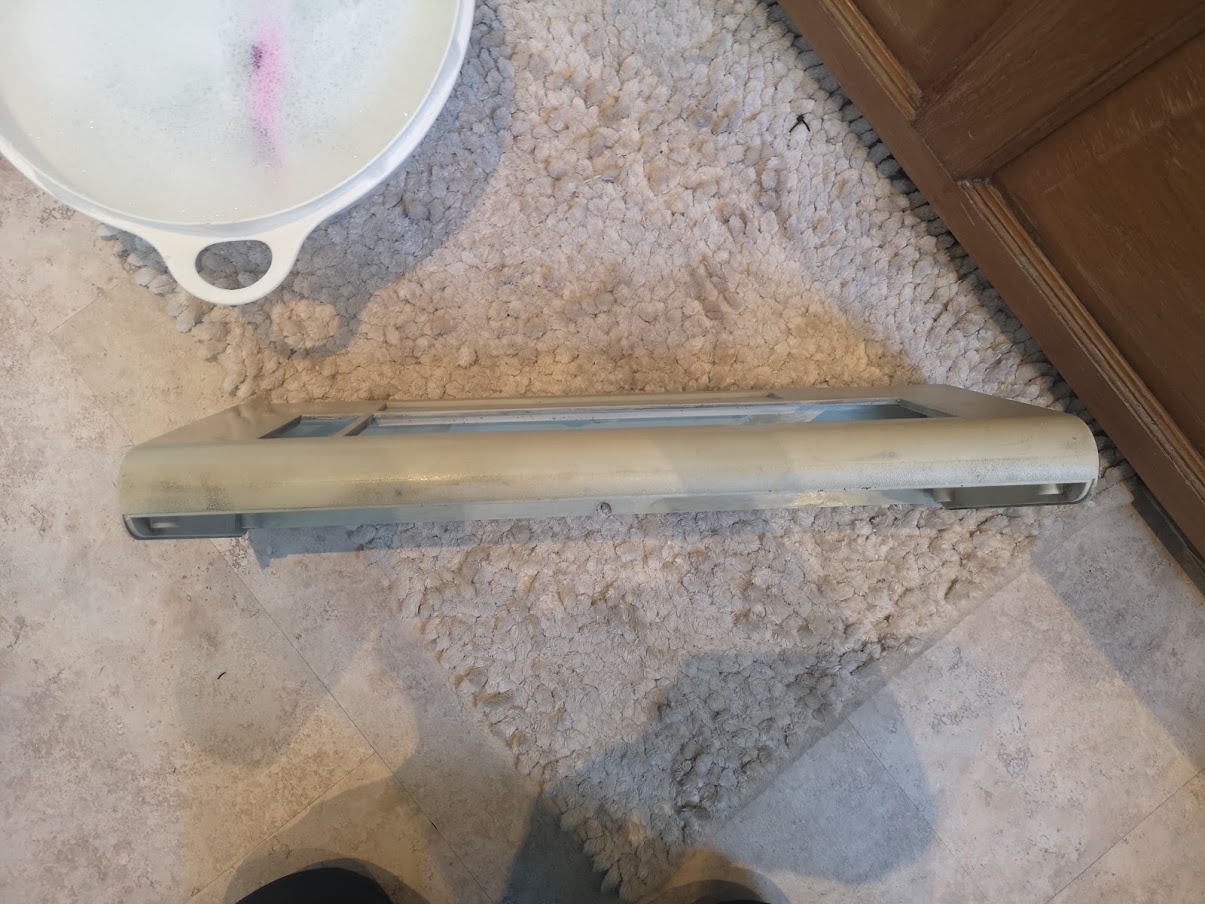

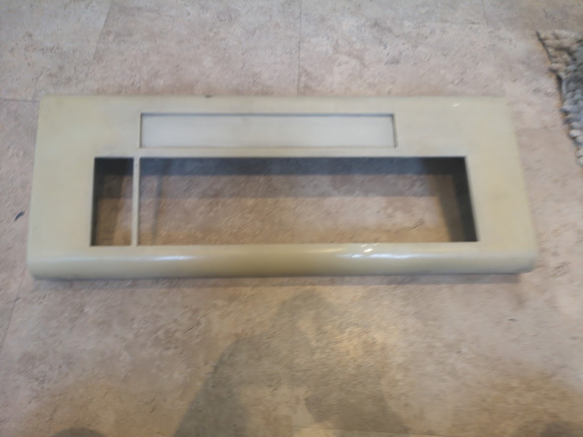

The top case was pretty dirty.
top case dirty pic 1.jpg (222.61 KiB) Viewed 9601 times
top case dirty 2.jpg (83.06 KiB) Viewed 9601 times
top case dirty 3.jpg (95.16 KiB) Viewed 9601 times
top case dirty 4.jpg (106.53 KiB) Viewed 9601 times
Top case cleaned sorry for the blurry image did not realise it came out blurry until after...
Top case cleaned.jpg (83.74 KiB) Viewed 9601 times
Whole keyboard disassembled and cleaned also new foam mat cut.
whole keyboard disassembled clean with o rings.jpg (209 KiB) Viewed 9601 times

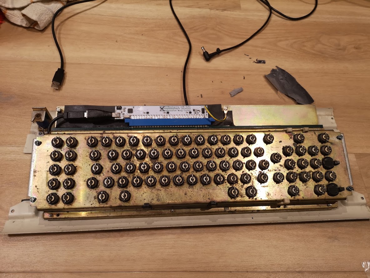

Xwhatsit installed.
Switch plate resassembled and Xwhatsit installed.jpg (253.96 KiB) Viewed 9601 times

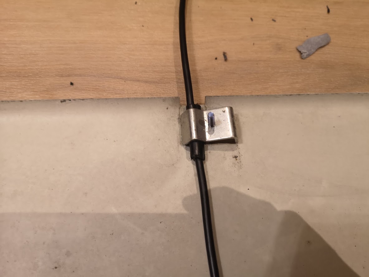

How I retained the Xwhatsit's USB cable.
How I retained the Xwhatsits USB cable.jpg (76.48 KiB) Viewed 9601 times

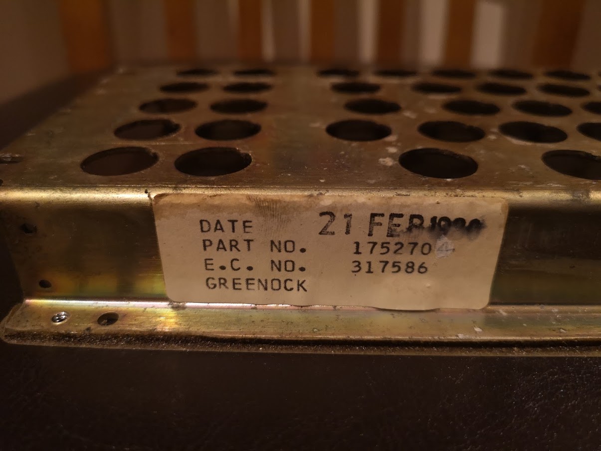

Manufacturers label on the keyboard.
IBM 5251 date label.jpg (128.62 KiB) Viewed 9601 times
