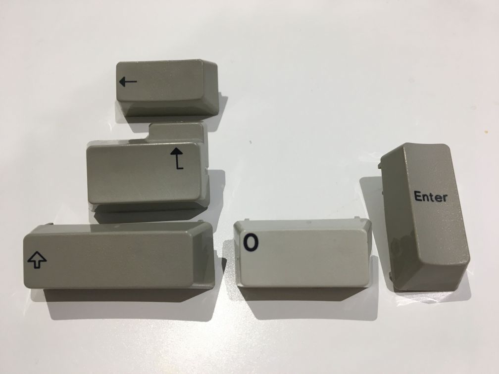

I’m restoring an IBM model F-122 and I want to update the wire-stabilized keycaps and use the barrel inserts instead. Don’t want to have to deal with broken stabilizer clips on the plate, etc.
I’m looking to buy the following replacement second gen keycaps:
backspace
iso return
long shift
numpad zero
numpad enter
I really want the legends to match too. :) Can someone hook me up?
Also, is it possible to know by date, which model M boards would have the barrel insert style caps?
Attached image shows the legends I’m after. Thanks for any help!

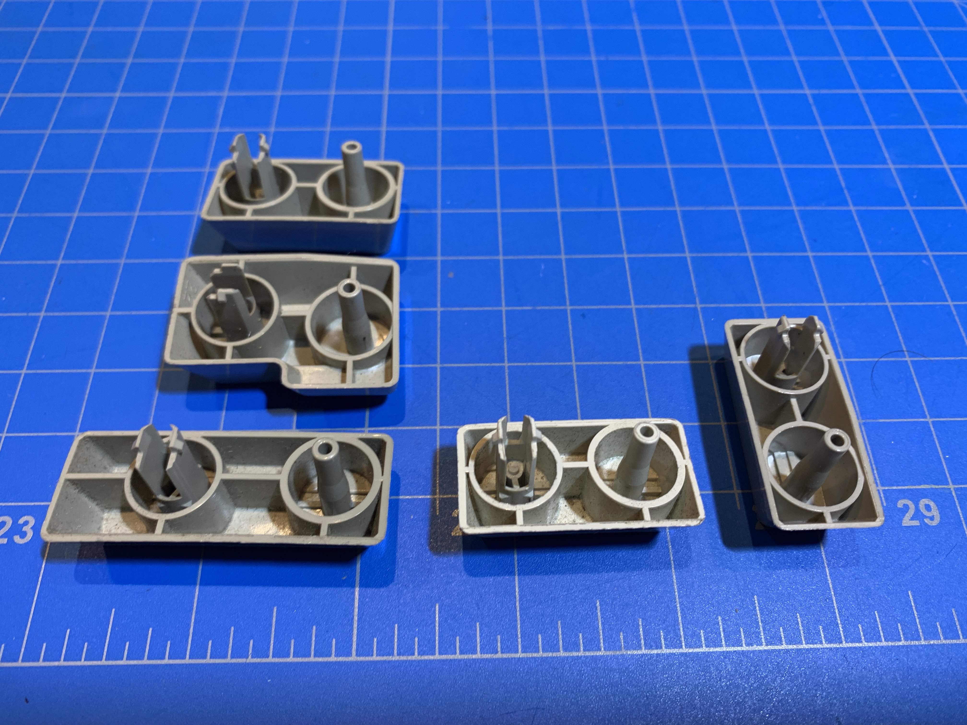

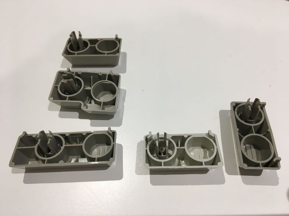

ISO versions of the standard model M also sometimes have these legends, at least according to my Googling. The wire is irrelevant, with the exception of the spacebar. They just need to have the stem that goes into the insert. Found some more images of M122s with the caps off and they definitely have the barrel inserts, so they do exist. :)
clickykeyboards
11 Aug 2019, 19:26

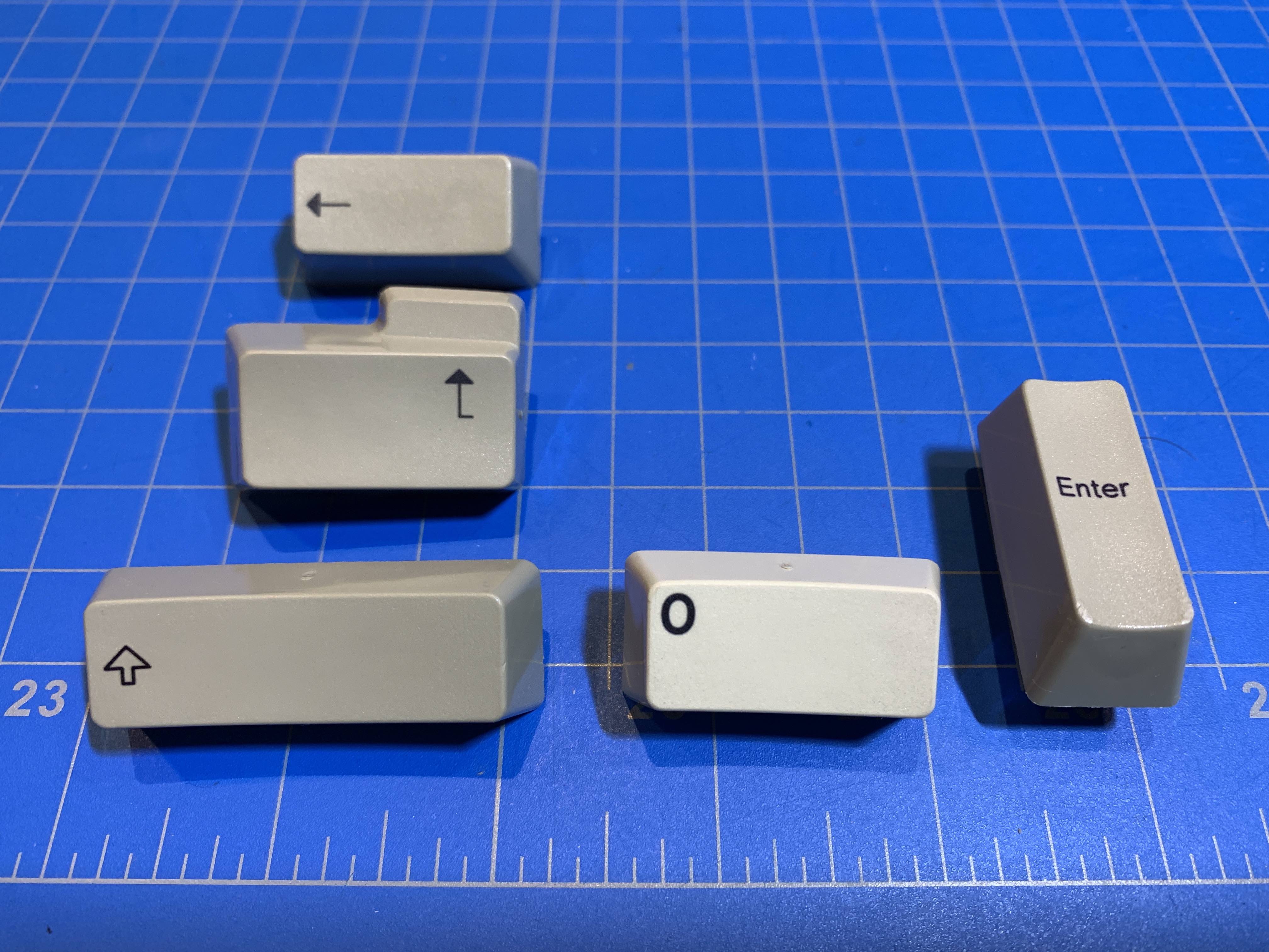

Are these the model M122 keys that you are looking for?
adamcobabe
11 Aug 2019, 22:12
Yes! Can you part with them? Hopefully we can work out a deal. :)
