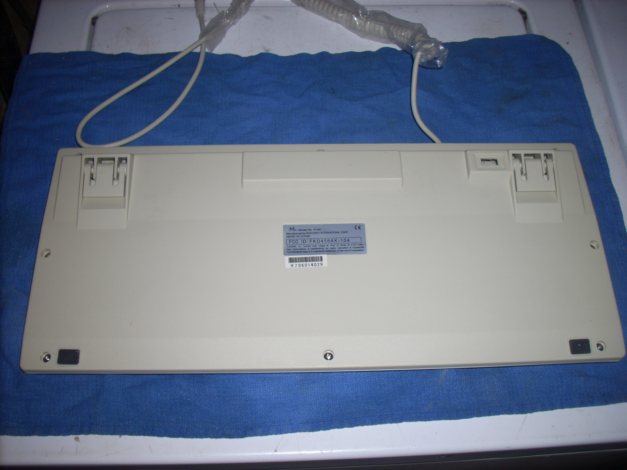

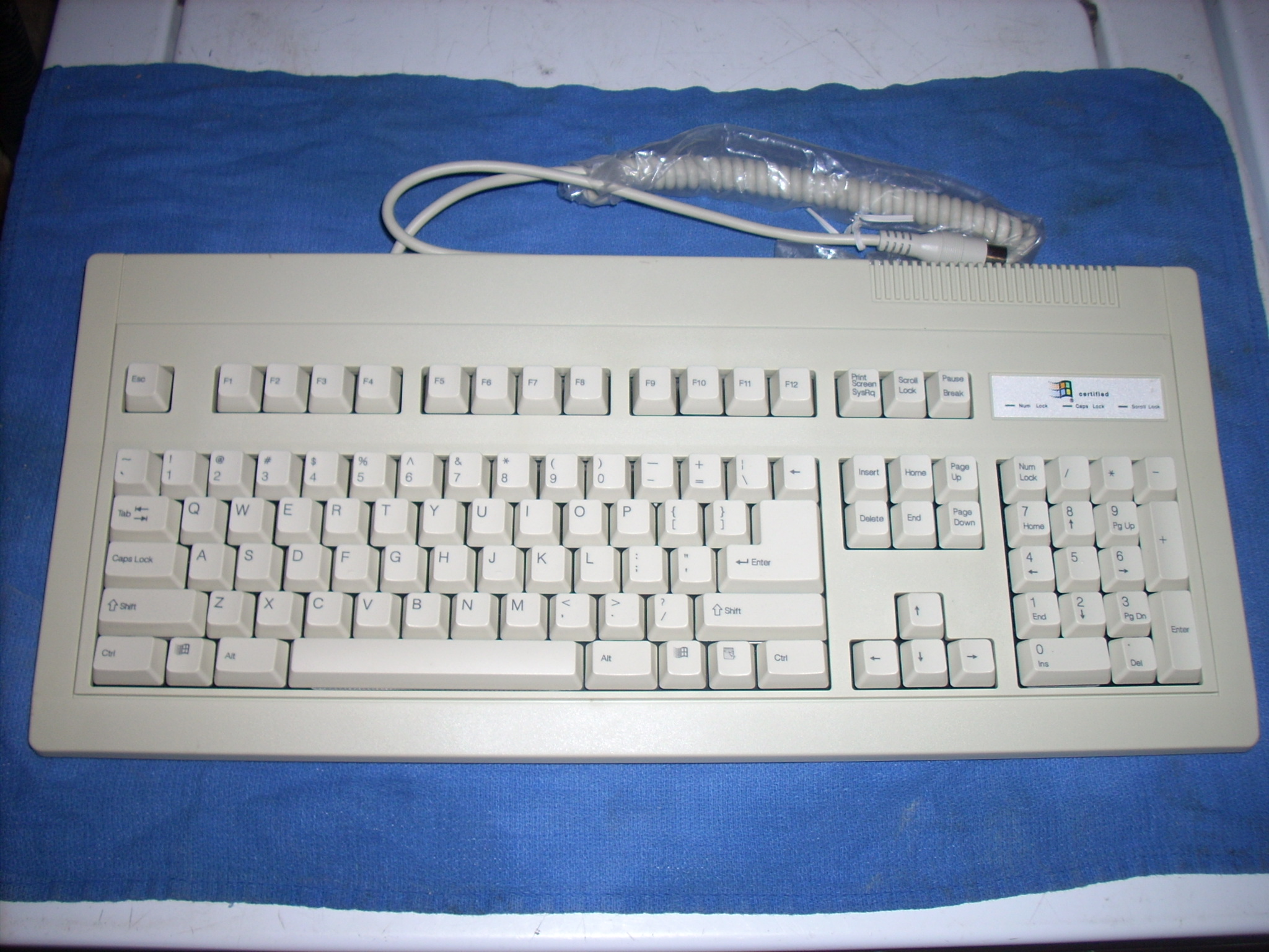

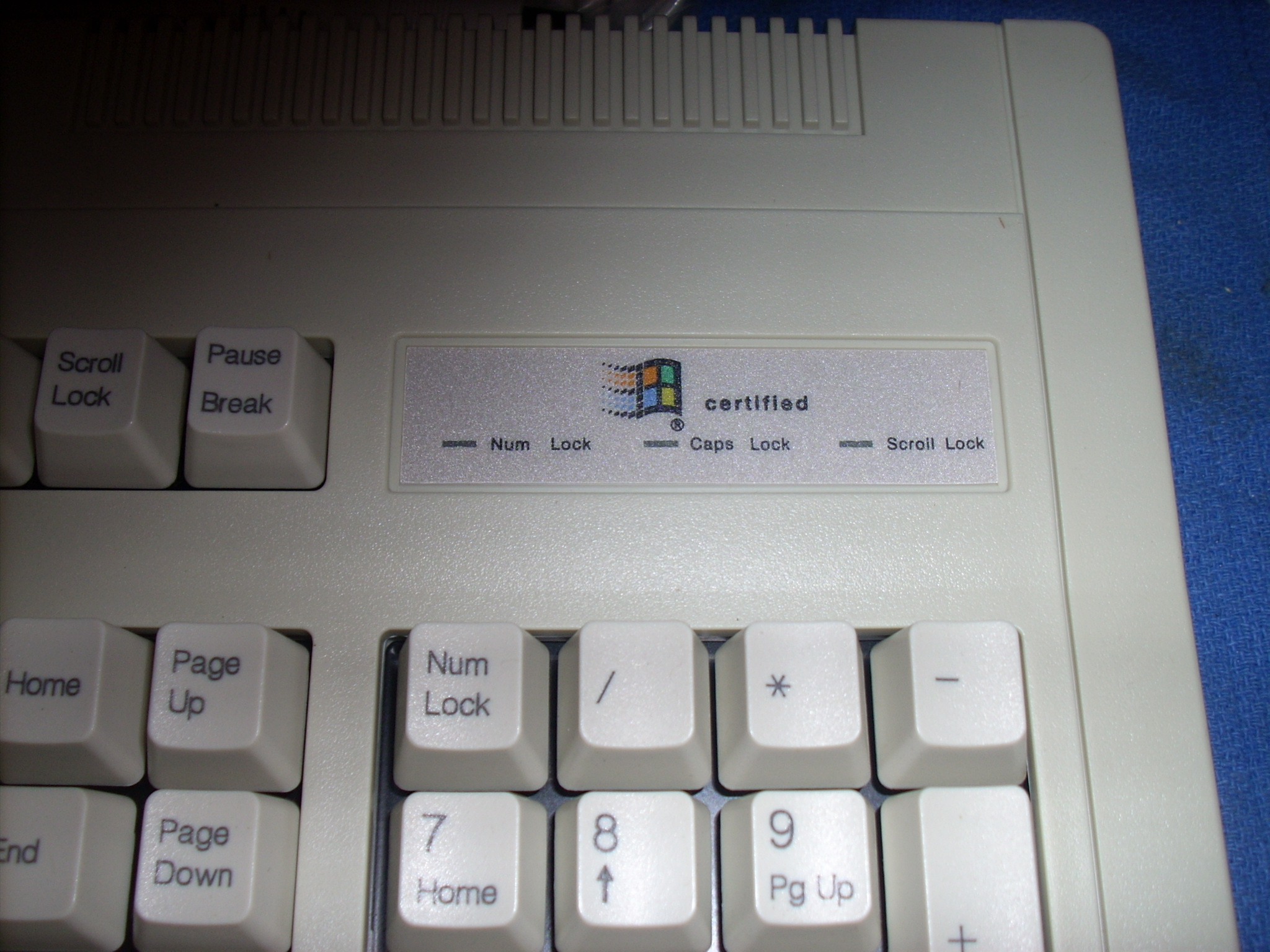

I just picked up a NIB Monterey K104W. The wiki says this model is "yet to be sighted", so I'm filling in a small blank. I don't know how to create a wiki entry, so I'll post it here instead. If anyone wants to do a better job of documenting this I can borrow a good camera and take some nicer photos. I can pop it open also if that helps anyone.

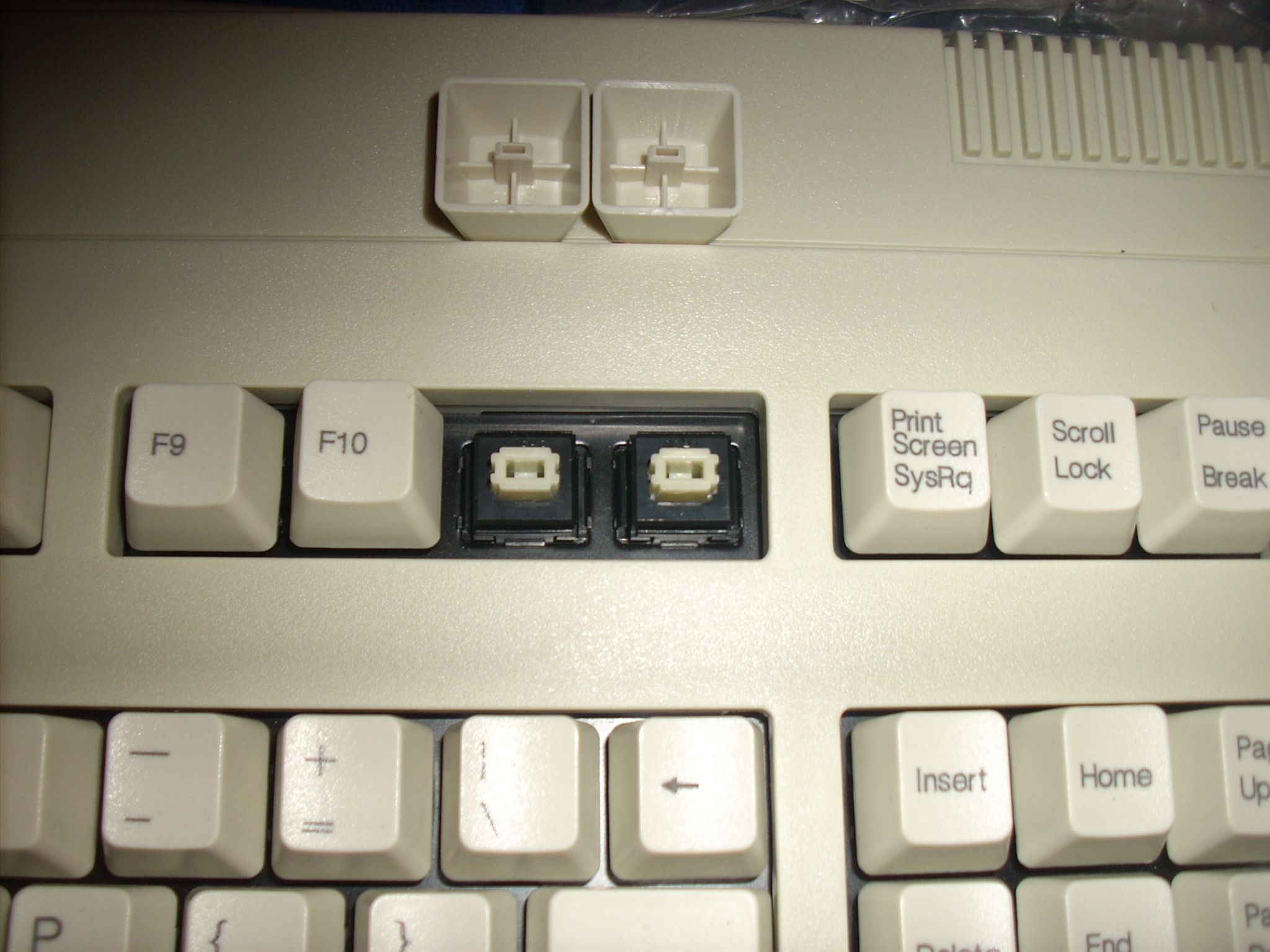

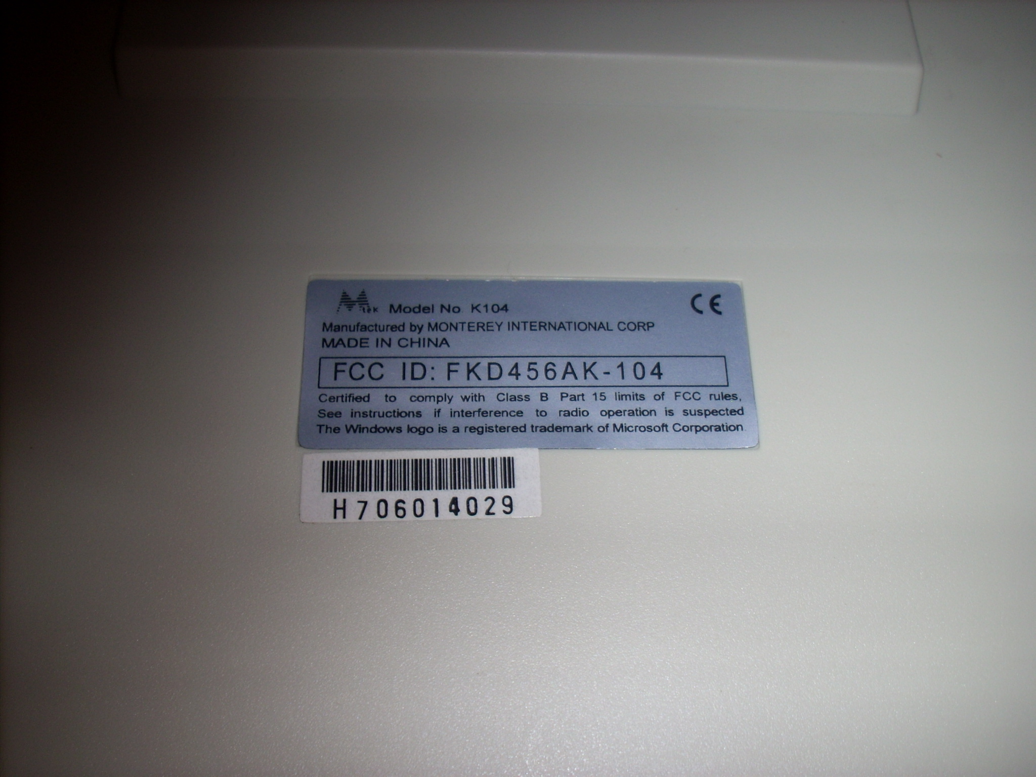

It's a disappointment compared to the earlier K104 versions, but that's to be expected. The switches are cream 4 tab clones, not much to say about those. The case is the same as the earlier K104s, very solid, so at least that wasn't compromised. Caps are printed, nothing special. Windows keys are what make it the "W" version, but it's not identified as such on the label, only on the box. Perhaps that's why it hasn't been documented before? The backspace was shrunk to 1u, which kills it for me as a driver, but this would be a good base for a switch transplant if one wanted an Alps keyboard with Windows keys and can live with the layout.
There's one more of these available. If anyone is interested pm me and I'll connect you directly. Here are some (crappy, sorry) photos.
Monterey K104W

- Windows LED overlay
- DSCN0706.JPG (814.09 KiB) Viewed 5075 times
- label
- DSCN0708.JPG (796.2 KiB) Viewed 5075 times
- case bottom
- DSCN0709.JPG (796.61 KiB) Viewed 5075 times
- switches and caps
- DSCN0710.JPG (813.17 KiB) Viewed 5075 times
