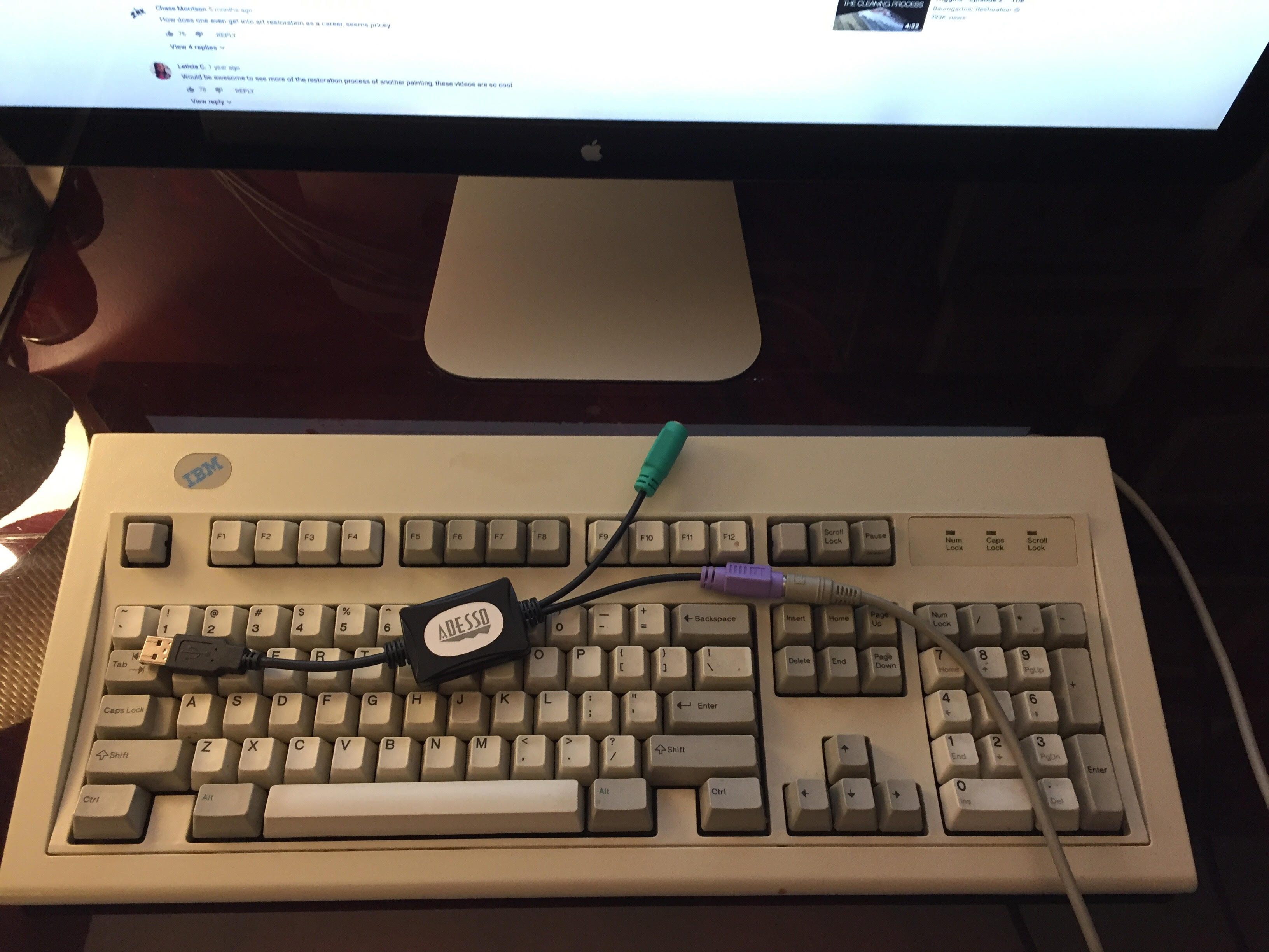

It is a pleasure joining your community. As a new member, I don't see a "Post New Thread" link so I will address my question here and seek your assistance and feedback. I discovered this site after my futile attempts in connecting a recently acquired IBM Model M 42H1292 to my two Macs: a 2011 Mac Mini (High Sierra) and a 2015 Macbook Air (Mojave). I also visited a local Best Buy to test connection with other Macs as well as Windows computers with no success.

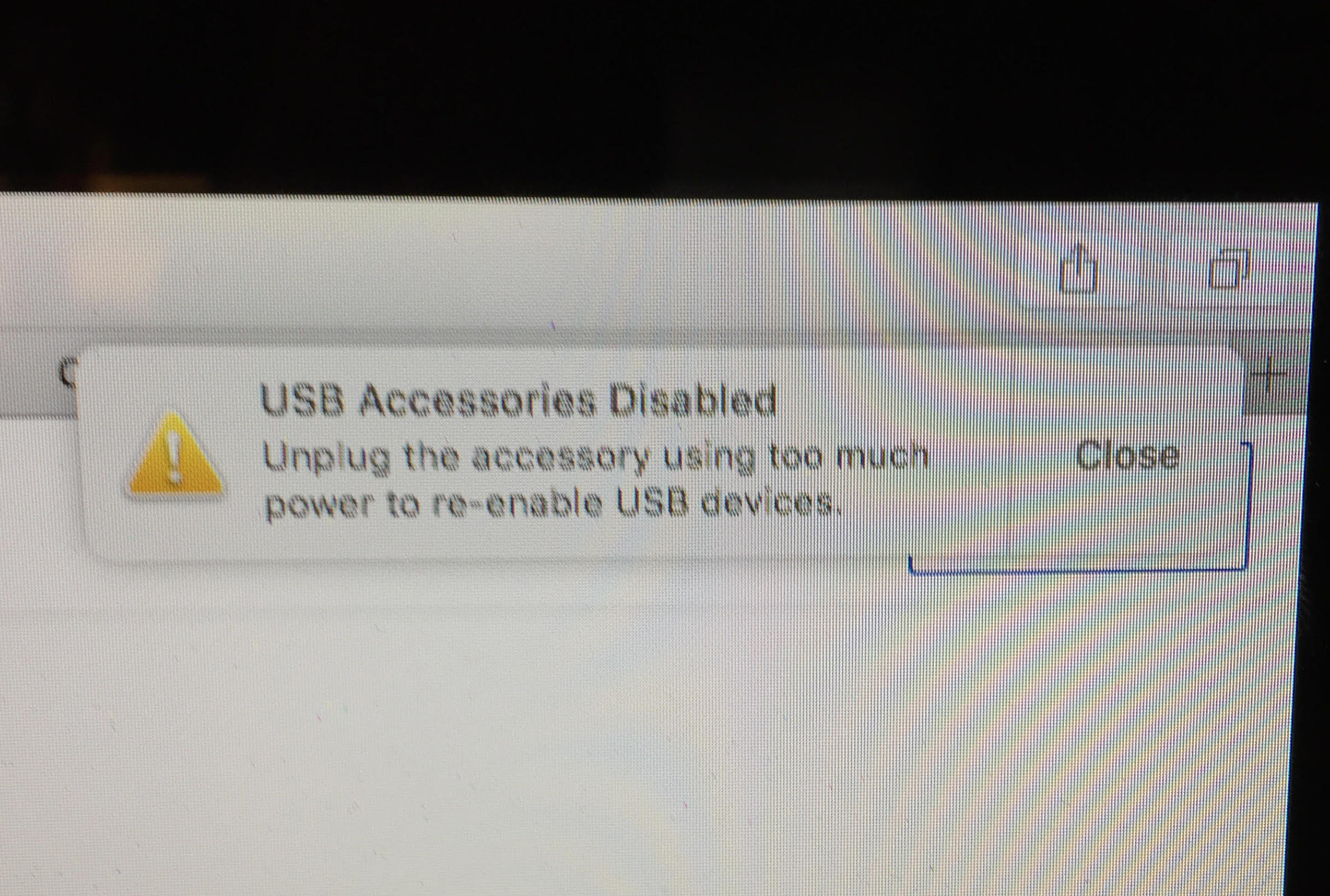

When connecting the Model M using a PS/2 to USB converter to either Mac, I receive the following notification:
Would appreciate any of your insights.

Unlike earlier models that came with detached cables, this 1995 IBM Model M 42H1292 comes with an attached PS/2 cable which I connected to the Adesso (which is advertised as an active converter) to the back of the Mac Mini as well the Macbook Air with no success. I also tried connecting the converter directly to the USB port on the Thunderbolt Display.
During the visit to Best Buy, I attempted connection with both the current model iMac and the iMac Pro. In all cases, I received the "USB Accessories Disabled" notification on the top right corner of the monitor as shown in the 3rd image. In attempted connections with current Windows computers, I receive similar notices alluding to excessive power or no notice at all.
If this Adesso converter is a dud and does not actively convert, would I continue to receive this "USB Accessories Disabled" notification?

I found my IBM Model M 42H1292 and connected it to my mid-2012 Macbook Air with an Adesso PS/2 to USB active converter. The MBA set up the keyboard with no problem. BTW, I am running Mac OS High Sierra 10.13.6.
I tried it with and without being connected to AC power, and I tried both USB connectors (left and right sides). Everything worked.
The problem with your setup might be the converter. It is also possible that newer Macs and/or a different version of Mac OS do not function with this keyboard and/or converter.

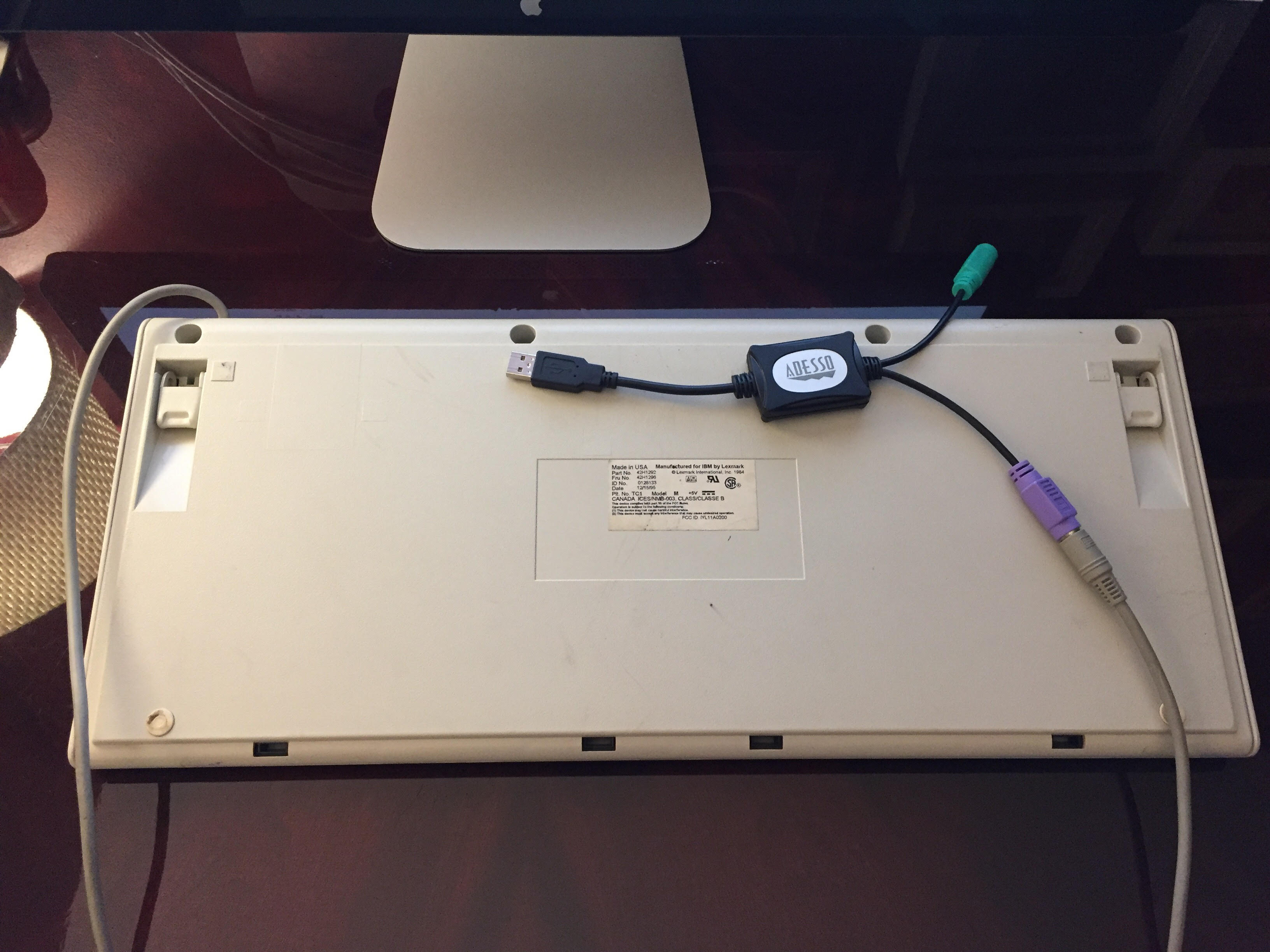

EDIT: I also noticed that the label on the back of your Model M does not look like an original. I hope you acquired the keyboard from a reputable source. Do you know when it was last tested and shown to work properly?

The only thing that I get a *low power* USB warning on is my phone, with a Lightning to USB OTG adapter. This actually works with my iPad, albeit mine is an old iPad and haven't tested with newer ones.

Here is my 5¢ answer. I never experienced any issues connecting one of my several ibm model Ms or FS to my hackintoshes since snow Leo to my last osx high Sierra. I used both blue cube active converter ps/2 and the same howard81 mentioned. Although I never tried to connect any kind kbd via usb c 3.1. the error message you got seems the same I got when I tried to connect my ibm F XT to Mac with a soarer's converter that had a bad wiring soldering. In other terms your Mac seems to say there is something wrong with voltage pin. Try to test your keyboard with a standard pc.
[strikethrough] myself, looking at your pics see something strange. I don't recognise a standard model m from the led panel.[/strikethrough]
