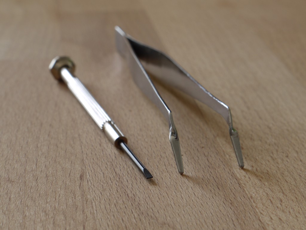

Here's my technique: it involves a pair of modified angled tweezers (tips bent by 90°) and a small screw driver. I've tried it with two tweezers but the tweezer-screw driver combination works better.
The tools.
The tools.

Kurk
23 May 2012, 10:04
off wrote:Hey Kurrk, did you heat it before/while twisting the tweezer ends, or just plain vanilla twisted them?
'Cause that does look like an even nicer tool than the paperbinder I was planning to sacrifice (copying someone else)..
I've just bent the ends using two pliers. This may only be that easy with *cheap* tweezers. The ones I used were 1 EUR for a set of four different shapes (at a local "Karwei" DIY store, or was it the "Gamma"?).
