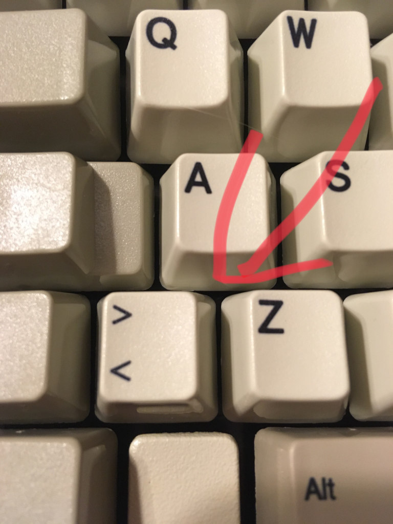

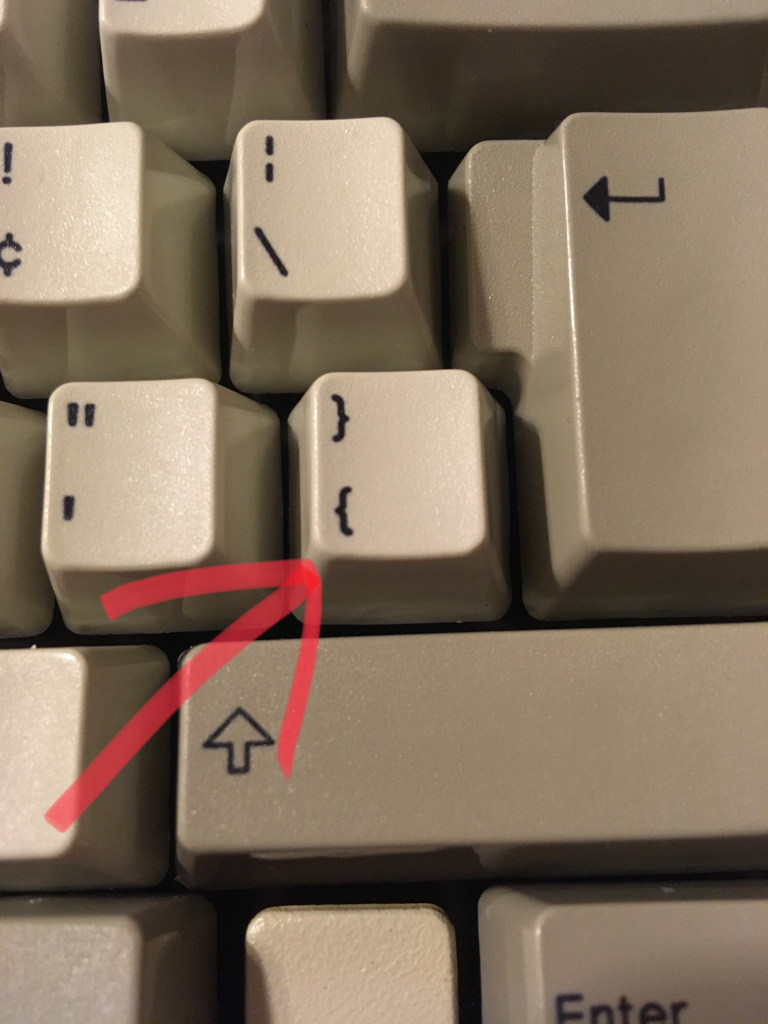

I have an IBM M122 and I'm trying create a custom Soarer's config. I've read through the docs but I can't find what the key with the braces (next to the tall return key) and the less than/greater than symbols on are called. The default Soarer's config doesn't seem to have them mapped to anything.
Photos attached for clarity on which keys I'm talking about.

Hmm, so I think the braces key is Europe_1?

lhutton wrote: 13 Mar 2019, 05:07 I have an IBM M122 and I'm trying create a custom Soarer's config. I've read through the docs but I can't find what the key with the braces (next to the tall return key) and the less than/greater than symbols on are called. The default Soarer's config doesn't seem to have them mapped to anything.
Thanks!
The SECOND one is 0x64 ("EUROPE_2") and you don't need to remap it.
The first one is 0x32 ("EUROPE_1) and you need to remap it to 0x31 ("BACKSLASH").
See my own F122/M122 remapping at viewtopic.php?p=425985#p425985 and use that as a starting point and/or reference for yours.
Right now EUROPE_2 just prints a strange character for me, not terribly useful. I figured out EUROPE_1 last night as no pipe key is a no go for a *nix user. I'll mess with my EUROPE_2 when I get home tonight. I just didn't know what to address it as in the config file. Thanks! I'll have a look at you file.

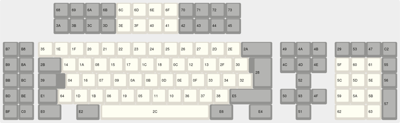

This is the "hid map" I got from my M122:
As you can see, the hid code you need to remap the central key of the cross arrow nav is 0x93 (LANG_4).
As for the "<" key, I guess your computer expects an US-EN layout, which lacks that key so it produces a strange character when pressed. I would try to remap EUROPE_2 and Shift + EUROPE_2 to whatever keys you want.
Thanks, that's a very helpful map. Yeah it's not a currency symbol or anything I recognize, I did change my layout to ISO European at one point and it did the same thing.

Do remember that layout configuration goes in two separate layers - physical (Soarer's) and logical ("national"). For example, you could remap the EUROPE_2 key to produce, say, the code 0x33. Then, pressing that key would produce a ';' if using the US English national layout, a 'Ñ' if using either Spanish layout, a 'Ö' with the German layout, etcetera.

At least for a Model F XT, these two settings are necessary to "fix" the ISO specific keys you mentioned.
remapblock
  BACKSLASH     EUROPE_2
  BACK_QUOTE    BACKSLASH
endblock
In case you're not yet happy with your configuration, if could be worth a try. (.... Or maybe I have no idea, what I'm talking about.)

I had exactly the same problem with my German ISO layout m122. I used the following to fix it
remapblock
EUROPE_1 BACKSLASH
endblock
