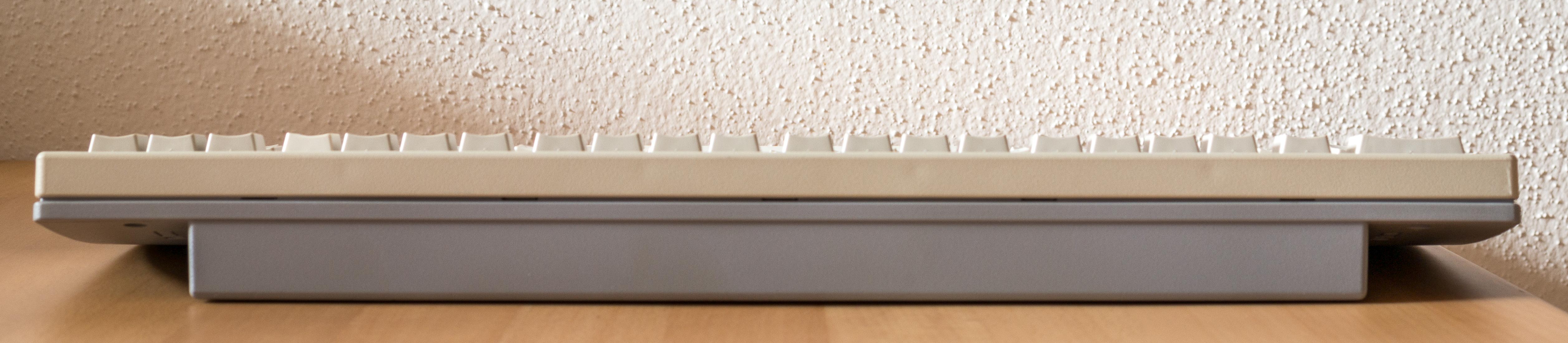

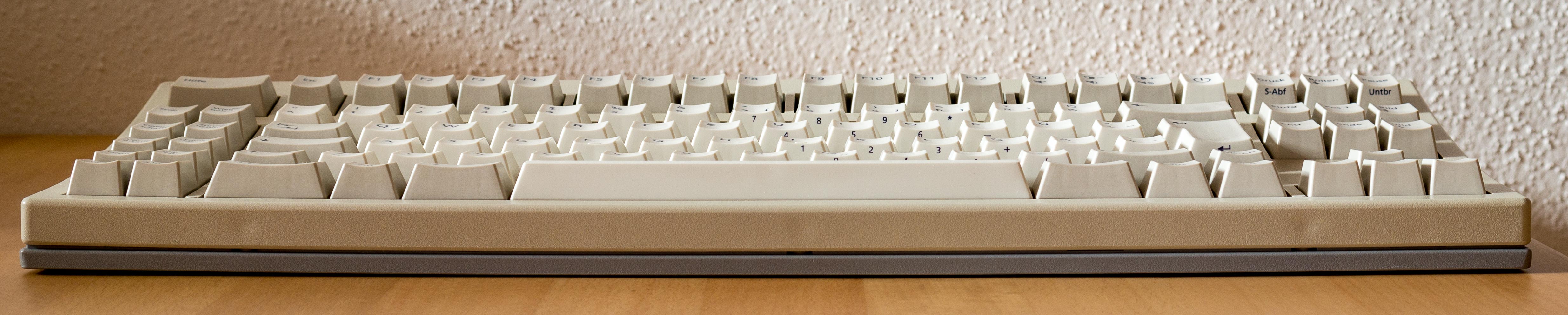

As teased a few days ago, here comes the cleaned Sun keyboard, which I saved from the bin, because of its space saving appeal.

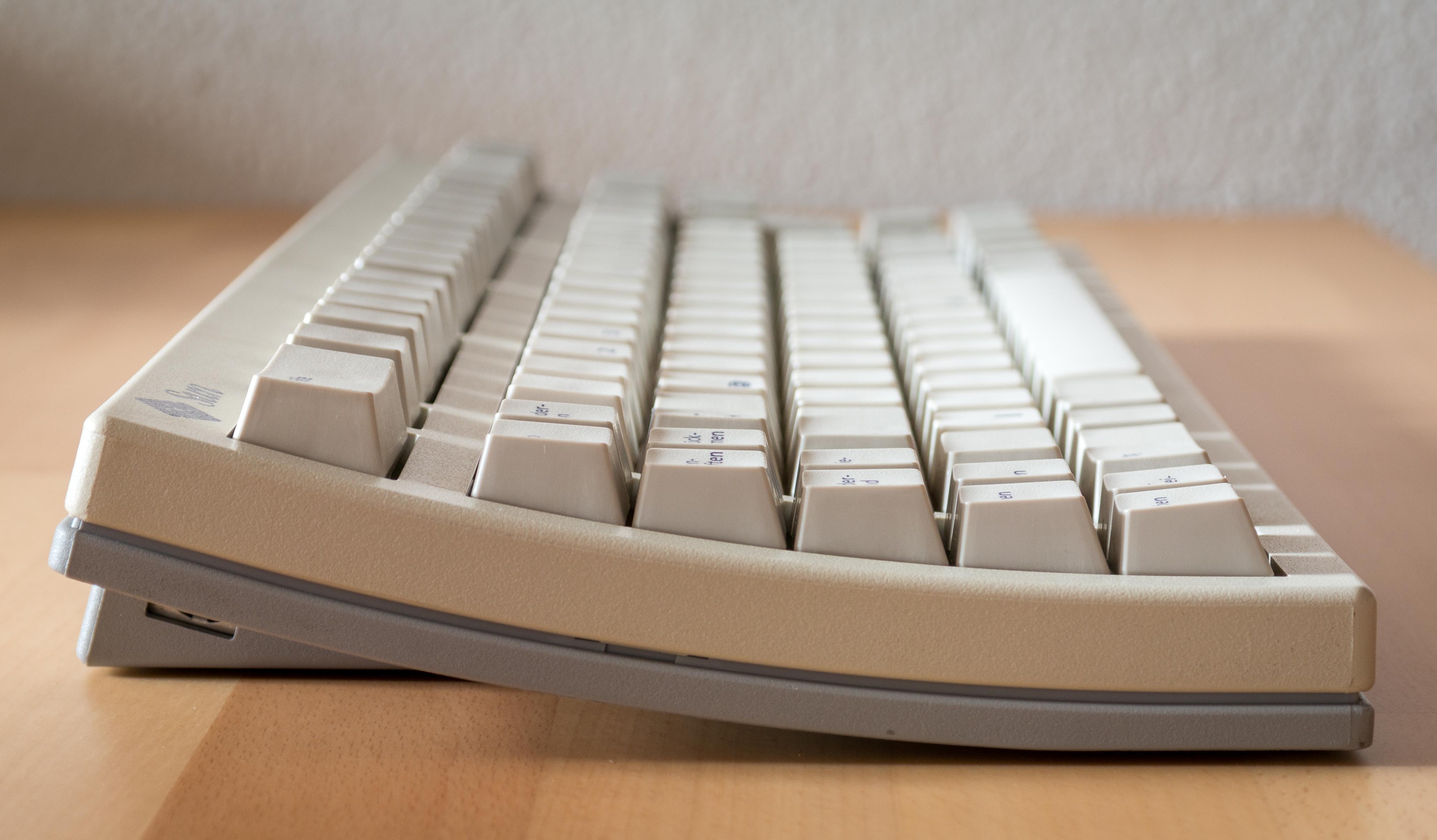

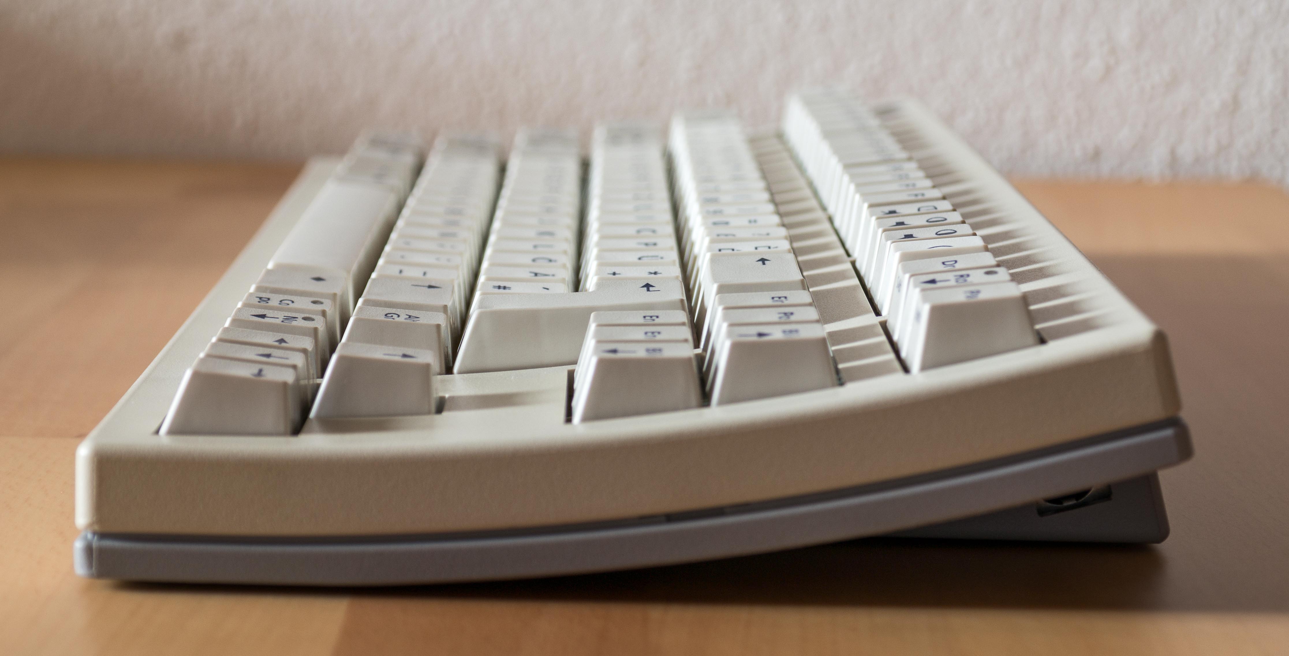

First the positive aspect: The looks (I really like that curved simple design)

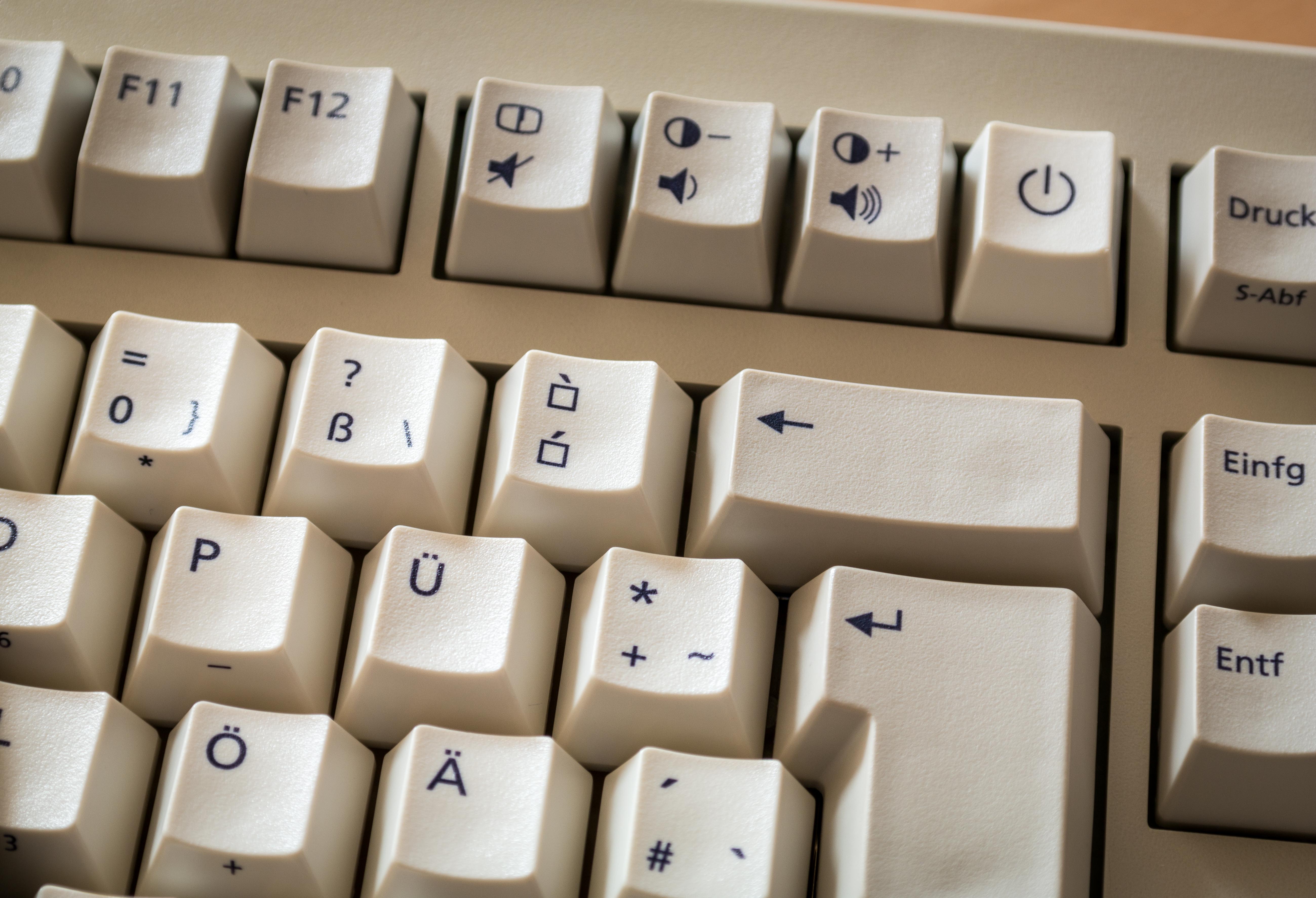

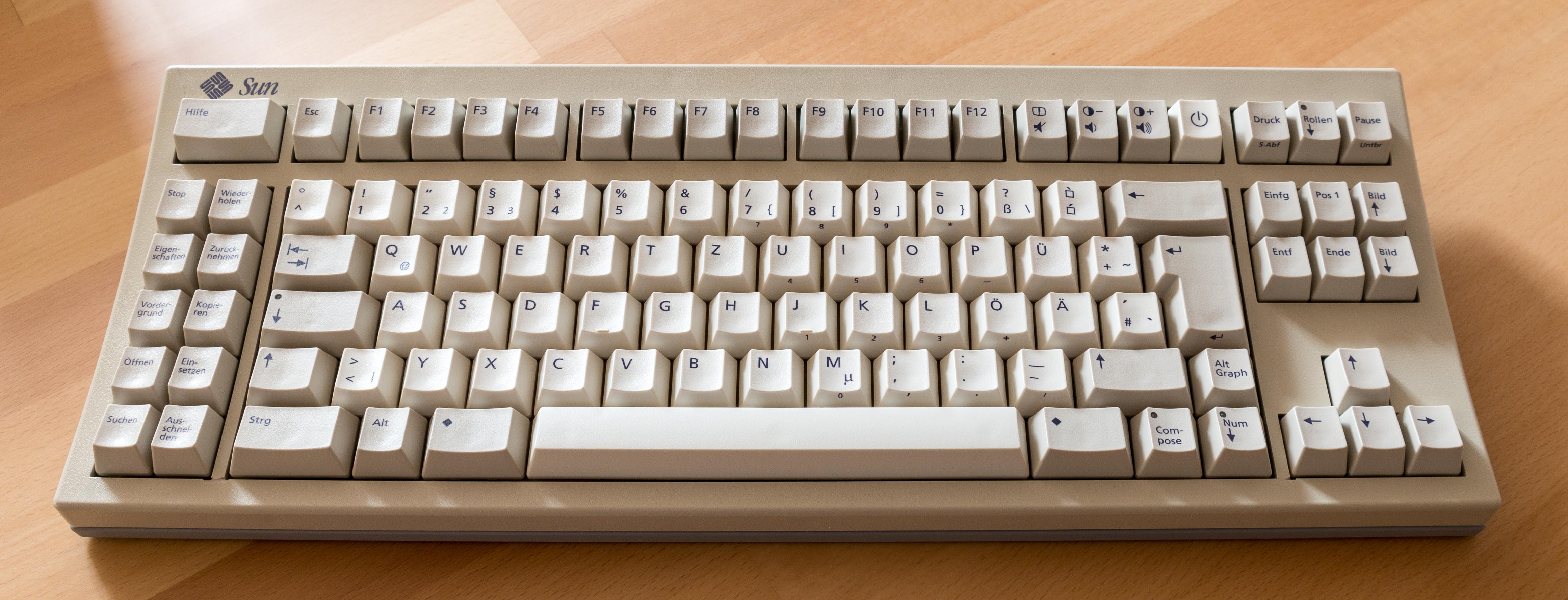

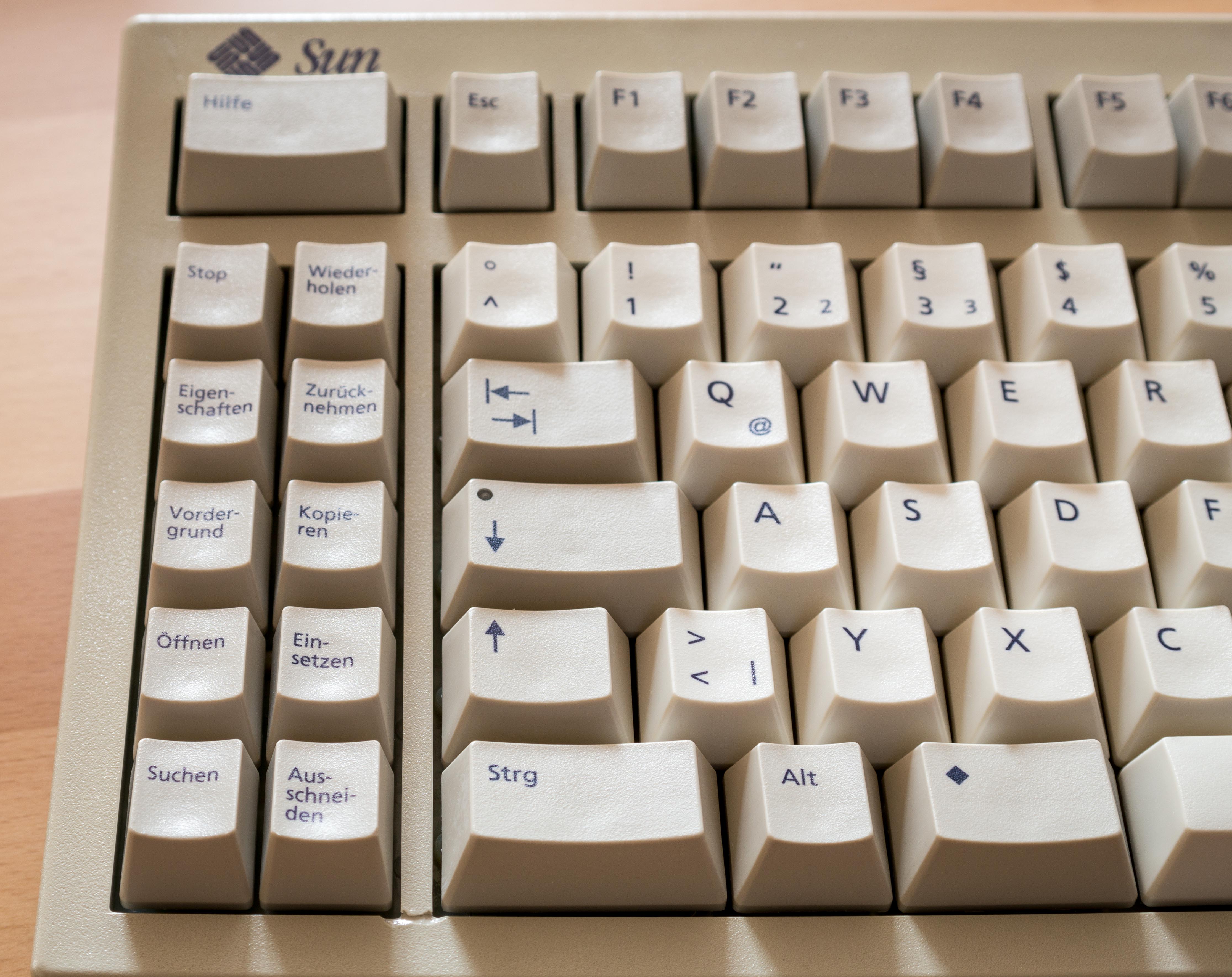

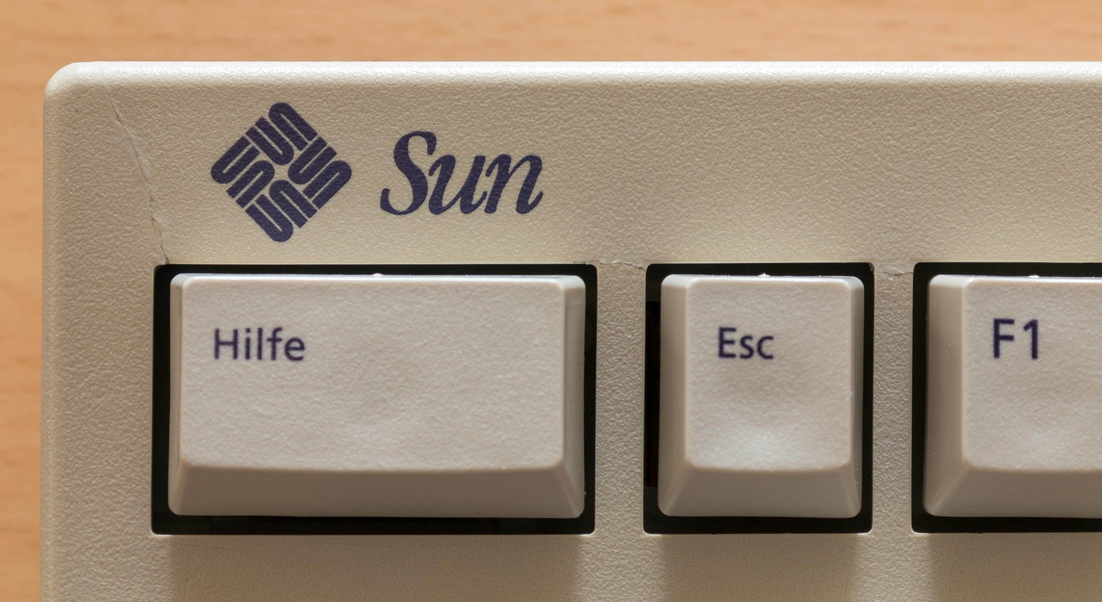

A nice quirky touch - the key that usually only shows the "accent aigu" and "accent grave" here has little squares as placeholders for the letter. (The legends are indeed dark blue/purple.)
Lots of special German legends

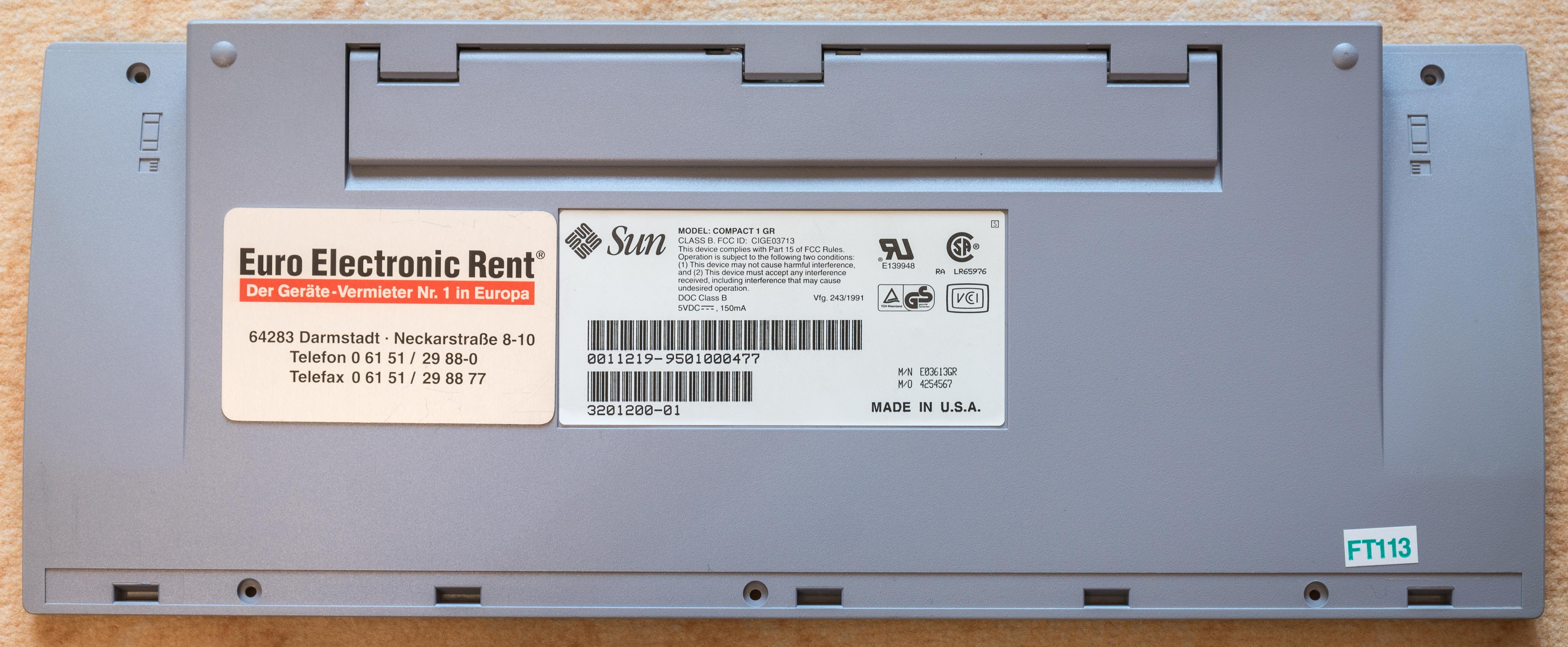

The small print (The big thick sticker from the renting company is pretty much the only piece of metal on this keyboard!)

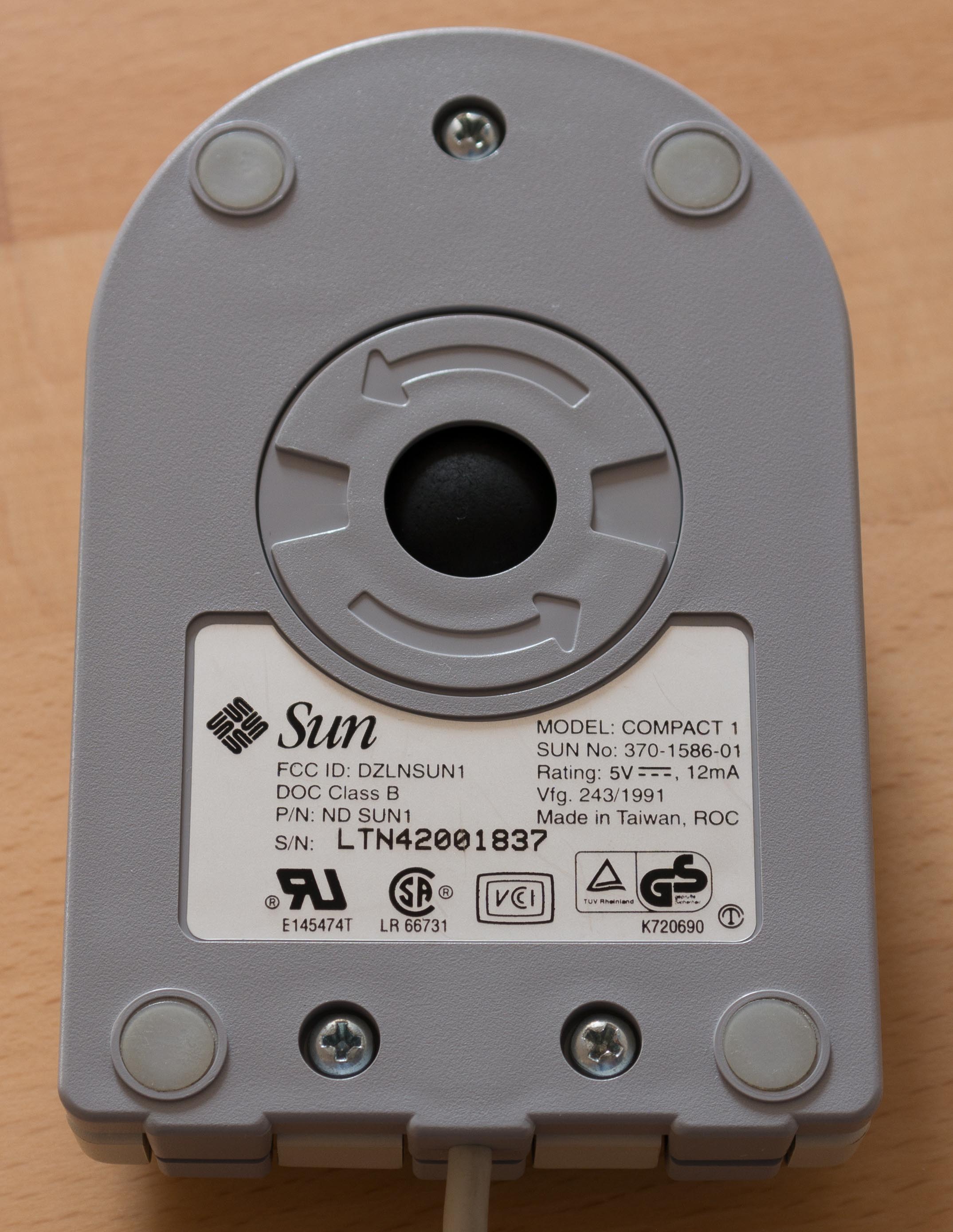

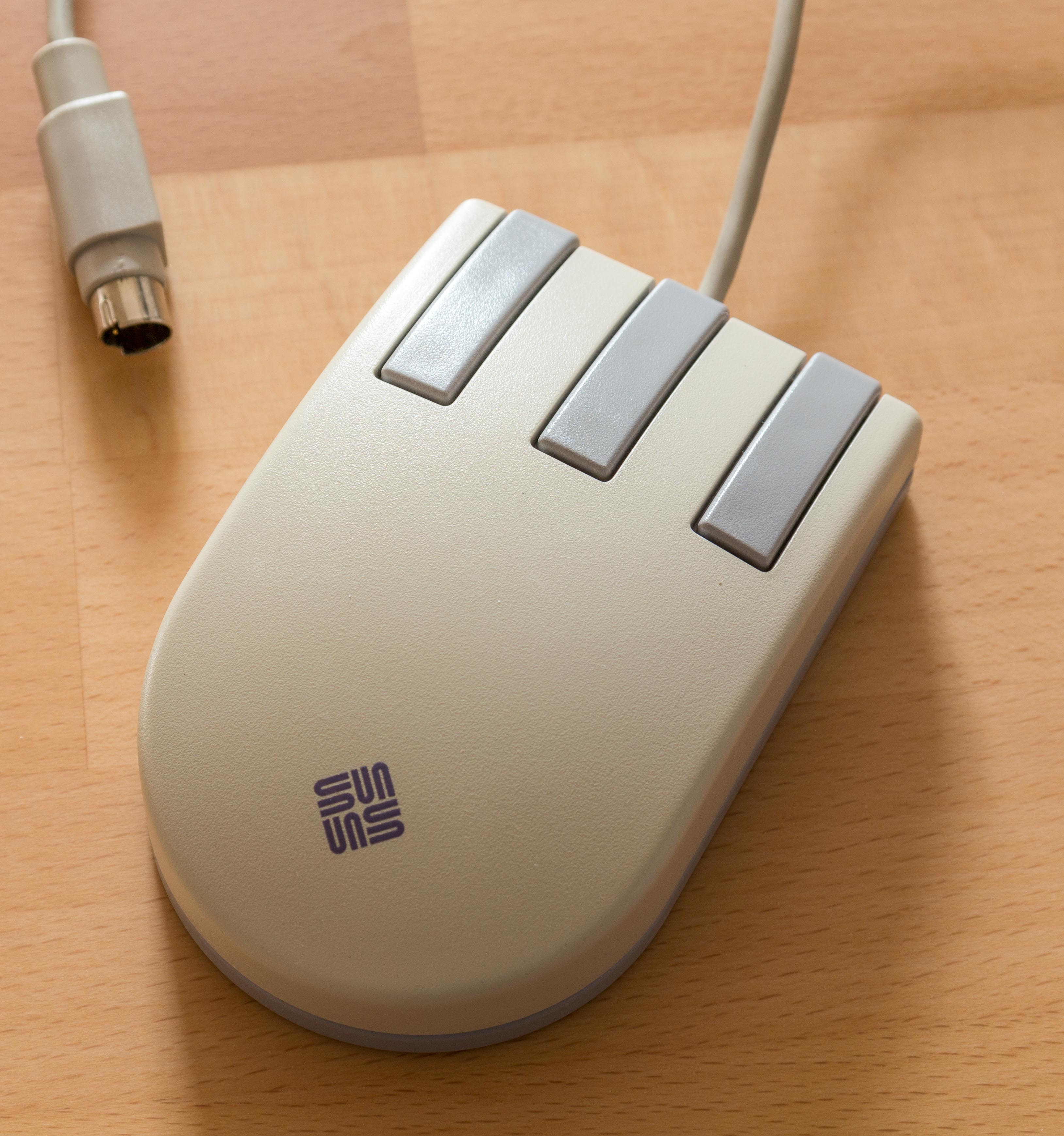

The accompanying mouse
According to the sticker - specific for this compact keyboard

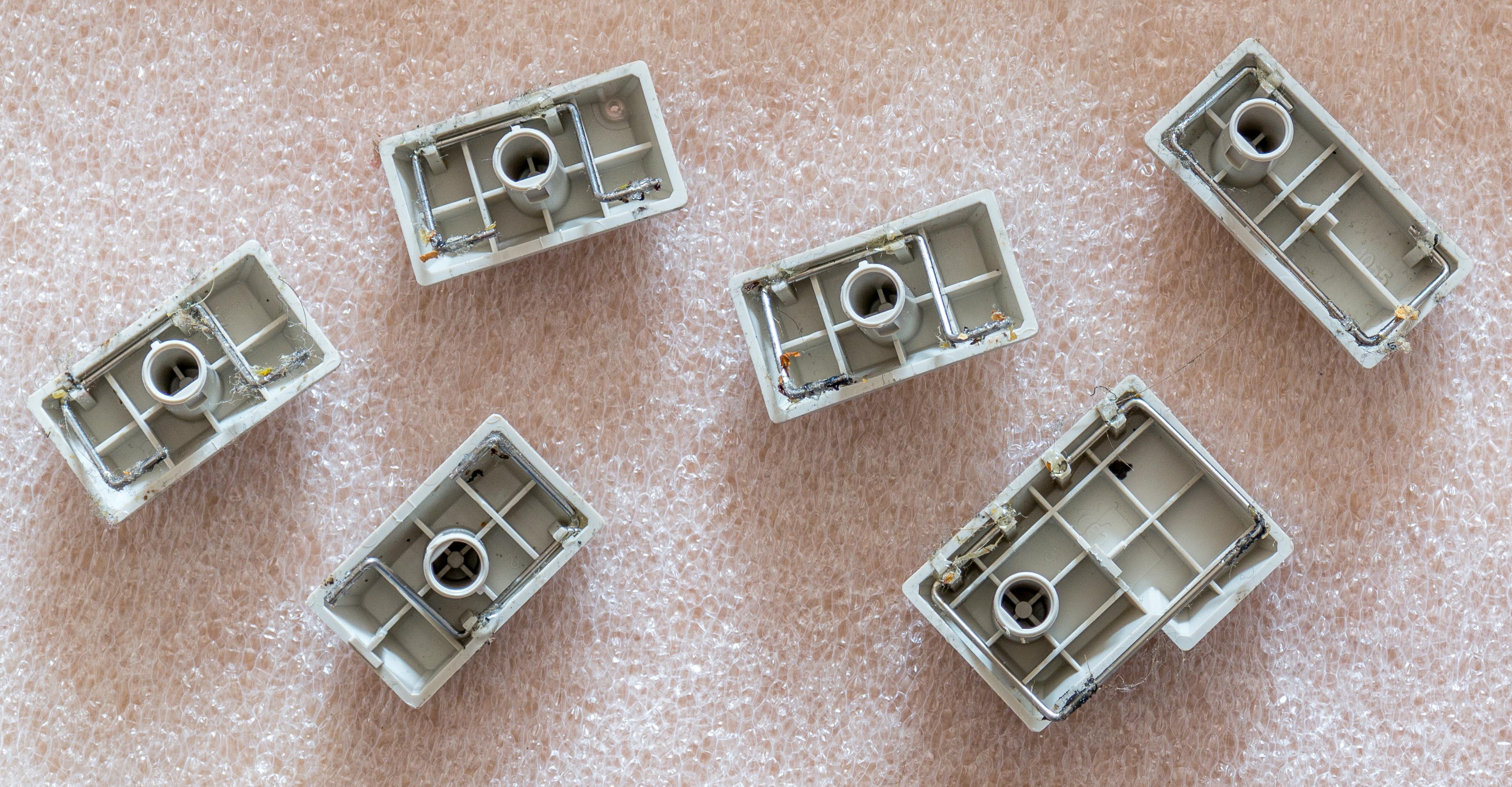

Stabilized keys (even the 1.75u keys like CapsLock, left Ctrl ("Strg") and right Shift are stabilized)
... with 24 years old - but still juicy - lube, including collected dust

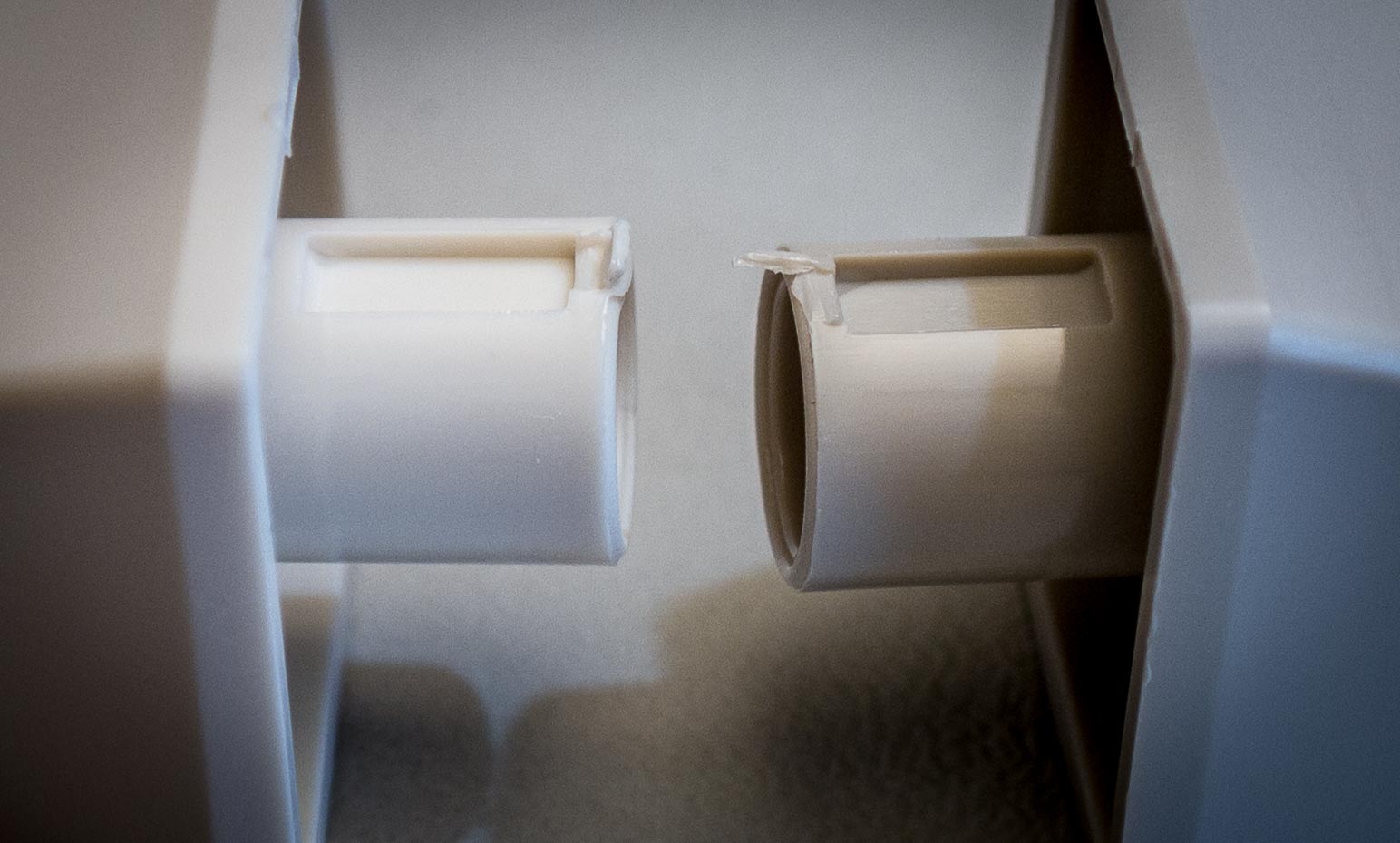

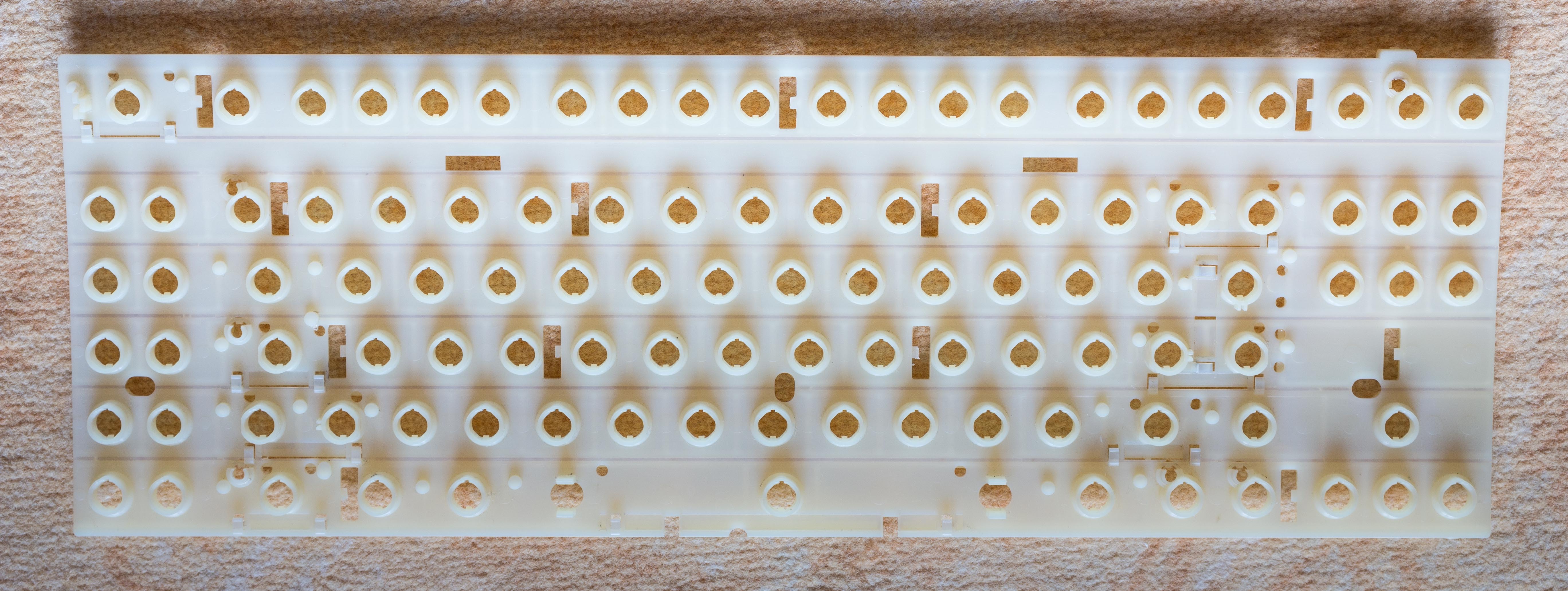

Another detail of maintenance unfriendly-ness: When keycaps are taken off, the hooks of the barrel plate rip out a piece of plastic.

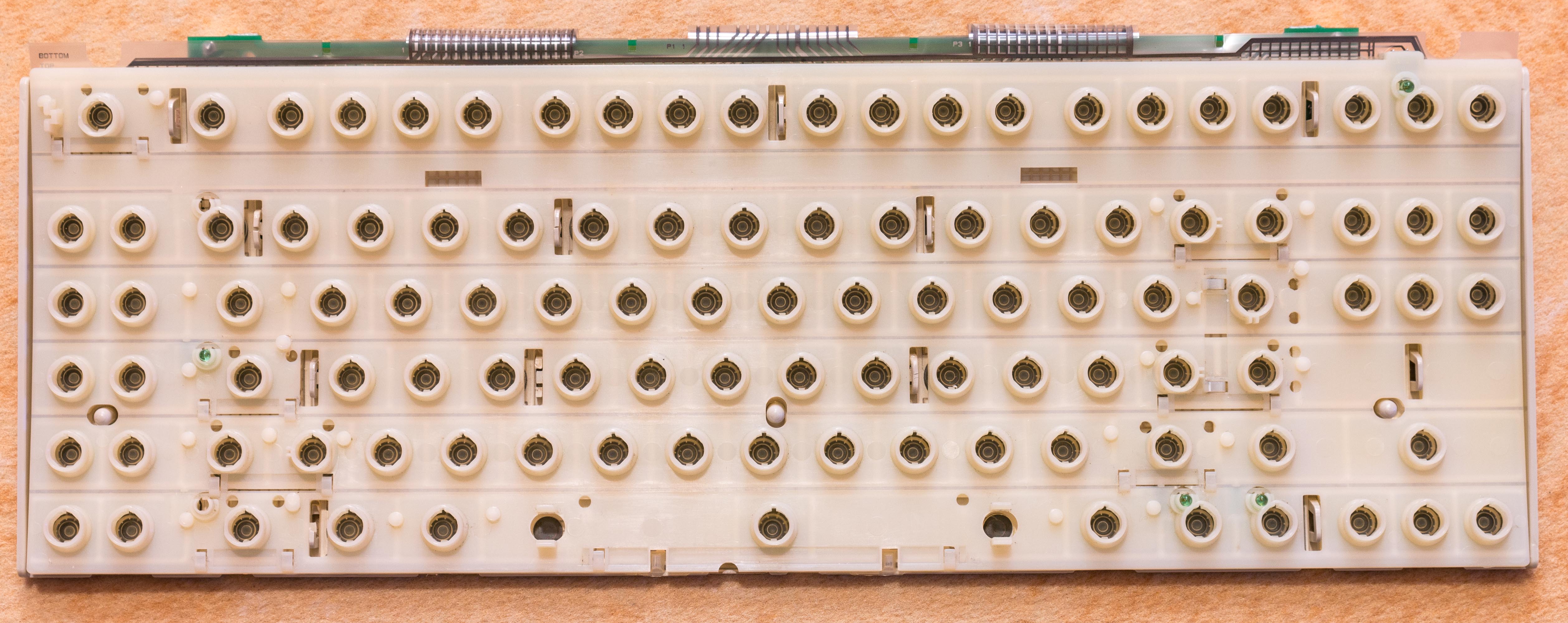

The barrel plate - after cleaning

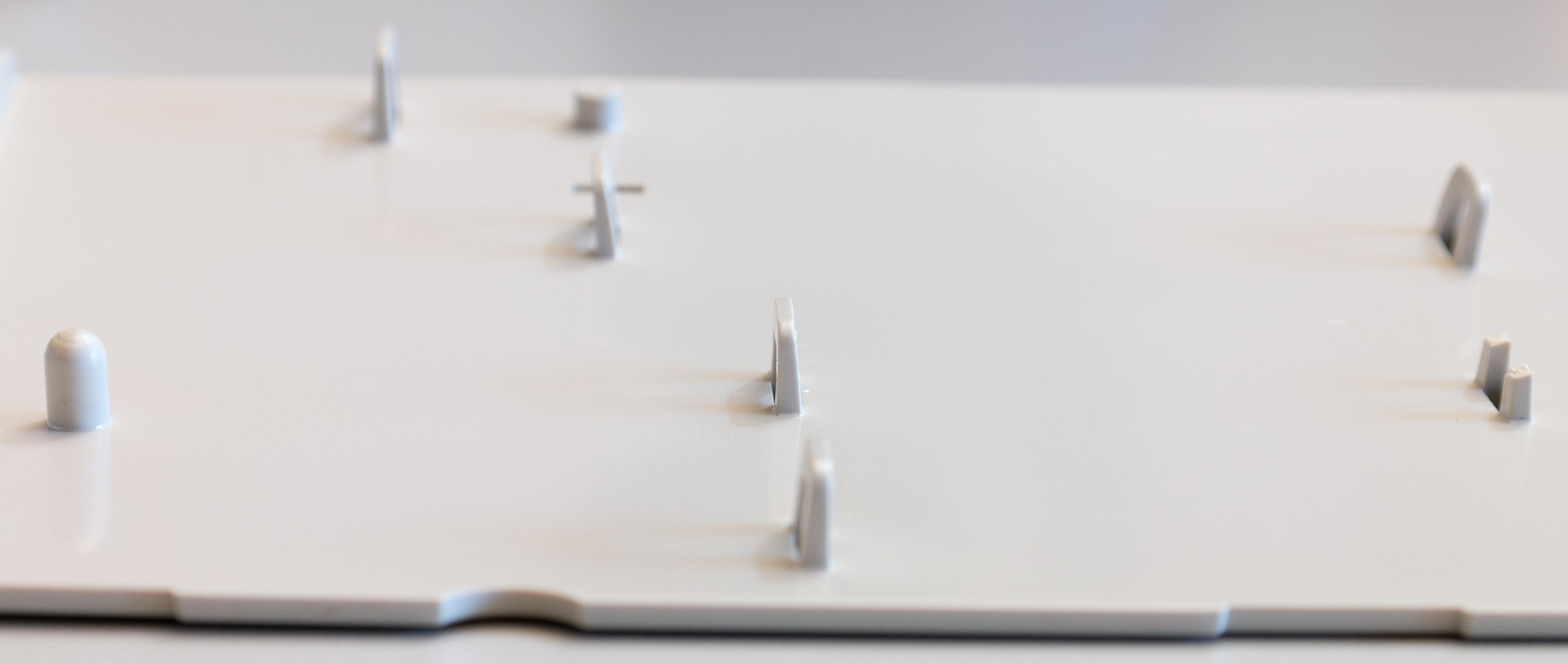

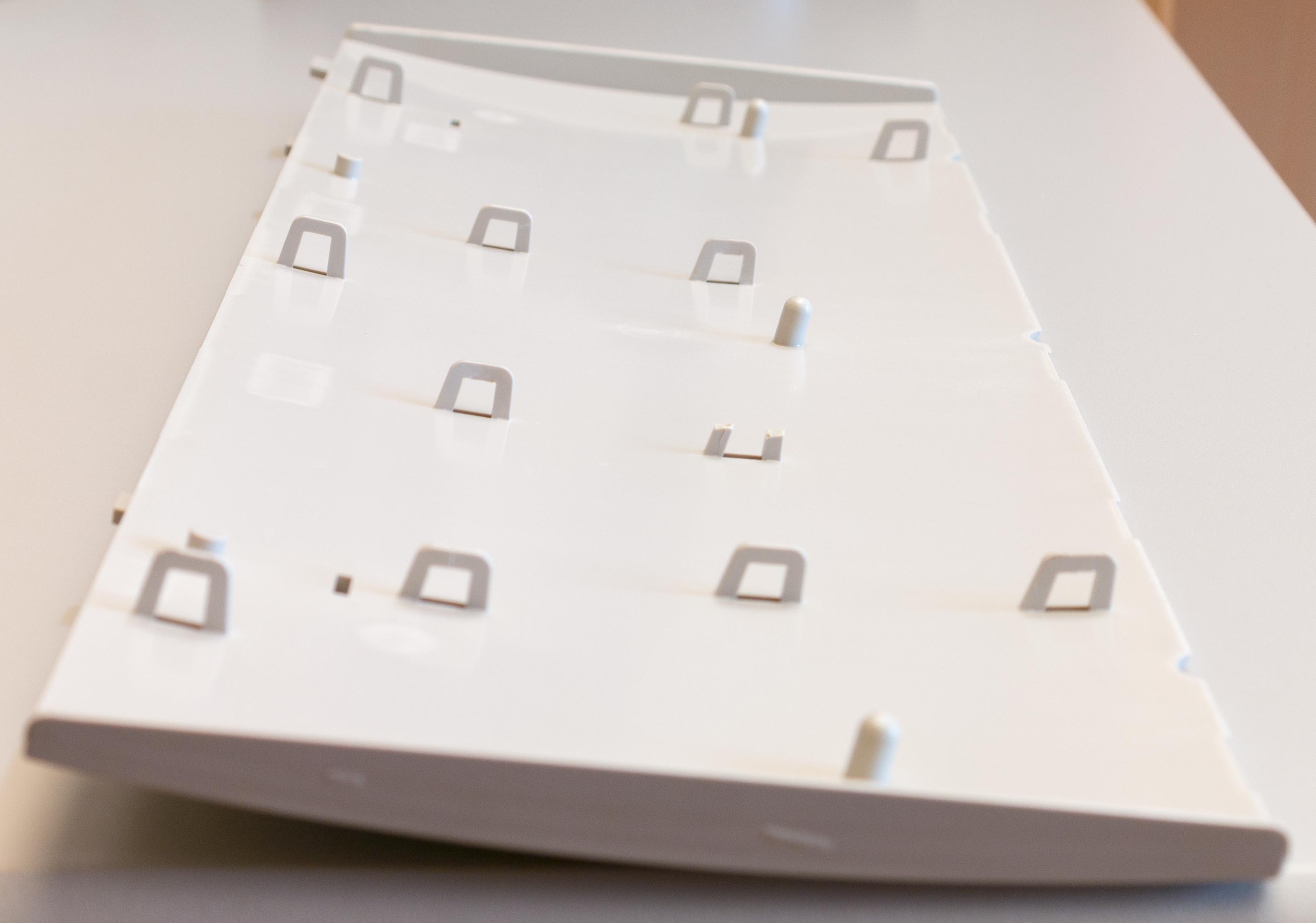

The back plate with little arches that (should) clip onto hooks of the barrel plate. (One was already broken off)
Others have never been clipped into the barrel plate, instead - after 24 years - they're bent to the side.

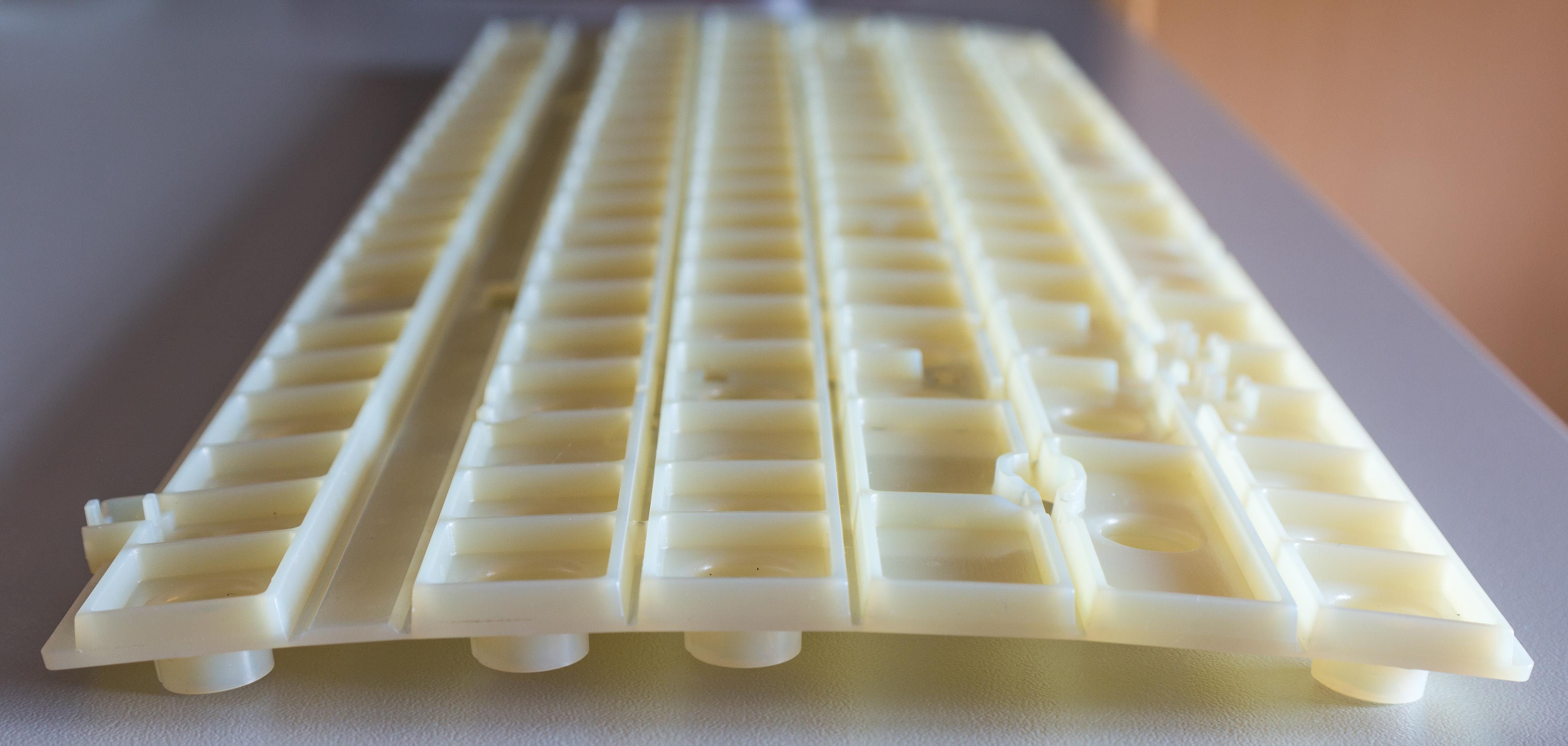

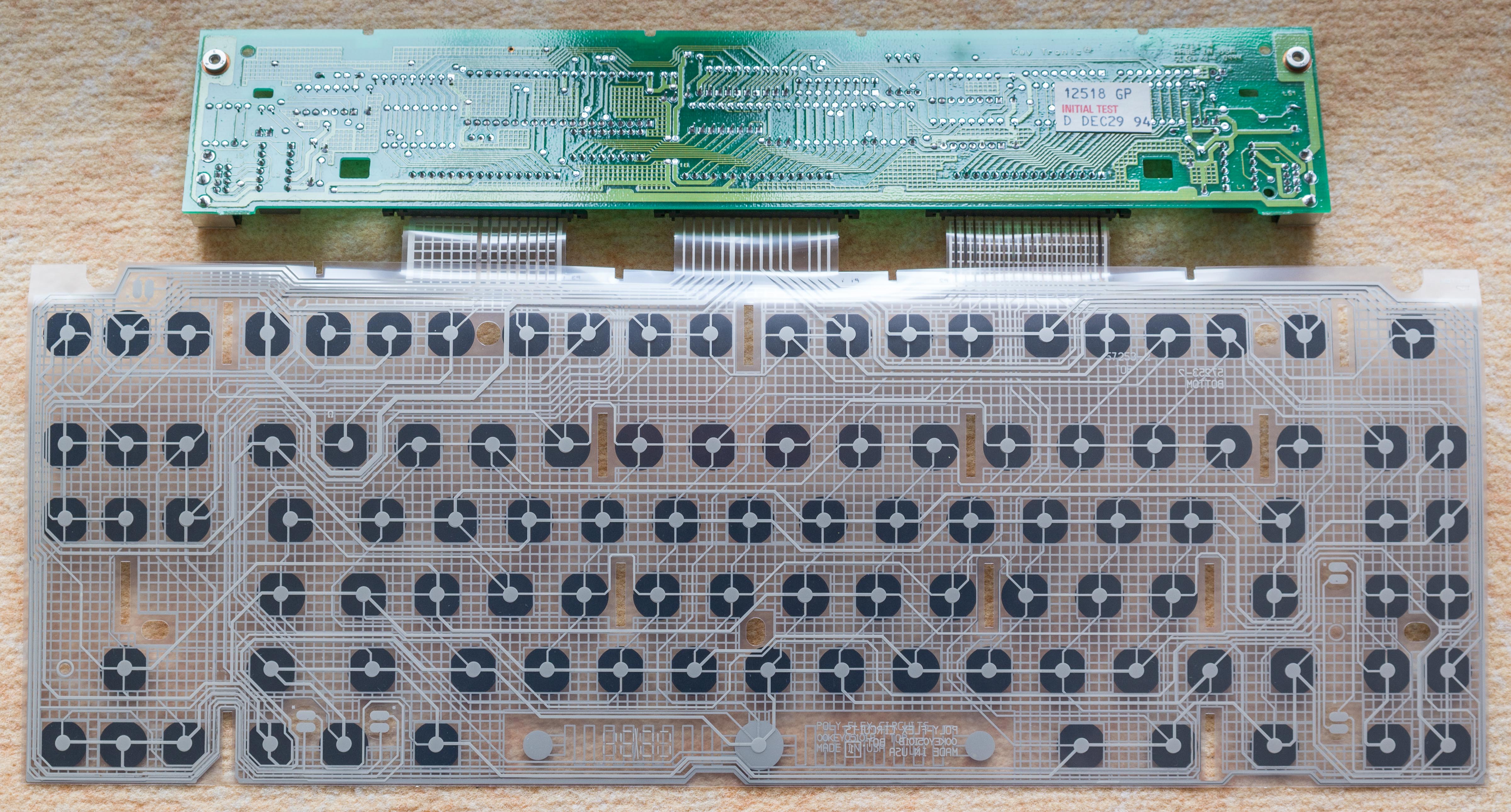

The membranes. Interesting information on the controller board: a test date from Dec 29 1994.
Plate sandwich, put back together. (The bent arches had been bent back - after slightly melting them. During assembling another half of an arch broke and a few others cracked in the middle of the top, but they're still doing their job.)

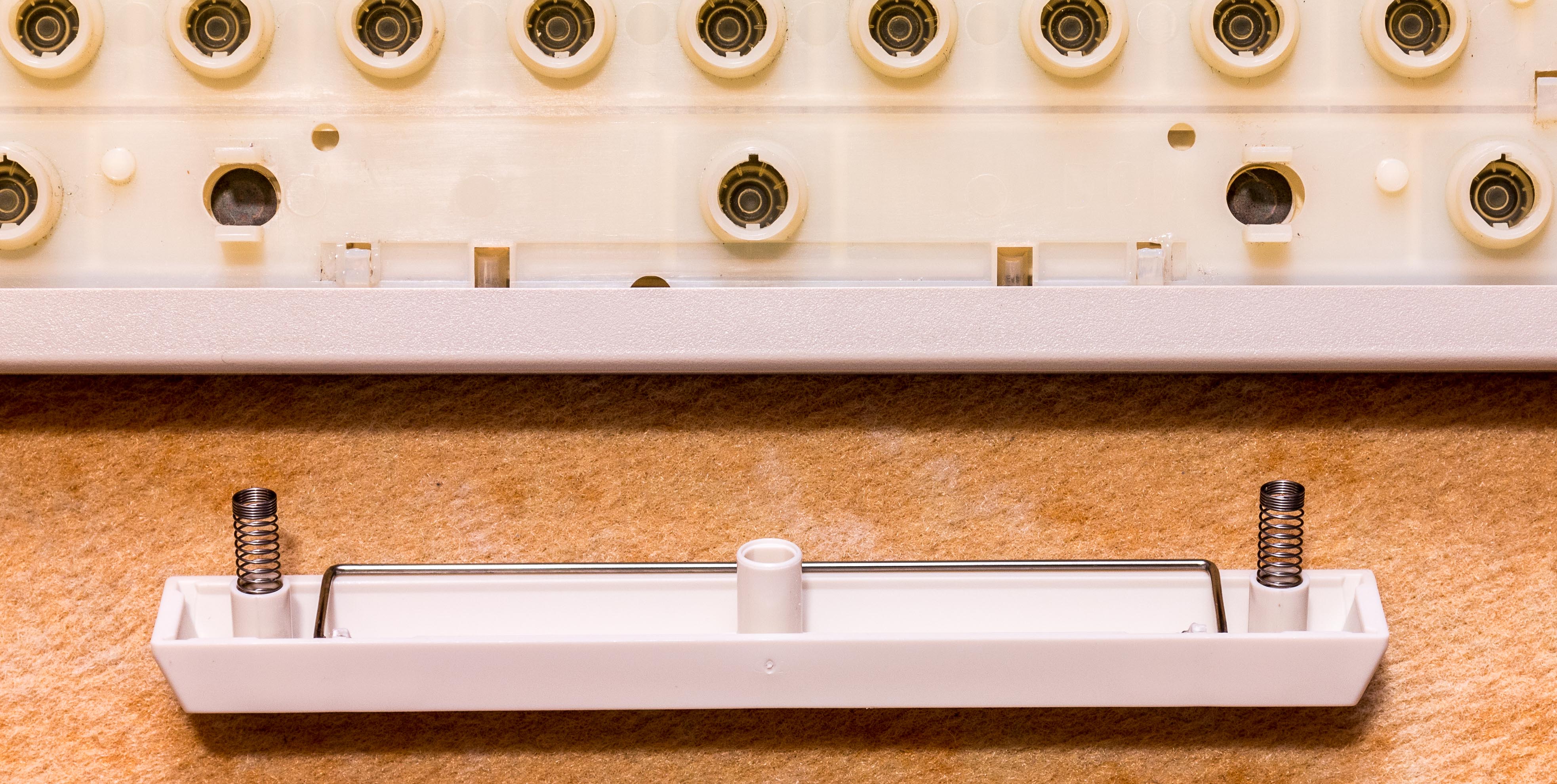

Then the Sun engineers must have thought, what can we do now? That can't be the end of terrible key feel. Ha! Let's put two more springs under the spacebar, that is already mushy and wobbly, and let's put them on the very ends of the key, so that the already struggling stabilizer gets a real workout.
And so they did. I present - the worst key in history:
For documentation - one big and 2 small cracks, that must have been caused by an accident and which I glued back together. (Two more of the narrow beams of the top case broke during disassembling and after glueing them too, they broke during assembling - and 2 tiny new cracks appeared in other places.)

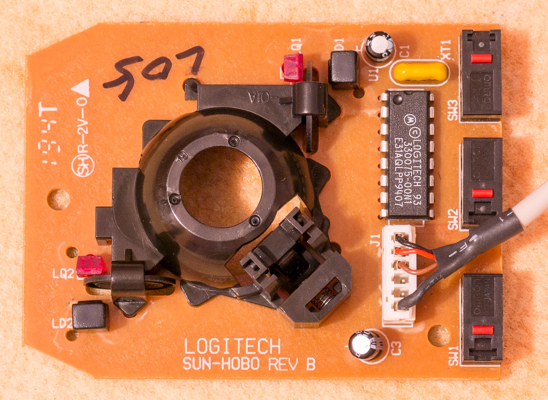

The internals of the roller mouse (made by Logitech - as usual)

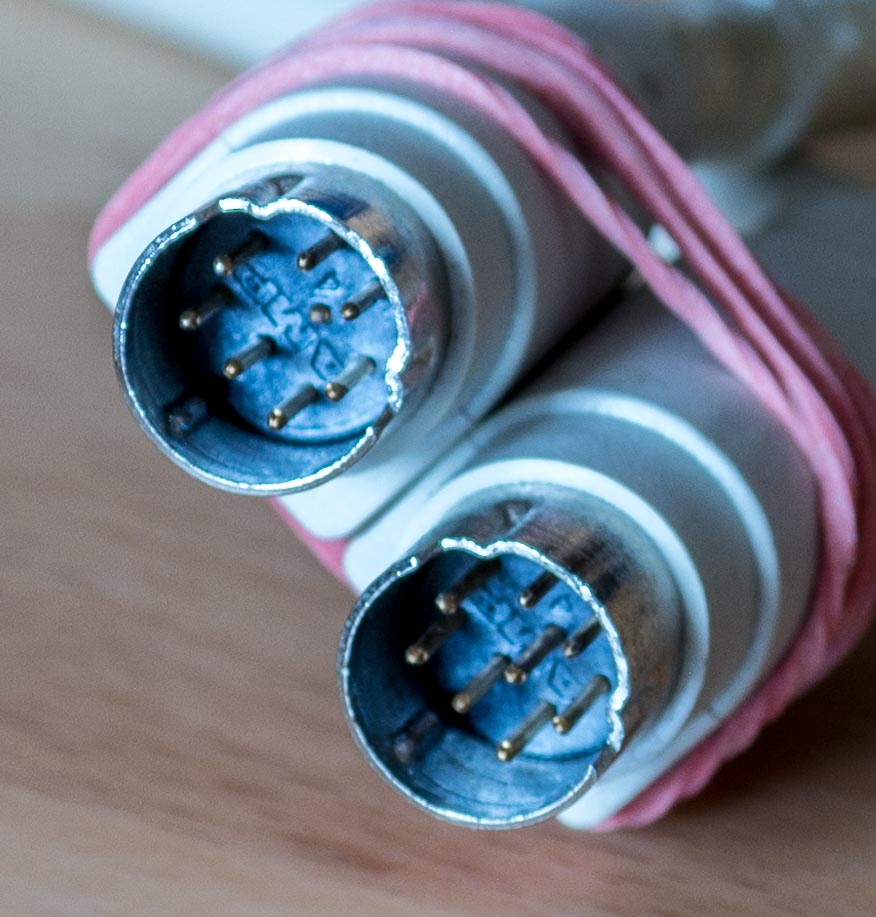

Because I hadn't done my research, I tried to plug the proprietary connector into a PS2-USB converter, which pushed the additional pin in the middle into the connector. (top left - compared to the intact one bottom right)
