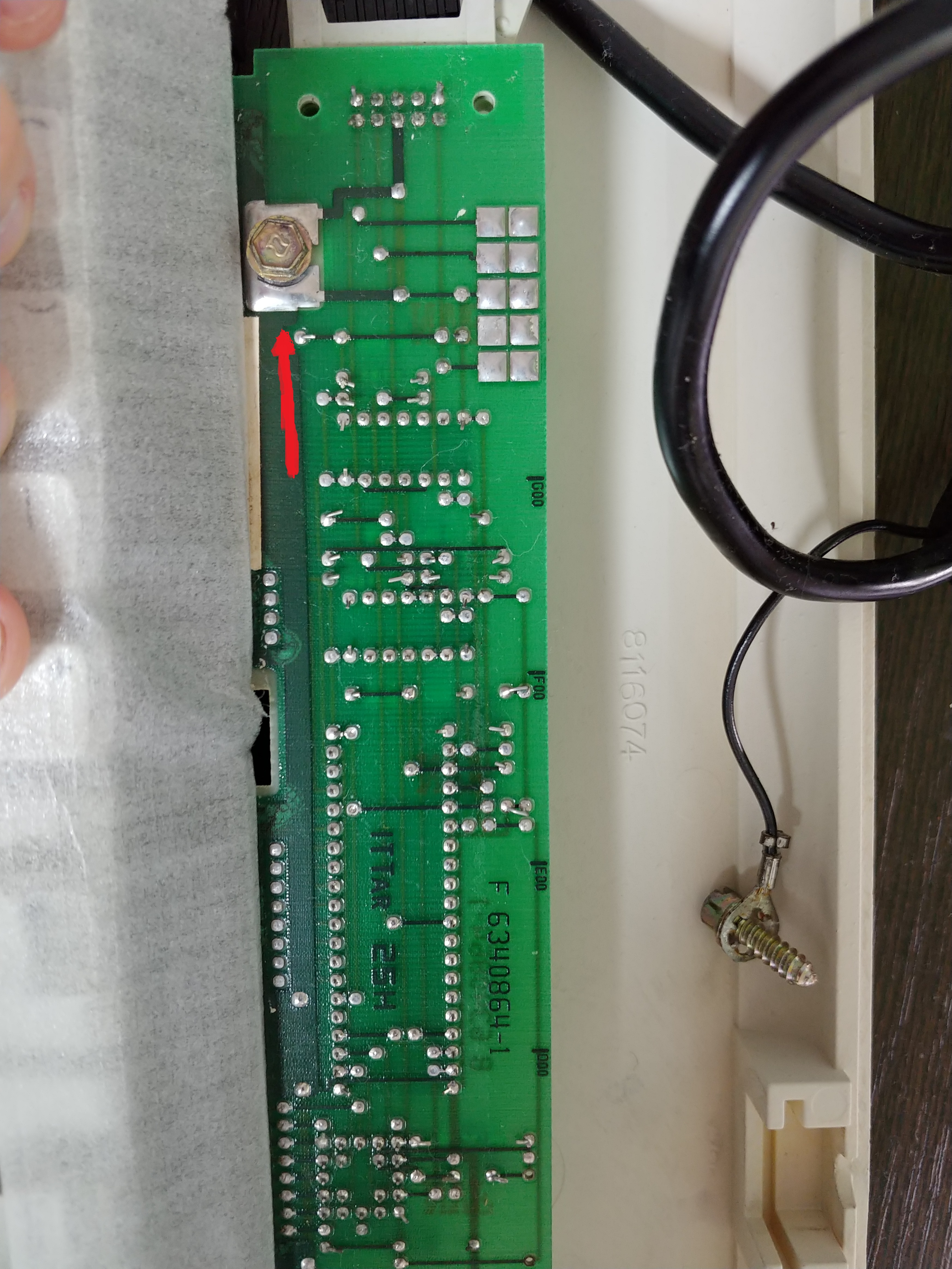

Just as I was preparing to add photos to this thread, I noticed this screw(see attachment) being a little loose, about 1cm off the contact pad and the washer sitting on top of it. I tightened it down and excitedly reassembled the keyboard. I think this fixed the problem or at least made it much more bearable, as I could now press on the keyboard and hit it without getting random characters on screen. The only way to get it to write unwanted stuff was to drop it on my desk from a distance of about 30cm (moment of silence for the desk please), and even then it was a single space bar, instead of the endless train of characters it used to type before. I came back with this because maybe someone else will have a similar problem in the future and this might be of use.

Dropping any Model F from a height causes the space bar to register. This is physics not a problem with the keyboard; the space bar is so fucking huge it has that much momentum that it overcomes even the atomic return spring on a Model F. It was the ground after all. Just like in an automobile bad ground makes all kinds of wacky shit happen.
