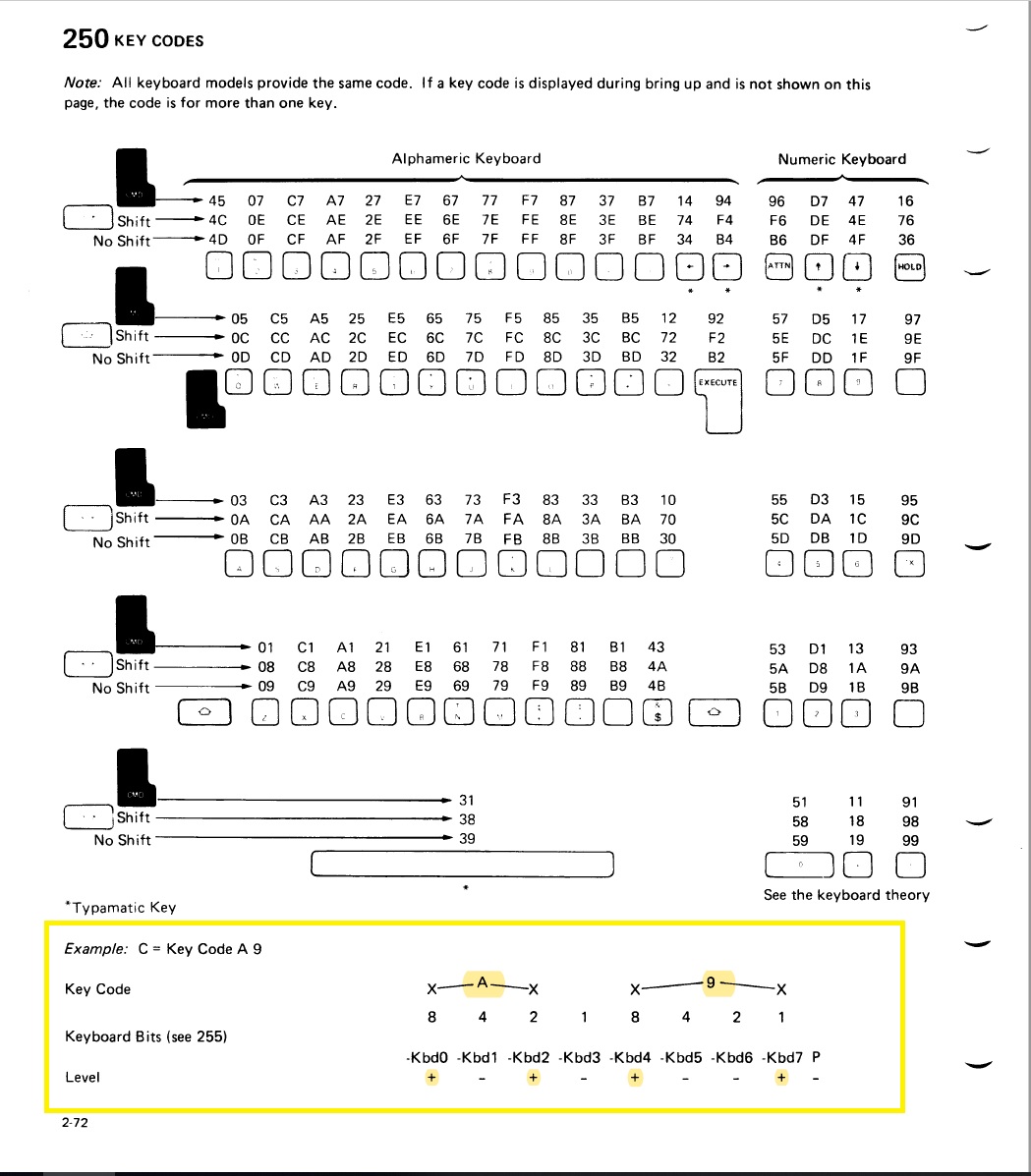

The IBM "5120" is actually an IBM "5110 Model 3" so both keyboards are the same between as they are both 5110s.
Note the scan codes and the bottom of this page explanation on how the scan code is derived (from positive and negative levels on pins Kb0 to Kb7. The "P" or parity line is even if this example is correct. It is highlighted below.
Hope this helps.
IBM 5110 key code.jpg (246.62 KiB) Viewed 11317 times
snacksthecat
28 Nov 2018, 03:43
snuci wrote:
snacksthecat wrote: @engicoder, if it turns out to be parallel I’ll buy you a beer
Buy him a beer!
Hope this helps.
Dude that does help. Thank you so much.
But I swear to God that's an "O"!!!!

Comparing it to others one the same page, it is definitely the capital letter 'O' and not the number zero '0' but the question is, is it a typo.

can You press the 'C' key so that we can compare the effect against @snucis table?

lucar wrote: can You press the 'C' key so that we can compare the effect against @snucis table?
Right now I don't get anything when I hit any keys (except for backslash).

snacksthecat wrote:
On the bright side, I thought about this. Am I jumping the gun or is this really too coincidental to ignore???
Try "A" and see what you get.
snacksthecat
29 Nov 2018, 02:45
snuci wrote: Try "A" and see what you get.
unfortunately no other keys produce any output at all.
snuci
Vintage computer guy
29 Nov 2018, 02:49
snacksthecat wrote: unfortunately no other keys produce any output at all.
Out of curiosity, how about "shift /" ? This is very strange.
