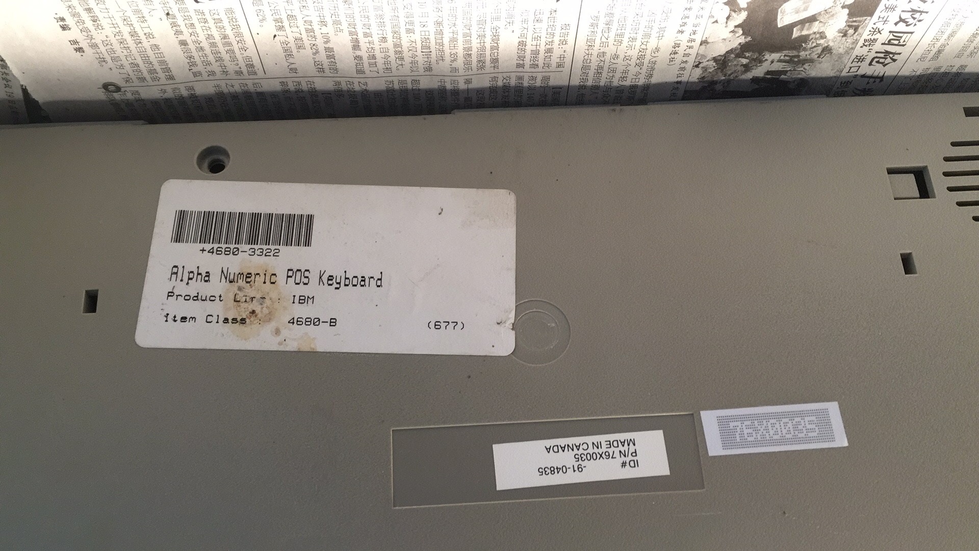

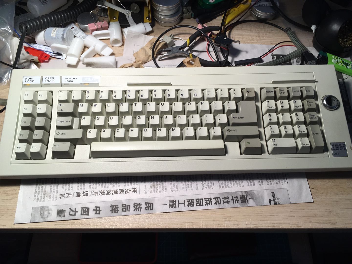

Model 4683 Using on the APOS, Not working on PC.

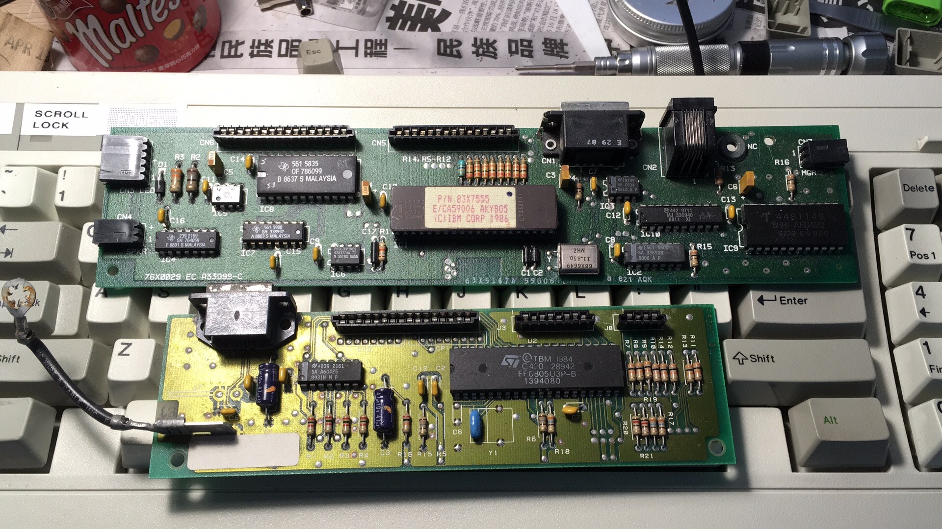

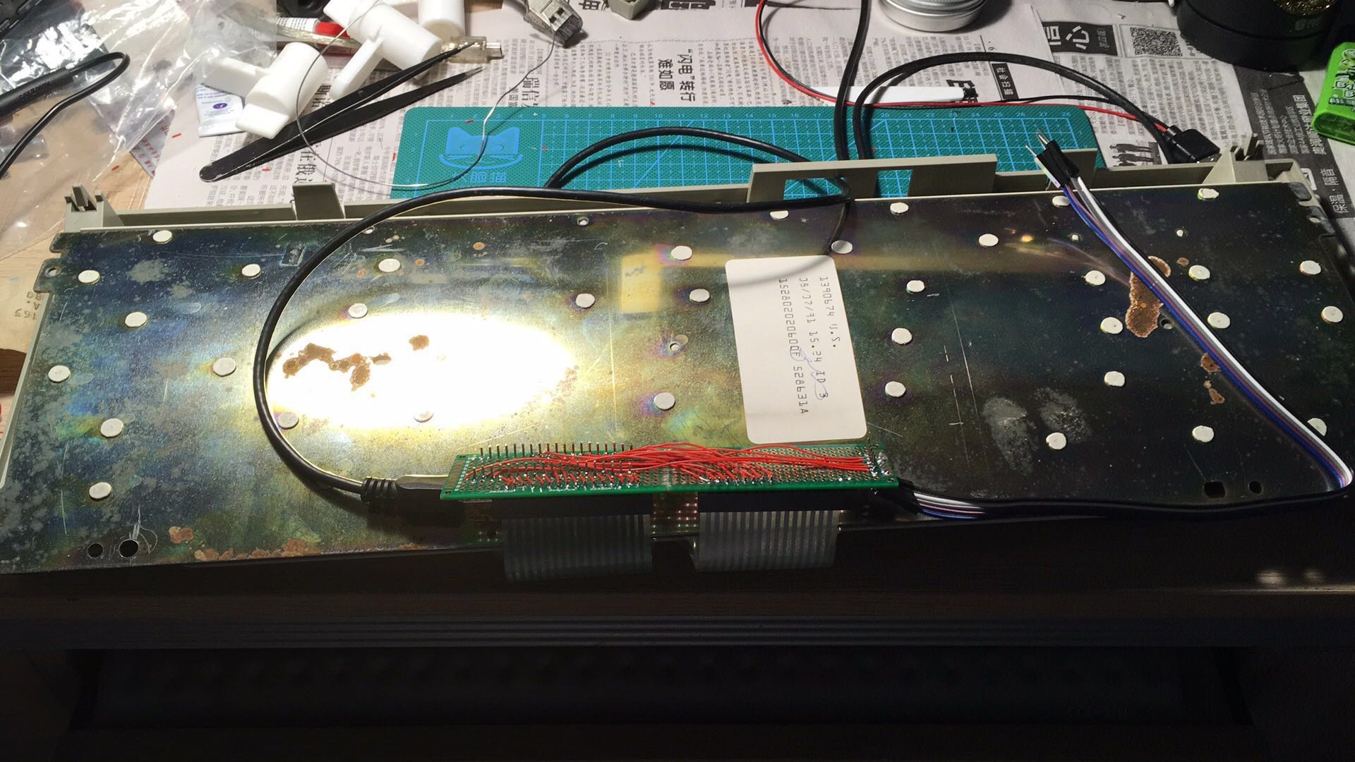

Contrllor repalced,works well now.

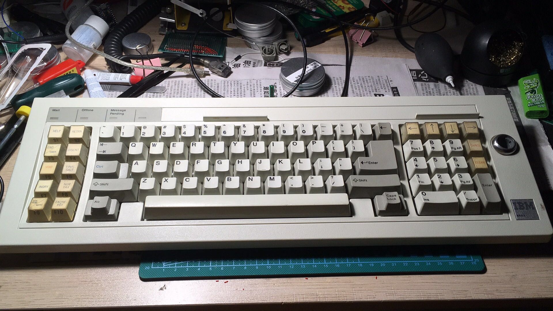

Oh, my, congratulations on your excellent find! Quick questions...

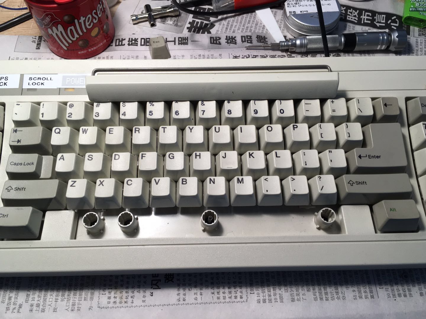

The relegendable caps seem to be the same cheap, fragile yellowable caps that the F107 has. If you want to, see my post comparing those to the one Fentek still sells, and which are much better.
I can't help but wonder if in this unit, as in regular AT keyboards, the space bar can be replaced by 2 1.5U (Alt) plus a 7U space bar.
Could the controller be used to control that extra fourth light in a programmable fashion? (I'm cooking up possibilities for it already)
And that key slot on the right? Does it work? If not, could it be made to? (again, possibilities for it are being cooked up)

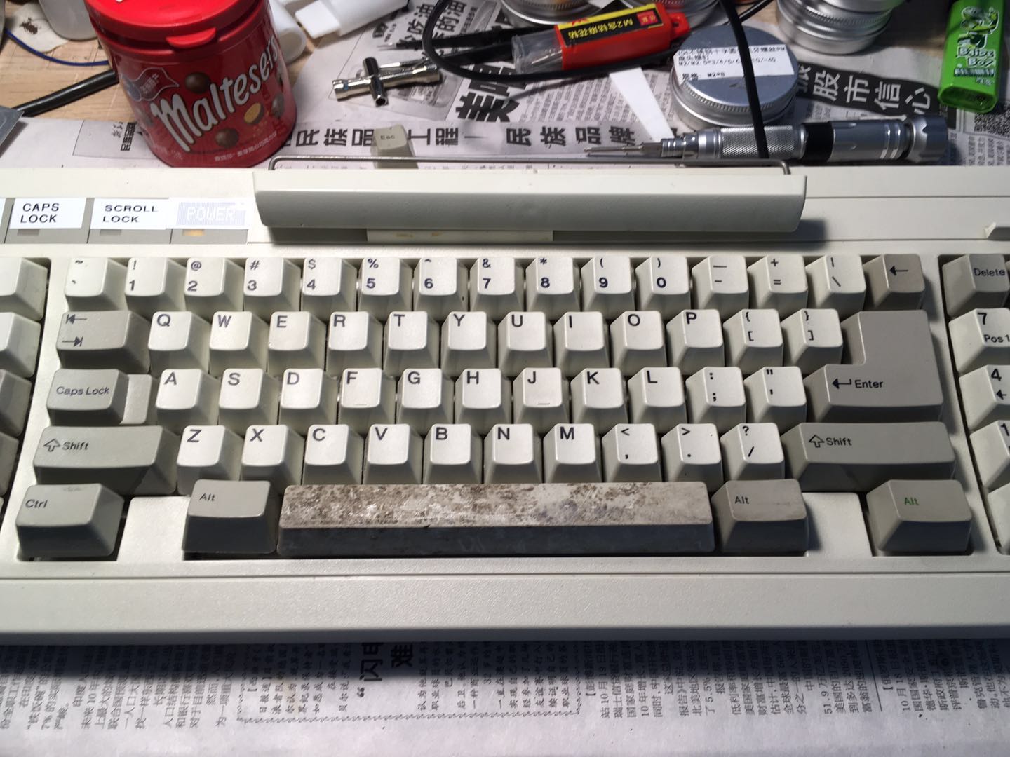

I'm not really know about those key caps,I replaced with M's keycaps,it looks better now.
It seem could change the layout as Model F AT,but need a little surgeon.

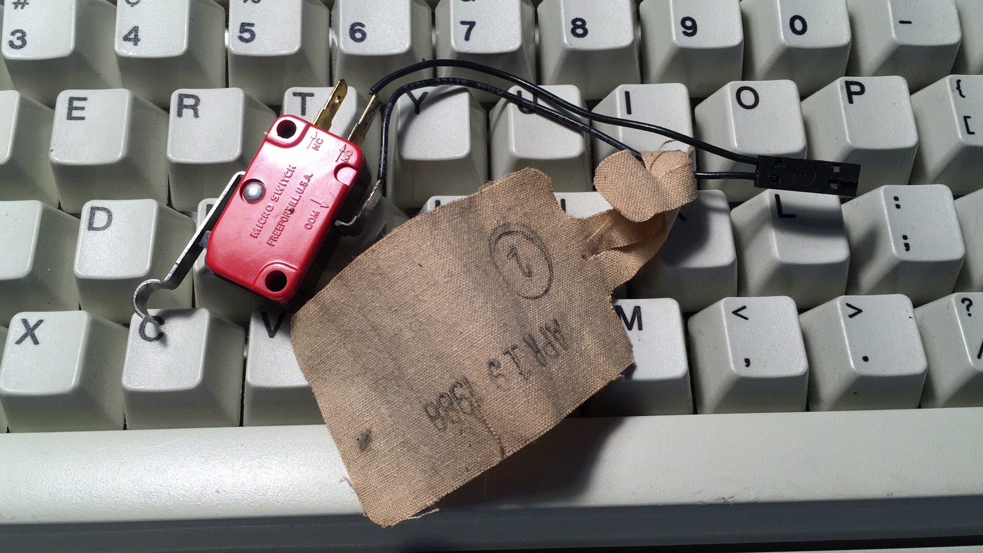

The locker in the right was broken,That was a micro switch under the lock arm,I work as power lock.
I use Soarer's controller,It just handle 3 of light,the fourth light mark power,which directly connect to internal LED.
Those keyboard was made in Canada?
Key feels similarly as SSK,typing lighter and crisp. I got it just under 25 USD makes it very valuable(even cheaper than normal M).
I decide make a customize PCB which can quickly switch the original monster huge controller.
27 Oct 2018, 14:37
watchman wrote: I'm not really know about those key caps,I replaced with M's keycaps,it looks better now.
Based on this picture, it's reasonable to think that you can, indeed, do this replacement (and you could well replace the BAE with an ISO or an ANSI Enter, as well).
watchman wrote: The locker in the right was broken,That was a micro switch under the lock arm,I work as power lock.
I'd love to see this in action again.

watchman wrote: I decide make a customize PCB which can quickly switch the original monster huge controller.
Waitasec... you manufactured this controller? :o

Looks like the lock just needs a new tumbler and lever. It's a standard size. You should be able to buy one from ebay for a few bucks.
