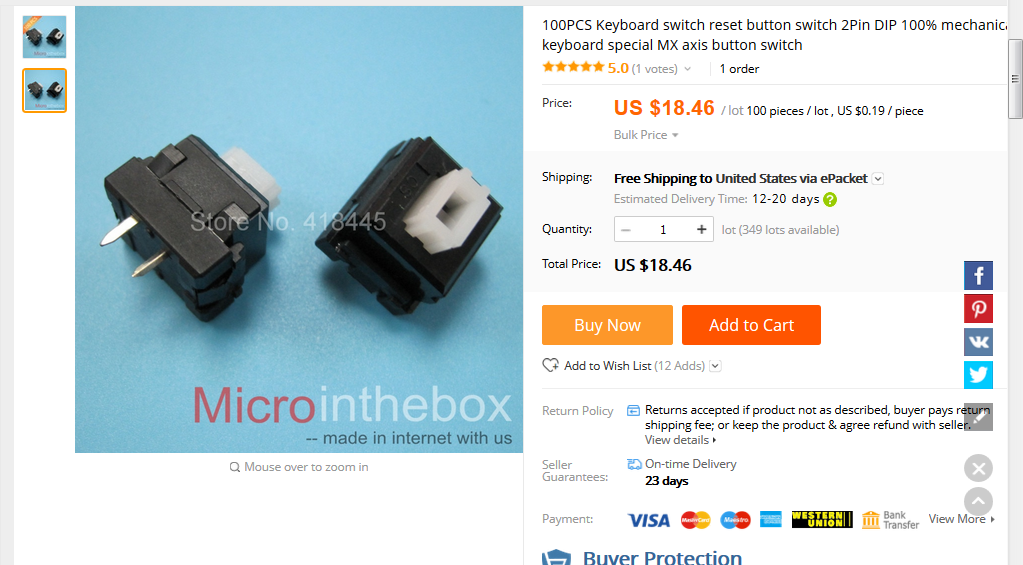

I just ordered these clones off of AliExpress. I've heard rumors of them being very tactile and stiff, but no one seems to know for sure, so I decided to go ahead and buy some to see if they are any good. I found a webpage that states they were made by Litontech. Does anyone know what these are, and has had any experience with them?

Hiya mate, yes, I still have them. They are very stiff, above all.

Fished them out of the box to have a go at them again - they are definitely very tactile. Note that they use a steel mantis-foot style clicker.
Also, mine have three legs rather than two Oo .

Interesting, I wonder if the two leg version has the same spring weight installed. It seems like the 3-leg version would be for special applications rather than keyboards. (Like the Guitar Hero controller switches)

They just arrived and have such a crazy looking tactile leaf! Tai-Hao's looks pathetic in comparison. They feel great to me stock IMO but you can drop in the Alps spring of your choice you get an amazing switch!
abrahamstechnology
27 Oct 2018, 04:02
I'm putting Black Alps springs in mine. They feel somewhere in between Box Navy and Jade, but a much more tactile bump.
If these are electrically OK and free of any chatter (Don't have board to test them in yet) I highly recommend these for modding.

It seems about average to me. Not Alps SKCM quality of course but the tactility is the thing that stands out here.
And if the electrical contacts are complete crap I can just put the clicker leaf and stem in a Tai-Hao housing.

While the contacts aren't gold plated (they look tin-plated), it looks like there are TWO contact points, presumably for redundancy.
I can see this switch as the Aristotle of Alps.

Update: Unfortunately the switch housings don't fit in Alps plates. However,the click leaf and slider can go into a Black Alps housing just fine.
