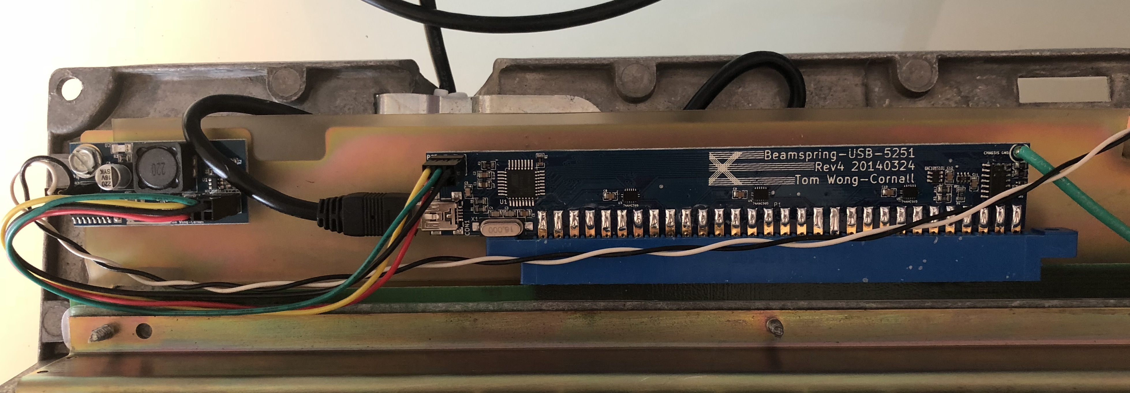

I want to add a lock LED and need some guidance on the wiring.
Actually, the problem I would like to solve is to have an indicator whenever I press the select button for Fn Layer 2, that it is active. Obviously, A Num Lock LED activation would help me also, as I could create a Macro that toggles both.
Anyway, before I blindly start attaching LEDs to the PINs of the extension header, I want to check with you folks who have more knowledge around this.
Sangdrax
17 Sep 2018, 11:48
To do that on an xwhatsit, you need to use the unused pins in the expansion header, which means you're going to need to muck up that pretty connector to the solenoid board. The two LED's are pins 3 and 5 as you can see here. Those pins are +
You'll also need current limiter resistors for the LED's, 220 ohm 'ish for a normal red LED IIRC. Just Ohm law out 15-20mA with whatever the voltage drop is for the thing.
So you need to connect a circuit that looks like this. 3>resistor>LED>ground. I'm pretty sure it's 3. I can't find the file. Might be pin 5. You won't hurt anything either way. If it doesn't work on one, try the other.
You can't swap out what the LED's do without adjusting the code itself. Also, pretty sure you only get 1 LED with xwhatsit and the ability to make it any of the 3 standard locklights. DMA capsense gets you 2 though. Probably more and customization theoretically, but DMA would have to mod the Flight Controller options and the number of Exp pins.
