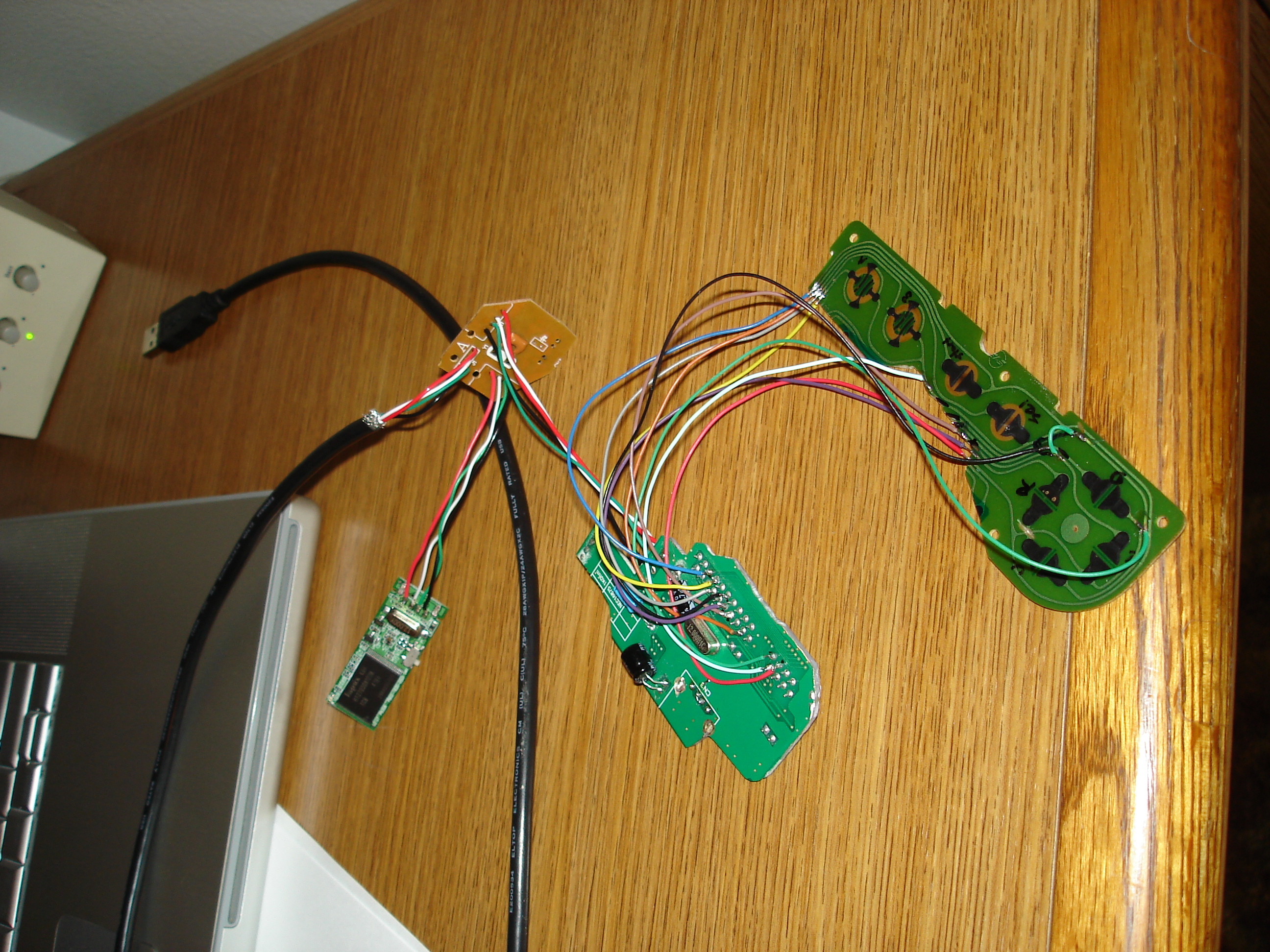

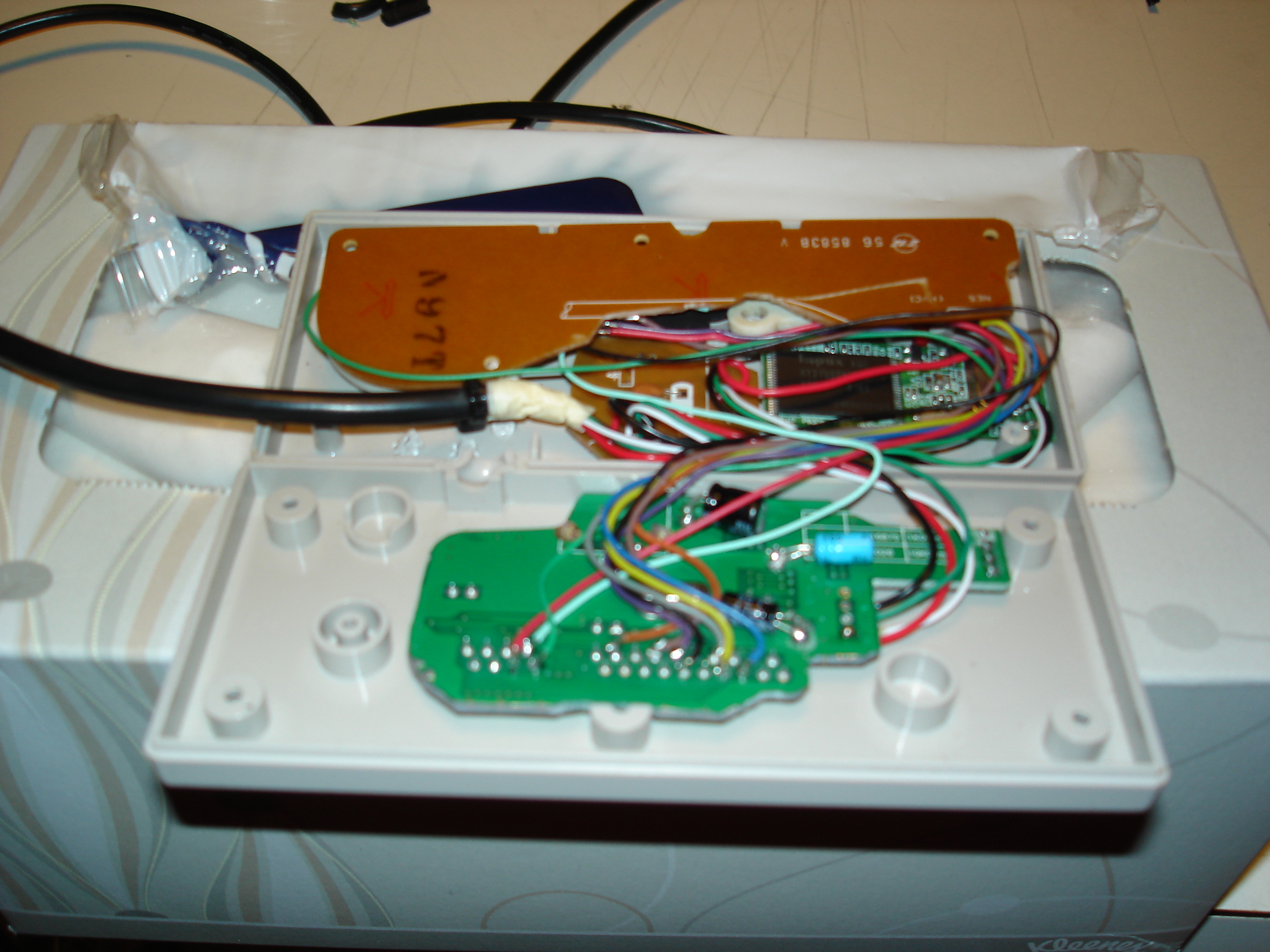

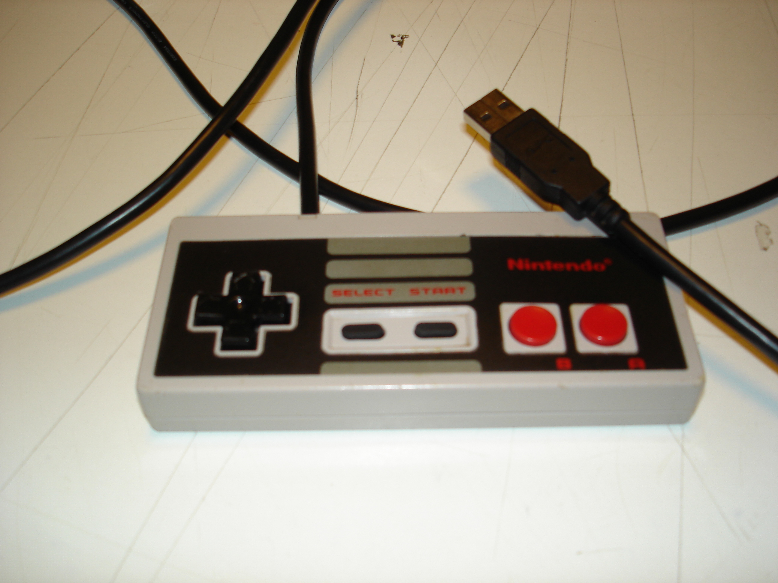

I don't see any reason why you couldn't put a USB hub in a Model M. I put one in an original NES controller about 10 years ago so that I could have a flash drive in there along with a crappy Dell keyboard controller so that files could be stored within the controller and so that controller buttons would produce keyboard presses that could be used by an NES emulator on any OS without drivers. There's way more space inside a Model M than an NES controller if I do say so myself :) This was of course before I knew anything about Arduinos, so you'll have to forgive how MacGyver'ed it is. Basically Dremeled as much of the original PCBs as I could, and it all worked, even without short circuiting! Come to think of it, this was my first keyboard project of all time, before I really even knew/cared about mechanical keyboards. How times have changed ;)
