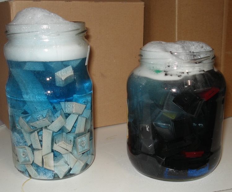

STEW!
STEW!
Tipro stew on the right, random cherry crap cap stew on the left.
I'll leave them in over night. There is no engraving or anything and if the print or whatever it is on the cherrys comes of then all the better. :twisted:

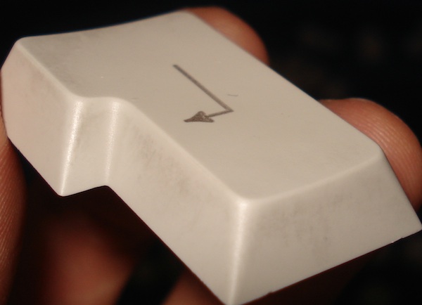

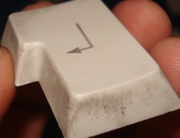

Okay, so the kukident tablets didn't do much at least on the cherry caps. I also tried cleaning them with ethyl alcohol which works better but then again I scrubbed that cap for about 2 minutes.
Cleaned with Kukident denture tablets. The scratches on the foreground side I made with my fingernails so the dirt is obviously quite loose.

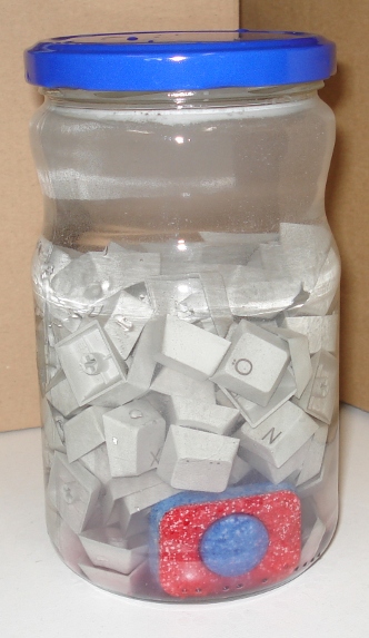

It was in there about 24 h with the somat tab and occasional shaking by yours truly.
Caps survived it just fine, color didn't even come off. They're laser etched or engraved. Don't know the difference. Maybe neither. :p
Dissolved in about 15 minutes.
