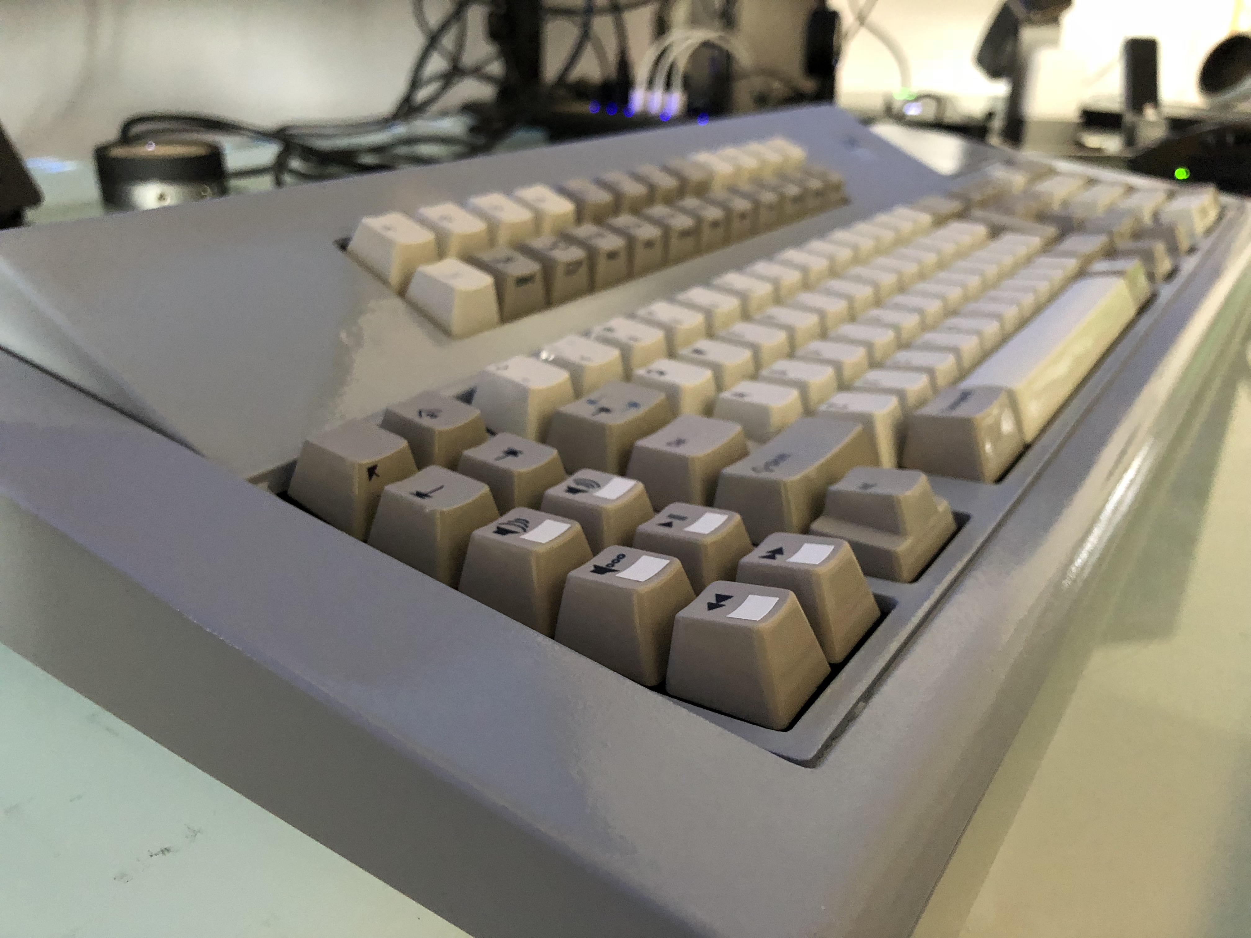

Stage 3 - The new key-caps.
Beige key-caps and a black case don't mix well so I ordered these key-caps from Unicomp. Yes, the legends are off, but it's the best thing I could get, safe for going after a black M13.
Should you want the same key-caps, I ordered them here;
http://www.pckeyboard.com/mm5/merchant. ... code=CPSET
I had to mention "gray printed button set" in the comment field with the keyboard part number. Then Unicomp shot the order down, citing they don't make Model F key-caps. It was only after I told them they're interchangeable that they shipped my order.

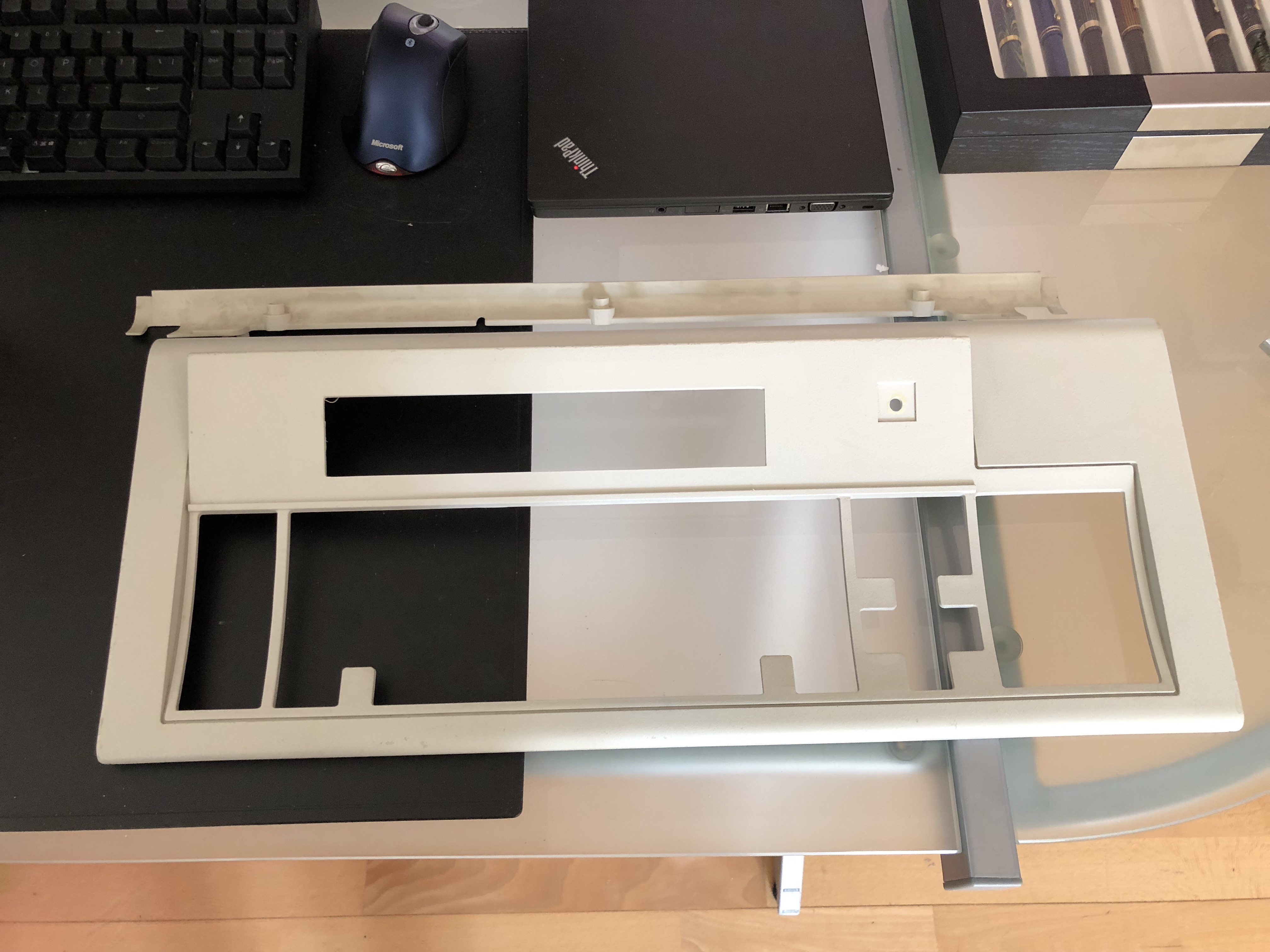

Stage 6 - Painting the case
The hardest and longest part of the project. Painting, wet sanding and vinyl wrapping the metal plate and the base plate was one thing, the painting and wet sanding of the plastic case was the most arduous to get just right. For the metal parts, vinyl wrapping was used over mat paint because it adheres more strongly to glossy paint. The final photo shows the finished product.

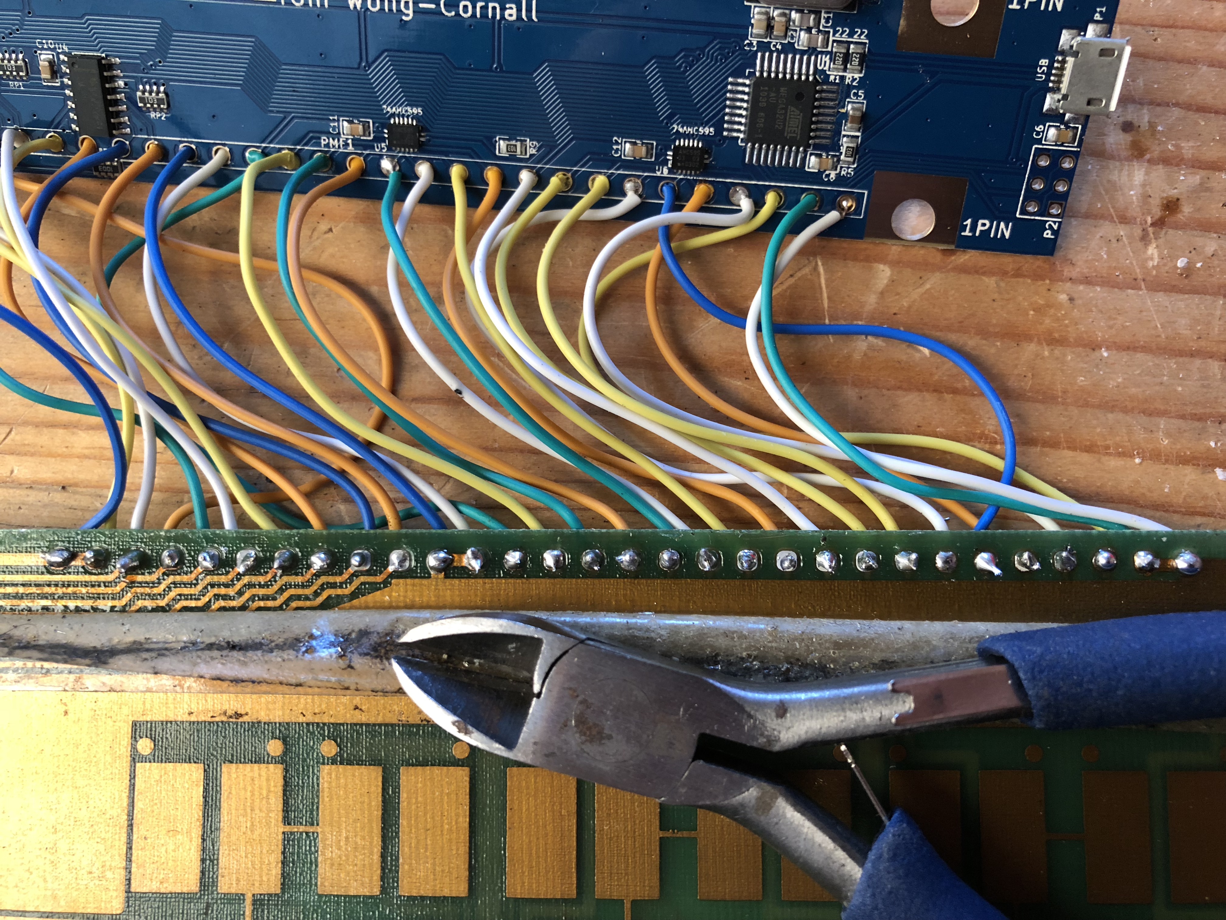

Stage 9 - The PCB
When it came down to addressing the electronic part of the keyboard, it appeared that the previous owner had replaced the original ultra-brittle wires with very thin 28 AVG wires that gave no improvement. just_add_coffee cutted and tinned a more thicker and more robust 22 AVG wires. He also added extra solder to the micro USB connector to the xwhatsit controller (since those pcb connectors break off easily).

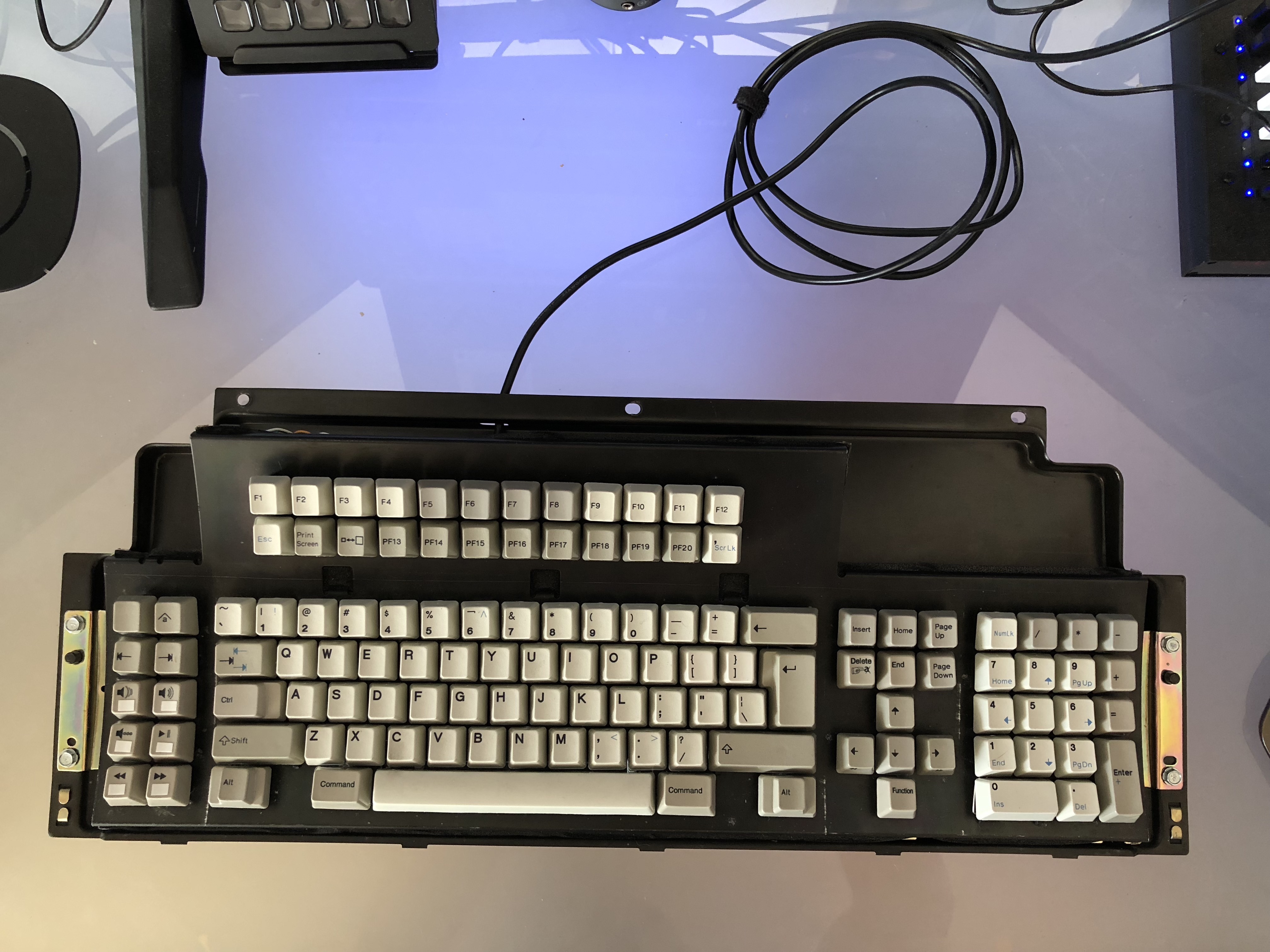

Stage 11 - Assembling
We're nearly done! As a neat touch, a thick lubricant was gently applied to the key-stems; Krytox GPL206. It was done very lightly with an artist brush. The result are even smoother keys. The back end of the keyboard got silicon bumpers at the top and the stock rubber feet beneath. The third photo shows the new supports for the inner base plate.
Oh, and since we're not using the metal tabs (meant for the plastic pipes mentioned at stage 7), those were now bent to tighten the base plate even further.
Stage 12 - Full assembly

The key-cap set I ordered is this one;
I had to mention "Gray printed" in the comment field and the keyboard part number. Of course Unicomp shot the order down with the remark that they don't make key-caps for Model F keyboards. Then I had to tell them they're interchangeable.

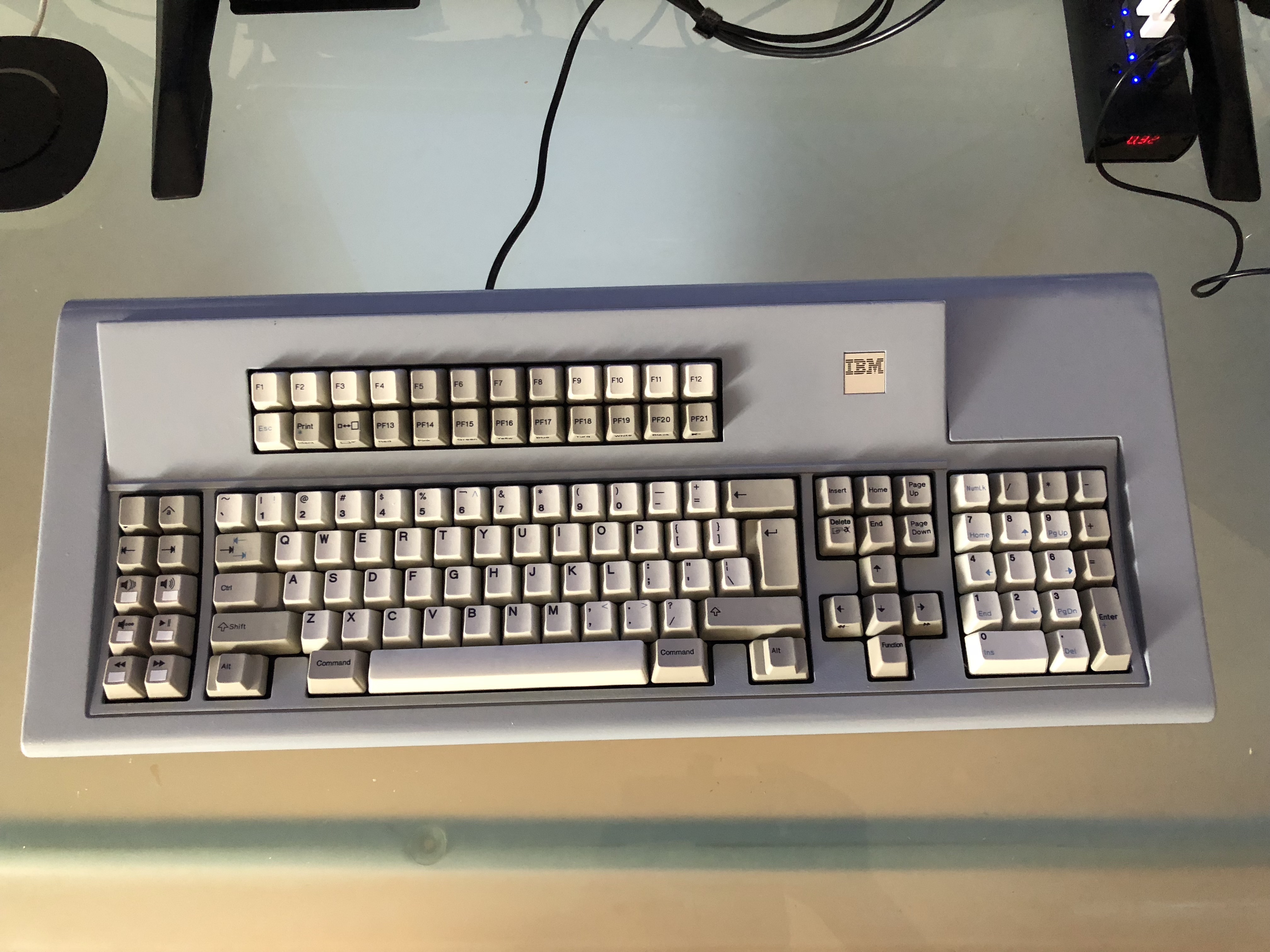

I wanted to share my restoration of the F122 as well. Of course it isn't fully complete, yet, as I still will replace the foam and some of the key caps. I wanted to share a few steps here as well, I went through:
1. Removal of the original keyboard controller and replacement with the xwhatsit one:
2. After cleaning of the backplate, pcb and key caps
3. Removal of the top case and getting it ready for re-paint
4. Removal of the parts that won't get a paint job
5. Result after painting:
Will it ever be ready? Likely not, because I love to change the key assignment whenever I feel it would suit my needs that day.

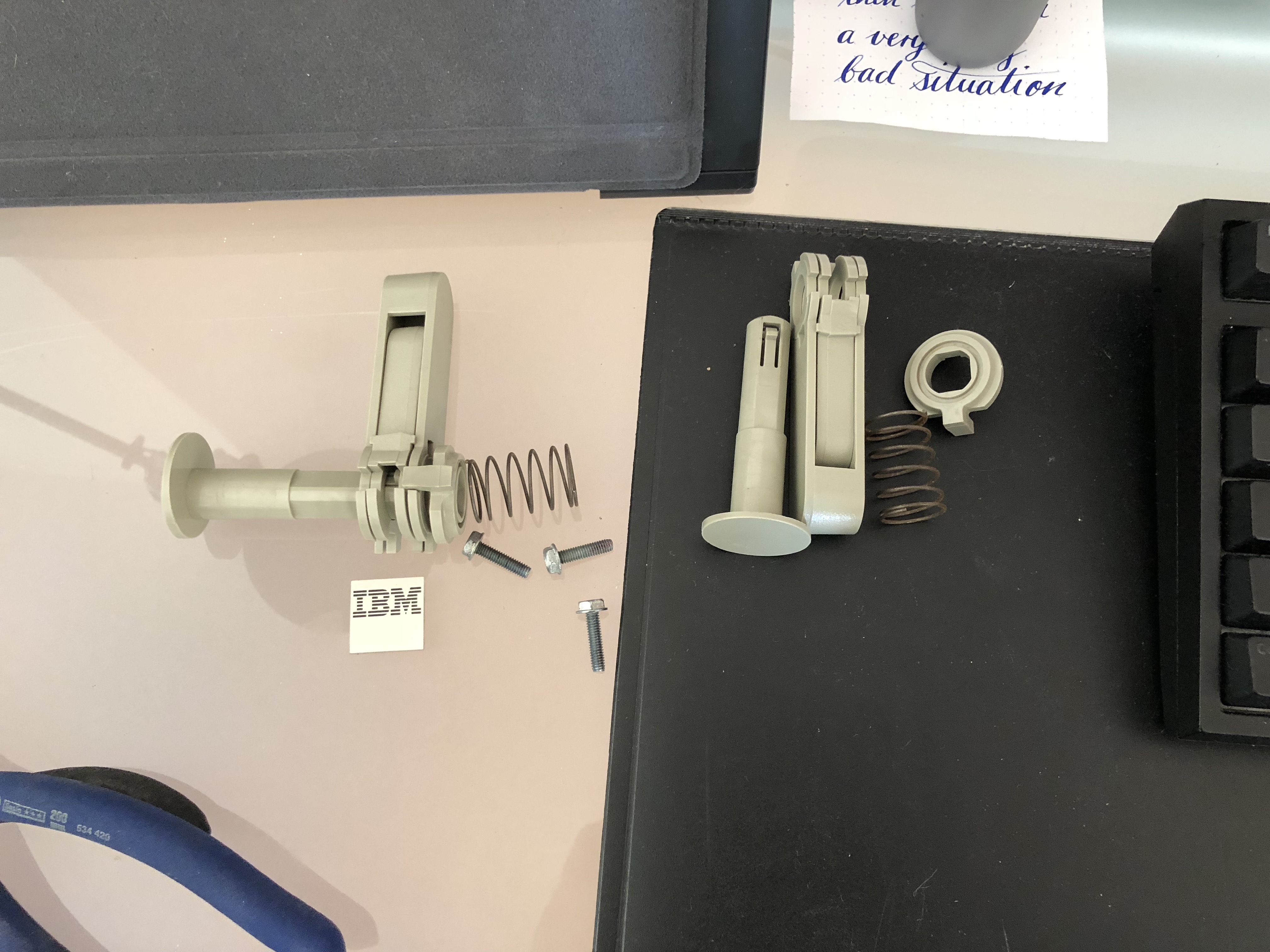

I also have created a new stabilizer for the space bar (Model M Space Bar). The stabilizer has to be 1.2mm spring steel and the top ends did get a pipe with 1.5mm outside diameter around it. Fits just perfectly.

For the black key-caps I bought two sets of keyboard stickers;
-English US with additional key non transparent keyboard stickers
-Selbstklebende Tasten Tastatur QWERTY English US
I'll be on the look-out for additional black key-caps in the future but first I'll wait to see how these turn out.

Those keyboard stickers I got, well, they're not a success.
While the photo demonstrates why I got the stickers they make for an awful feel when your fingers touch the caps, it's somewhat slippery and you can sometimes feel the edges of the stickers.
