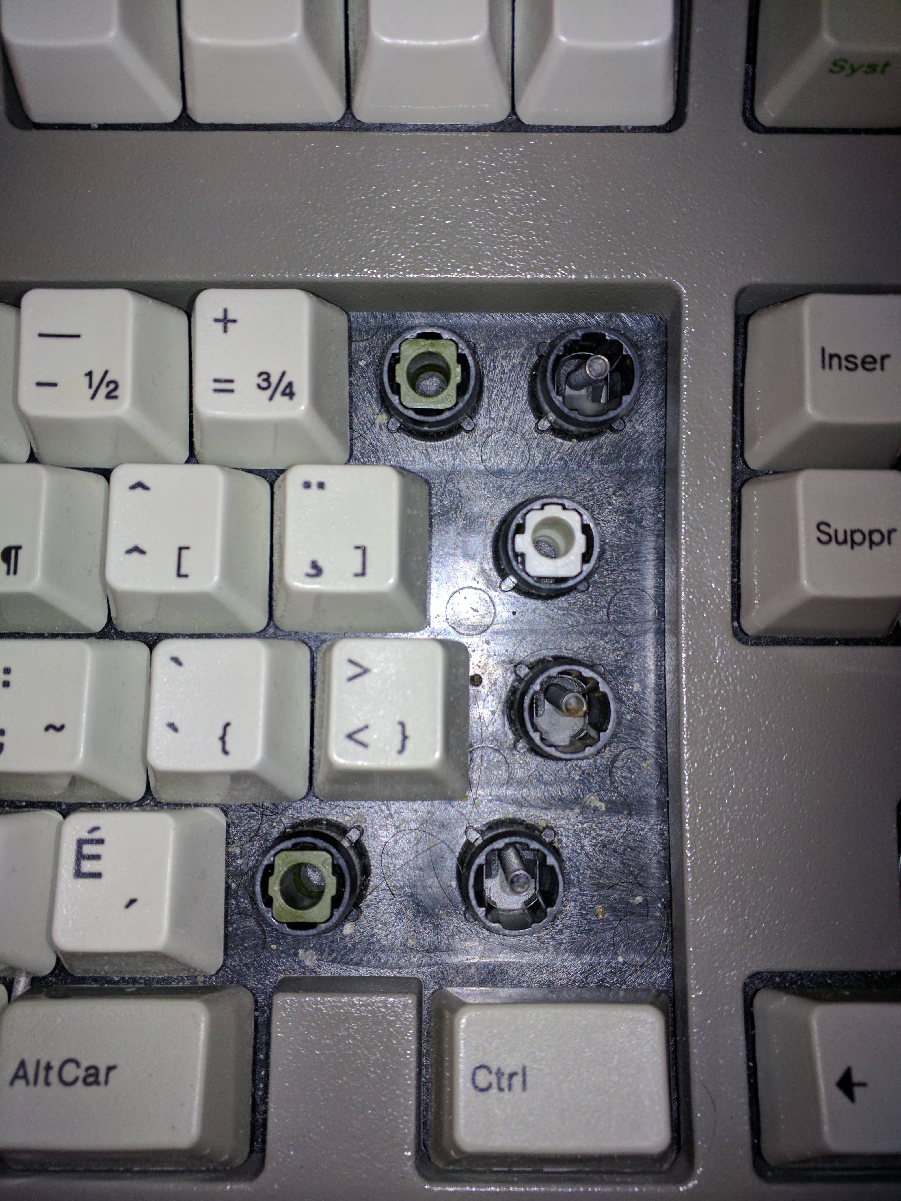

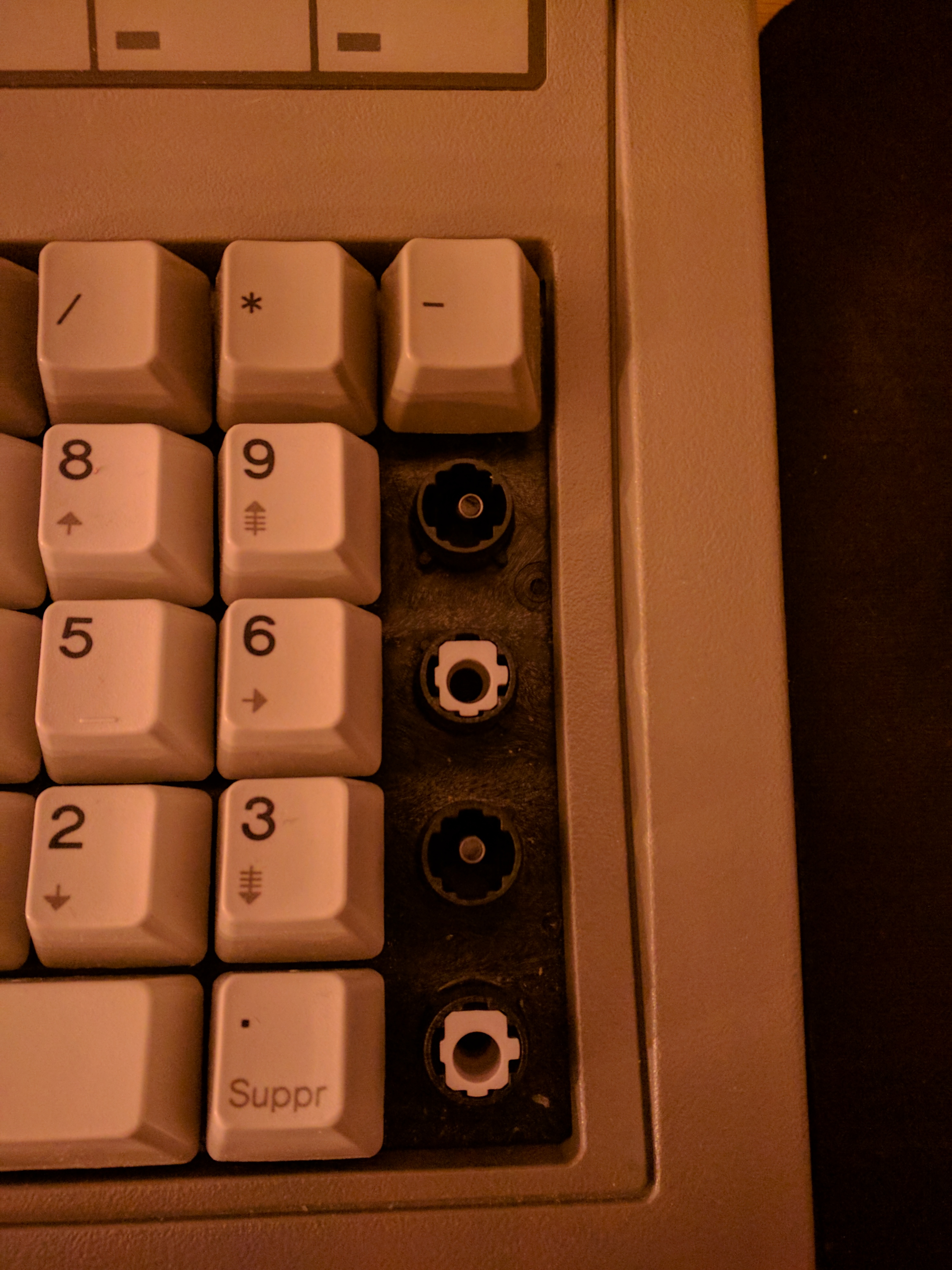

These pictures shows the two styles of stabilizers and how they have to be placed, note the vertical one is rotated 180° depending on if it's installed for an ISO Enter key or on the outer edge of the numpad.
Model M stabilizer inserts, ISO Enter and horizontal keys

Model M stabilizer inserts, numpad
