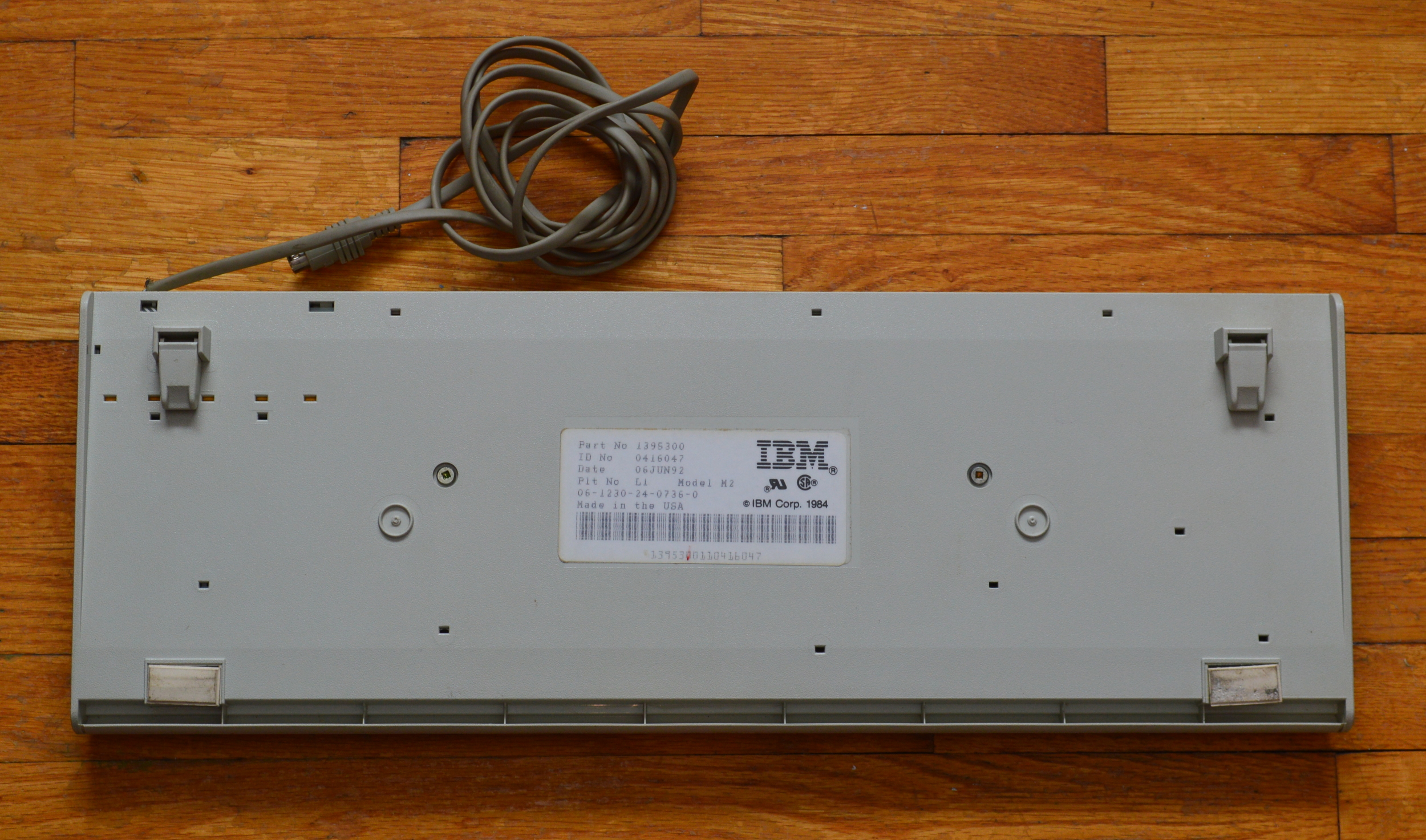

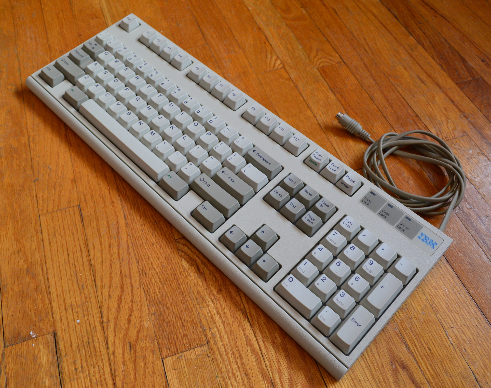

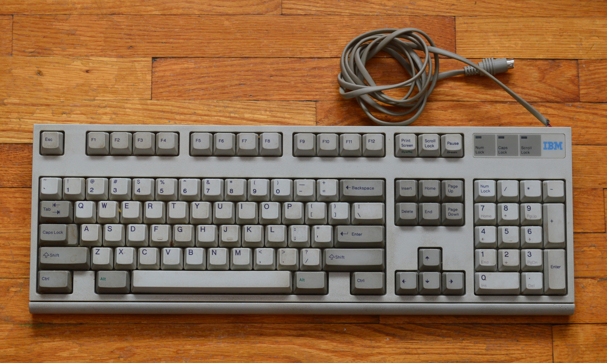

Front and back shots
The keyboard was dirty as hell.
I will spare you the graphic content.

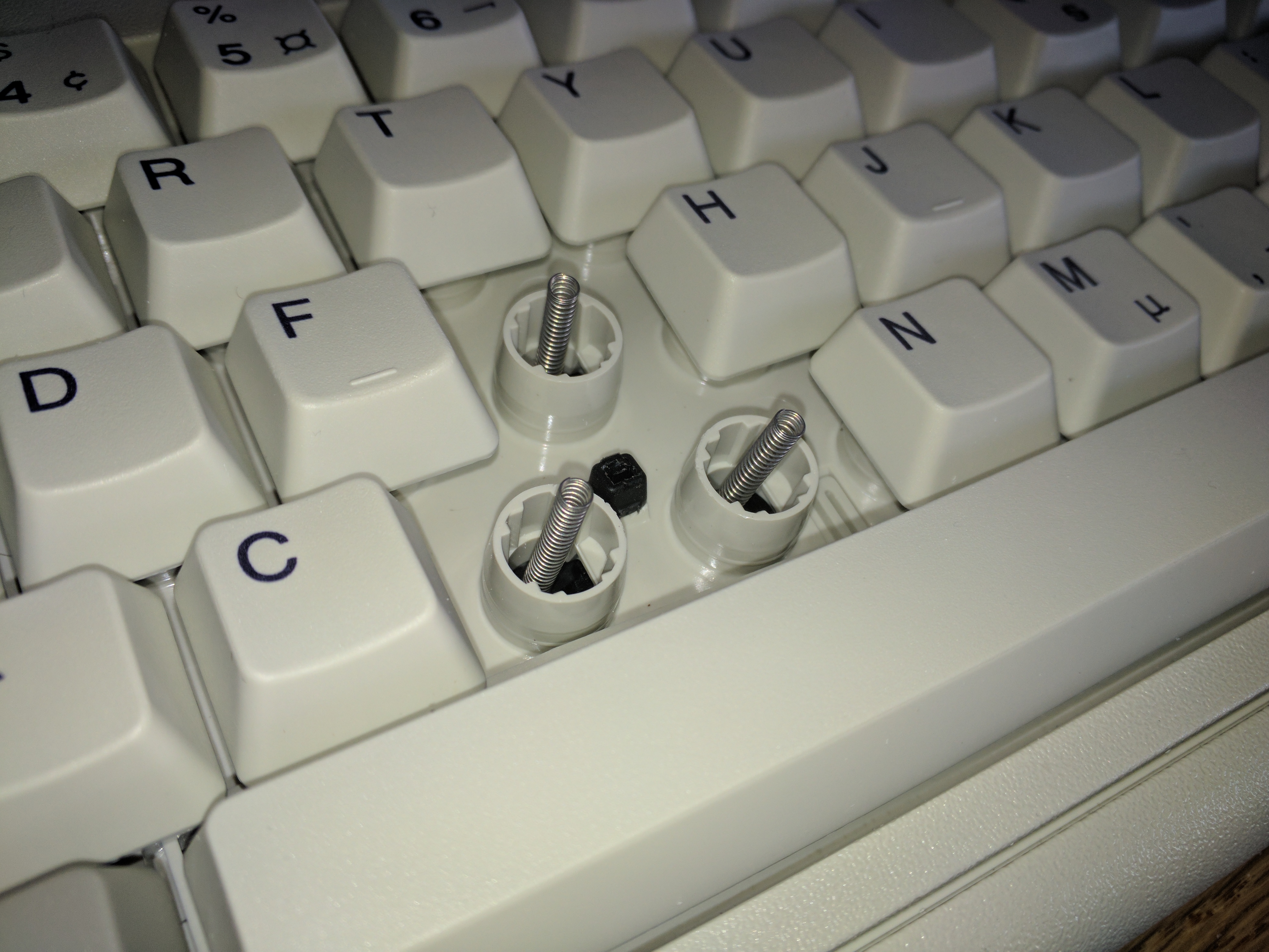

I removed and cleaned every component of this keyboard.
There are plenty of other tutorials on this so here is a simple summary of what I did:
  • Clean the PCB and matrices with rubbing alcohol (70% ethanol) and cotton swabs.
  • Clean the case and keys with hot soapy water and a toothbrush.
  • Clean the black spots on the case with baking soda, paper towel and a little bit of water. I put this in bold because it really does miracles and it's more effective than rubbing alcohol.

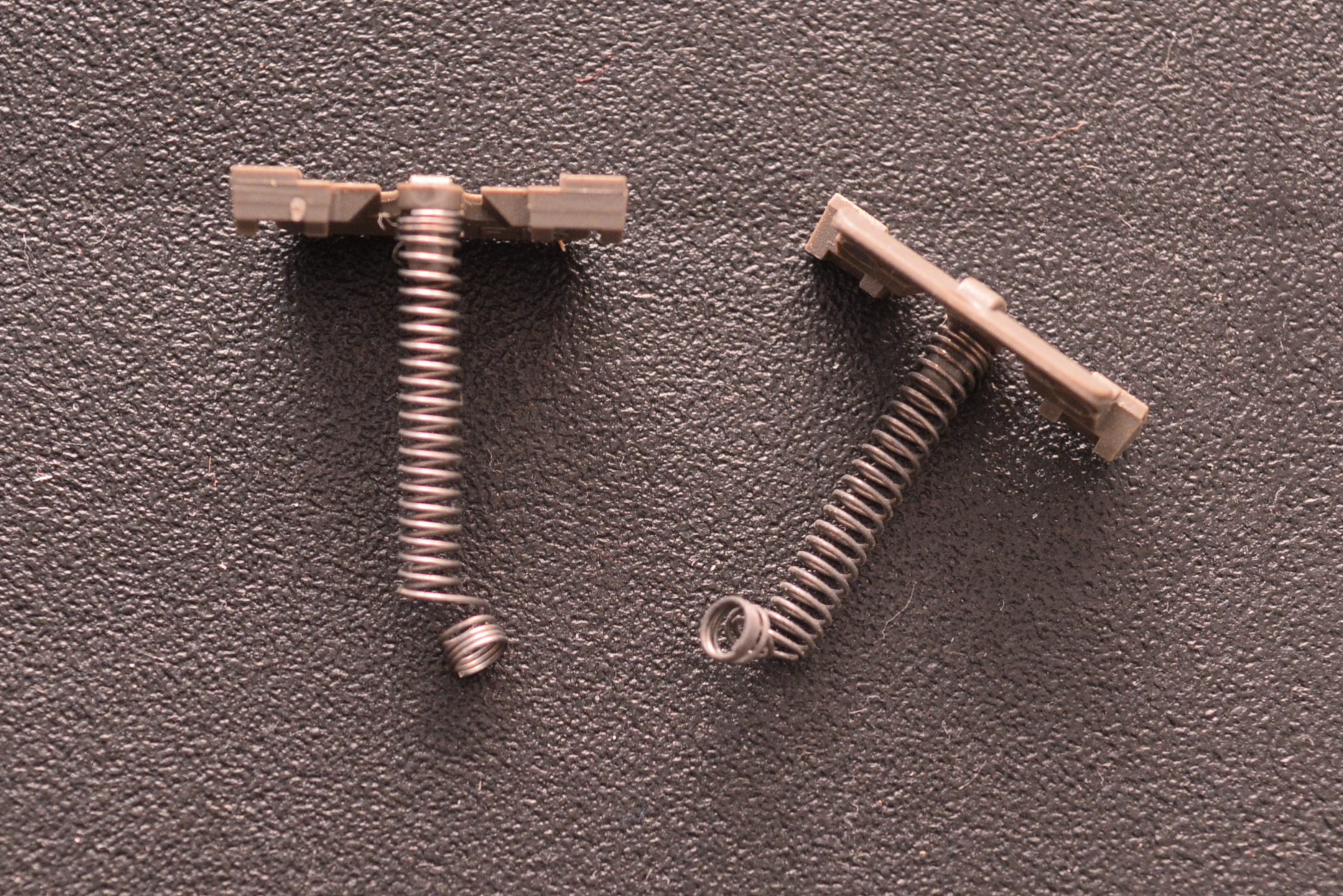

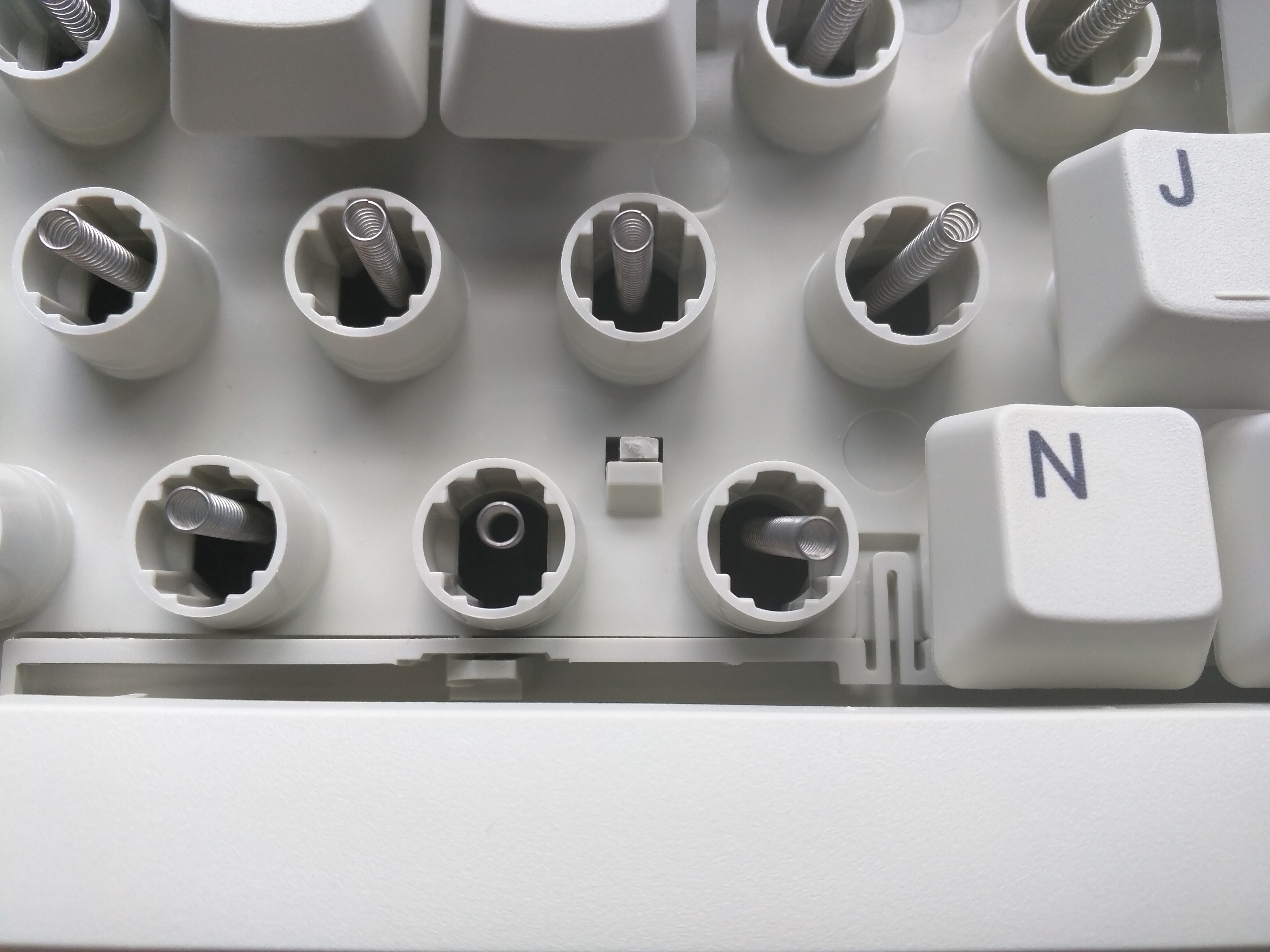

Two springs are stretched

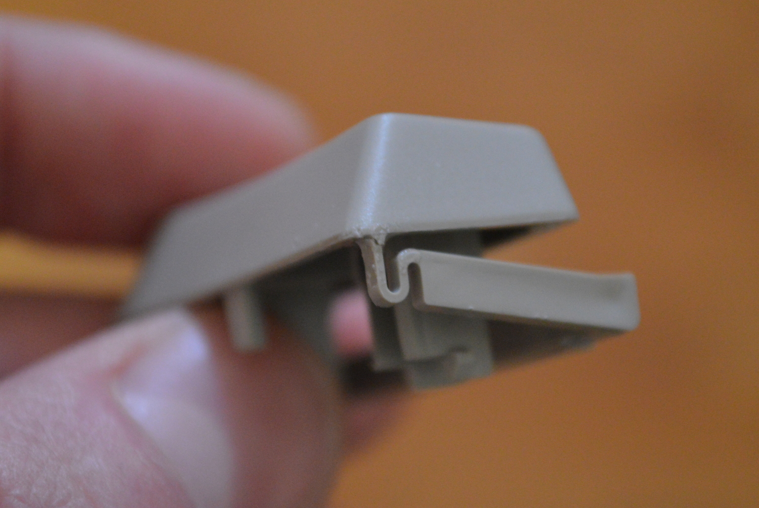

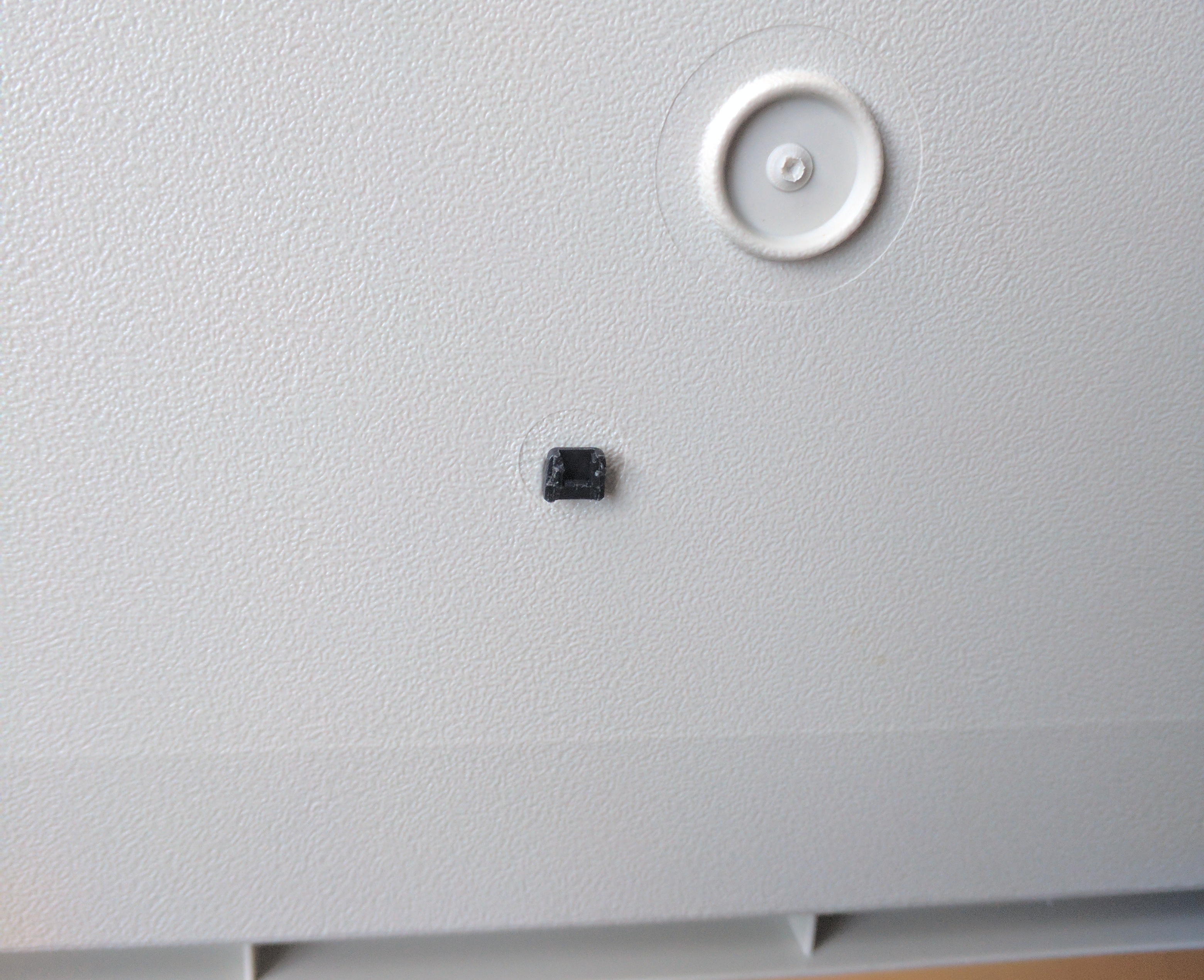

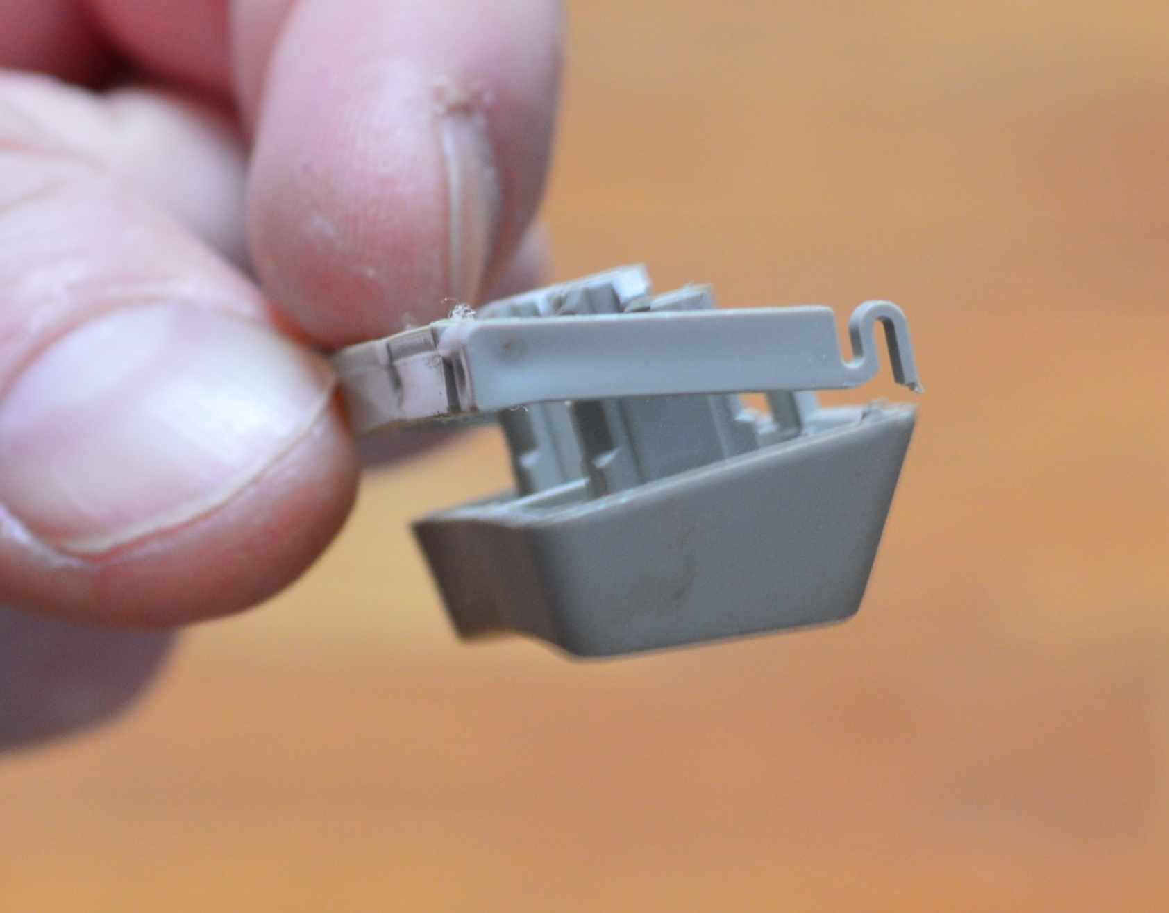

The stabilizer on the Shift key is broken

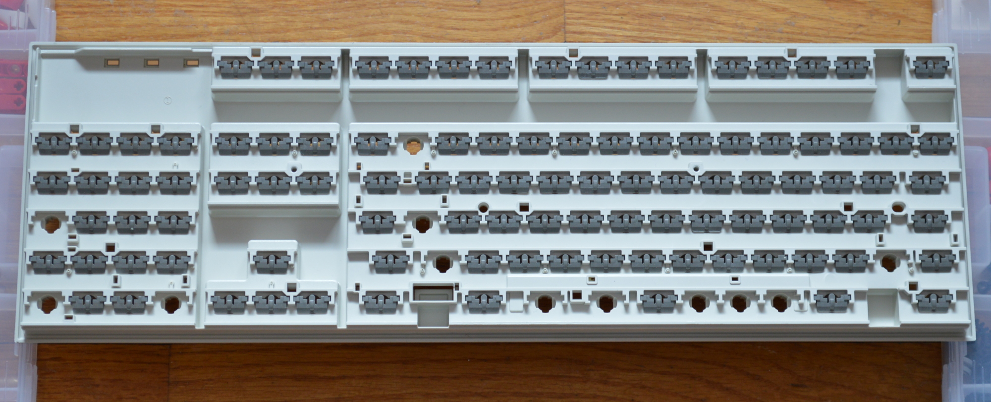

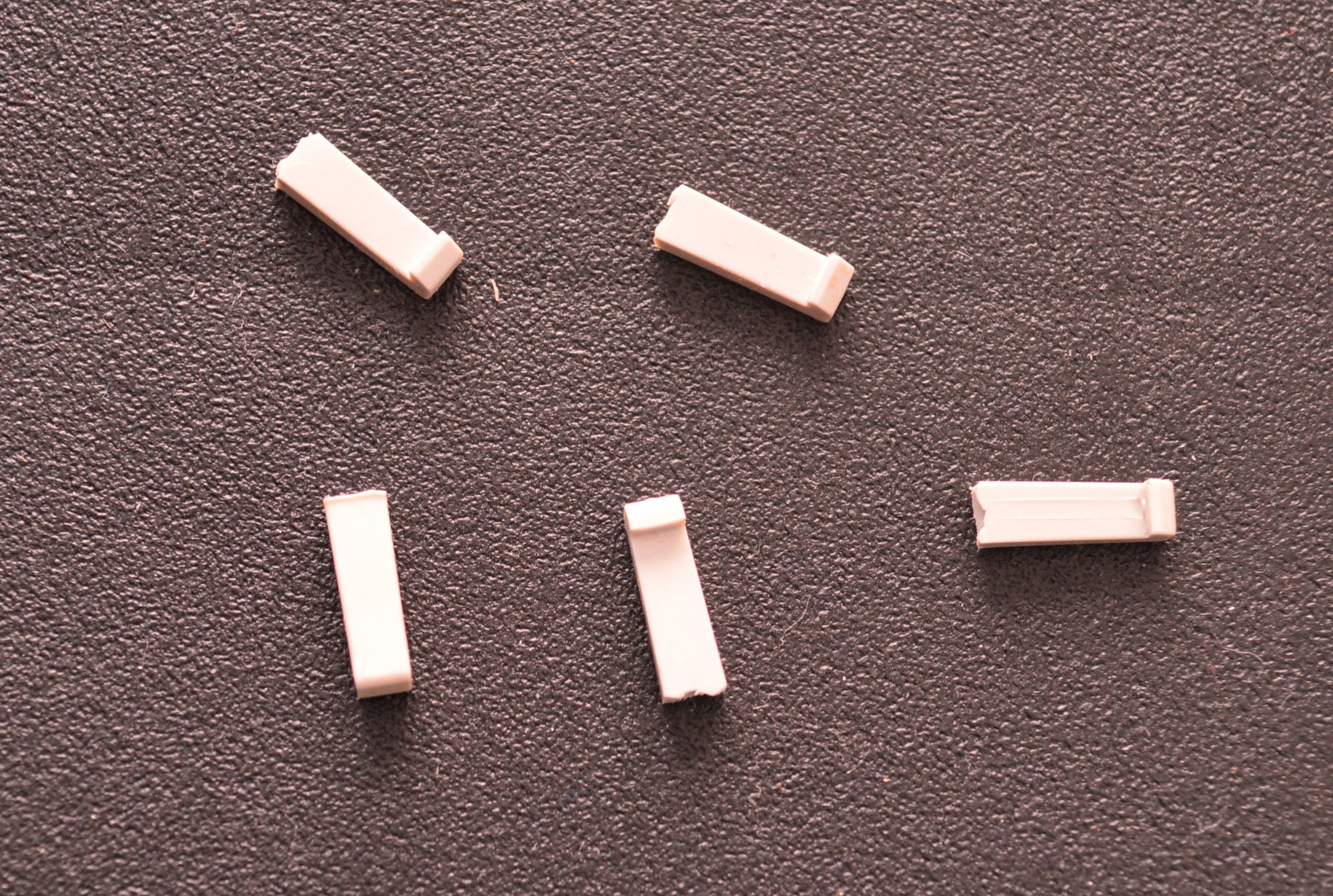

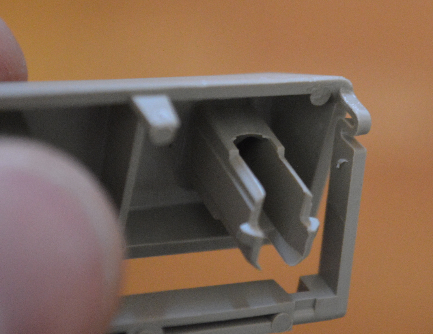

Some broken case pins that I found under the keys

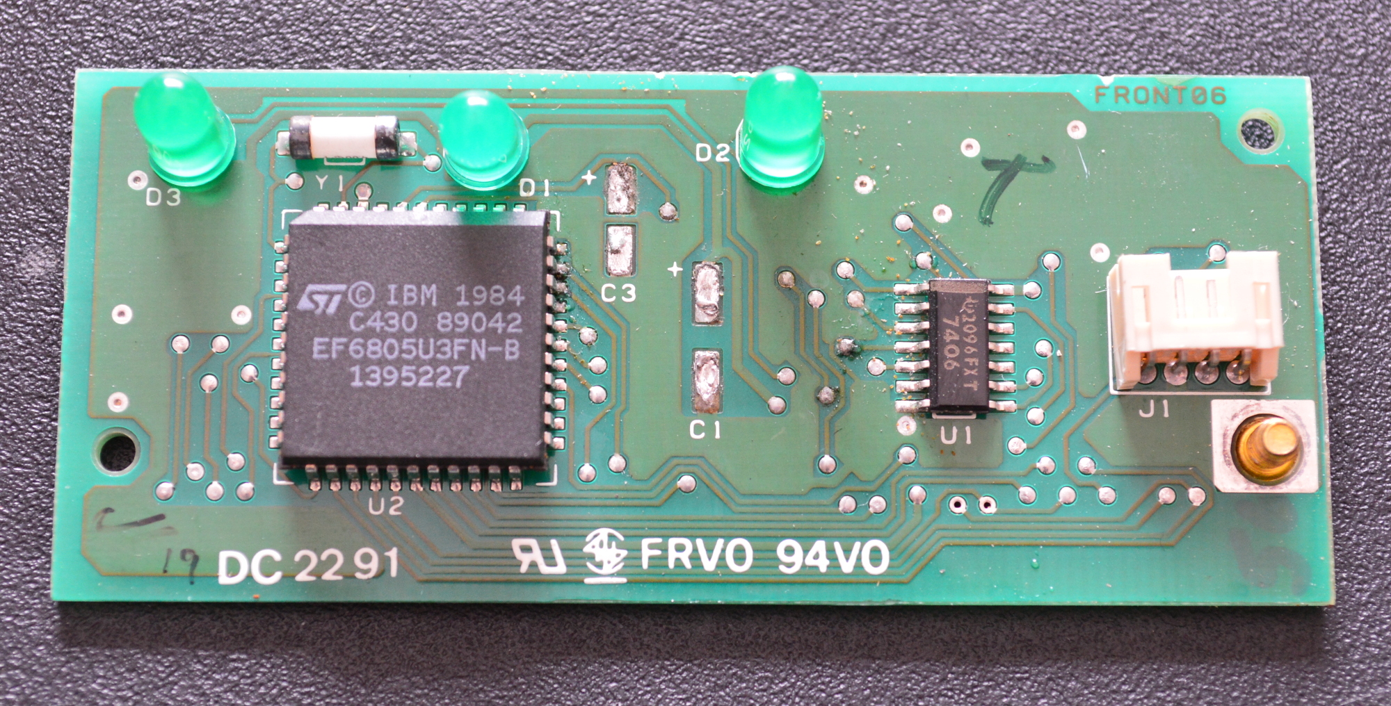

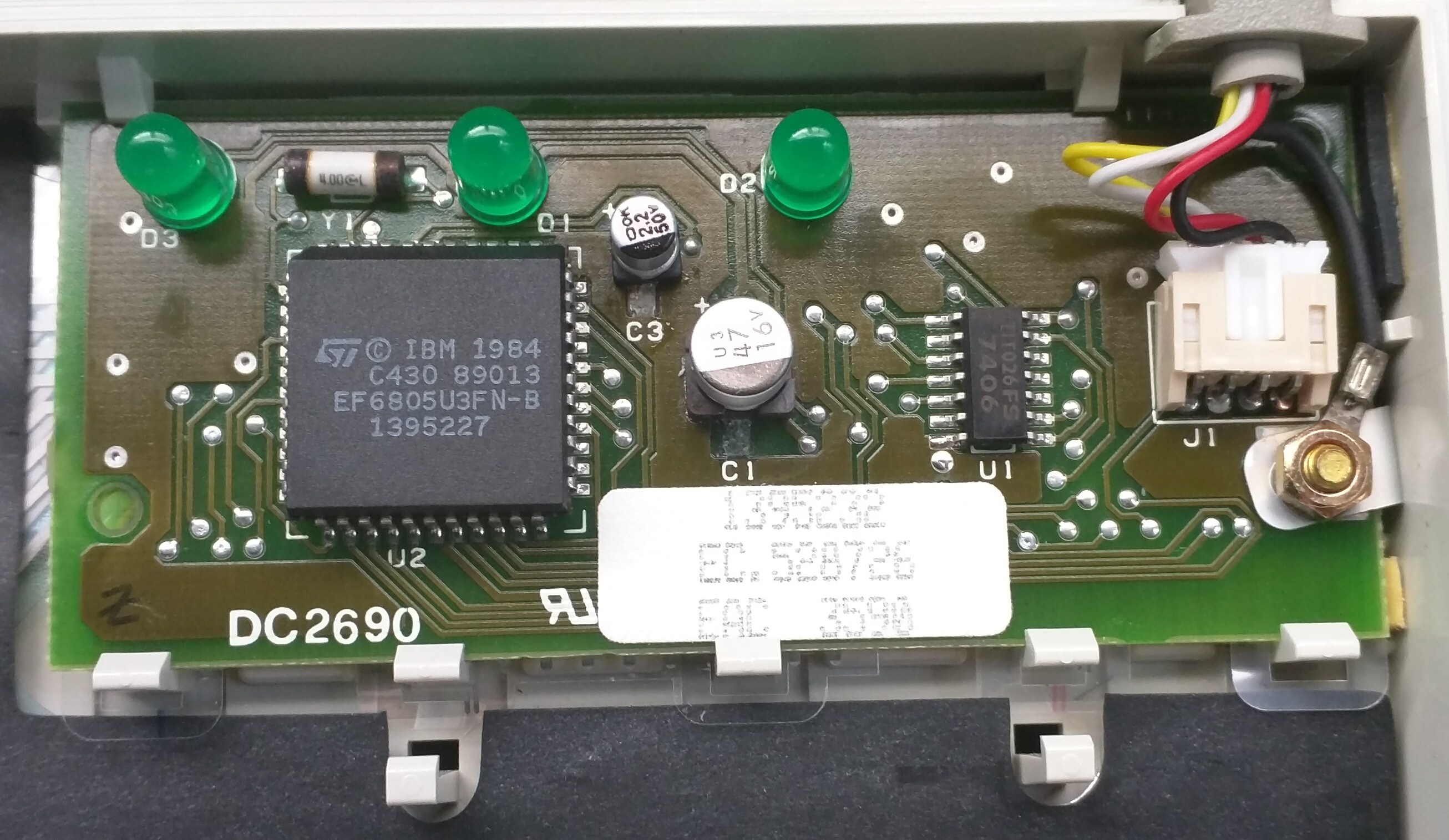

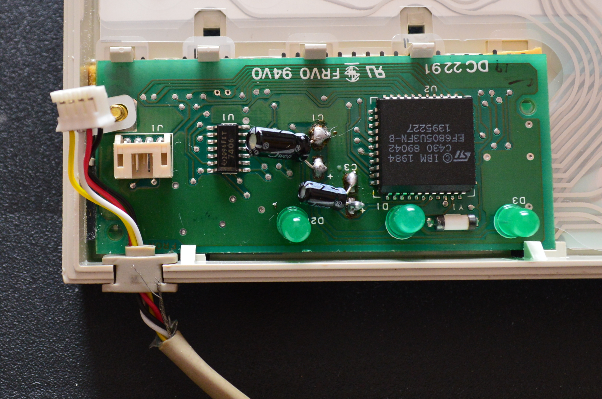

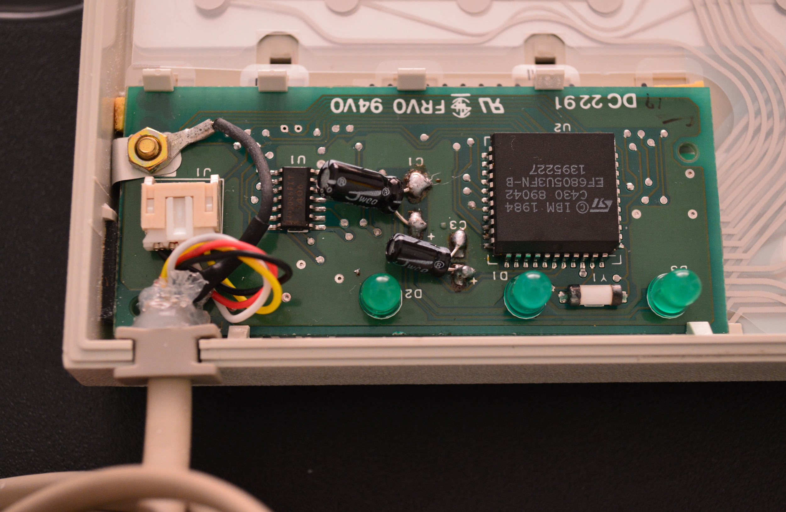

And of course, the capacitors on the PCB need to be replaced (C1 and C3)

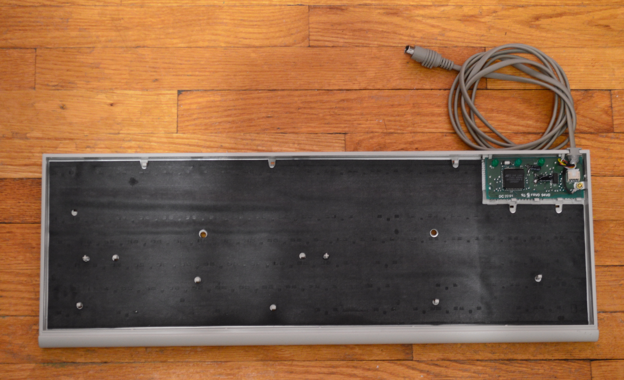

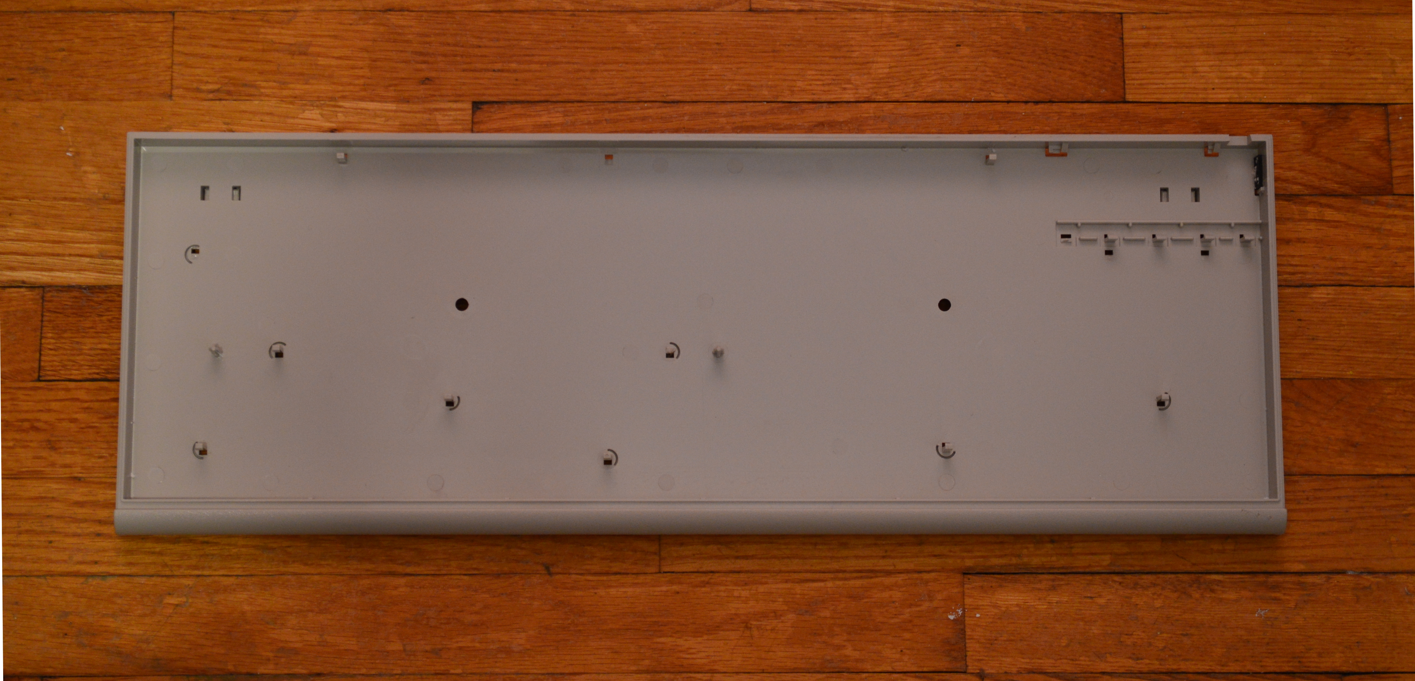

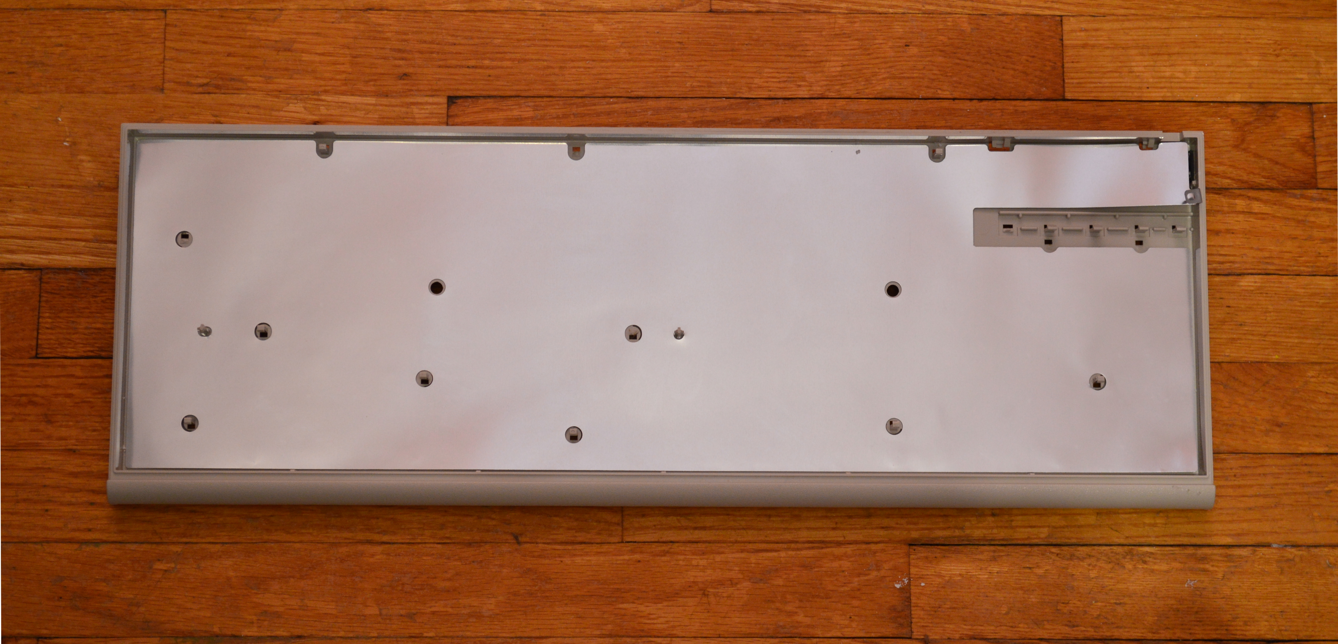

Cleaned the bottom case
Cleaned and put back the thin metallic sheet at the bottom of the case

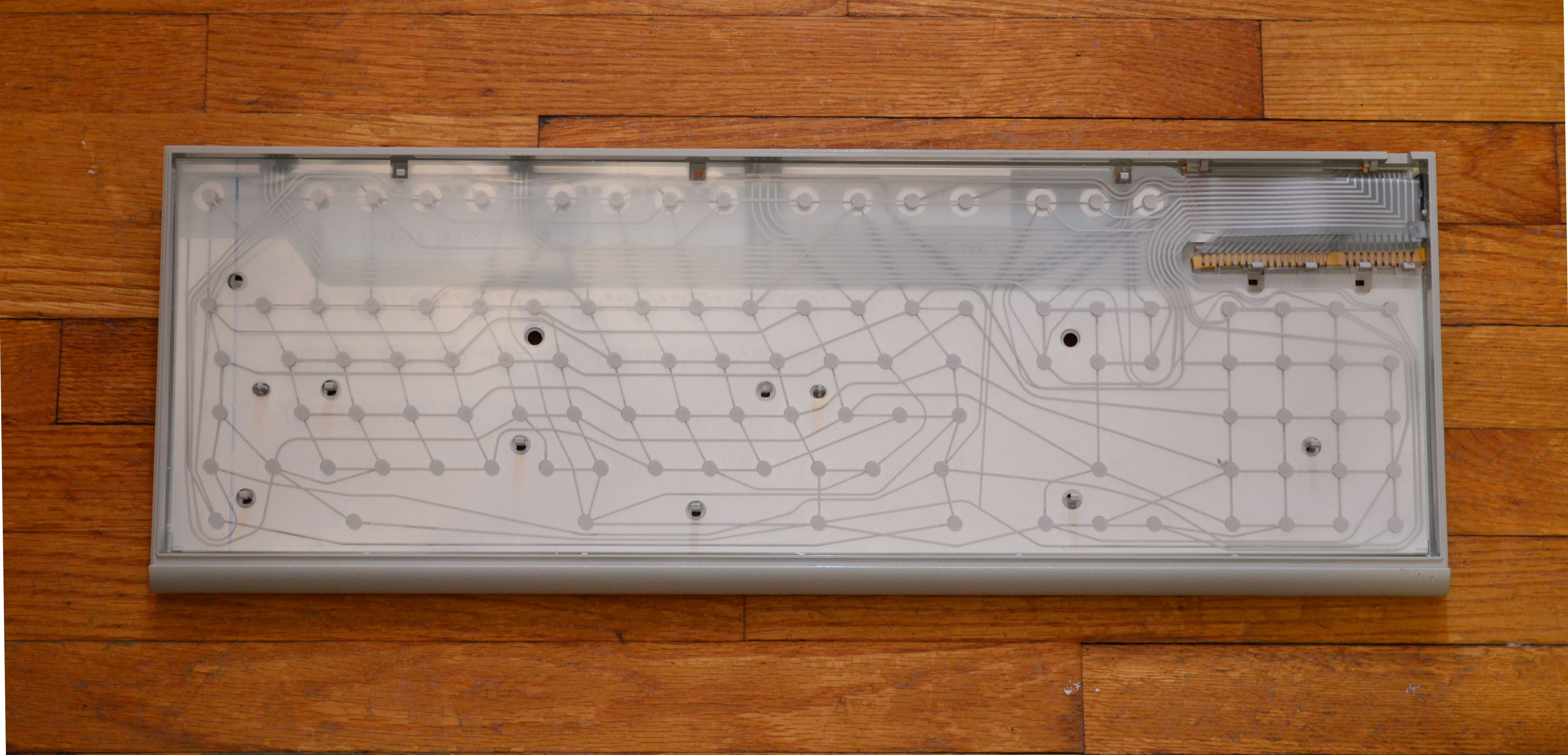

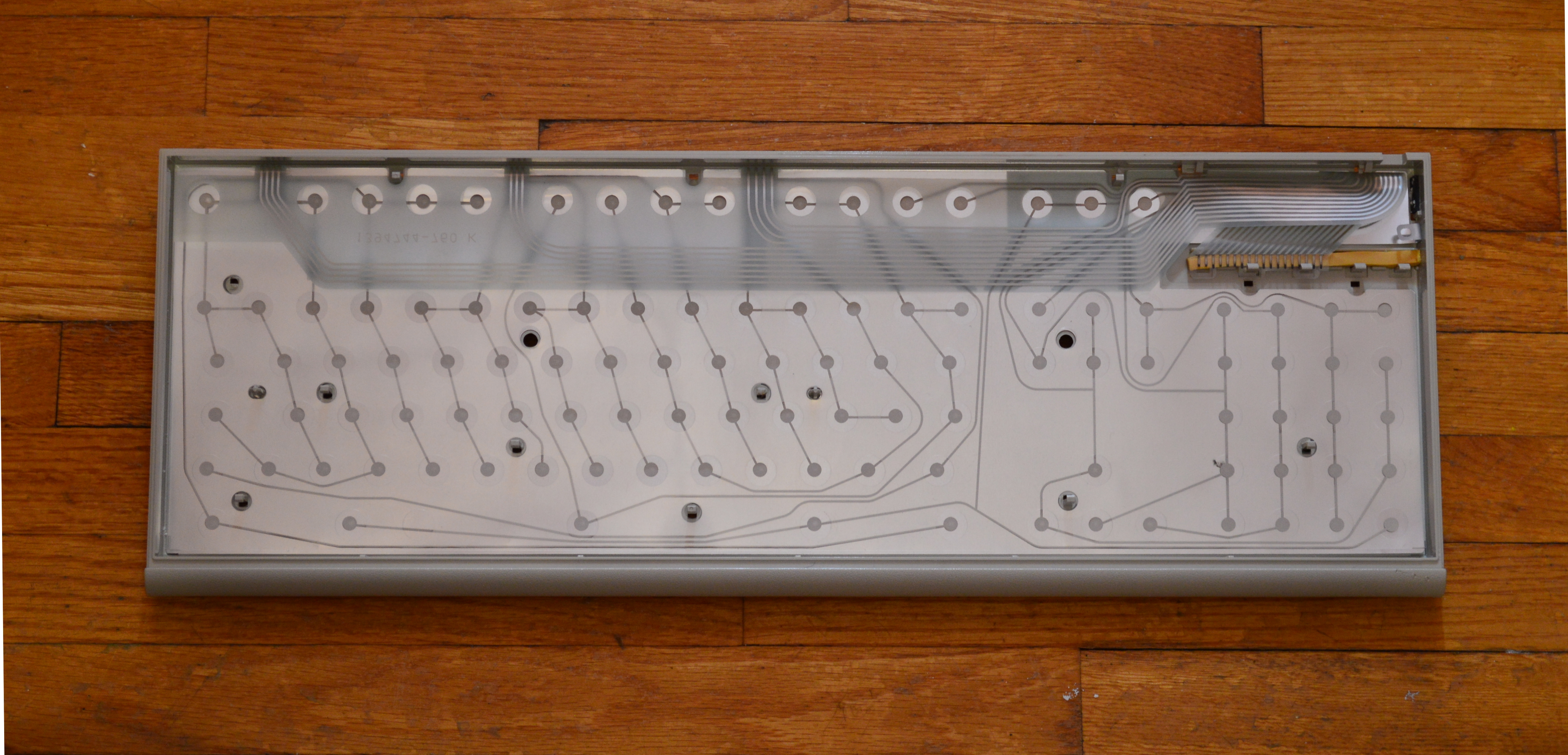

Cleaned and put back the first matrix layer (also scanned and added to the wiki)
Cleaned and put back the second matrix layer (also scanned and added to the wiki)

I will attack each issue individually, starting with the replacement of the capacitors on the PCB. If you have any ideas / suggestions / etc. for each issue, please let me know.

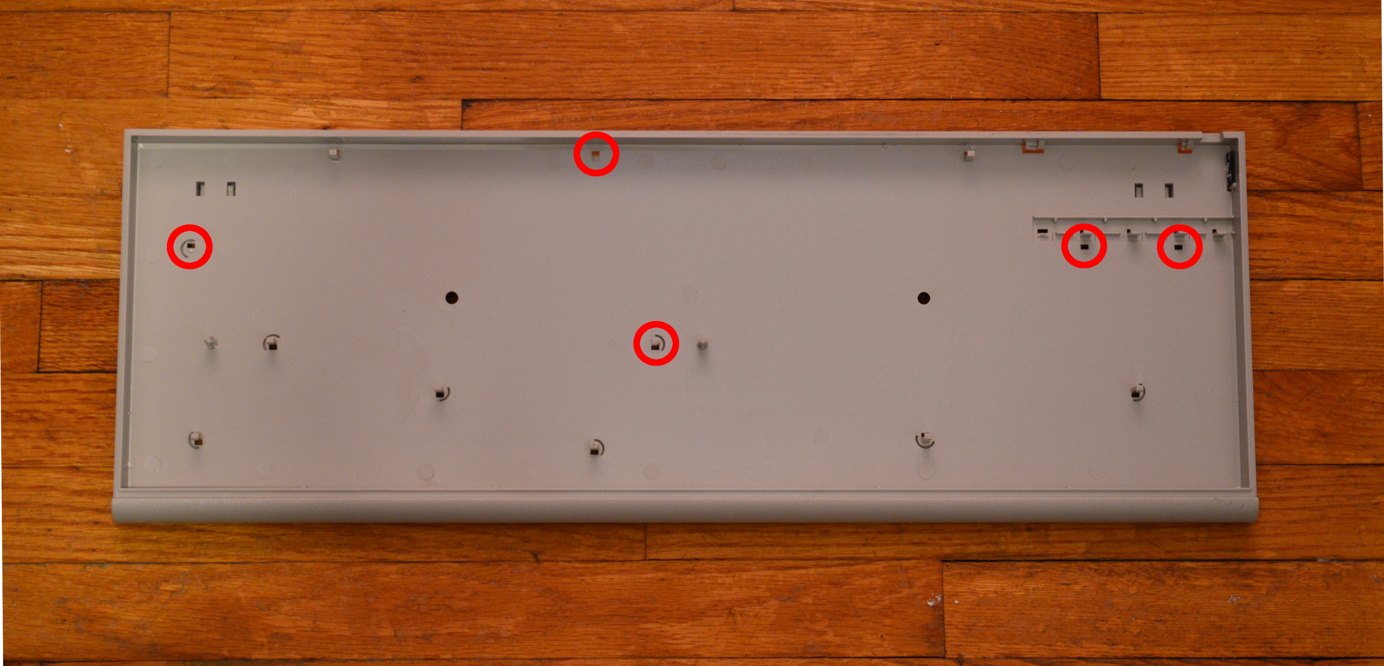

Jeez with that many broken tabs you're gonna have to do a weird bolt mod.
At least the holes are already there for it kind of.. Lol
I was thinking of doing a bolt mod to mine.. those tabs are trash.
j0d1
29 Mar 2018, 18:23
Yeah they are really fragile.
There are a total of 13 on the keyboard and 5 of those are broken.
The top case was still firmly attached to the bottom case so I'm wondering if I should replace them or not.
If I do, some kind of bolt mod is a better idea than trying to put back the original tabs (with crazy glue, hot glue, melting the plastic around, ...)
The holes in the bottom case are not aligned with the ones in the top case but this can be fixed.
Obviously I am not touching the broken tab in the middle of the keyboard because it is right above the precious label. :D

j0d1 wrote: Yeah they are really fragile.

I received the keyboard with all the broken tabs under the keycaps so it looks like it happened during shipping.
I assume the previous owner would have removed the broken tabs if he opened the case before selling it to me.
That mystery will never be resolved. :?:
For the PCB tabs, I managed to break one while removing the PCB, oh well :(
Blaise170
ALPS キーボード
29 Mar 2018, 21:50
I once bought a Greek M2 and tried opening it and I think I broke every tab in it, assuming the tabs weren't already broken. The tabs in M2's are so fragile that you could probably break them just by typing too hard. Either way, I think it was a pleasant typing experience and I actually prefer them to regular M's.

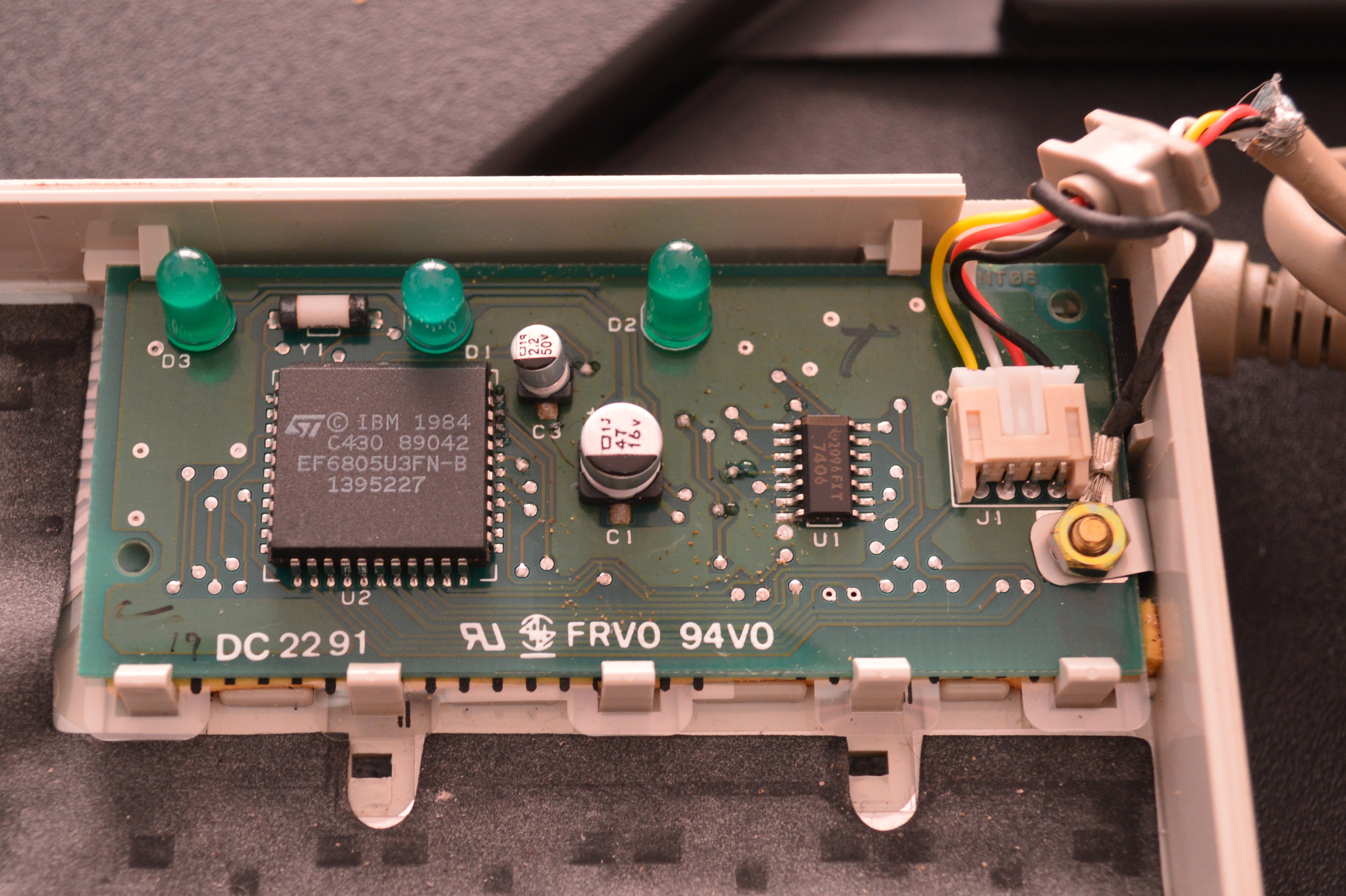

Fixing the capacitors

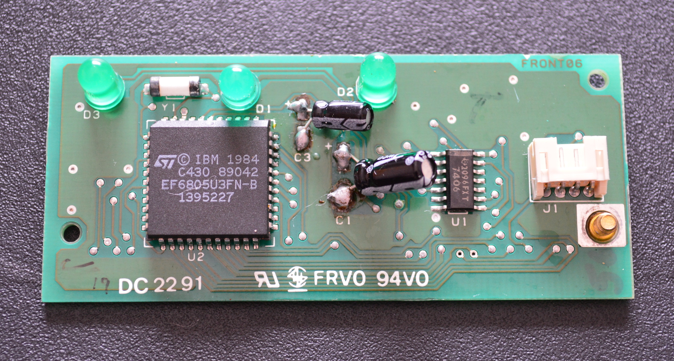

I replaced the two faulty capacitors.
  • C1 requires a 47uF 16v capacitor.
  • C3 requires a 2.2uF 50v capacitor.
Removed the old capacitors
I simply pulled the capacitors with pliers while applying heat to the pads and they easily came off.
The polarity of each capacitor is clearly indicated on the PCB (the + sign for the anode) so it difficult to make a mistake when installing the new ones.
Soldered the new capacitors
That's not the best soldering job but it will do.
I plugged the keyboard and pressed on the matrix membranes and it works!

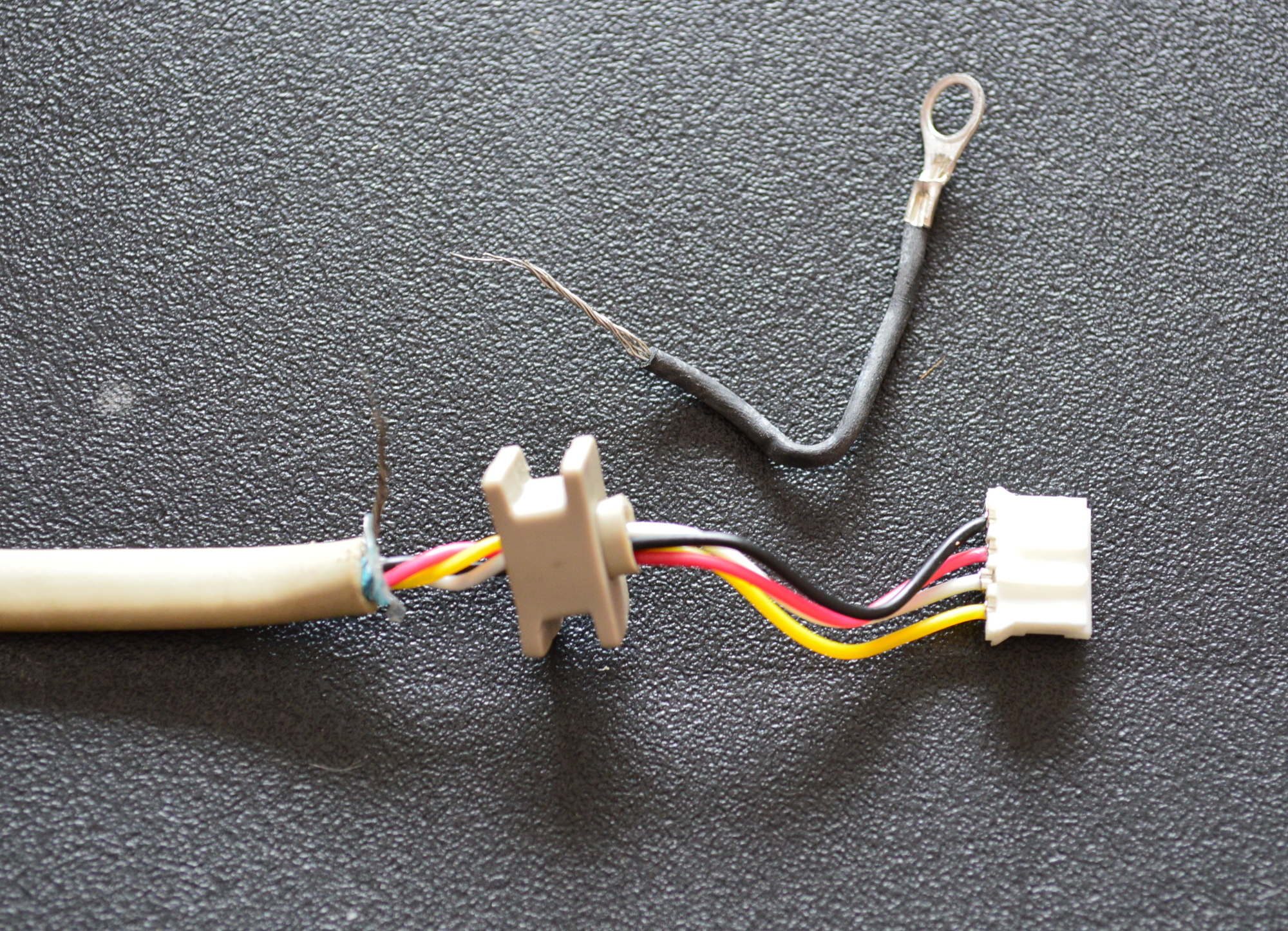

Fixing the cable
How it looks like before the fix
Close up on the issues
As you can see:

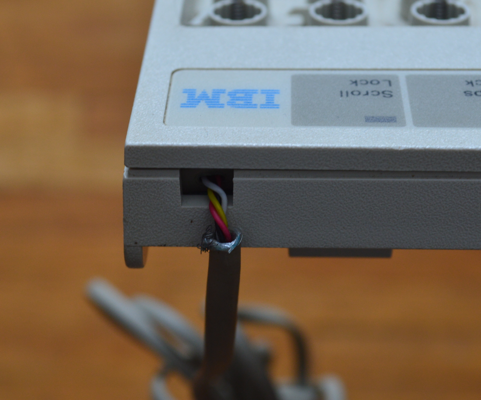

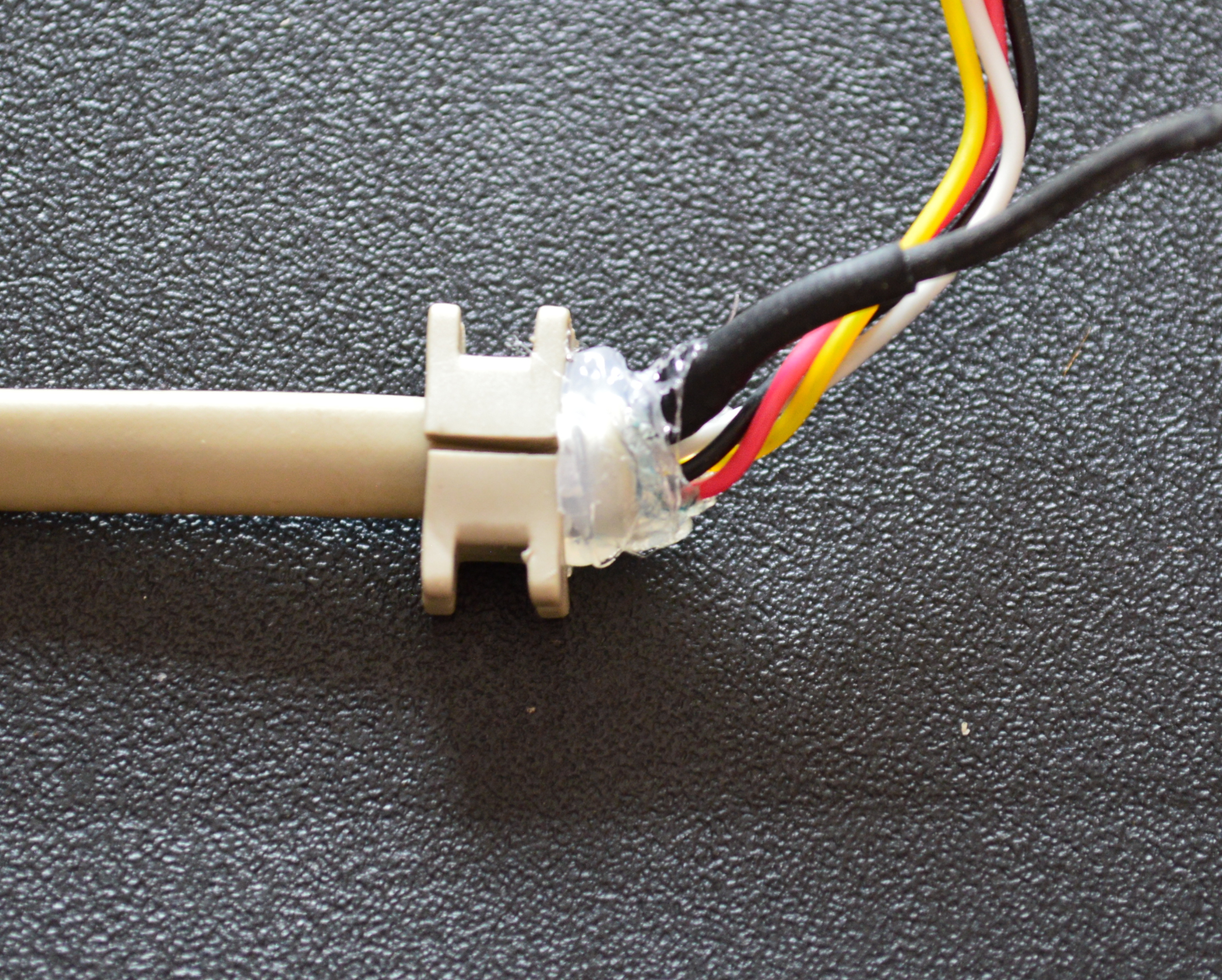

  • The ground cable is cut in half.
  • Part of the cable sleeve is stuck in the holder.
Cleaning the holder... oops.
I made a cut in the holder (is it the proper name of this thing by the way?) because for a moment I thought the holder was simply not large enough to accomodate the cable sleeve.
That's when I realized a chunk of the cable sleeve was simply stuck inside it, so I removed it with an exacto.
Cable fixed!
  • I reattached the ground cable and added a shrinking tube to securize it.
  • I hot glued the holder onto the cable sleeve so it is more resistant to a pull on the cable.
Cable installed on the PCB

Fixing the stabilizer on the Shift key.
31 Mar 2018, 18:22
Good fix. I have always wondered about the electrical properties of hot glue.
The piece you asked about is a grommet.
31 Mar 2018, 18:25
I just noticed something — that PCB was made by Wong's Electronics of Hong Kong.
j0d1
31 Mar 2018, 19:14
fohat wrote:Good fix. I have always wondered about the electrical properties of hot glue.
From what I read, it depends on the composition of the hot glue but in most cases, it is an insulator.
fohat wrote:The piece you asked about is a grommet.
Thank you!

Huh... You used through hole caps.. I bet that is way more easy to solder than SMD ones.

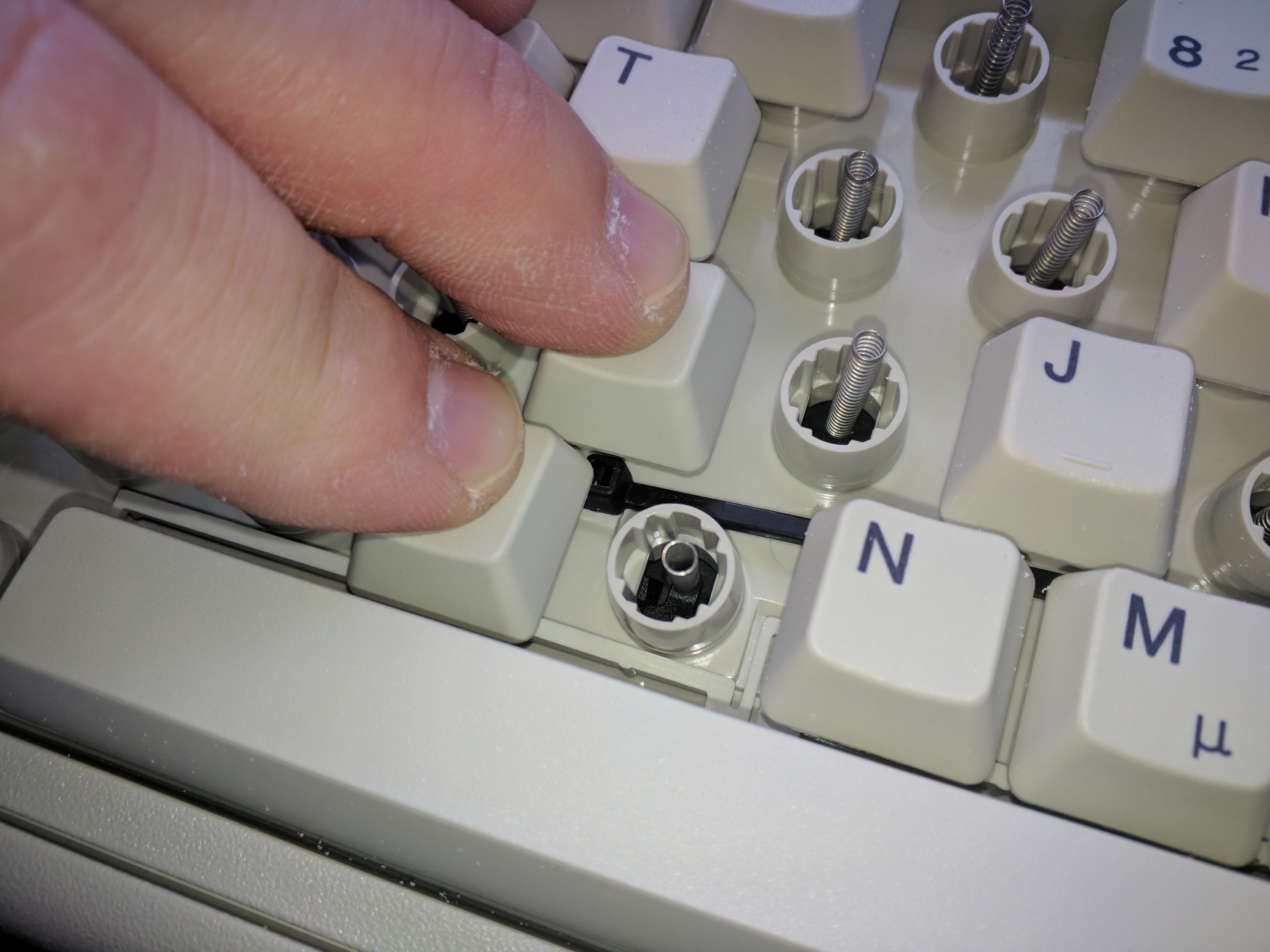

Darkshado
02 Apr 2018, 01:22
So I took care of mine this weekend, typing this post on it.
IBM 1395705 French Canadian Model M2
2018-04-01 16.32.31.jpg (1.69 MiB) Viewed 7355 times
Looks like the capacitors on mine are still good, so I left them as is.

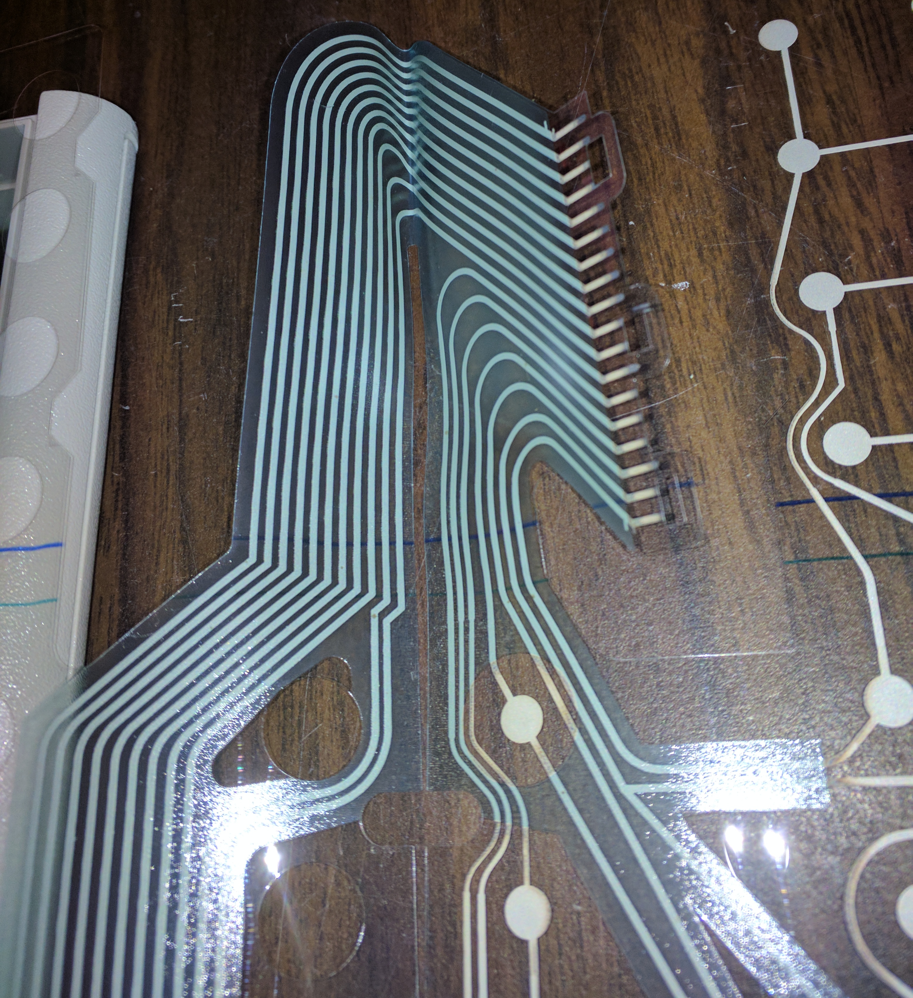

PCB
PCB
2018-04-01 14.44.04.jpg (1013.93 KiB) Viewed 7355 times
There was some corrosion on the membrane traces, especially near the contacts for the controller PCB.
Membrane corrosion. Gentle rubbing with a pencil eraser got rid of that.

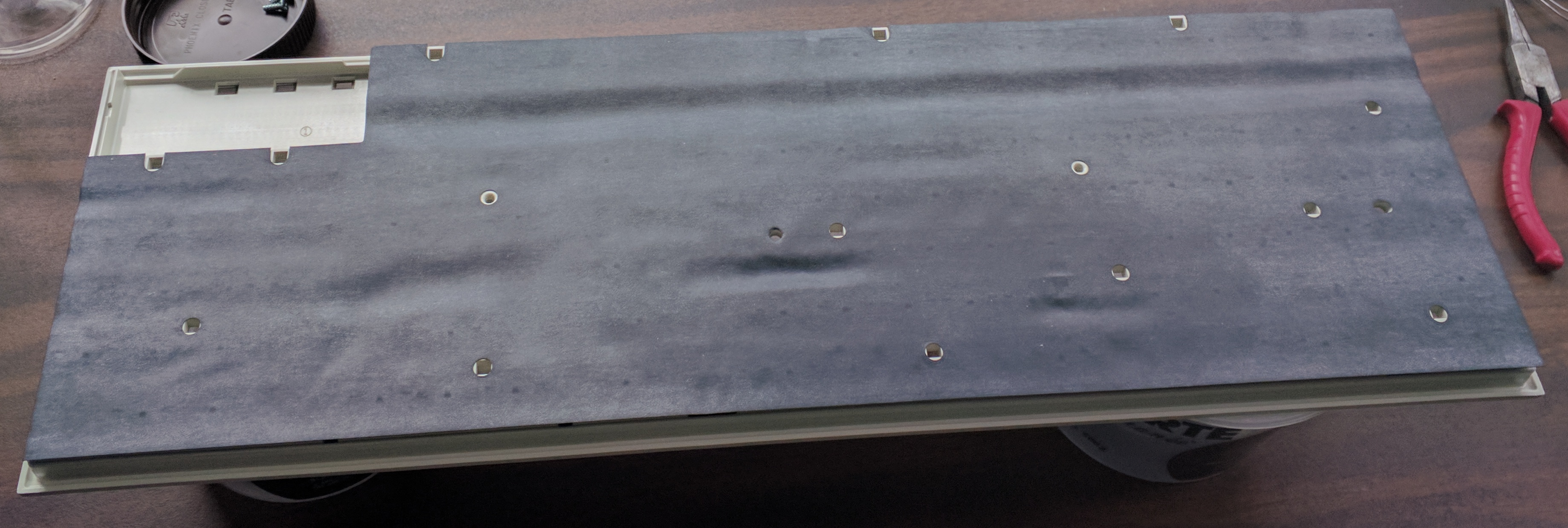

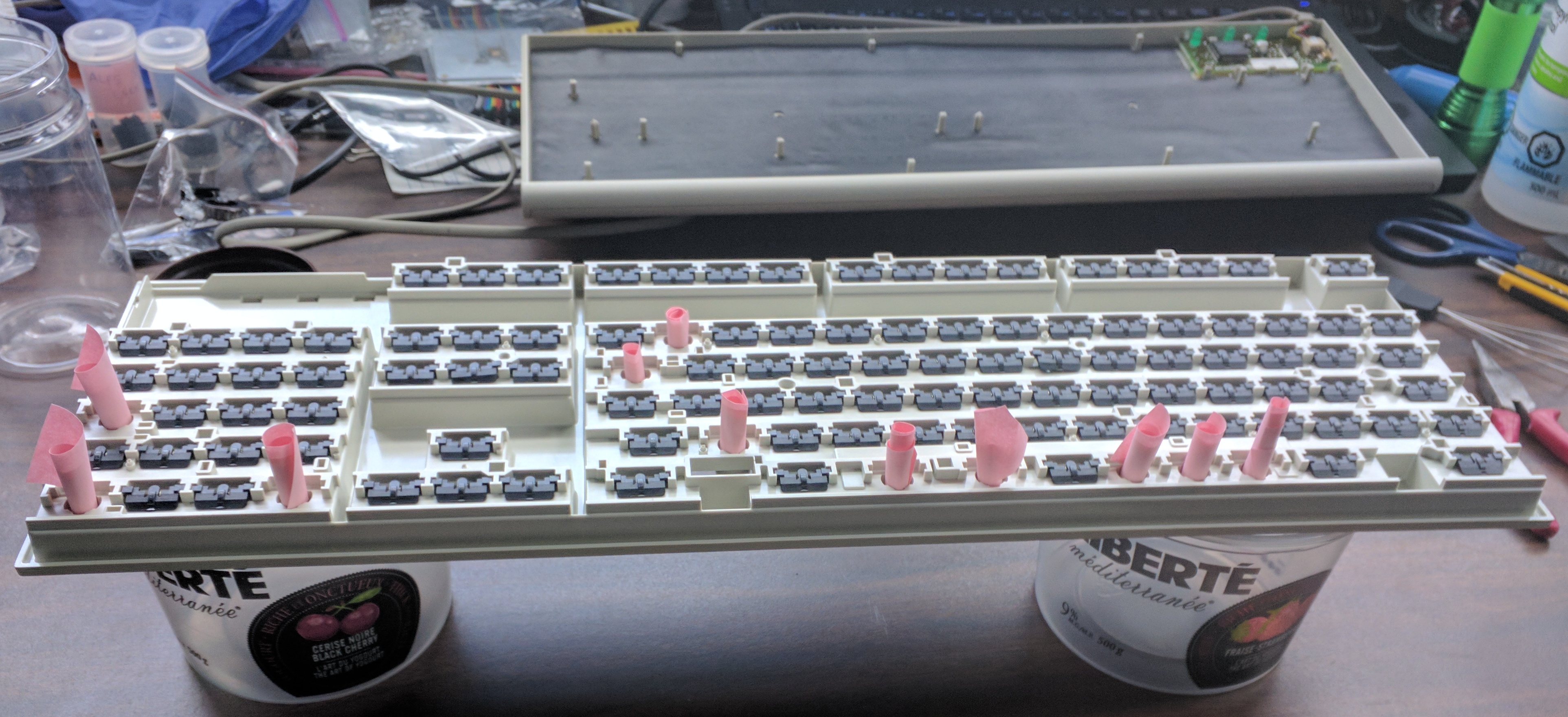

Reassembly is best done with something to raise the inverted top half of the case, e.g. these two yogurt containers:
Raised M2 top shell with flippers inserted. Rolled up small size sticky notes identify barrels to be left empty.
2018-04-01 14.50.25.jpg (2.05 MiB) Viewed 7355 times
Set the mat on top, hold the membrane on the "left" end (the one with Escape, opposite the controller PCB), lower it onto the top shell and snap into place:
Mat laid on top half shell.
2018-04-01 14.51.56.jpg (1.36 MiB) Viewed 7355 times
Tips:
  • Begin keycap installation with the stabilized keys. On ISO boards, place Enter just before moving onto the 1u keys.
  • I had to use a cotton swap to pull the mat outwards on the numpad + and Enter keys before they clicked correctly.
  • Broke a plastic stabilizer leg on the Numpad + but am under the impression the barrel inserts alone are enough to stabilise the keys.

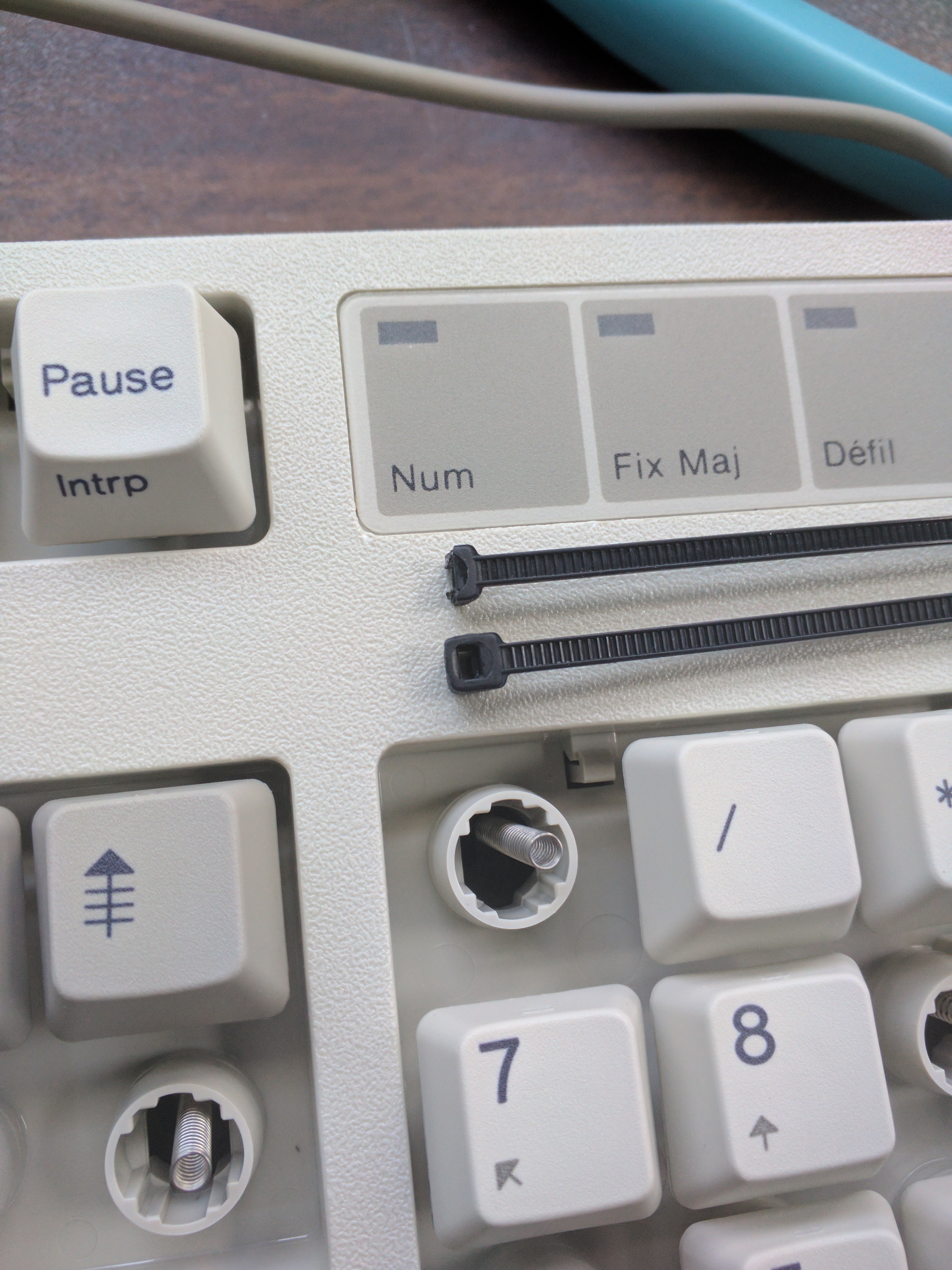

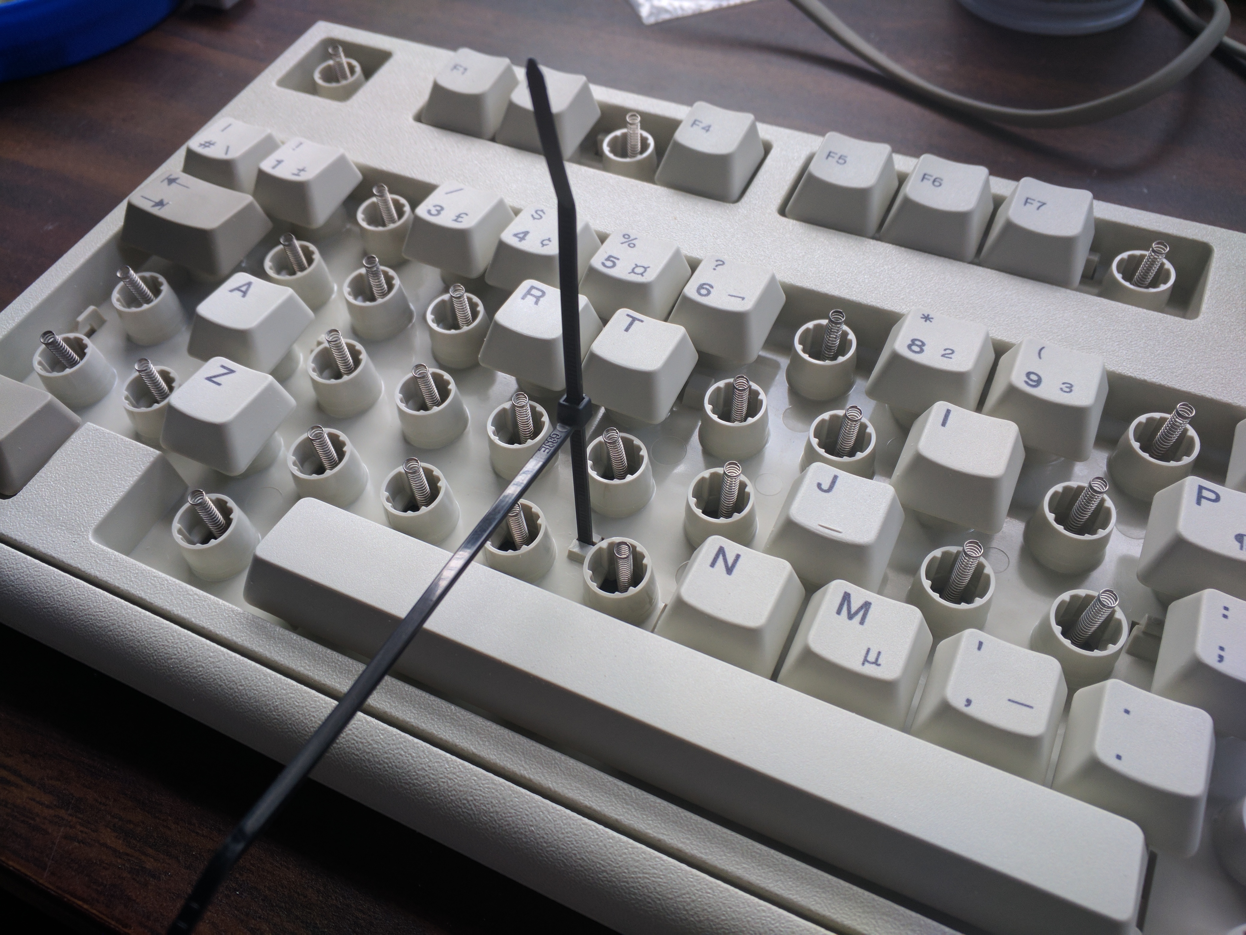

I have broken off a retaining tab during dissassembly... :(
Broken tab
Broken tab
2018-04-01 15.42.35.jpg (1.92 MiB) Viewed 7355 times
But came up with the "zip tie" mod!
Zip tie mod part 1
Zip tie mod part 1
2018-04-01 15.46.02.jpg (3.82 MiB) Viewed 7355 times

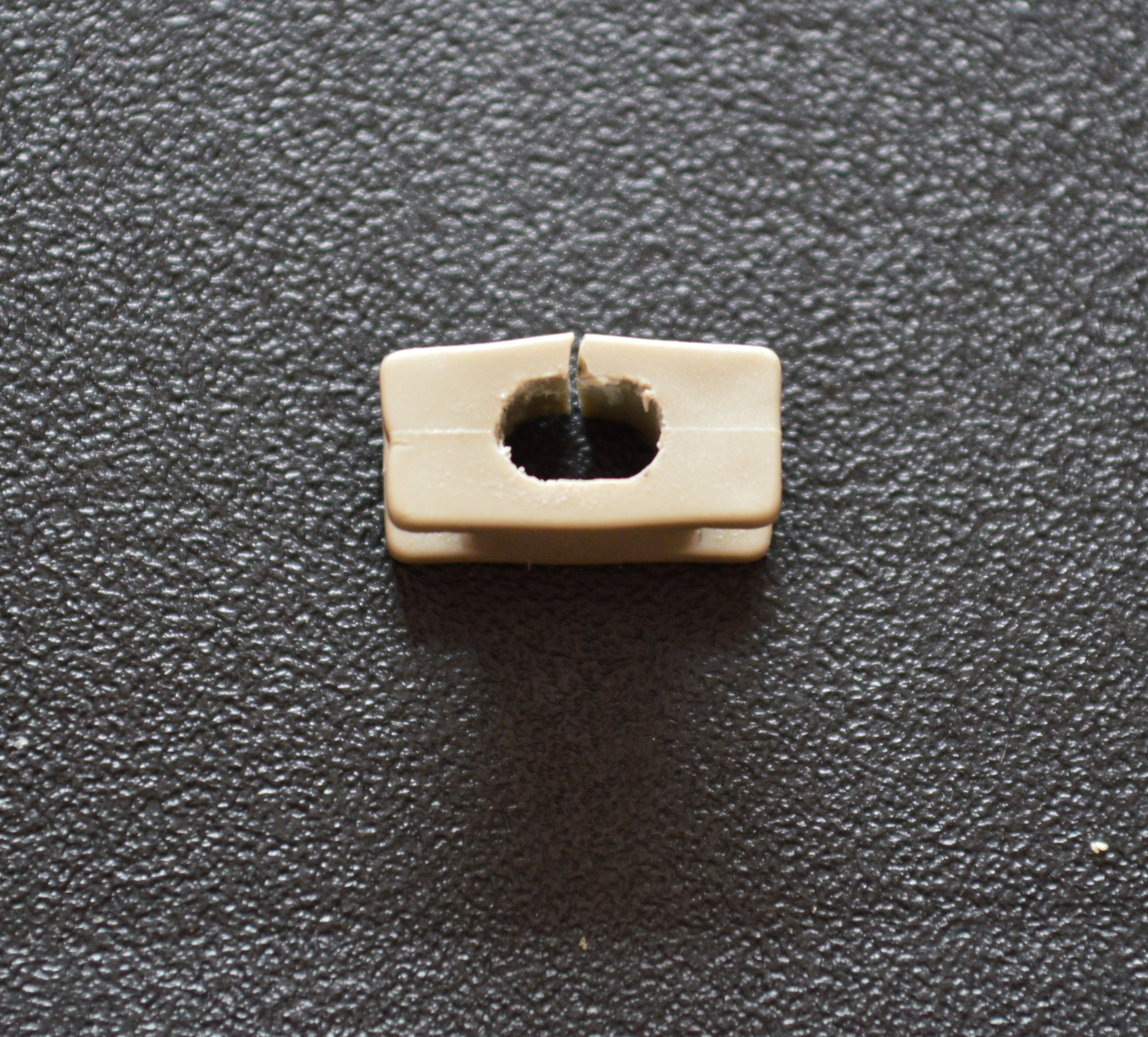

Trimmed part of the "head" so it does not protrude past the keyboard legs underneath the case.
Zip tie mod part 2
Zip tie mod part 2
2018-04-01 15.45.26.jpg (2.13 MiB) Viewed 7355 times
Used a rotary tool to trim the post and retaining clip down two millimeters or so, in order for the second tie's head to clear the depressed surrounding keys.
Zip tie mod part 3
Zip tie mod part 3
2018-04-01 16.04.32.jpg (2.79 MiB) Viewed 7355 times
Fastened the ties, put a little bit of tension into it, then trimmed with small wire cutters.
Zip tie mod part 4
Zip tie mod part 4
2018-04-01 16.08.46.jpg (3.57 MiB) Viewed 7355 times
Zip tie mod part 5 - End result
2018-04-01 18.51.06.jpg (2.89 MiB) Viewed 7355 times

Fixing the SHIFT stabilizer
That one was easy. I applied a little bit of krazy glue and wait a few minutes.
It's head to see but the crack is filled with glue
At some angles, it doesn't look cracked
I did not have a lot of hope and I was ready to use some hot glue or melt the plastic with a solder iron.
I installed and removed it a couple of time and it works perfectly!
Fixing the springs
I won't be able to fix the springs and I will need to replace them.
Unfortunately I don't have spare ones so my temporary solution is to move those springs to the Scroll Lock and Pause keys that I never use. :(
Wrapping up for now

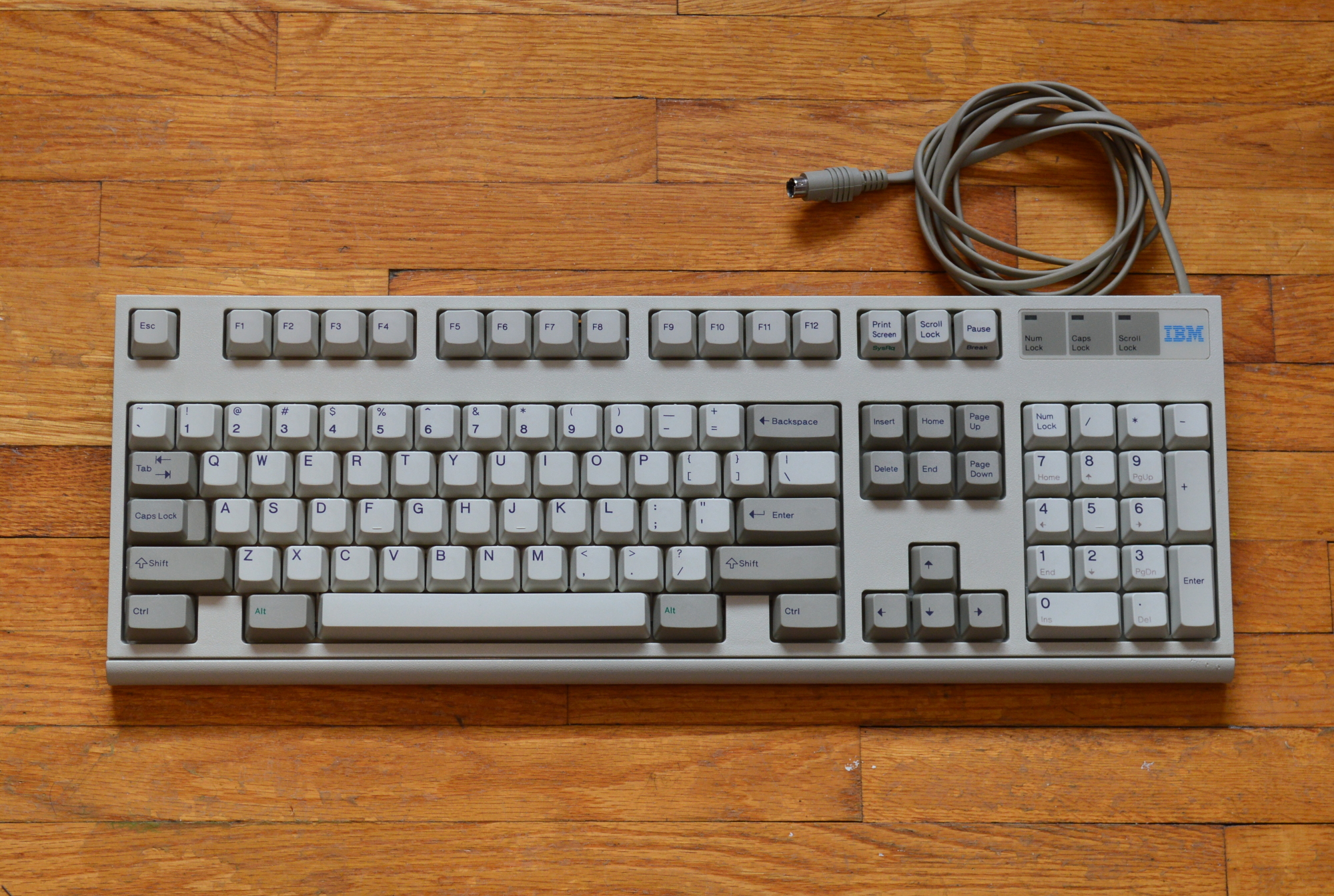

Until I find replacements for the springs, I decided to close the keyboard.
Closing the M2 by putting the springs in the top case
Ready to use!
