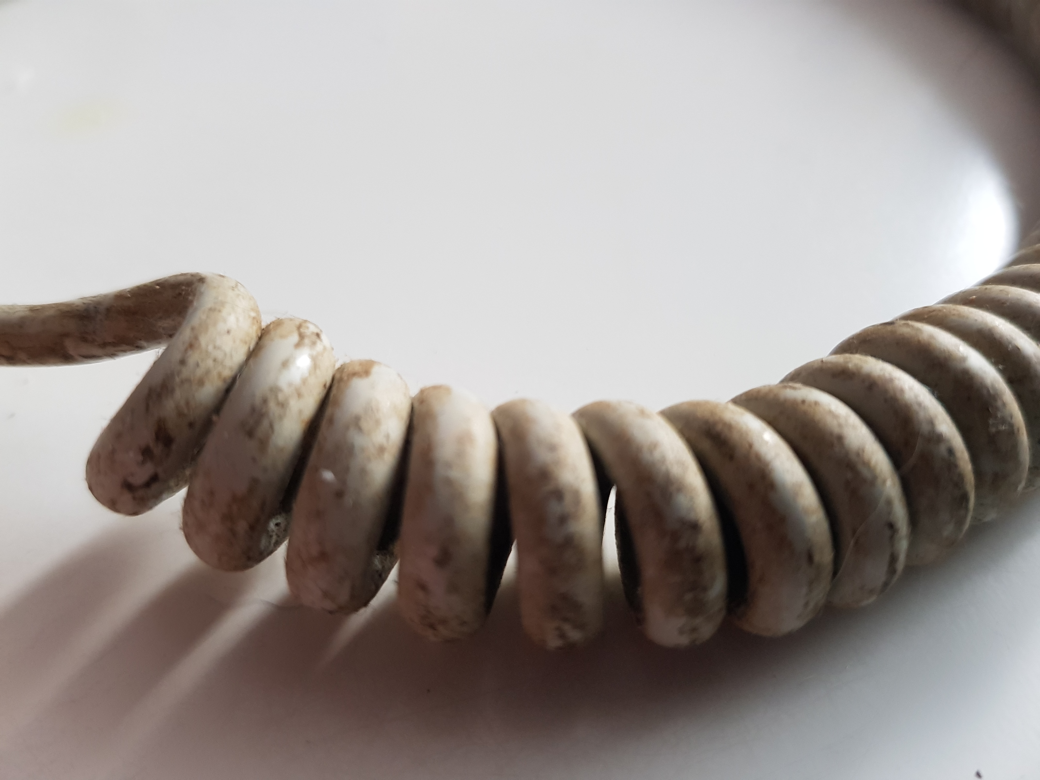

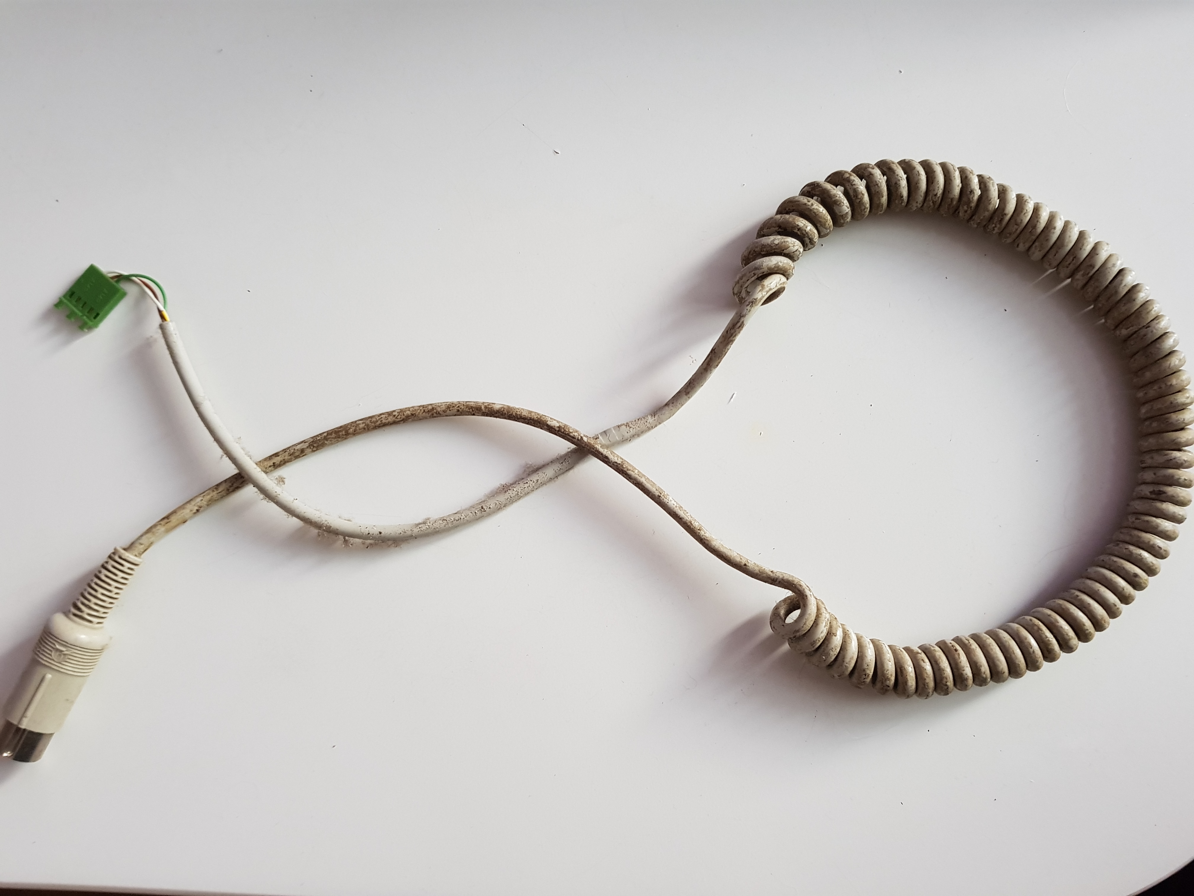

I'm cleaning a keyboard (IBM Model M 1396791, US/ANSI '95).
Soapy warm water was sufficient to clean the case and keycaps but the cable is fairly dirty.
Soap and warm water didn't help much. The non-coiled part is clean by now (scrubbing) but for the coiled part I might need a solvent.
Is there a recommended way to clean coiled cables?

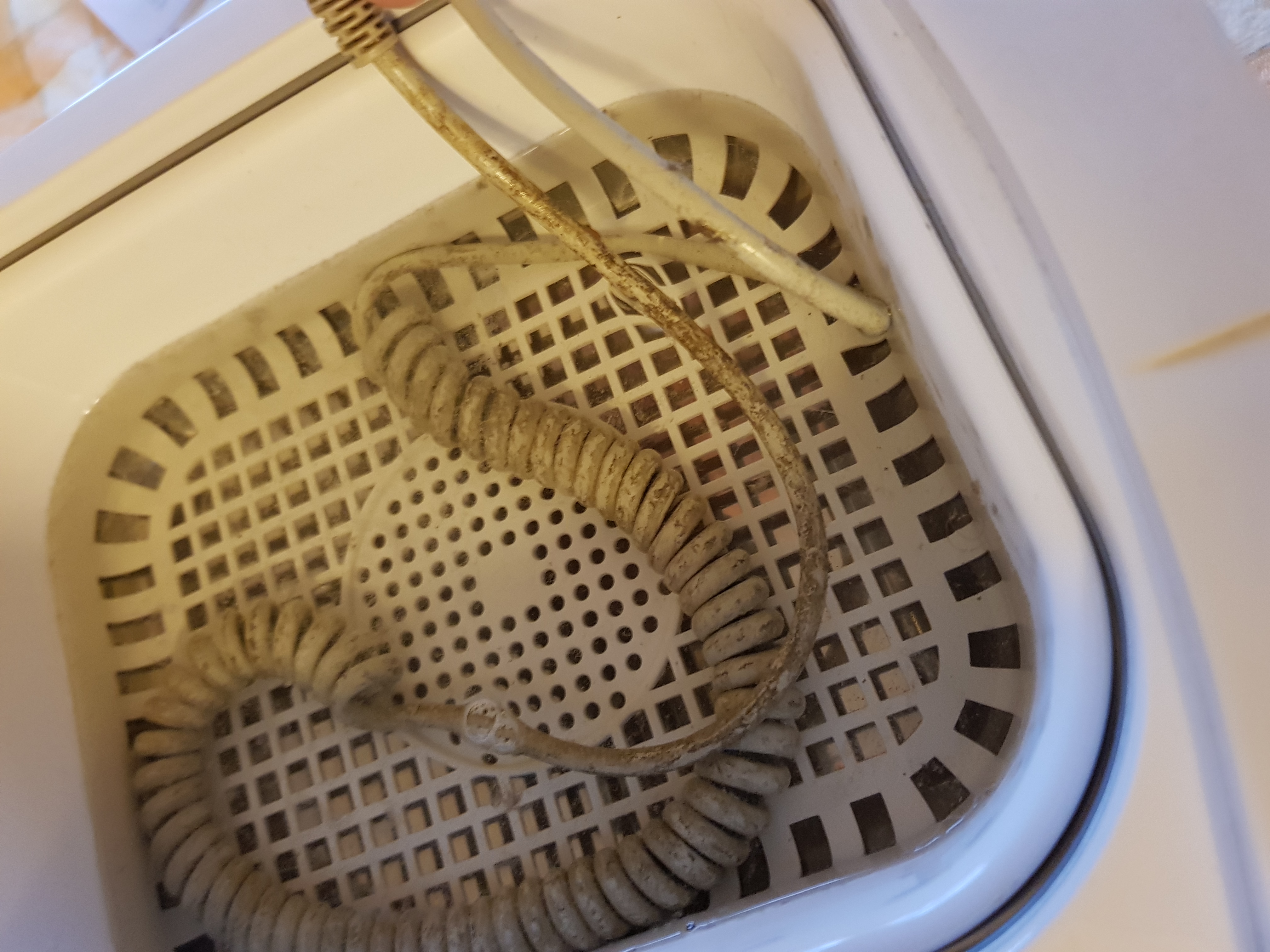

The cable is bathing in the ultra sonic tub right now (40C, ends hanging out). Except for some detergent I did not add anything.

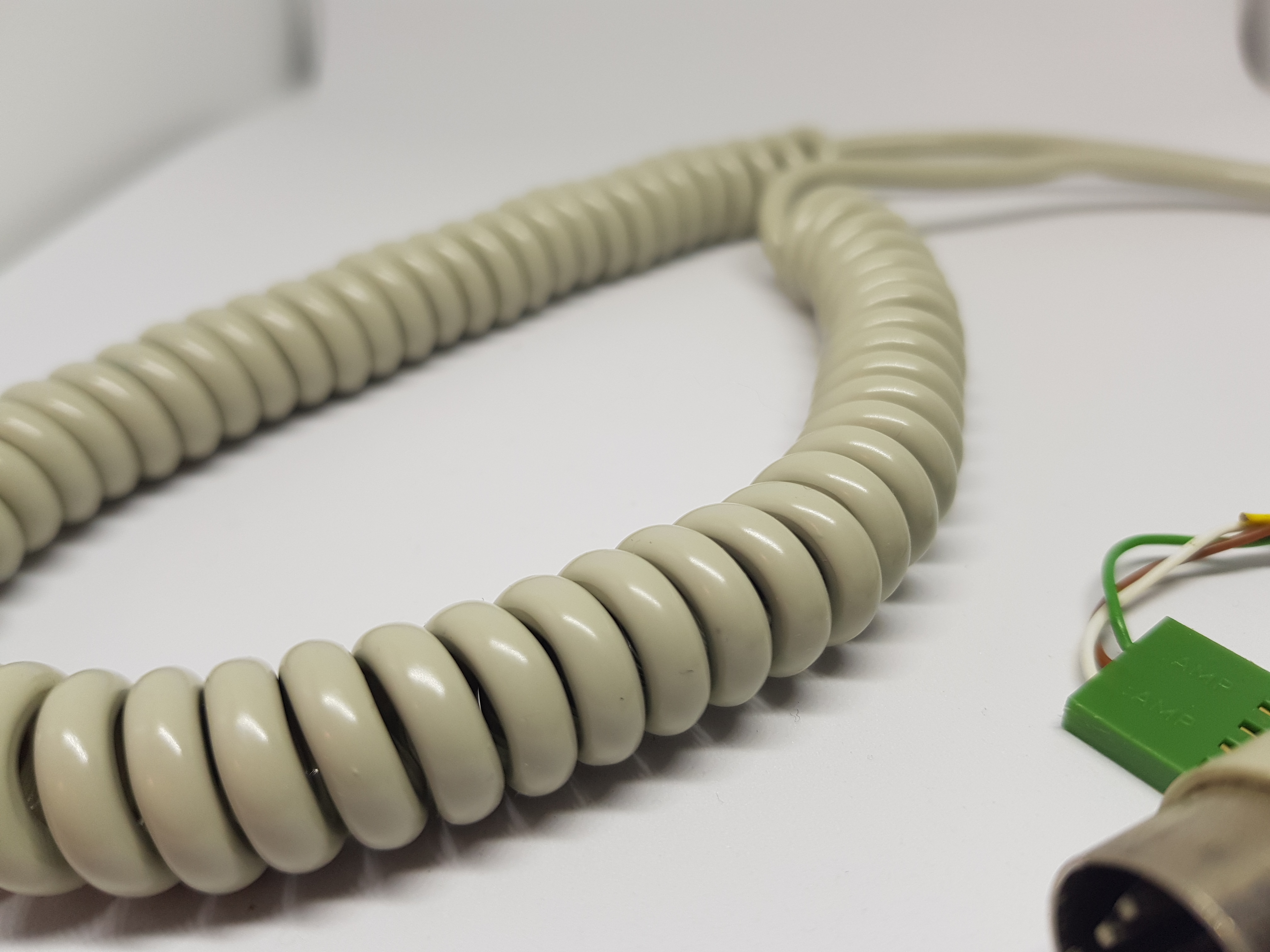

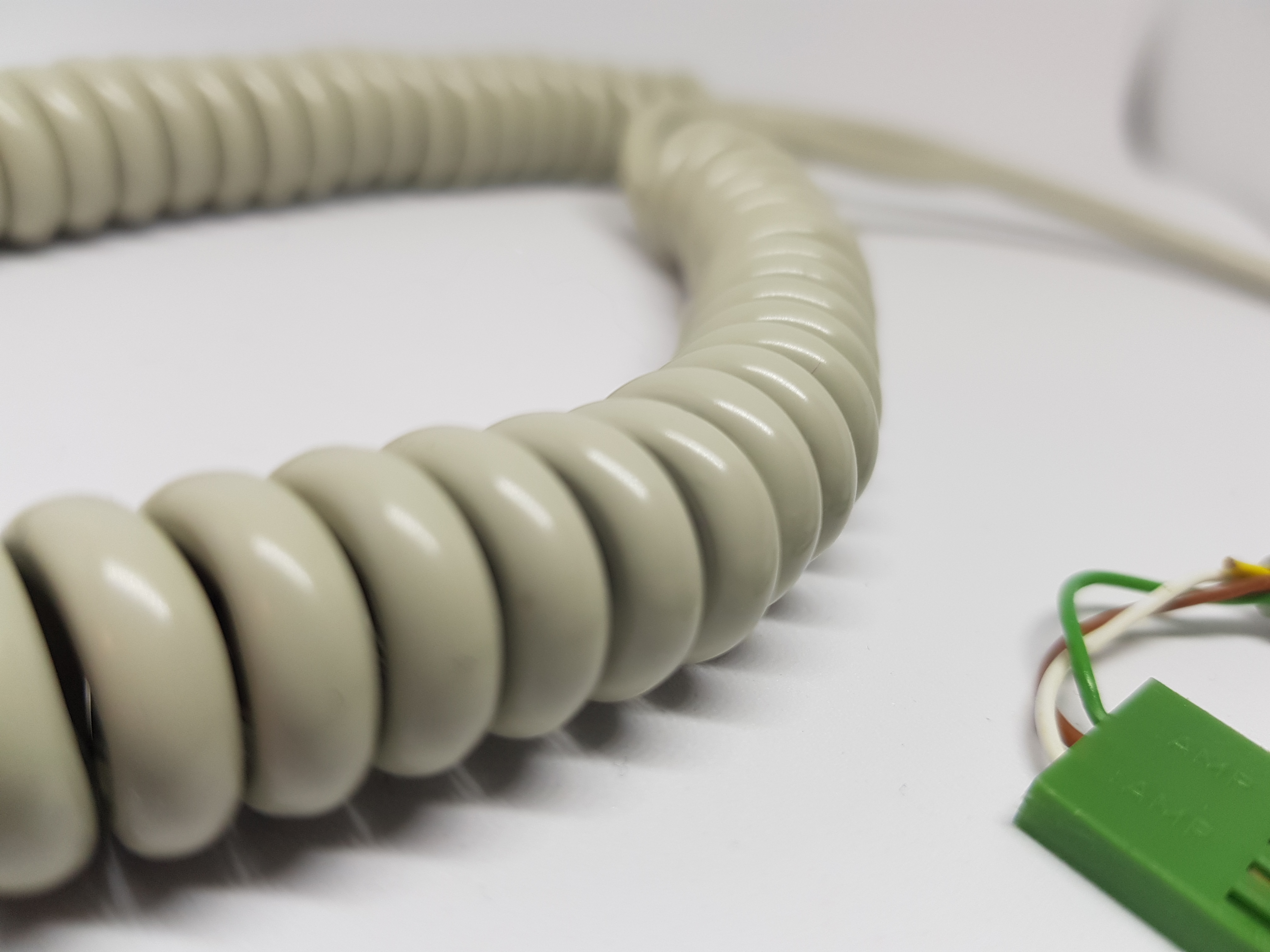

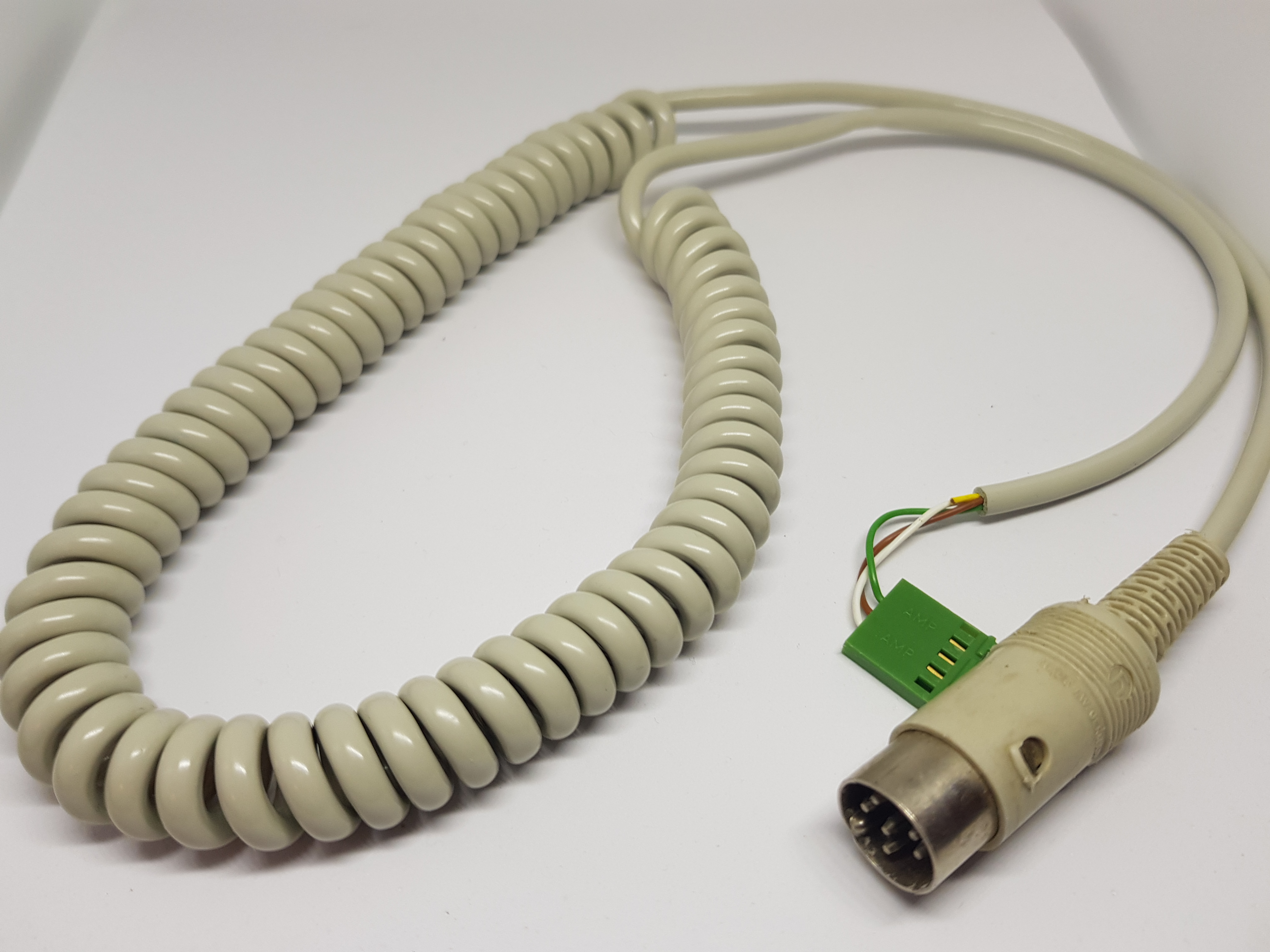

Etikettenentferner works fine, the sticky residue from the cable is gone.
The color is still a bit yellow but that is probably due to aging.

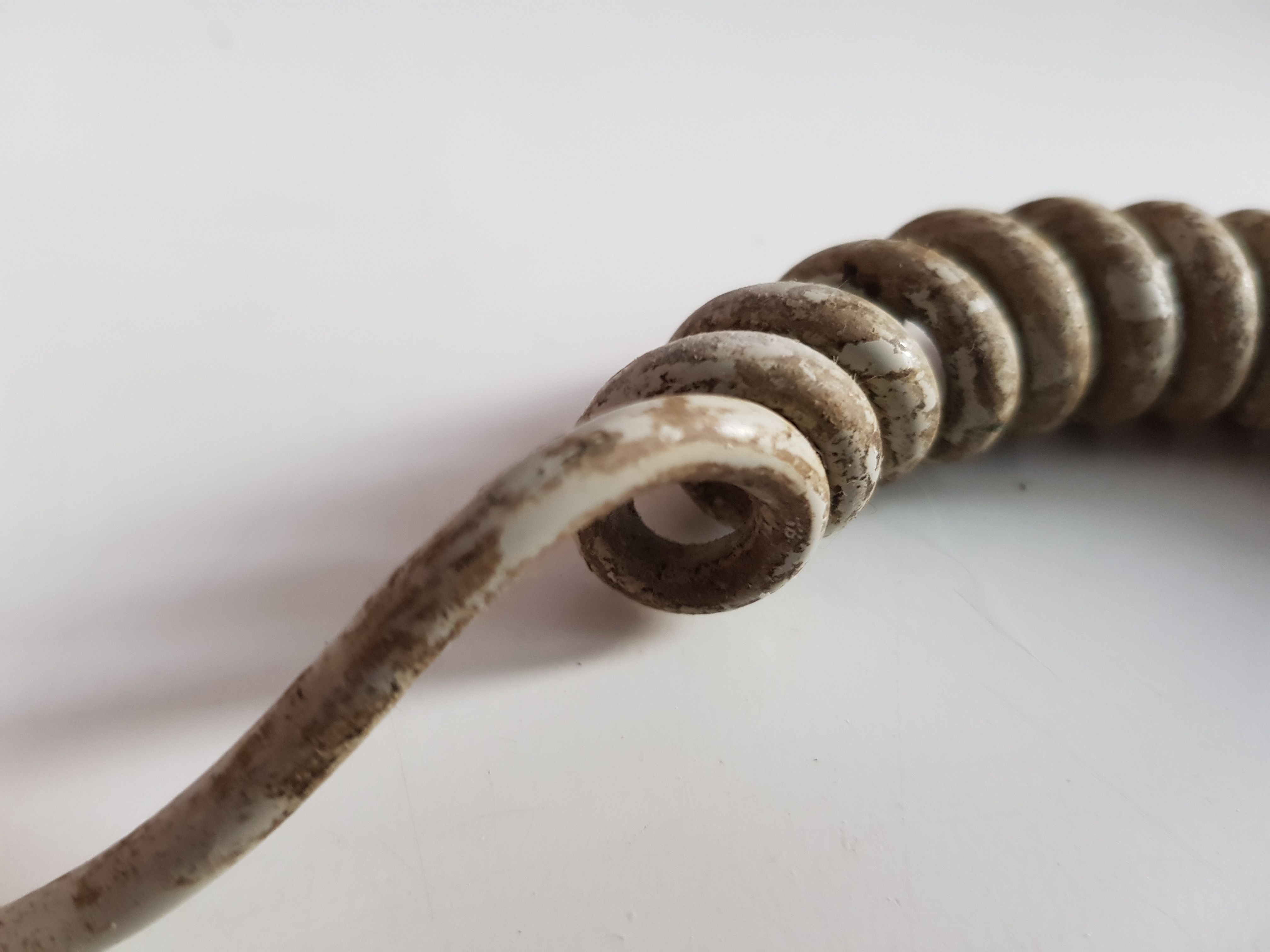

I cleaned a very grimy cable in my ultrasonic recently using only tap water and a ultrasonic cleaning solution, about 10+1 mixture. It actually came out looking pretty clean.
After cleaning
After cleaning
- 20180409_080251.jpg (2.72 MiB) Viewed 5936 times
- I haven't cleaned the ends yet though, figured I´ll do this with a cue-tip and some isopropyl alchohol.
- 20180409_080237.jpg (2.69 MiB) Viewed 5936 times
- A few tiny marks that wouldn't come of. Will try a magic eraser or some such
- 20180409_080221.jpg (2.71 MiB) Viewed 5936 times
- 20180408_194446.jpg (3.02 MiB) Viewed 5936 times
- 20180408_191738.jpg (2.71 MiB) Viewed 5936 times
- 20180408_191732.jpg (3.01 MiB) Viewed 5936 times
- Cable before in all its disgusting glory
- 20180408_191724.jpg (2.79 MiB) Viewed 5936 times
