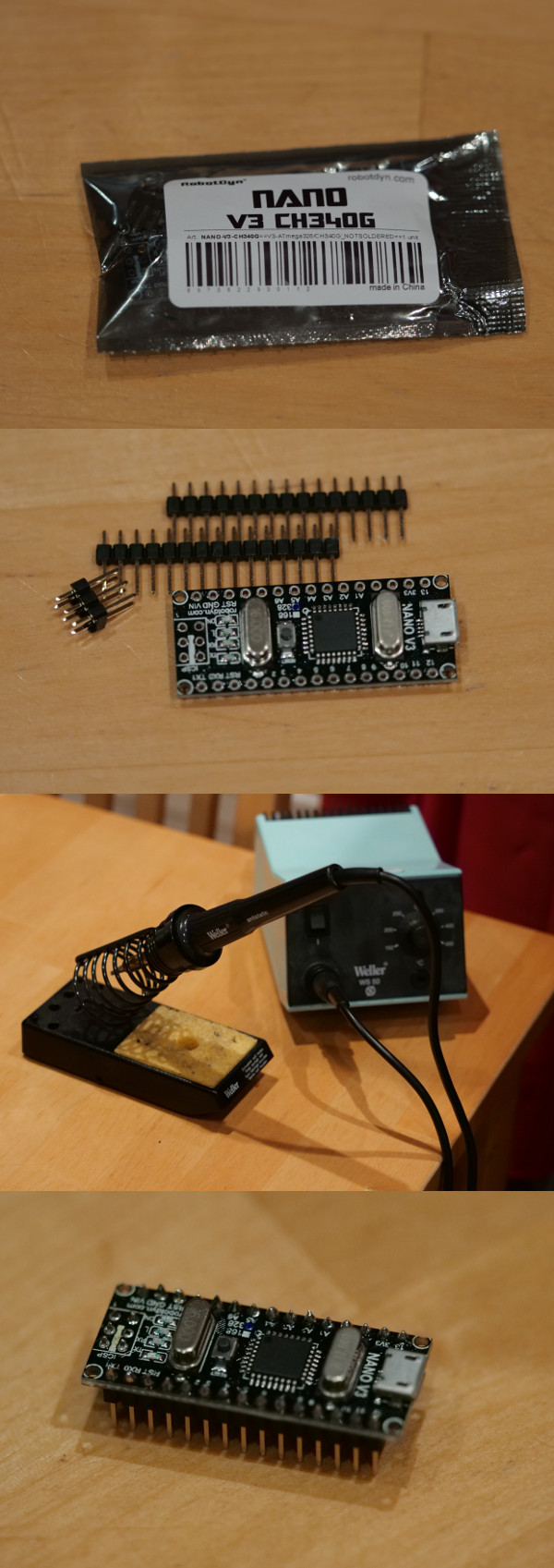

Le Barde
- Location: France
Hello,
I purchased copies of Arduino-nano boards on aliexpress. As they were around 1-2€ each, I purchased 3 of them, should I burn one into flames.
The cards went with separate pins I had to solder. Here is in the bottom what I got.
Now, I would like to use the QMK firmware, but I don't know how to use it with an arduino board.
I looked at the QMK documentation, but I don't know how to program the qmk firmware onto the arduino-nano microcontroller. What I understand is, the microcontroller is compatible with QMK firmware. But as it is written in C, I have to compile it and burn the board in a low-level state, just as any other microcontroller.
Looking at Arduino as ISP, I understand that I can flash my board using another one.
Am I right? Thanks for your advice, because I am a little bit confused

relevant info https://github.com/qmk/qmk_firmware/blo ... rollers.md but I never tried myself. Honestly I don't think the nano makes for a good keyboard controller.
@Le Barde you need to compile and flash your bios. QMK docs are pretty good actually https://docs.qmk.fm/install-build-tools

oh it's ortho. sorry I didn't get that.
if the matrix is done and you don't want to change it, you probably need a new controller.
technically you could remix your matrix to use less I/O but it would be a real headache
- Laser
- emacs -nw
- Location: Romania
- Main keyboard: Plum TKL \w Topre domes (work) / Novatouch (home)
- DT Pro Member: 0180
Maybe an "Arduino Micro" (not Pro) could do the job, you'd be at the limit (it has 20 digital i/o pins) if all those pins can be used:
https://store.arduino.cc/arduino-micro
