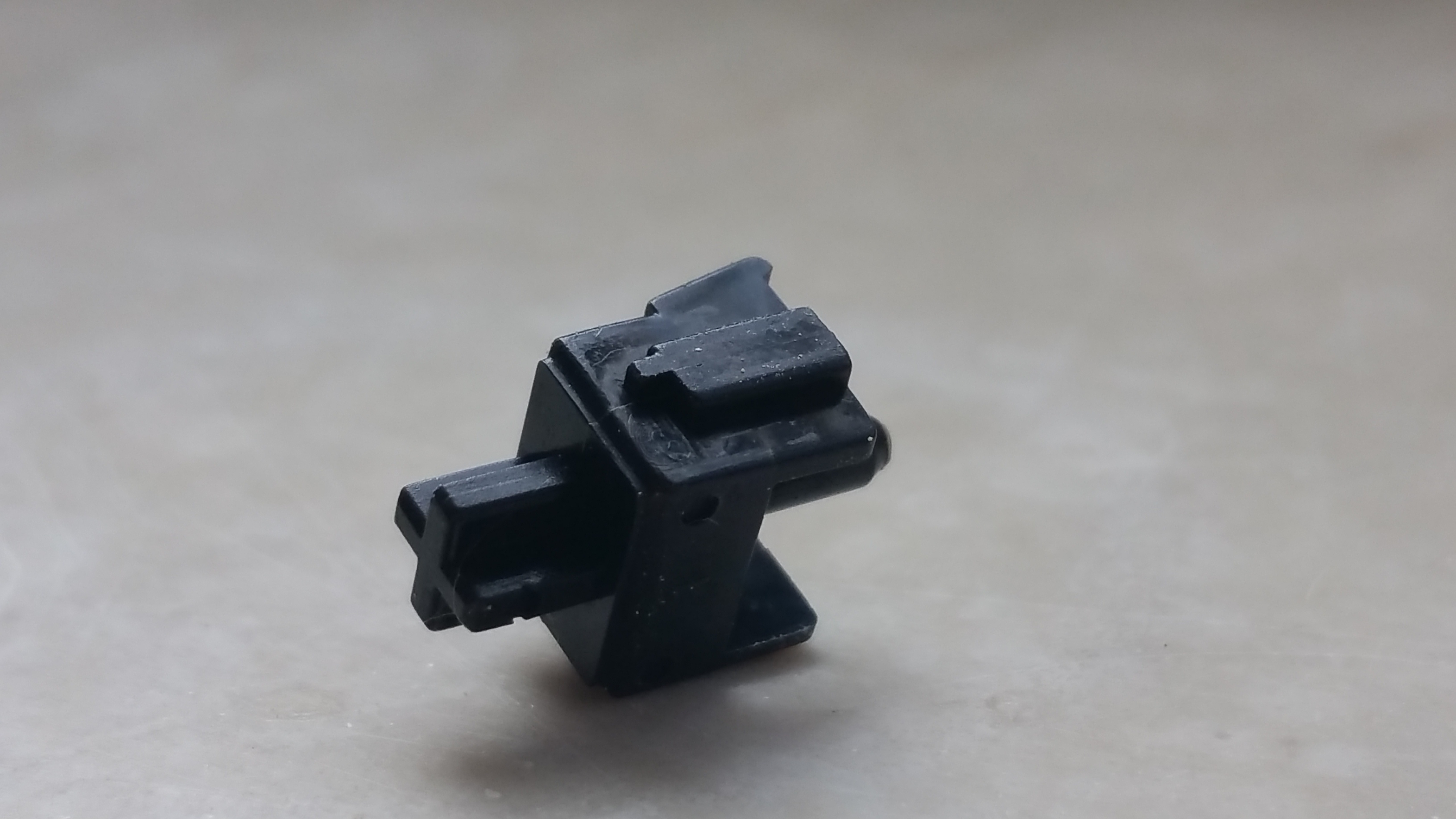

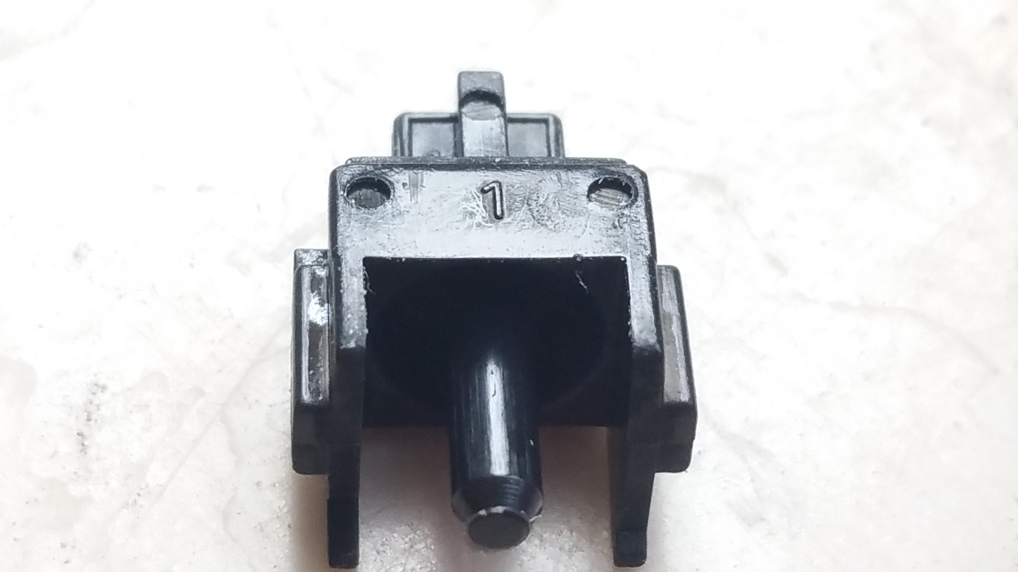

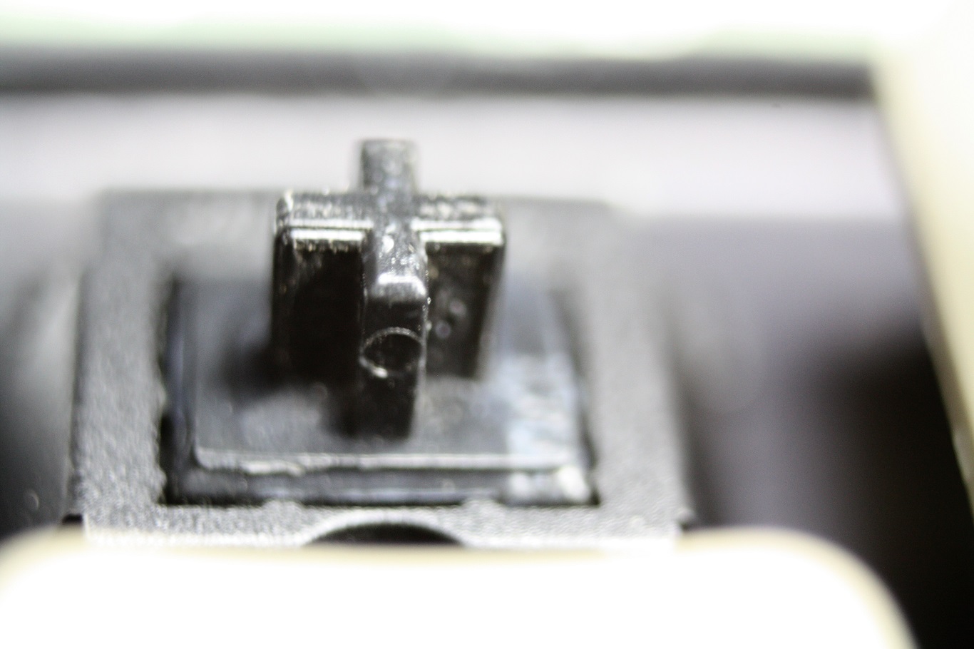

Nope, no notch. Just an "injection port"? Sorry for the blur. I don't have a tripod I can use for that close and I have to hold the camera steady.

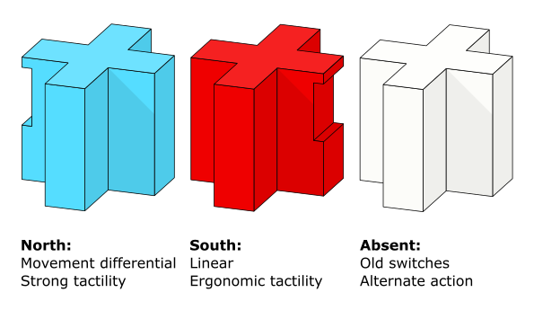

Diagram added to [wiki]Cherry MX Olympia Linear Clear[/wiki] along with other differing dimensions.

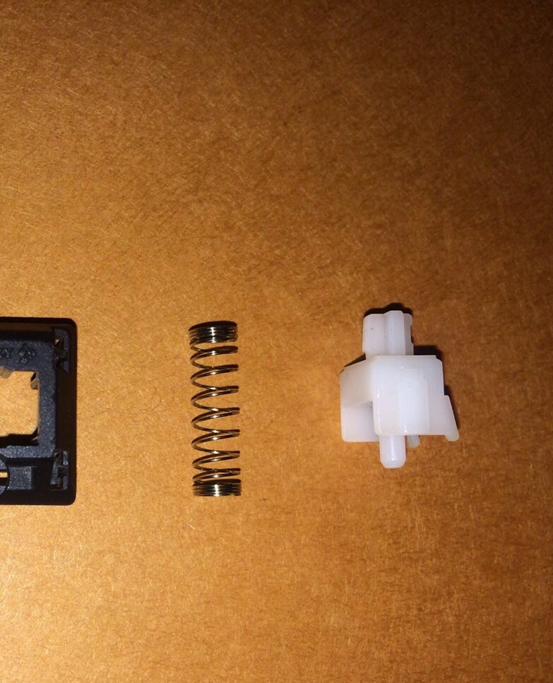

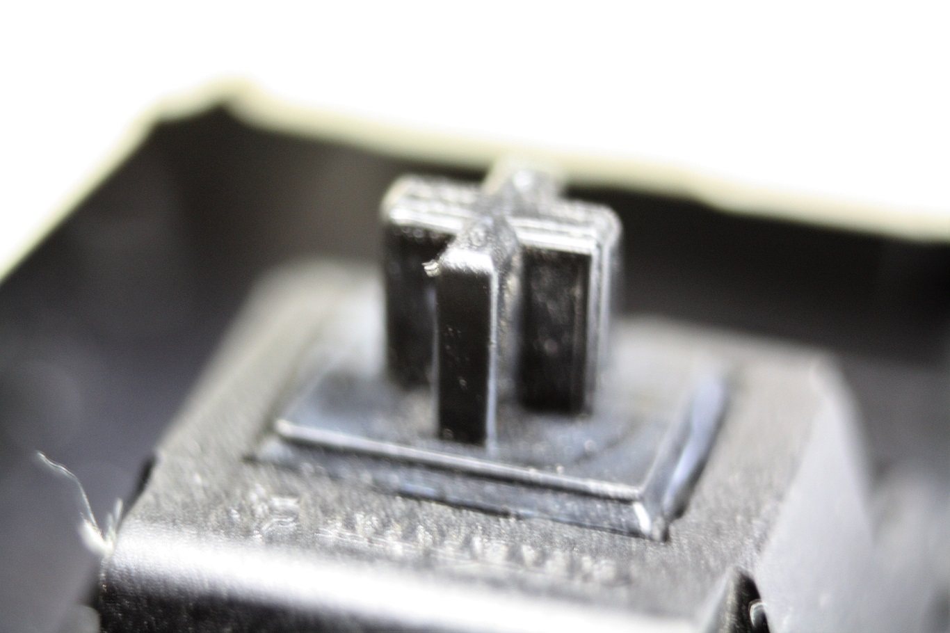

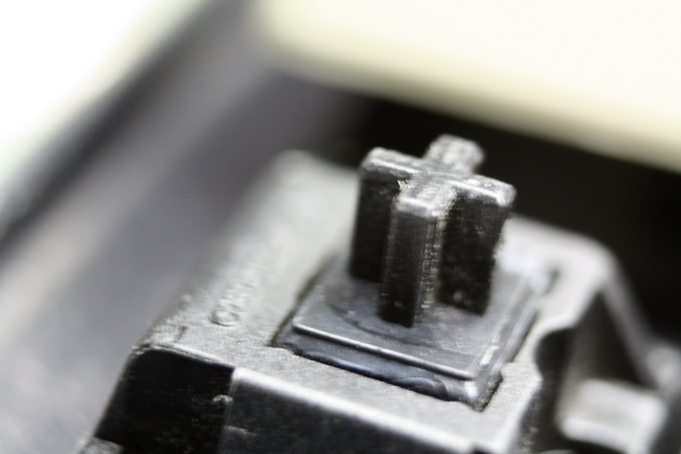

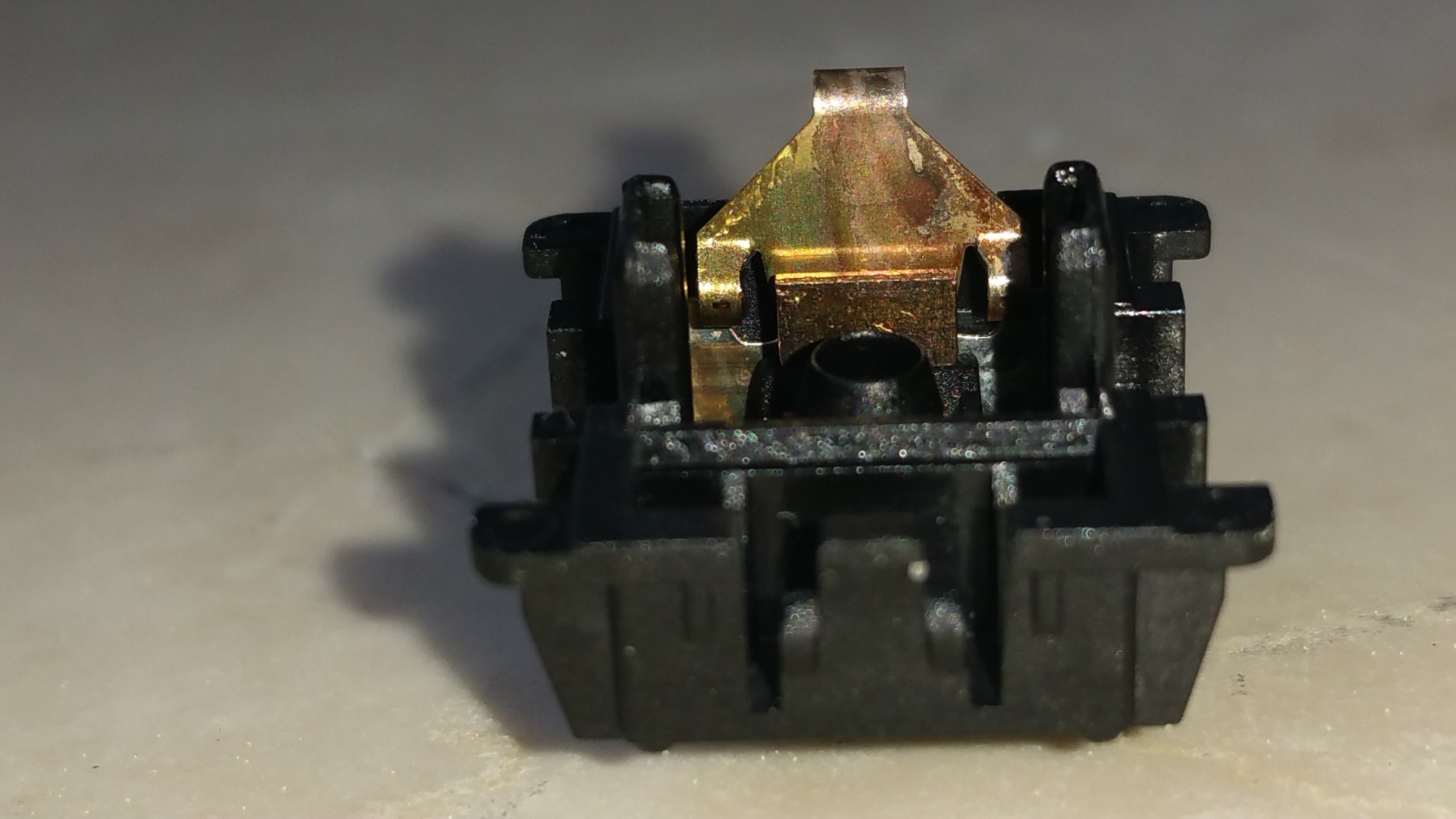

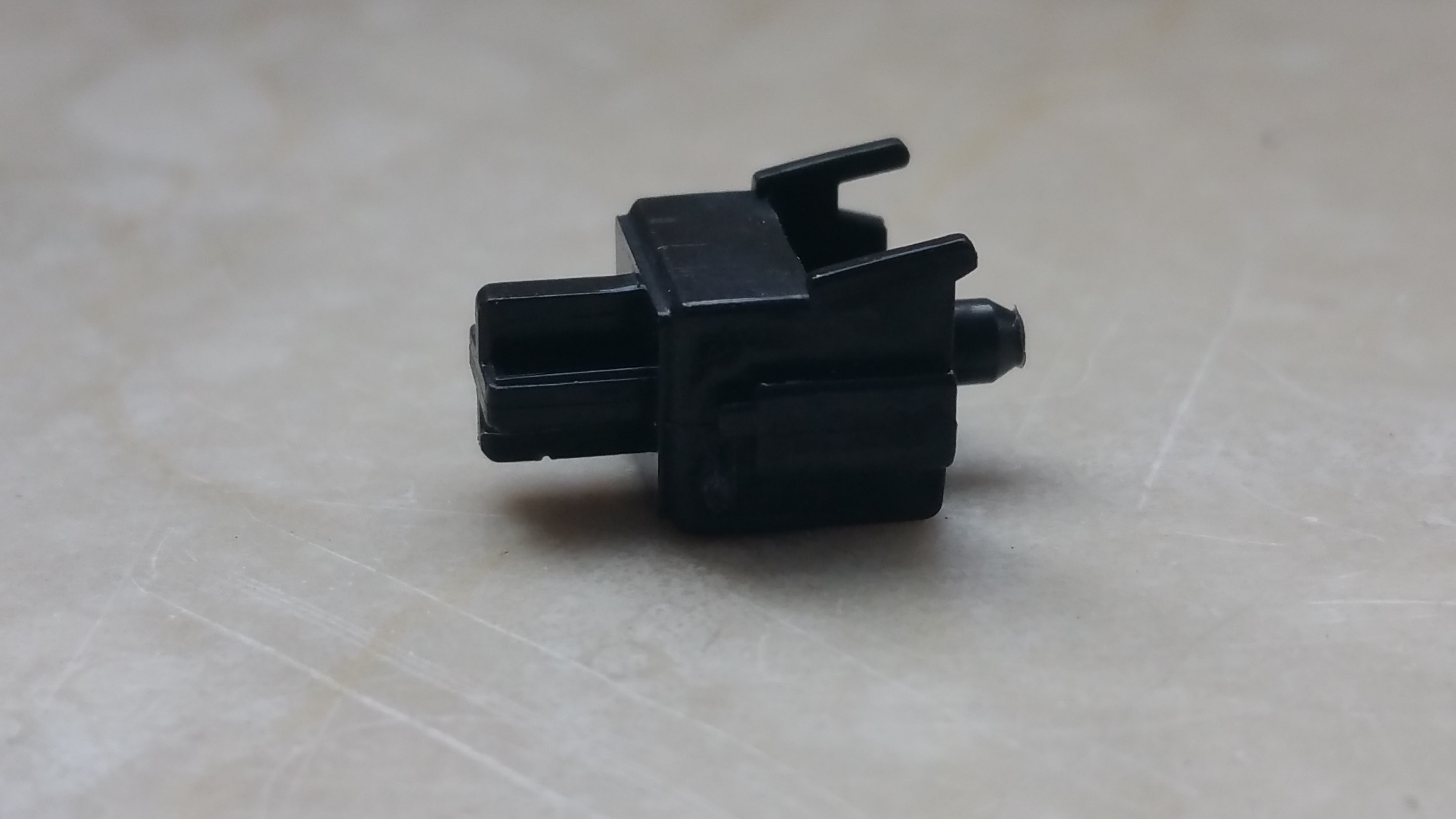

I opened my Triumph Adler Alphatronic PC 50 keyboard which appears to be from around 1984 based on the date codes on its ICs (1983 and 1982) for cleaning recently, and took a closer look at the switches; they appear to be the same type as in snuci's KXN3-8451 keyboard. They seem to be lubed too, and not just at the contact point of slider and contact leaf like in some other cherry switches.
Edit: replaced with better pictures
- slider side
- 20180427_144117.jpg (861.09 KiB) Viewed 9074 times
- slider side edge
- 20180427_144156.jpg (856.66 KiB) Viewed 9074 times
- old contact leaf style
- 20180427_144255.jpg (1.2 MiB) Viewed 9074 times
- slider back
- 20180427_144547.jpg (787.37 KiB) Viewed 9074 times
