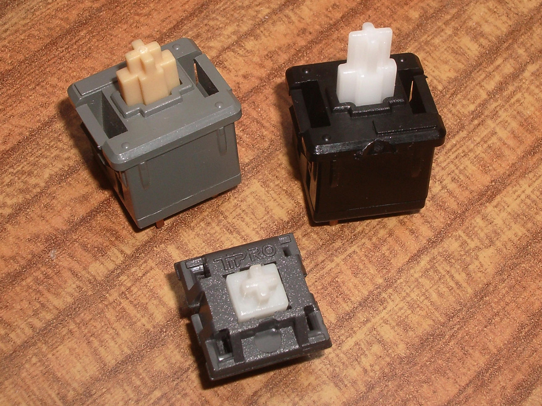

What I actually got was this:
Three different types, from two families
Tipro -- top.jpg (441.83 KiB) Viewed 1661 times

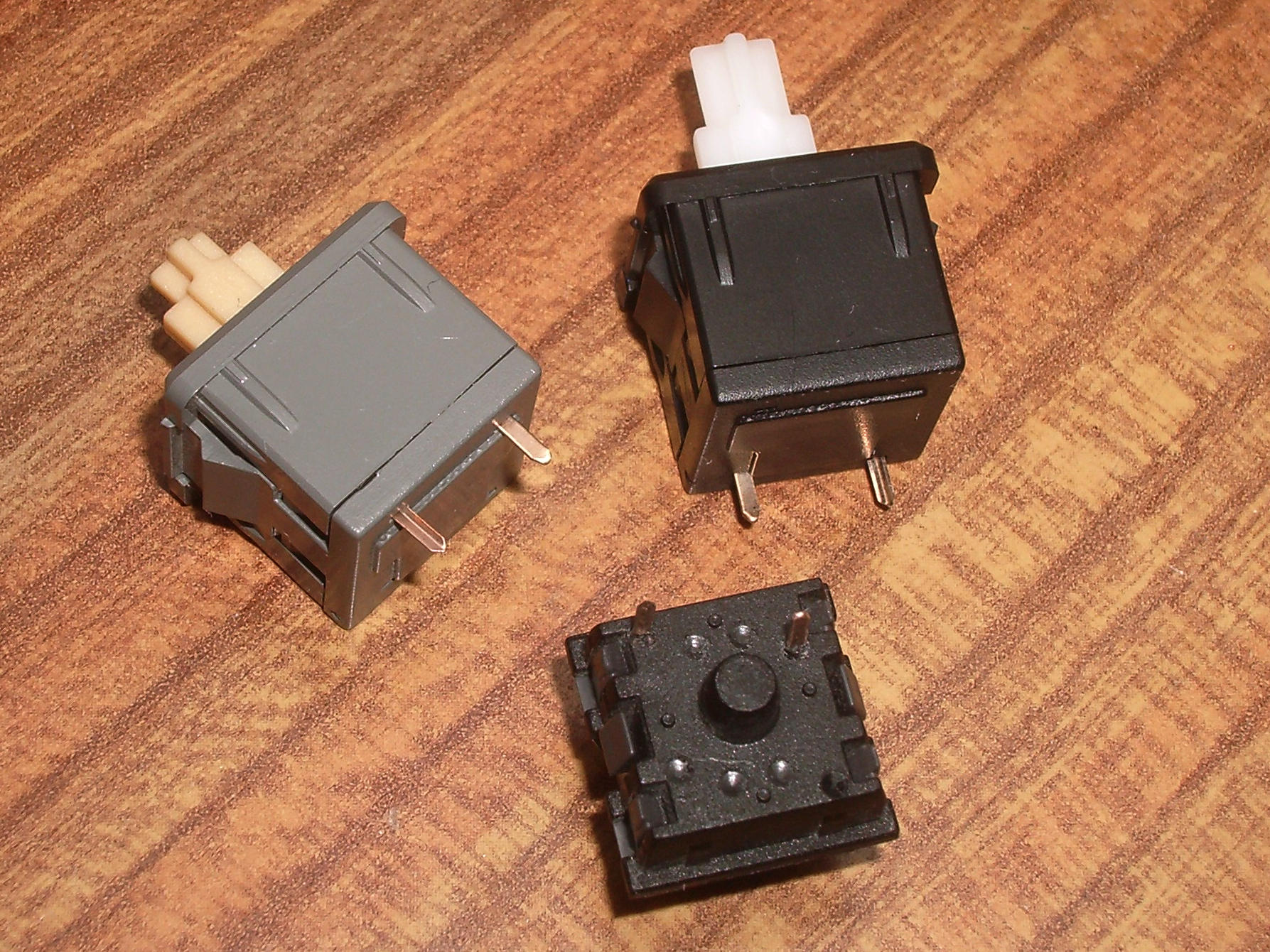

Bottom views, or as close as I can get
Tipro -- bottom.jpg (507.41 KiB) Viewed 1661 times
The larger switches are linear, while the small switch is tactile.

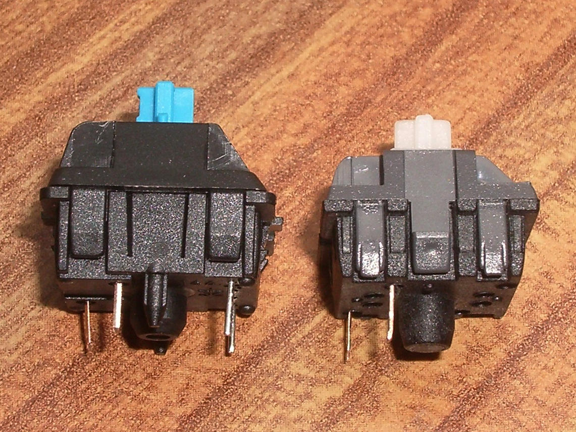

What I didn't realise is just how tiny the Cherry-style switches are:
Tipro -- side.jpg (231.87 KiB) Viewed 1661 times
Note that these do not appear to take Cherry keycaps: the keystem vanes are just slightly too thick. (Tested with GMK and Tai-Hao keycaps.)

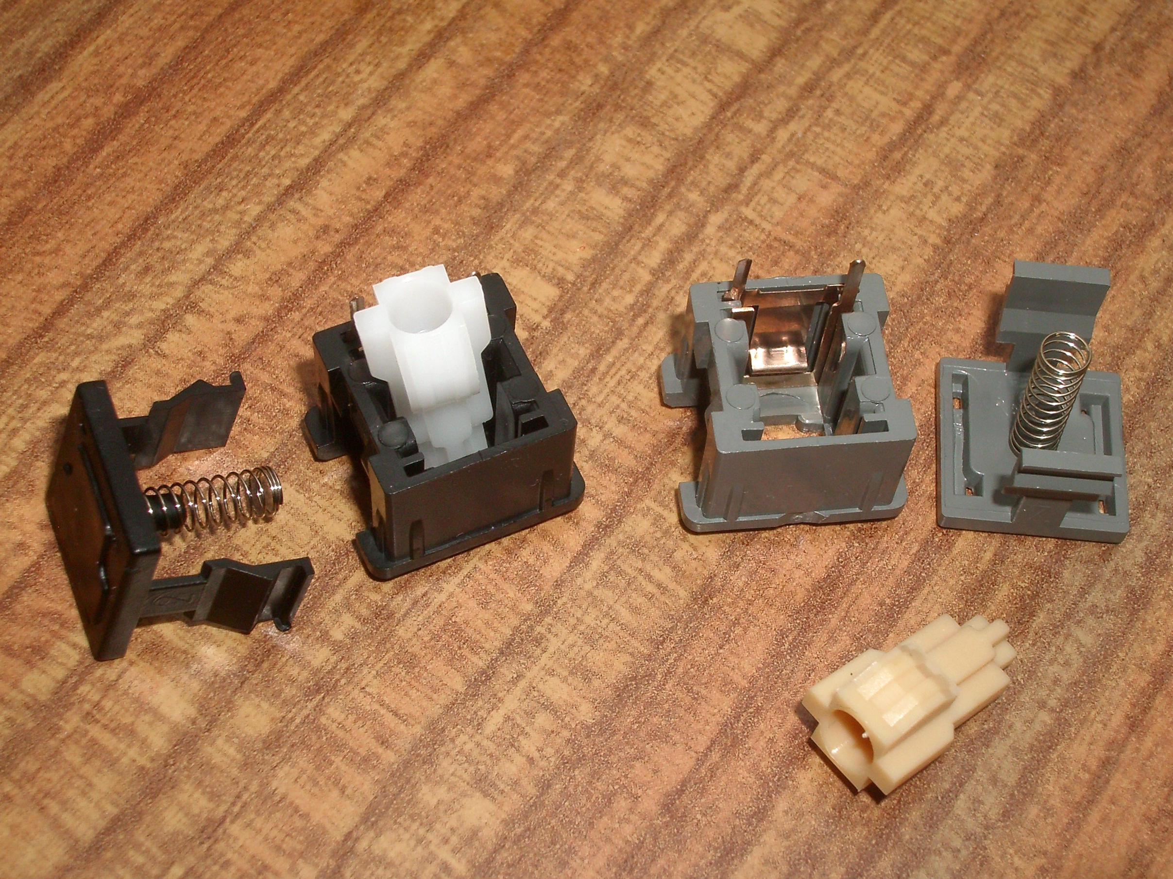

The larger switches are based on SMK J-M0404 series:
Tipro -- opened.jpg (770.3 KiB) Viewed 1661 times
I've already bent a leg on one through just being careless and silly; it straightened out but there's a permanent kink now :(
These are also Tipro-branded, but the branding is extremely faint, and entirely unreadable on one of them. On the other, you can just make out some of the word "TIPRO" from the right angle.

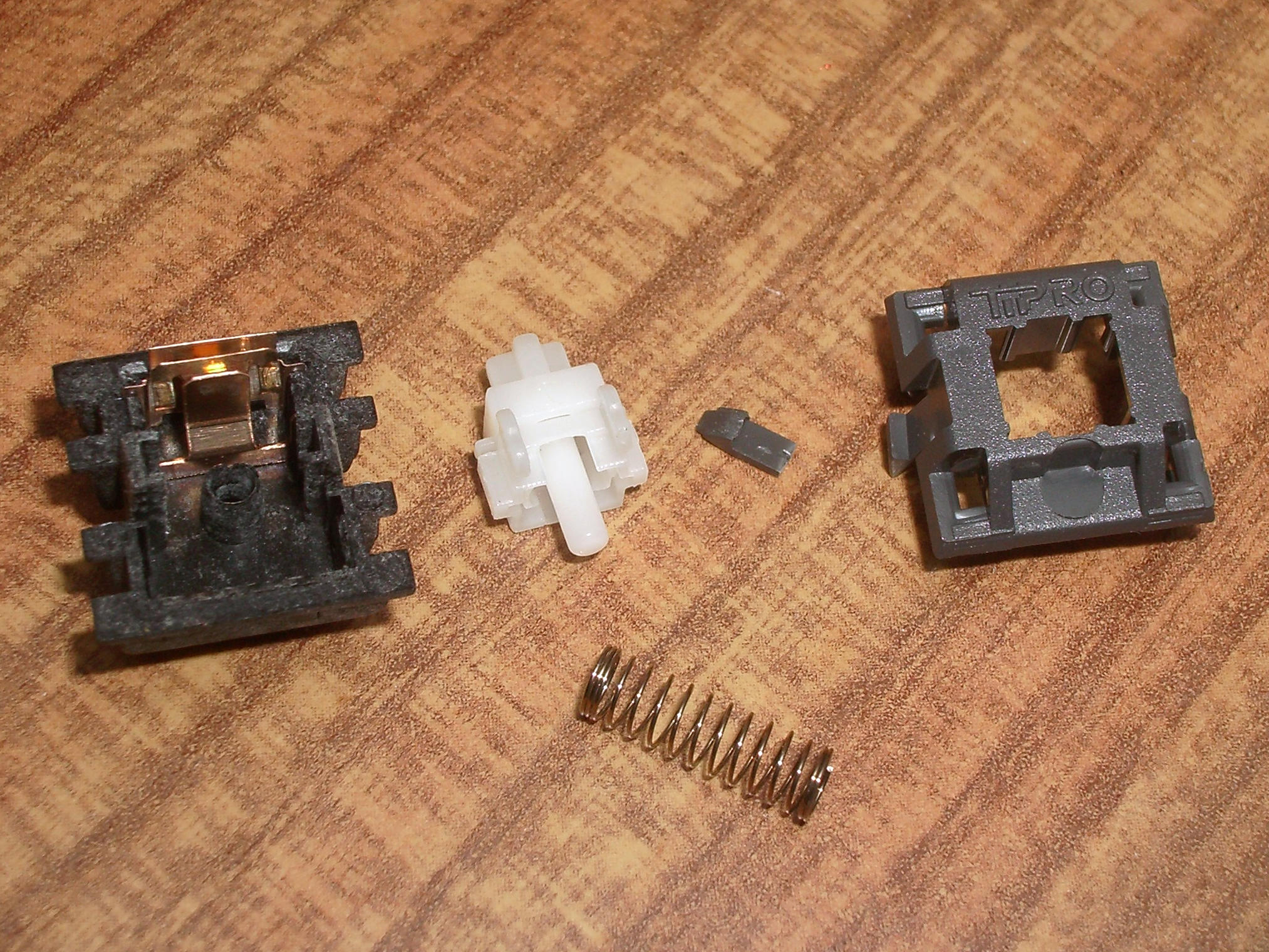

The Cherry-style switch is surprisingly different inside:
Tipro -- opened, 2.jpg (624.41 KiB) Viewed 1661 times

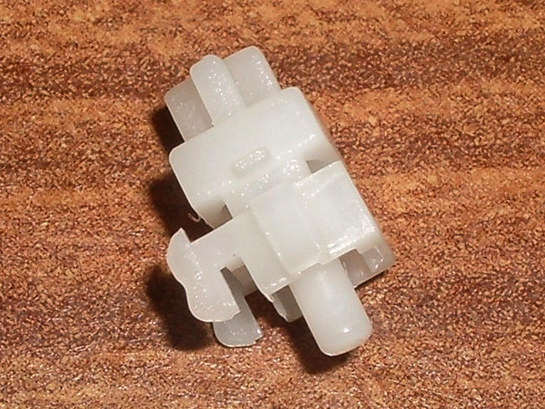

This is the slider design:
Tipro -- slider.jpg (157.25 KiB) Viewed 1661 times
Sadly that one broke already trying to get it apart: I'm not sure quite how they are retained, and one of the retaining clips just bent suddenly. Sadly it's a left side one — the side I photograph from! Maybe I can position it in place with Blu-Tack when I come to take a proper photo on a white background, unless there are any other spares of these :P
