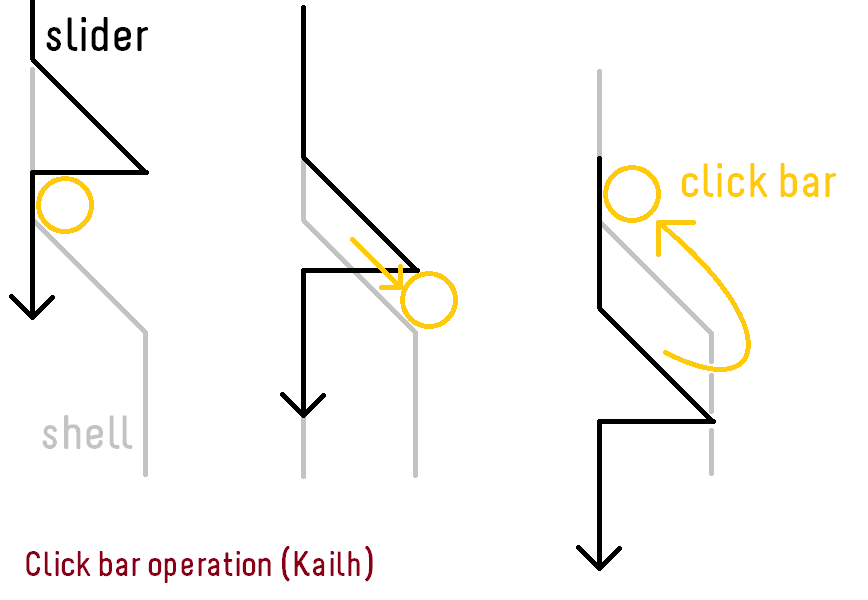

I looked at the cam that operates the click bar and I did wonder how it could possibly be that shape. Now I finally understand: there's a ramp on the shell that pushes the click bar outwards around the cam so that it can snap back up to the top.
Click bar operation.png (16.7 KiB) Viewed 15629 times
Hence the unidirectional cam on the slider: the slider provides the shift cam for upstroke but on the downstroke the shell is used.
Quite ingenious actually. It will be interesting to see how this holds up long-term, as it's always good to see genuine innovation. Maybe not perfect, but a good start. Indeed the click bar could do with being a bit thicker — that heavy clicker, light return spring balance is in part what makes blue Alps so good (the longer lead-in also helps).
The Cherry MX Blue click demonstration sounds horrible in your video, with that nasty rattle — but that's exactly what's happened to my Filco: instead of a sharp click, many keys rattle. In typing, though, I never notice, so it's not a big deal even though it was a disappointing discovery originally. So long as you hit keys fast enough, it's not a problem. However, a sharper click would still be a definite improvement.

Interesting, it would be nice if the wedge on the slider was hinged at the top and held out by a very light spring such that it would force the click bar outwards on the down stroke but be pressed back into the slider on the upstroke eliminating that secondary click.
