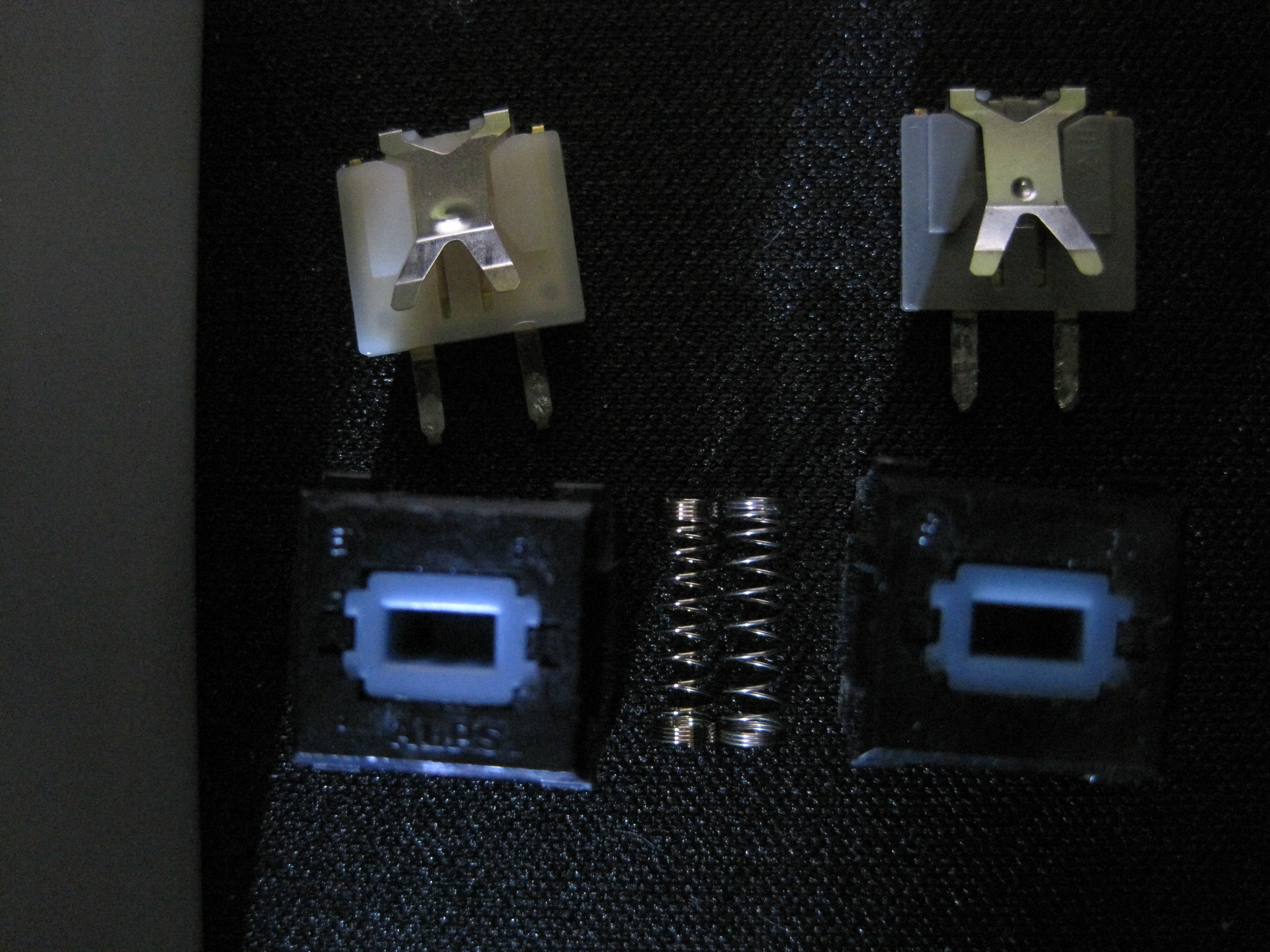

Are some of my Blue Alps actually White in disguise?
M4dn3ss
09 Aug 2017, 12:07
I recently bought a bunch of Blue Alps switches and noticed that the top housing on some of them had ALPS printed on them, even though Blue Alps aren't meant to have that.
I didn't think too much of it until I opened some of them up, and I noticed that the switches with ALPS on the top housings had a white switch plate, and the springs had more coils than the springs in the non-branded Blue Alps (does this make them heavier?).
I opened up some of the White Alps switches on one of my old keyboards and compared the springs and they were identical to the ones in on the branded Blue Alps.
In the photo below, the spring and other parts on the left are from the "maybe-blue-maybe-white" Alps switch and the parts on the right are from the "most probably definitely blue" Alps switch.
I can't really tell the difference in feel when the switches are loose but I wouldn't want to solder them all in to a board and realise that some feel different to others. Can anyone tell me what's going on with these?

Looks like you might have the "rare white switchplate" version: wiki/Alps_SKCM_Blue

M4dn3ss wrote: I recently bought a bunch of Blue Alps switches and noticed that the top housing on some of them had ALPS printed on them, even though Blue Alps aren't meant to have that.
No, don't worry about the number of coils. As an example, Alps SKCL Brown springs and SKCL Green springs are the same length and have the same number of coils but are very different weights. Also, Alps SKCM White is part of the beginning of the second generation of Alps switches, with short white switchplates. That is one of the more noticeable differences. Another is that blue Alps has lubricant applied to its sliders whereas Alps SKCM White has none and instead uses a plastic with less friction.
What you have found are late model Alps SKCM Blues, which are totally normal and legitimate. No worries. :) They are pretty uncommon to see, actually. Versions without the top logo but with long white switch plates also exist.

Alps switches had numerous revisions, their changes over time, including that of white to blue, are well-known. Logo'd blue Alps are quite rare, but known. It's stranger that your blue Alps span several revisions even inside the same single keyboard tbh Oo .

Chyros wrote: Alps switches had numerous revisions, their changes over time, including that of white to blue, are well-known. Logo'd blue Alps are quite rare, but known. It's stranger that your blue Alps span several revisions even inside the same single keyboard tbh Oo .
That's probably the case. I just separate all the branded switches and realised that the sliders on those are lighter blue.
BTW, these switches are probably not all from the same keyboard. I bought them loose, and they were someone else's spares they'd acquired for a Clueboard.
I just hope they aren't going to feel different when actually in a board.
09 Aug 2017, 19:16
M4dn3ss wrote: I just hope they aren't going to feel different when actually in a board.
They will; as the components changed over time, so did their keyfeel.
I have actually seen switch variation in a single board before though. I've seen both grey and white long switch plates in my Alps SKCL Cream Bondwell PRO 8T laptop as well as a mixture of black and grey long switch plates in an SKCM Blue Leading Edge DC-2014 I purchased a few months back.
So yeah, you can find some mixes in a single board, though you have clarified that this is a different case. You'll only really feel a difference if the later model blue Alps ditched the lubrication on its sliders and changed the plastic. I do not think this is the case with them.
I can't be sure about the short switch plate versions, but you don't have to worry about that.
Also, don't mind the color variation with sliders. The dye they used must've been prone to fading, and there's often a lot of inconsistency in slider color even across the same board. That's normal.

I do agree that switchplate length does not change the feel. It might have a minuscule change on acoustics, but I'm not sure.
It's really the change from a lubricated slider to a more slick plastic slider with no lubricant. Despite the slicker plastic, it's not smoother in feel. You can feel this in comparing Alps SKCM Green to Alps SKCM Brown especially.

Ah great, well I basically have 3 different batches then, haha.

balotz wrote: I have the same combo in my Packard Bell. The switches are really smooth, which must scupper the theory that the difference in feel between blues and whites is down to the switchplate.
I still think it plays a role, though. Regardless, the biggest determining factor for keyfeel (for alps at least) is condition.
