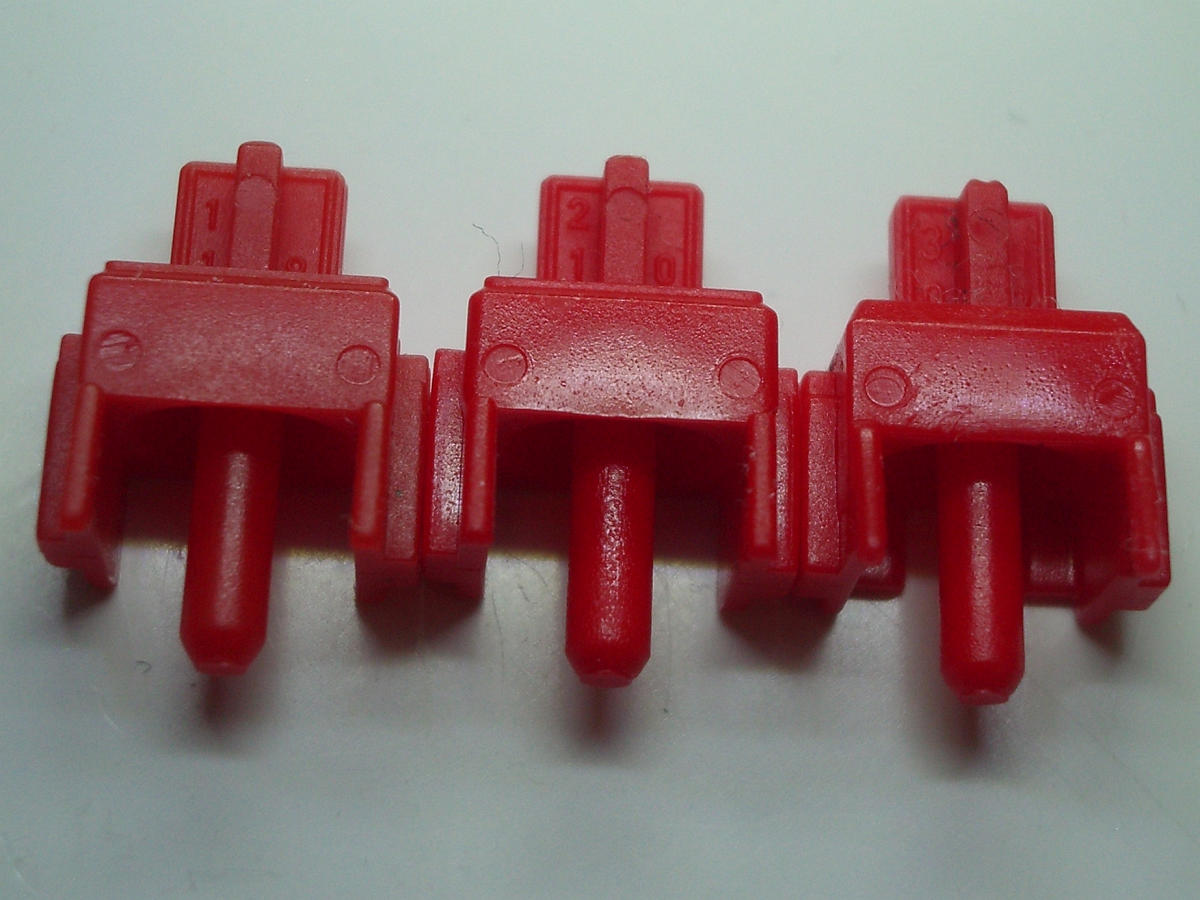

Cherry changed the material or finish and the shape of their sliders recently — that "pyramidal" base is the new design:
Notice the lack of step and the cross arm recess, just as in the AliExpress photo. There are Geekhack topics about it, and one topic has some more detailed photos I took that shows the smoother material or finish of the newer sliders. This is one of the photos I took; older MX Red (ca. 2012) red is on the left and the other two are older and newer batches of MX RGB Red that have different revisions of slider, with the most recent batch having the "pyramidal" base:
The "coppery" Kailh sliders are a much more pink colour than Cherry's brown. (Copper is bright pink-orange, but "coppery" sliders are much darker.)
