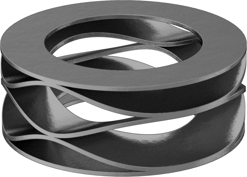

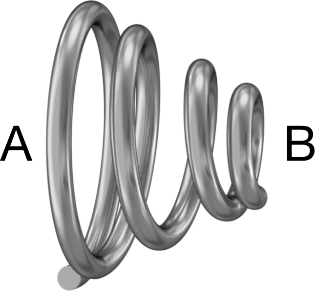

jsheradin
01 Apr 2022, 17:53
Jan Pospisil wrote: 01 Apr 2022, 16:29 A possibly incredibly stupid question - has anyone tried replacing the foam with a very short spring?
Sourcing springs with sane weighting might be difficult and would probably need a GB. That diameter and length are only mass produced in wave and conical springs from what I know. I bet the capsense mechanism would still work if the foam pads were replaced entirely by a topre like spring and the PCB covered in kapton tape. The metal of the spring would be enough that you don't need mylar but sensing too early might be an issue.
1800g bottom-out might be a bit much.
Weighting is again an issue at 1600g.
"Keytronic to linear Topre conversion group buy" sounds interesting.

I've also considered whether it would be possible to replace it with a spring.
I haven't considered conical. Would you then mount the conical spring directly to the PCB instead? I'm a little concerned, whether a spring would reverberate too much, and cause faulty keypresses this way. Topre overcomes this, by having the dome double as a dampener for the spring. And most compression springs in other switches are compressed, even when they are as extended as they can be, making the slider stay put when there are spring reverberations. The foam pad (I guess this is also a compression spring) has built in dampening to overcome this.
The wavy spring seems super cool to make a drop-in replacement if it was available in a light enough weight.
But to come back to the conical spring. Would a conical spring that is slightly compressed when the switch is resting work out, if the sense level is set in a way, that it will actuate when the switch reaches a given position? Or am I just science fictioning capsense?

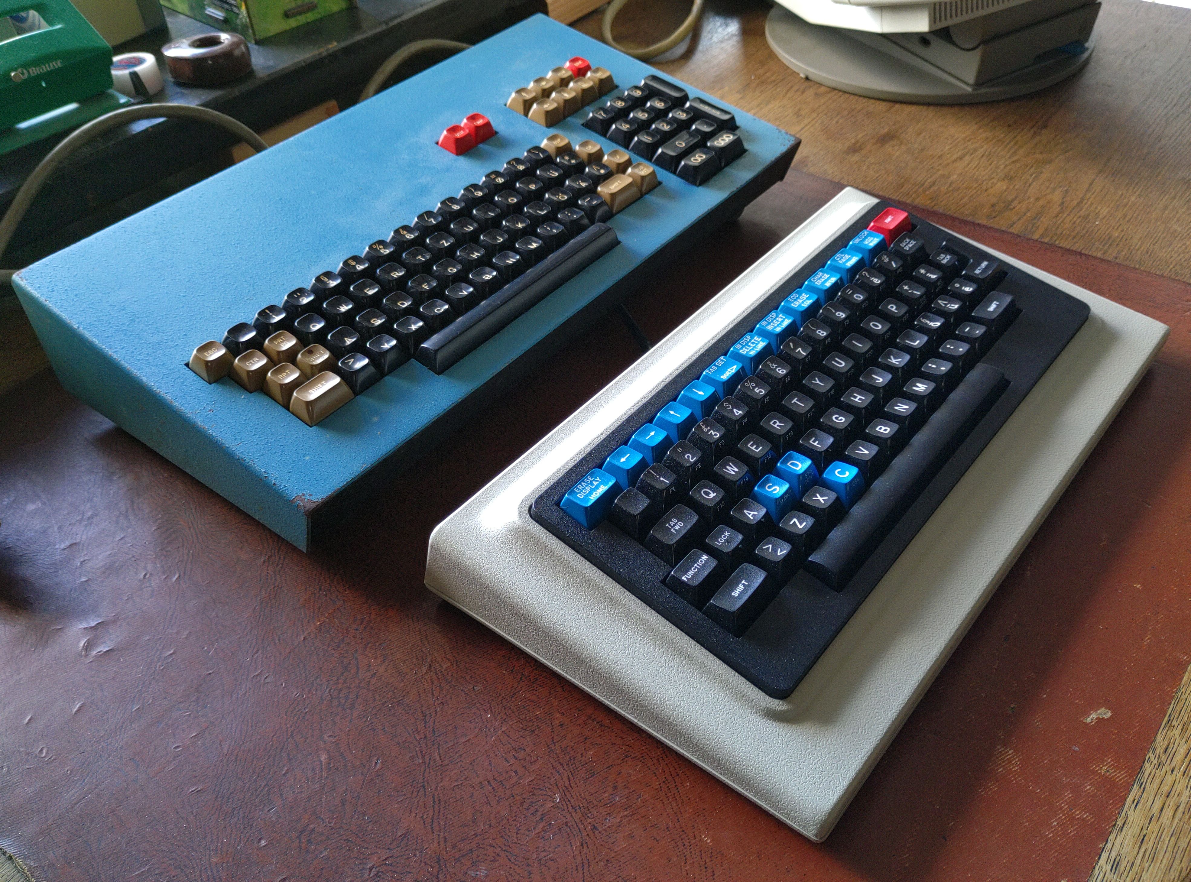

TNT
03 Apr 2022, 16:56
I've replaced mine with those Texelec Pads and kinda like them. But a conversion like this sounds interesting, to say the least.
Since I don't want to face prison time for committing a major offense, here's my picture with a little nod to the original:
Jan Pospisil
03 Apr 2022, 23:10
They really are quite handsome keyboards.
