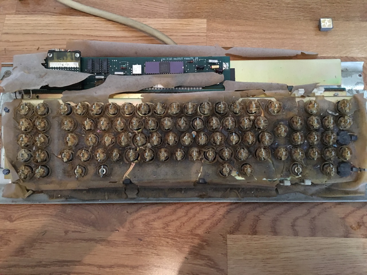

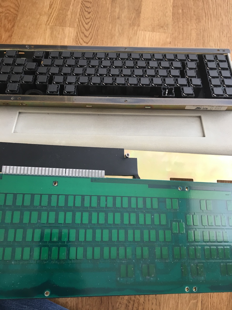

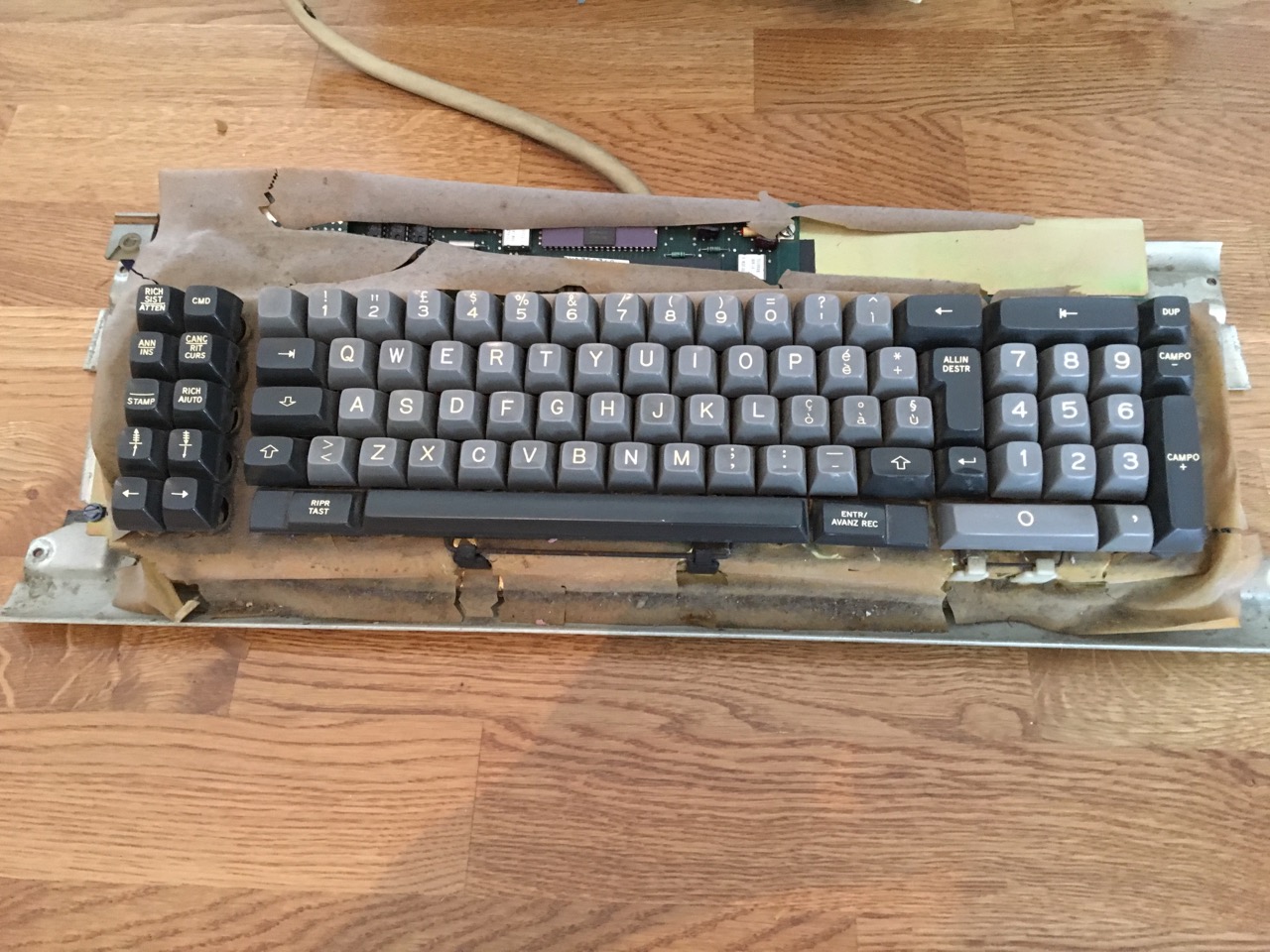

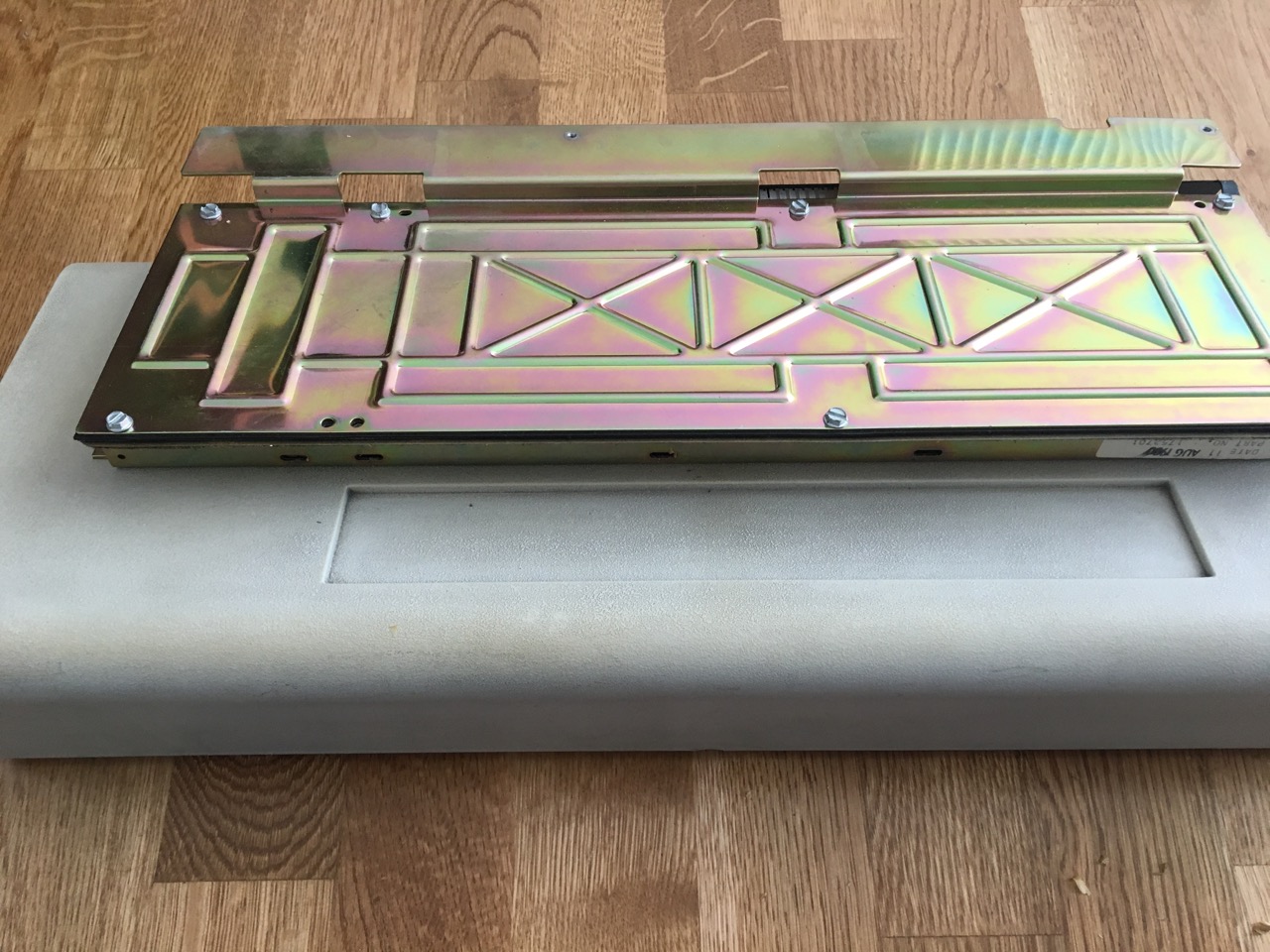

I have taken apart and started cleaning my beamspring keyboard. The key caps were very difficult to remove but I managed to do it with a key cap remover. The contamination shield had disintegrated. I removed it and cleaned off the switches. I took out the main keyboard sandwich. Should I bother taking this apart before I have a chance to test the keyboard? I do not have a keyboard controller to test it with yet. I included pictures of my progress.

There is little reason why it wouldn't work, so I wouldn't wait for the controller to come in to start restoration. I think if you are lucky you may not have to replace the foam, which is hell.

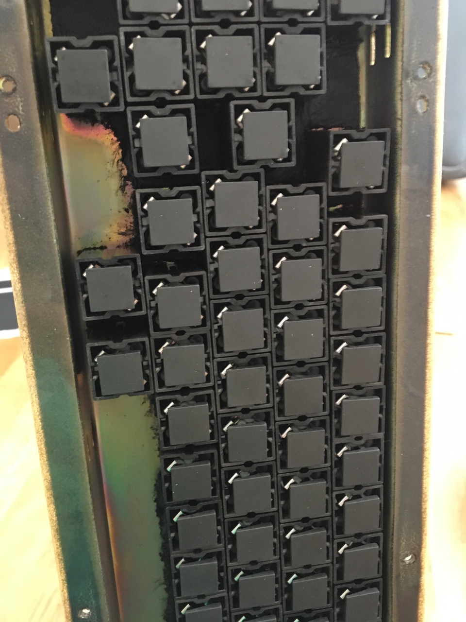

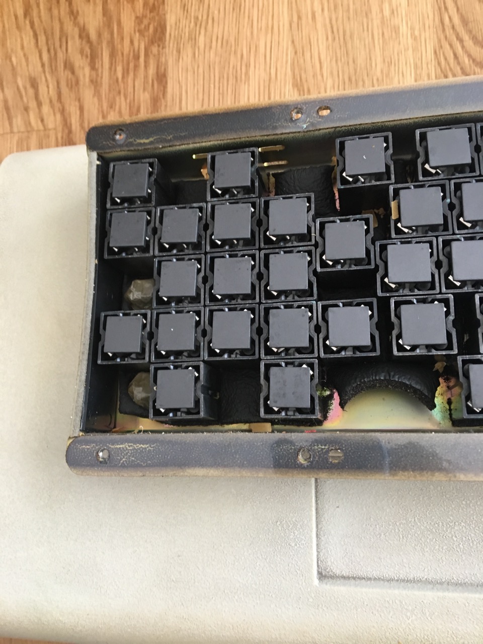

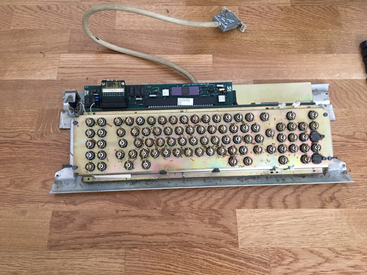

The foam doesn't look great but maybe it will be alright. I would rather not have to remove all of the switches and I don't have anything to replace the foam with. Do you think it's fine to clean the contacts and pad card, leaving the foam alone? Ignore the remaining bits of the contamination shield in the last image, I've already cleaned it out.

That foam looks roasted, now if you don't have the time for a full restoration and since you switch plate is basically rust free you could just clean off the sense pad (pcb) with some Iso alcohol and clean the contact pads on the switches. Bolt it back together and use it until you get more time to do the foam restoration or until some foam gets knocked loose and messes with the switch contacts. There are people here who have done that, mostly because it takes a bit of skill and time to do the foam work.

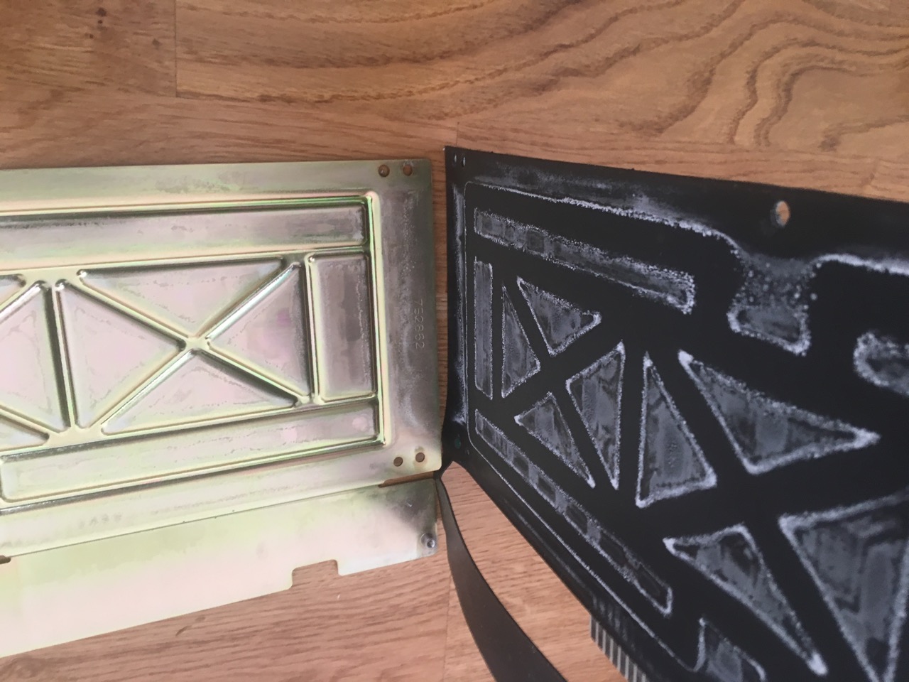

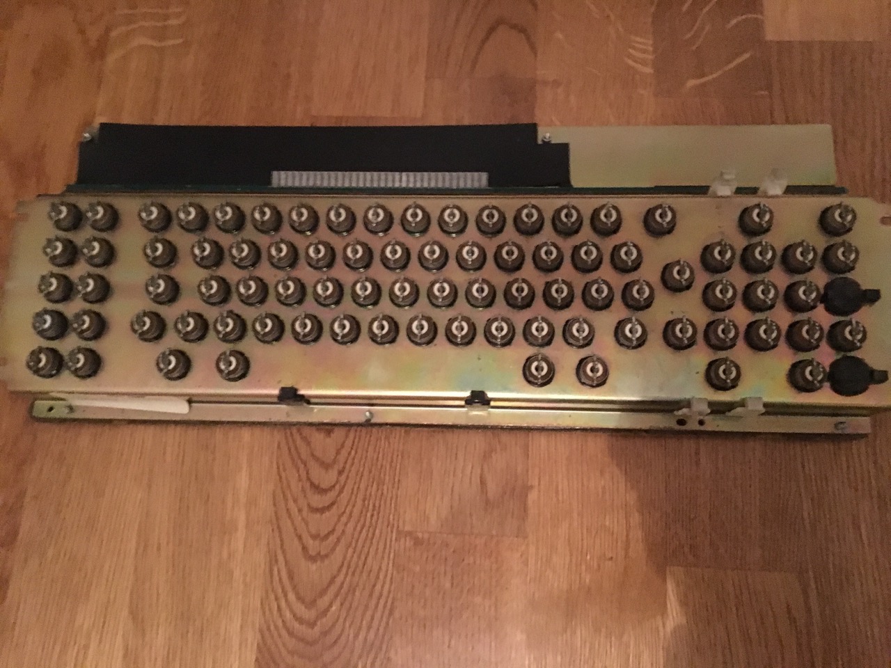

I really don't want to remove all of the key switches and I don't have any replacement foam. I would consider it if someone sells already cut replacement foam. For now, I think I will leave it as long as it works. There's no rust on the switch plate. I will clean the switch contacts and PCB with isopropyl alcohol. Should I use alcohol to clean the switch plate and rubber mat underneath the PCB as well? Do you know what this stuff is on the rubber mat and switch plate?

You should clean it and dry it well, as it should help with corrosion as long as you don't remove the layer of patina (don't use harsh cleaners like Brasso). I don't know what the rubber for your keyboard is made of because it seems to be different then mine so I would stick with warm water with a tiny bit of unscented soap. Iso alcohol is fine on the metal 100%.

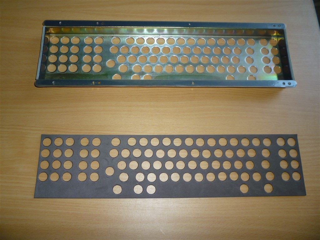

@limelight: I've recently replaced the foam of an IBM 3101 with a 2mm art foam with a good result, you have only to
build up a template and then using a 15mm hollow punch to do the holes.

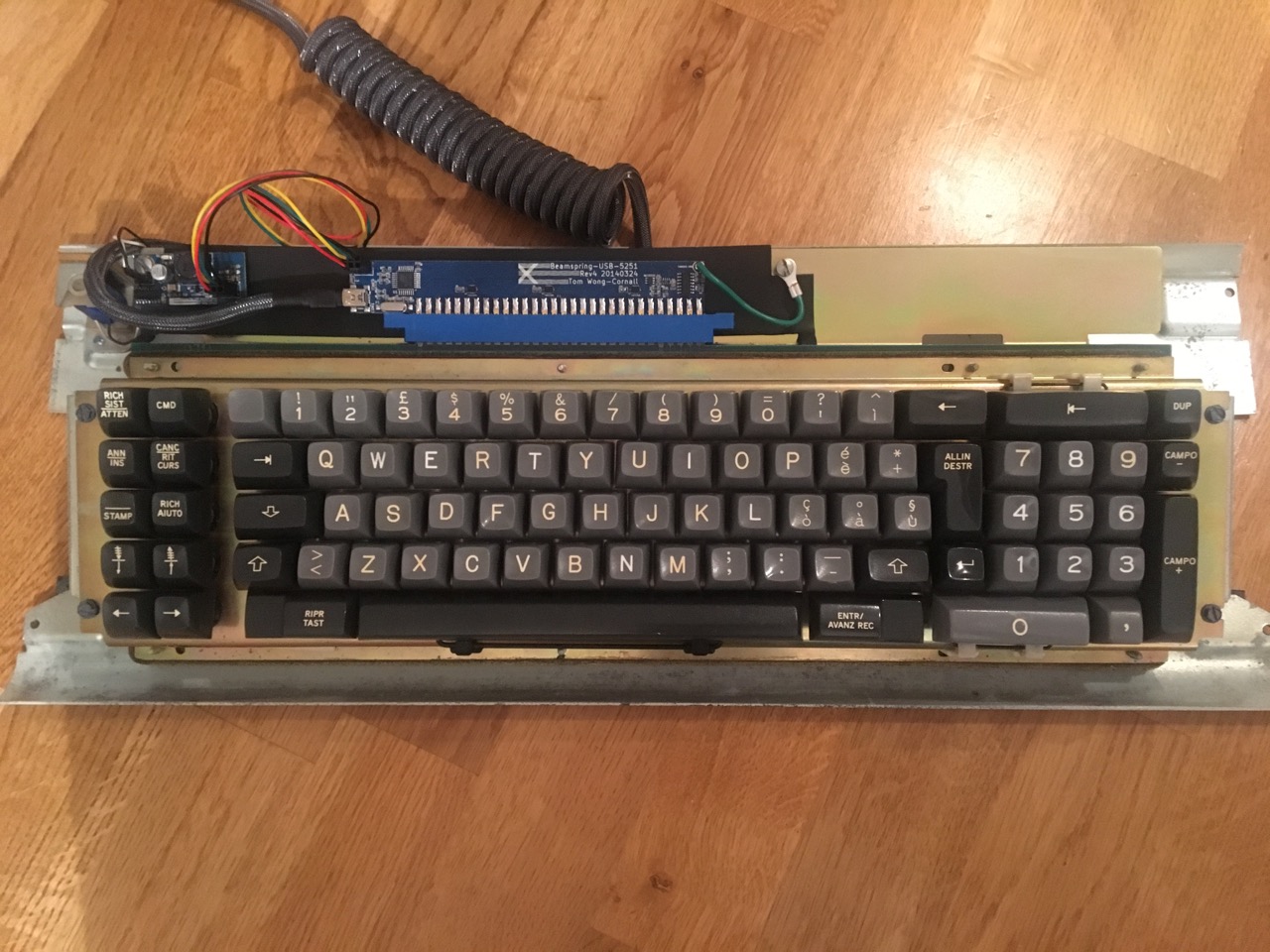

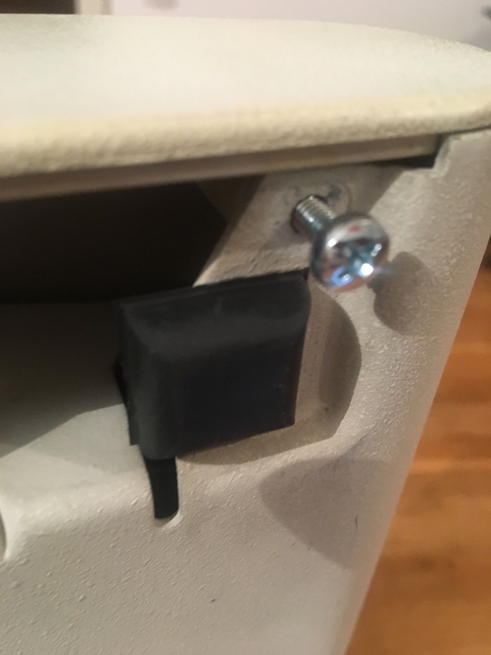

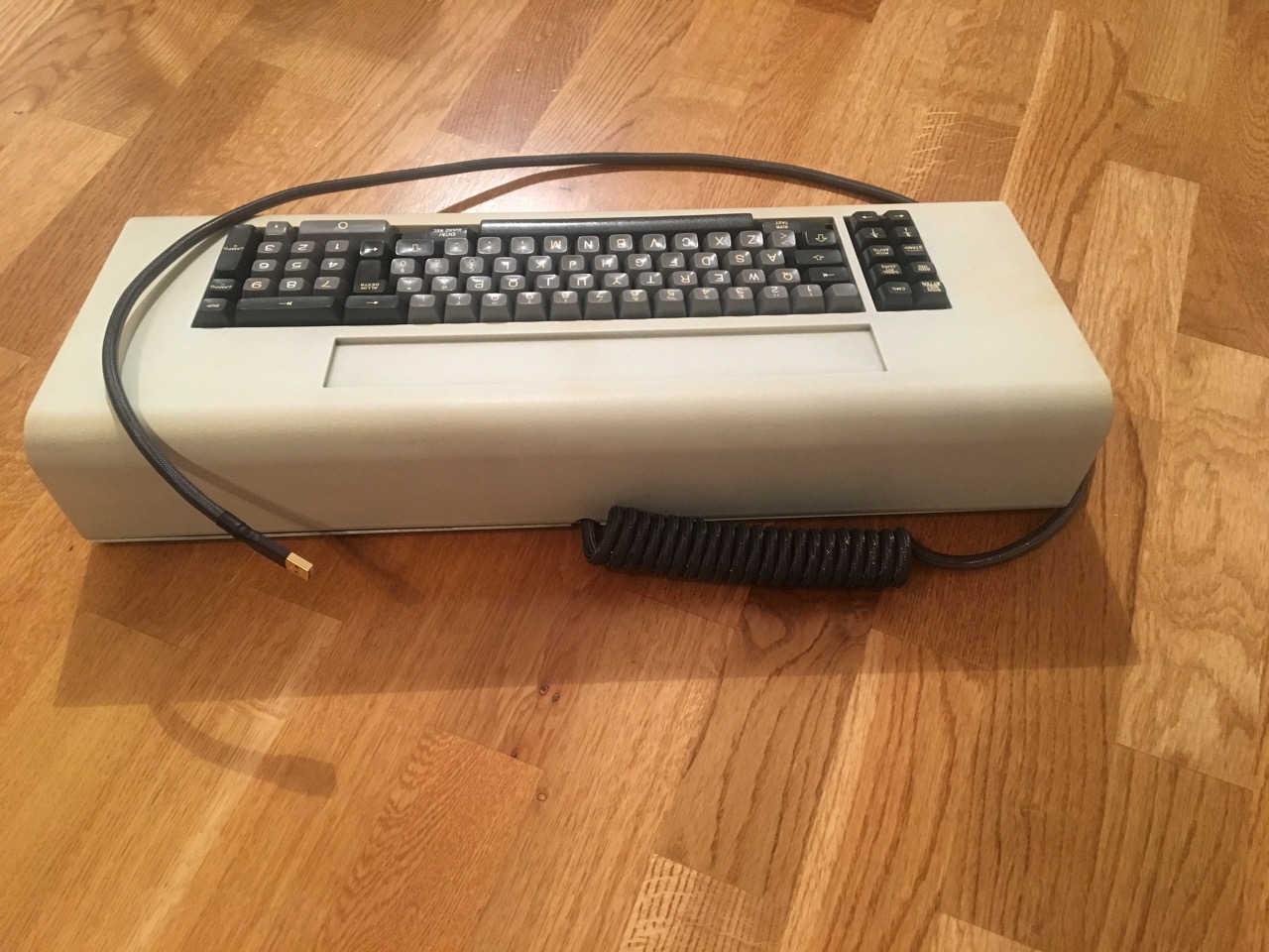

I finally got my USB controller. I finished cleaning everything. The contact pads on the bottom of the switches had a lot more dirt than I expected. I removed some bad parts of the existing foam. I will have to replace the foam later since I haven't had a chance to order it to a friend in a country where Amazon ships. It doesn't seem to cause any issues. I replaced the old flat head screws on the bottom case, I was missing one of them anyway.
It takes a bit of time to program all of the keys. On the solenoid, I found 35 and 60 ms to work better than the 40 and 80 ms the manual recommends. The solenoid is also much louder with the case on than with it off.
