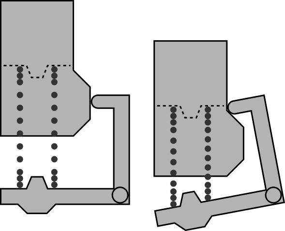

BTW, I'd say that Acer switches are actually more mechanical than buckling spring. It's not a hammer mechanism: the slider has a cam, and the actuator has a follower arm. As the slider is depressed, the cam position changes, and spring acting on the actuator rotates the actuator until it's pressing on the membrane. This process is fairly gentle, meaning that without the click leaf, the switch is only very faintly tactile, although the tactility is inconsistent between keys.
Rough drawing; dimensions and shapes not accurate
Acer switch.png (32.43 KiB) Viewed 2230 times
If anything could be classed as "mechanical", the Acer switch definitely would be.
