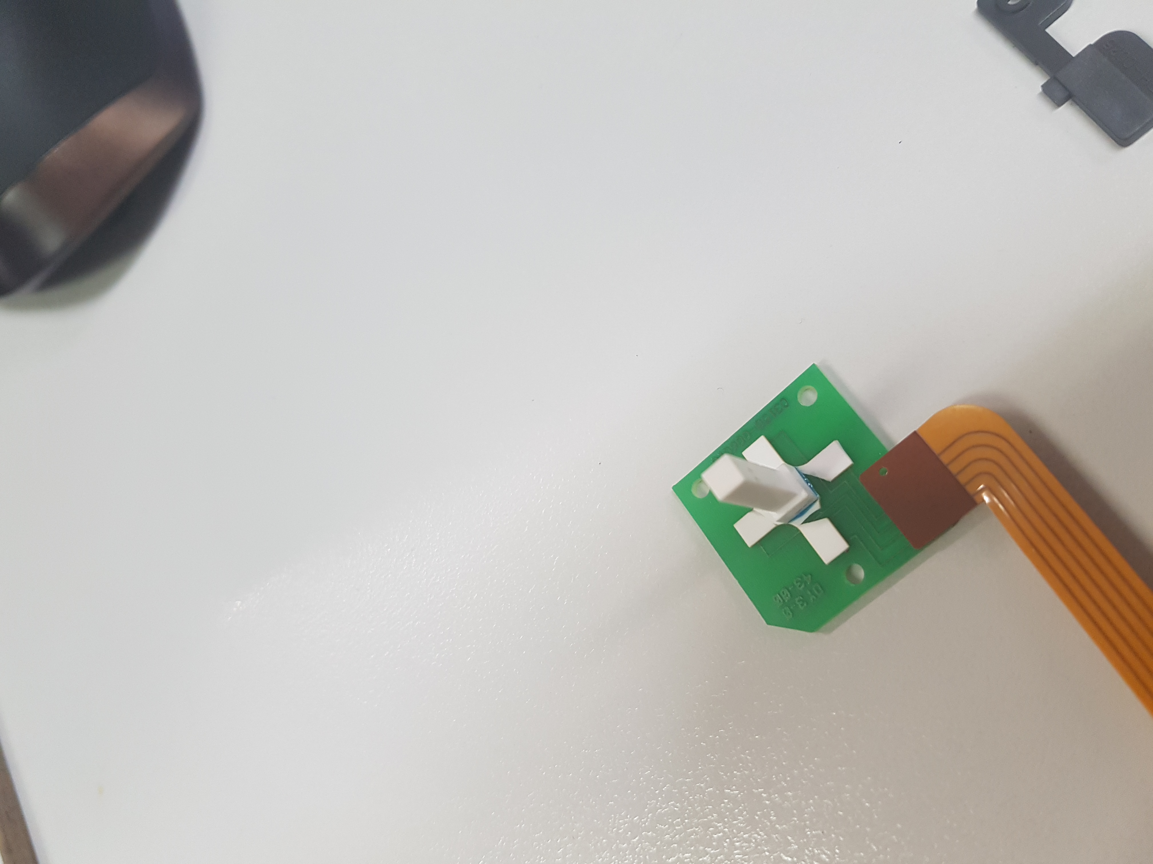

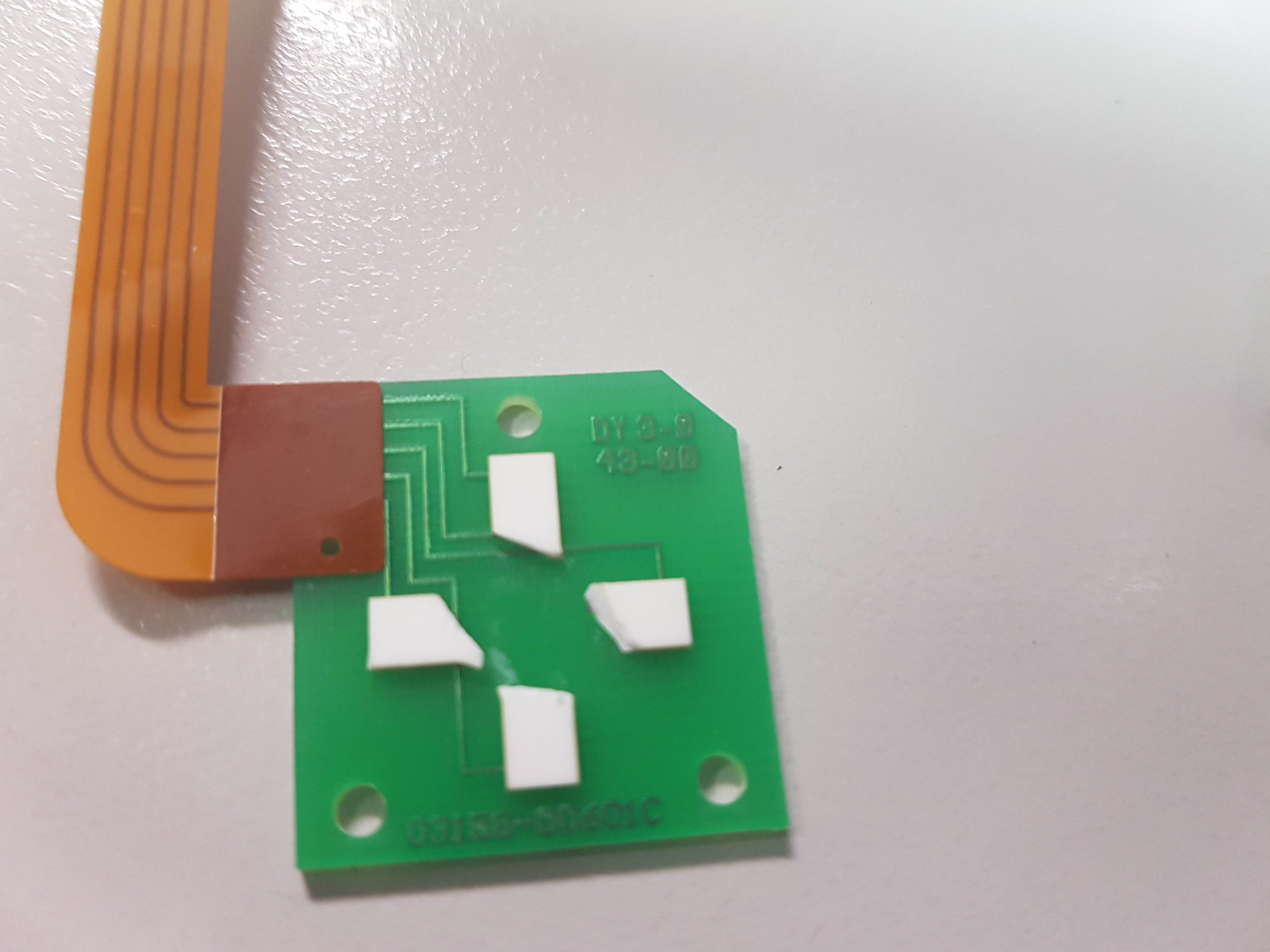

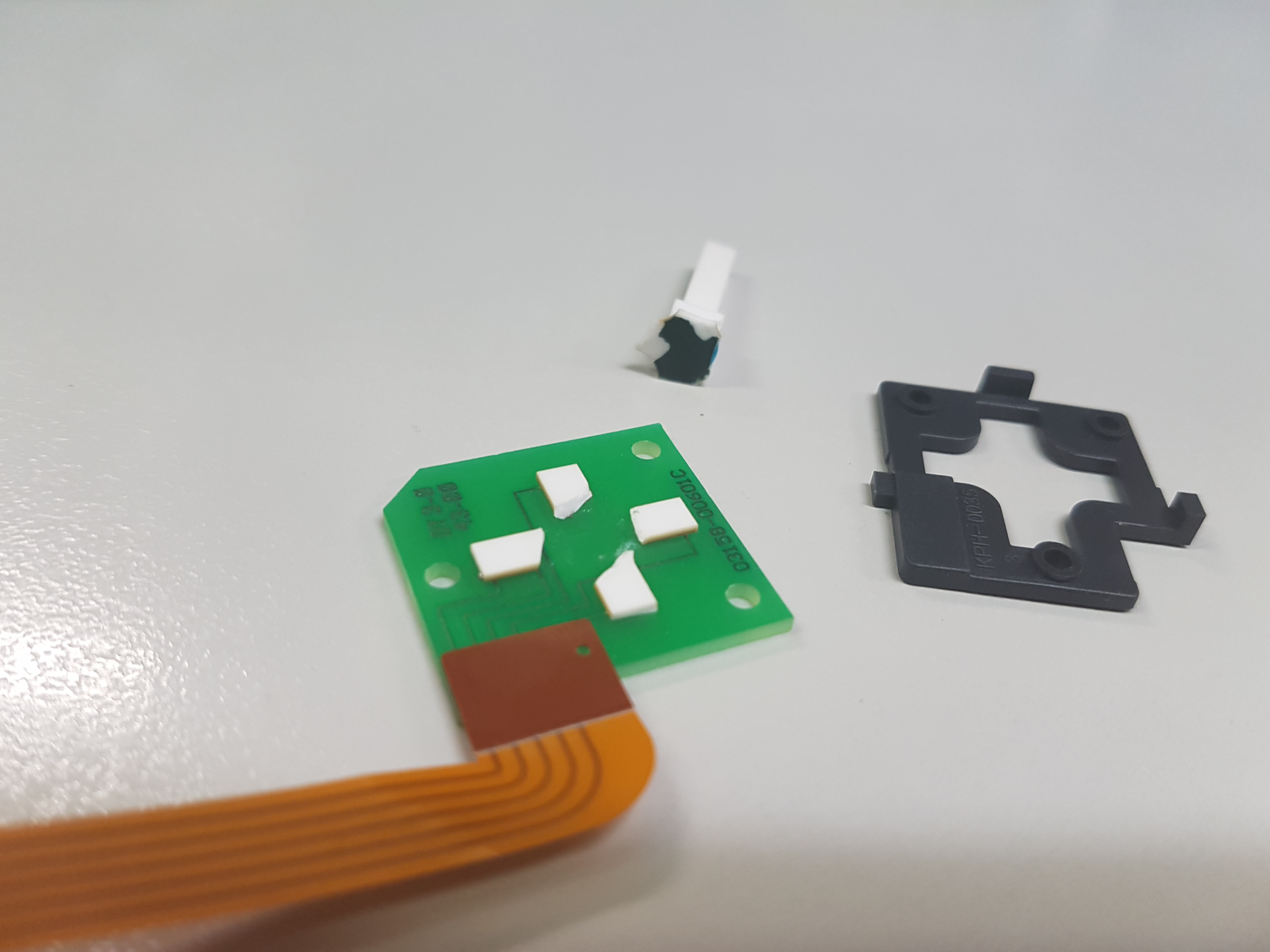

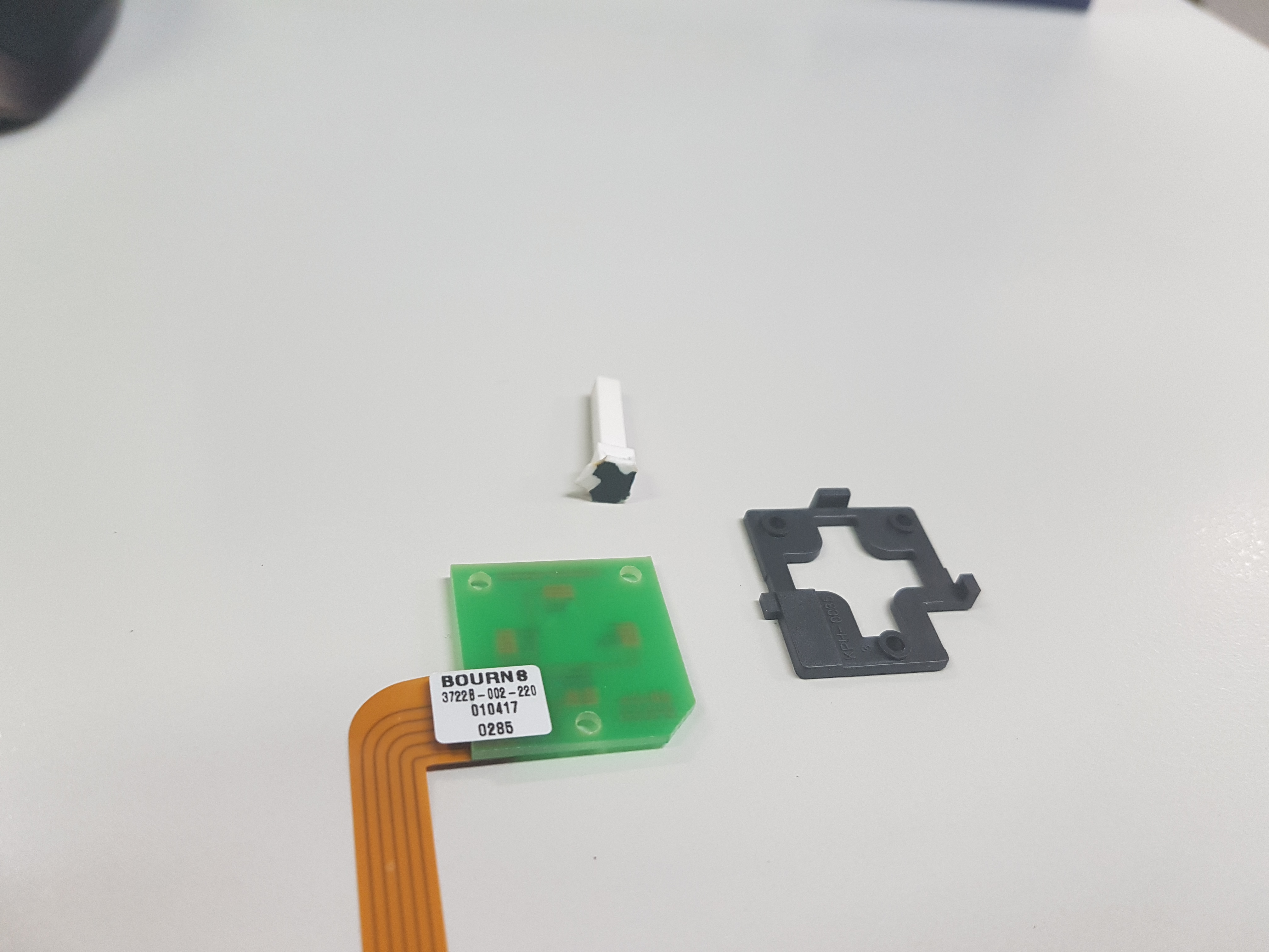

Trackpoint stem on my beloved KPH0035 IBM USB spacesaver keyboard which I'm primarily uses for work is broken :( it is a BOURNS 3722B based trackpoint module - see attachments below
I'm wondering if this is repairable or I actually have to replace the entire module?
Not quite sure where I can even find spare part for this
Thanks in advance
kousuke
25 May 2017, 02:54
I'm thinking of using epoxy putty for the repair - it looks like abs plastic - I don't understand how does the sensors circuitry works - kindna worried that gluing the pieces back would not actually reconnect the circuit?

If it is ABS it could be solvent welded back together. The solvent glue for doing such a repair can be found in just about any home improvement center. I'm not familiar with your component though and am uncertain about any measure of success you would have. replacement might be a better option as it looks like there is a conductive surface applied to the bottom
How did you manage to break it?

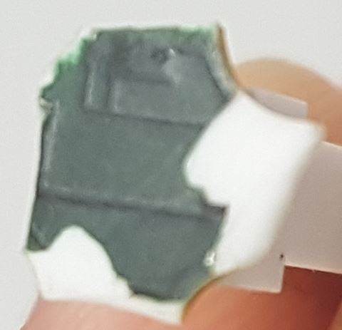

Damn.. looks like gluing it back together is not going to fix it :shock:
There are wire traces underneath it and they have torn off...
trackpoint wiretrace.jpg (27.6 KiB) Viewed 4838 times
What a shockingly stupid design...

A quick search resulted in an article explaining the tech behind your part. It is made of a ceramic material not ABS so scratch my previous recommendation. below is a link to the article which includes contact info for the manufacturer. They may be able to provide a replacement or send you to a vendor who can. ;)
kousuke
25 May 2017, 03:25
thanks I did find that link - it dates back to 1998 and the part is no longer in production - I have contacted BOURNS for spare part - I doubt they still have it in inventory
