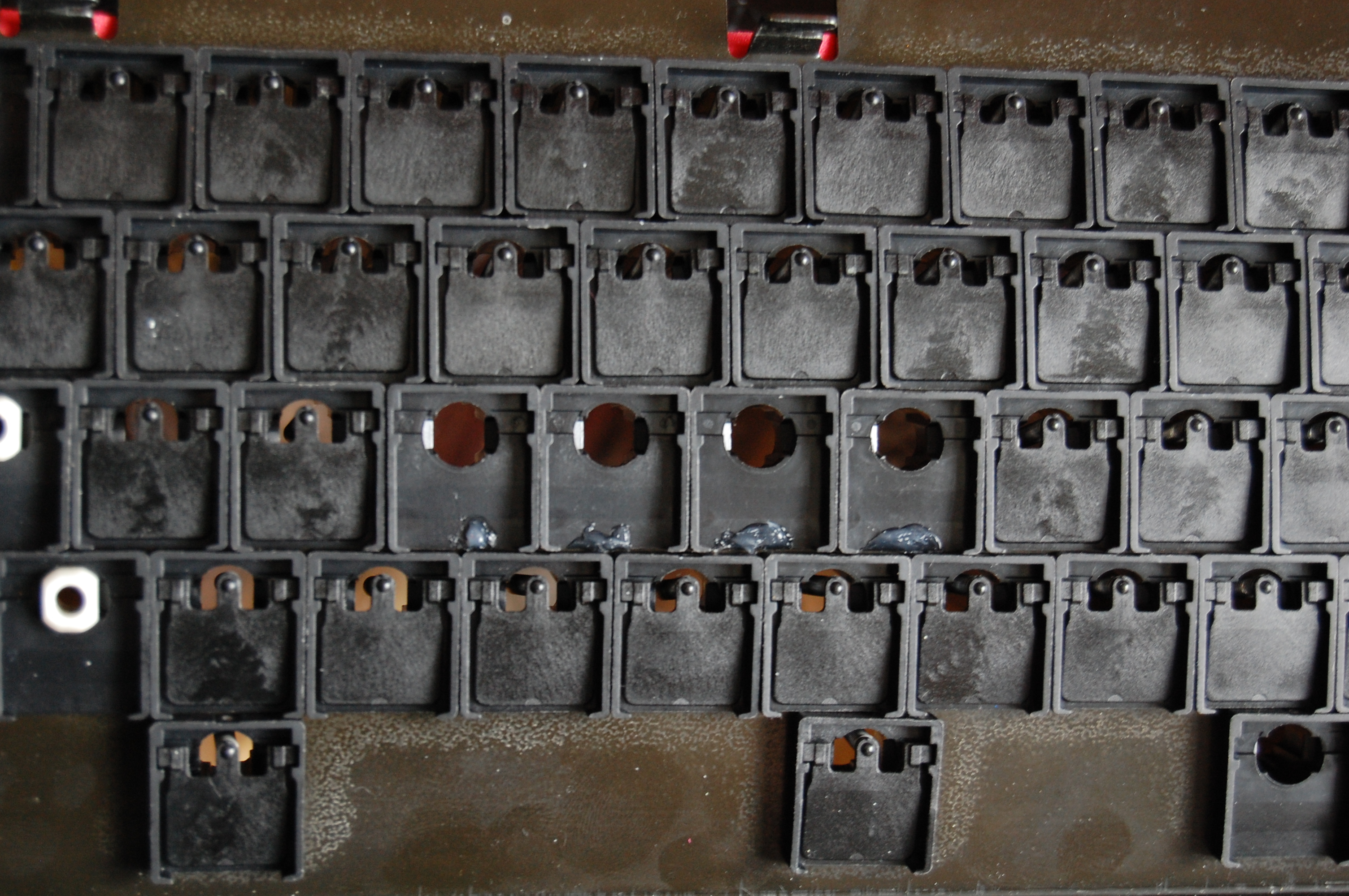

I had a bit of silicone sealant, so I put a very small, 1-2mm diameter drop of it onto the far end of the barrel - between that "7" stamp and the edge.
Surprisingly, this made rebound practically silent.
SHOCK VIDEO
Don't know how long the sealant will hold before it starts crumbling or just peels off the barrel plastic. In video it looks like only the TWANG is missing - but actually it's much quieter, may be a bit louder than rubber dome keyboard I have. Comparable to the beamspring.
Click on keypress is also a bit quieter - because the paddle has less to travel now. Tactile feedback is mostly there. But the rebound is ALMOST SILENT!

Disclosure - I wasn't too careful with consistency and the effect was about the same, not much difference. May be even really tiny drops will work.
I don't know why I didn't make a photo of actual barrels, and I'm too lazy to disassemble everything just for the photo :(
My biggest fear is that the bead unsticks from the barrel in a week of active use and jams the key, actually. Or will disintegrate into dust. Barrels themselves won't suffer.

It does something! I don't know what, exactly. May be it just reduces the contact area and metal (well, metal probably won't - ABS) ball will work just as well.

DMA wrote: I had a bit of silicone sealant, so I put a very small, 1-2mm diameter drop of it onto the far end of the barrel - between that "7" stamp and the edge.
What are you using as a background in your photo?
DMA
13 May 2017, 01:49
rsbseb wrote: What are you using as a background in your photo?
Ask Ellipse, it's his photo, I pulled it from The Internet. But, if my eyes serve me well, that's your standard styrofoam packing block.

And I searched for a while on the picture for some hint where you put the sealant :?
DMA
13 May 2017, 08:29
Madhias wrote: And I searched for a while on the picture for some hint where you put the sealant :?

Because it's time to test macros, had to reassemble keyboard in "all keys" configuration. Snapped a photo!
As you can see, the bead can be pretty large or pretty small - the effect is about the same :)
