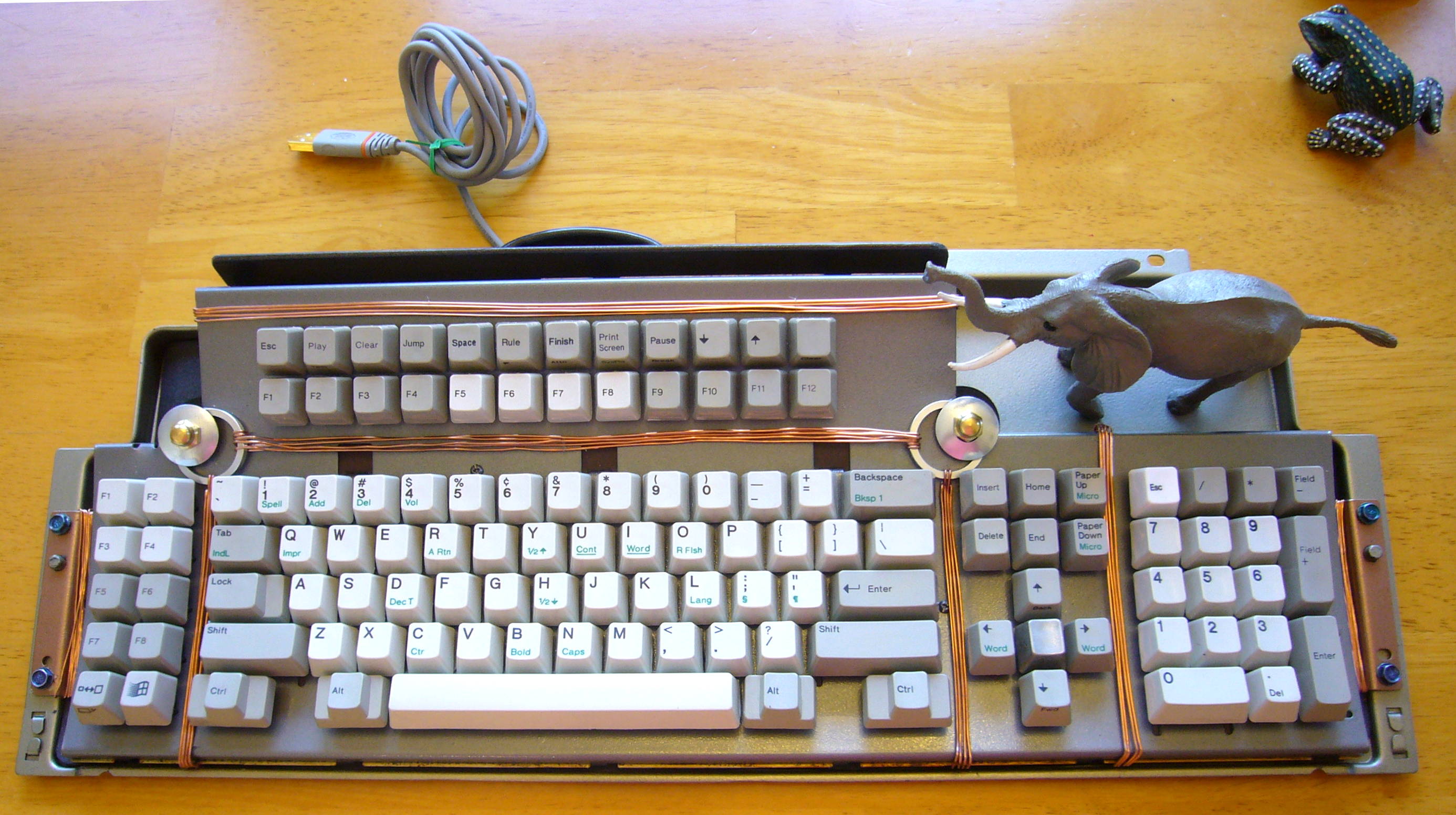

07 May 2017, 15:09
Daniel Beardsmore wrote:
you've actually added visual clutter
When people just look at their minimalistic keyboard setup, perhaps they would imagine they have a cluster-free futuristic home like this.

Seems like personal preference, just like RGB key lighting and underlighting. Some people get their keyboards for something other than utility, and those non-essential functions might make it more appealing when in pictures, on their desktop, or when on display.
08 May 2017, 23:00
chuckdee wrote: Seems like personal preference, just like RGB key lighting and underlighting. Some people get their keyboards for something other than utility, and those non-essential functions might make it more appealing when in pictures, on their desktop, or when on display.
Right, I can't really picture it with any of my keyboards but fohat's example is a good one. He's even got decoration.
