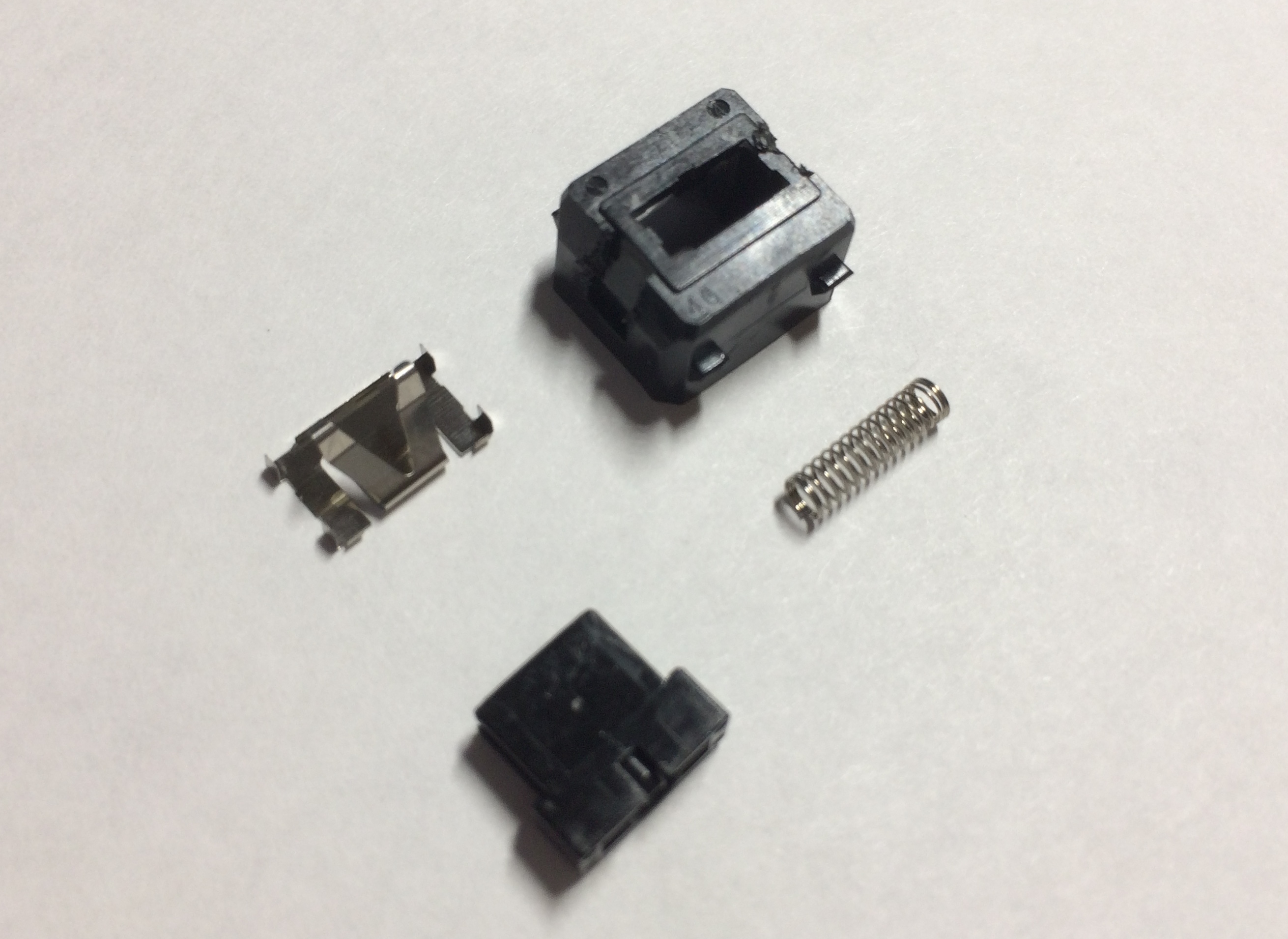

Mine looks like this:
Orange Alps > BKE dome Topre > 45g Topre > Matias QC = 62g Zealio > Brown Alps > MX Brown > Black Alps > MX Clear > Alps Common Mount Low Profile > Cherry ML
29 Apr 2017, 09:31
My favourite is orange Alps, which are nothing like black Alps.

29 Apr 2017, 14:07
dokyun wrote: Mine looks like this:
(Emphasis mine)
Are you saying that these have an unintentionally tactile feel, or have you actually found the tactile version of these?

dokyun
29 Apr 2017, 18:22
(Emphasis mine)
The ones I have absolutely have a pronounced tactile bump.
*looks at the wiki again*
Well, what do ya' know?
29 Apr 2017, 19:12
Curious — I see that they're described as "tactile" on the Acer 6083 page, but the page about the switch doesn't give any details.
It seems to be the same approach as SKFR/SKFS (click leaf with nothing behind it for it to hit), but the slider colours are reversed.
So now it must be a pair of series, possibly SKFN/SKFO or SKFM/SKFN.

29 Apr 2017, 22:14
dokyun wrote: The ones I have absolutely have a pronounced tactile bump.
And here's the patent for it:
https://www.google.com/patents/US5004880
The patent describes it as a "click-type" switch, so is there a clicky version of this too? SKFS has an empty space behind the click leaf to prevent any sound (creating tactility only) but the patent drawing shows a clicky design. I've never seen inside the tactile version of this switch to see whether it takes measures to prevent sound.
dokyun
30 Apr 2017, 19:32
I need to get some better pictures of the innards - I had been planning to fully document the numpad it came in for the Wiki but that's fallen a bit by the wayside recently.
