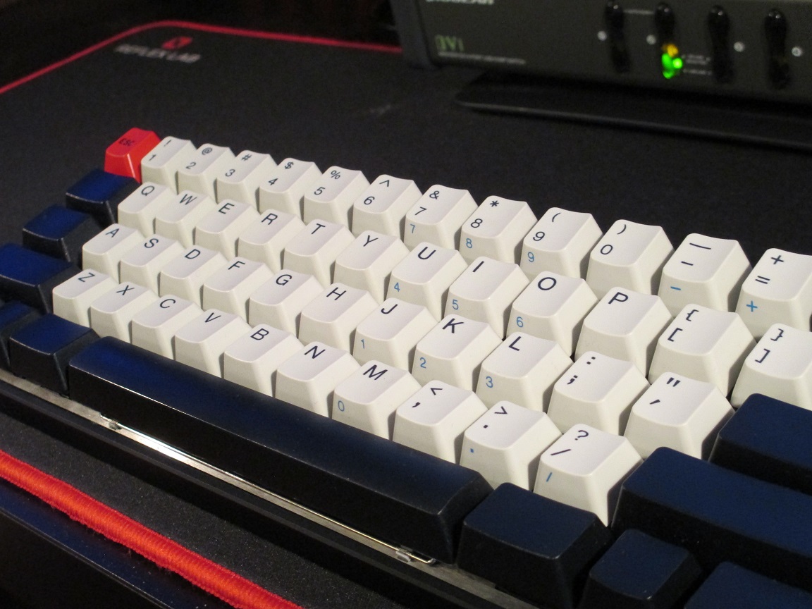

During the past few weeks, I have been typing almost exclusively on my custom Alps64 60%, and I am starting to think that I might be approaching endgame.
Specifications:
Alps64 PCB
HHKB Layout
Stainless Steel Plate, AEK Cut
Hybrid SKCM Brown / Blue Switches
IBM 5140 Dye-sublimated PBT Alphanumeric Keycaps
Matias Black Black Mods and Spacebar
SP Red Esc
TEX CNC Black Aluminum Case

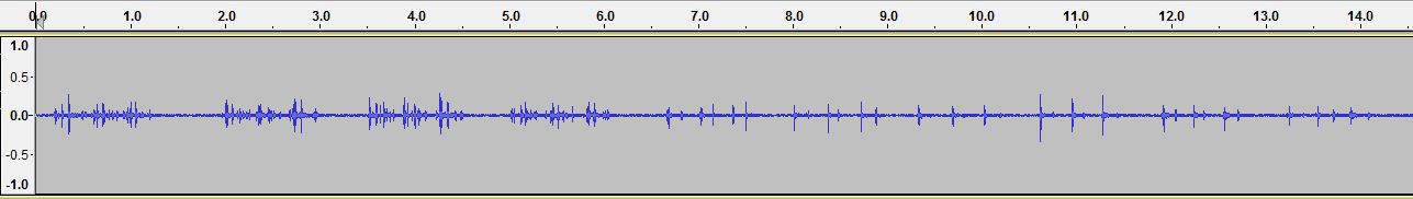

See below for a brief video with an audio clip. The typing is:
098098098
poipoipoi
lkjlkjlkj
,n,mn,mn
Backspace (Backslash) x 3
Backslash (Backspace) x 3
Enter x3
Right Shift x 3
Right Control (Fn) x 3
Spacebar x 3

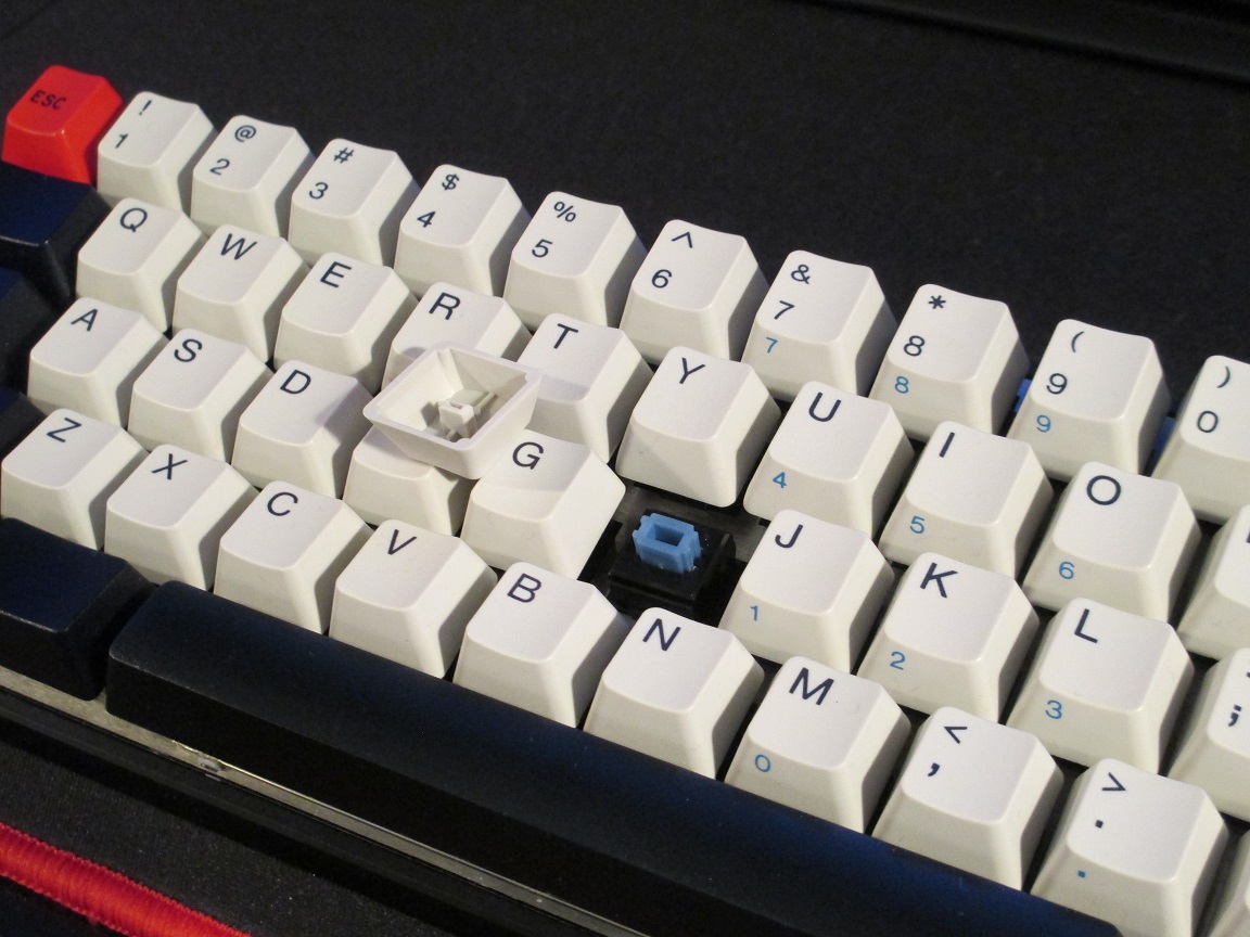

What do you mean by hybrid blue/brown alps? Brown alps spring + blue alps everything else?
Also, did you find that when you moved the blue alps from whatever keeb they came on to your custom that the sound became higher pitched/more metallic? I don't know why, but every typing video with I've watched with blue alps seems like they're quite a bit more bassy in the huge vintage boards compared to when somebody puts em in a 60% or whatever.
Hypersphere
13 Apr 2017, 00:28
The only components from the original brown Alps switches that were in the board is the bottom switch housings (along with the switch plates, and contact leaves). Everything else (tops, sliders, springs, and click leaves) is from blue Alps. Given that brown Alps have the long switch plates, the resultant switches are effectively older-generation blue Alps.
Yes, indeed, the sound of blue Alps in this (and probably most) 60% boards is rather high-pitched and lacking the timbre afforded by a large board with a large hollow case that acts like a soundboard of a musical instrument.
In particular, my 60% has a stainless steel plate and a shallow aluminum case -- together these elements tend to deaden sound leaving only the rather shrill voice of the switches without benefit of a resonating chamber. In fact, the sound initially put me off this board until I started to focus on the feel of the switches.
Apart from the switches, I have a general fondness for the 60% form factor and HHKB layout. So, although I appreciate the sound and feel of my full-size Alps boards (especially Leading Edge, Northgate, and Zenith), I prefer the size and symmetry of the smaller boards.

Thanks for the write up Hypersphere, I did notice in some older threads that you mentioned you were in possession of some of the alps sprit springs, however I saw no mention of them in this "approaching endgame" build. Was there a particular reason you decided to stick with the stock blue alps springs?
Hypersphere
17 Apr 2017, 22:20
tkim wrote: Thanks for the write up Hypersphere, I did notice in some older threads that you mentioned you were in possession of some of the alps sprit springs, however I saw no mention of them in this "approaching endgame" build. Was there a particular reason you decided to stick with the stock blue alps springs?
I completed the present mod before I received the Spirit springs. In addition, the springs from the blue Alps appeared to be in excellent condition, so I saw no compelling reason to wait for new springs. I am also not quite decided on which weight of spring to use for a given project. The choice would be easier with linear switches, but with tactile or tactile/clicky Alps, the tactile/click leaf contributes to the total resistance of the switch.
