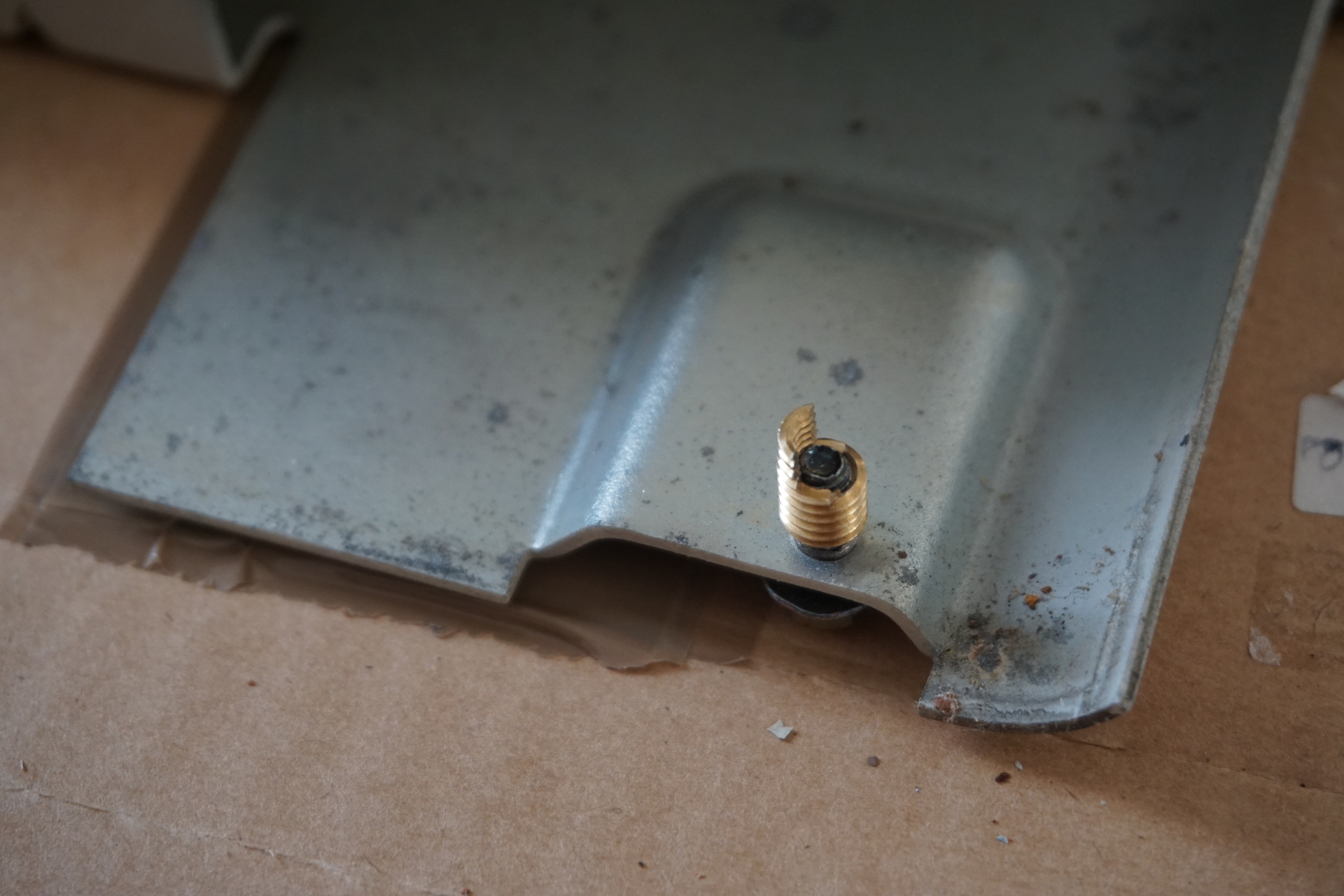

We start by unscrewing the plastic top of the case from the bottom of the case. The screws in the bottom of the case are two-part: On brass(?) ring with threads on the inside and the outside that is screwed into the hole in the top case, and a "normal" screw that is screwed into the brass ring and holds the bottom case. In my case, the screws are pretty rusty, so that the ring will move inside the plastic. When it hits the bottom case, the resistance will markedly increase. At that point you better stop screwing until all 4 screws are lose, or you will damage the threading in the plastic. Guess how I know :(
For one of my screws, the screw came out of the brass ring. When I wanted to put the two parts together again, a piece broke of the brass ring. We are off to a good start ...
broken screw.JPG (527.79 KiB) Viewed 7603 times

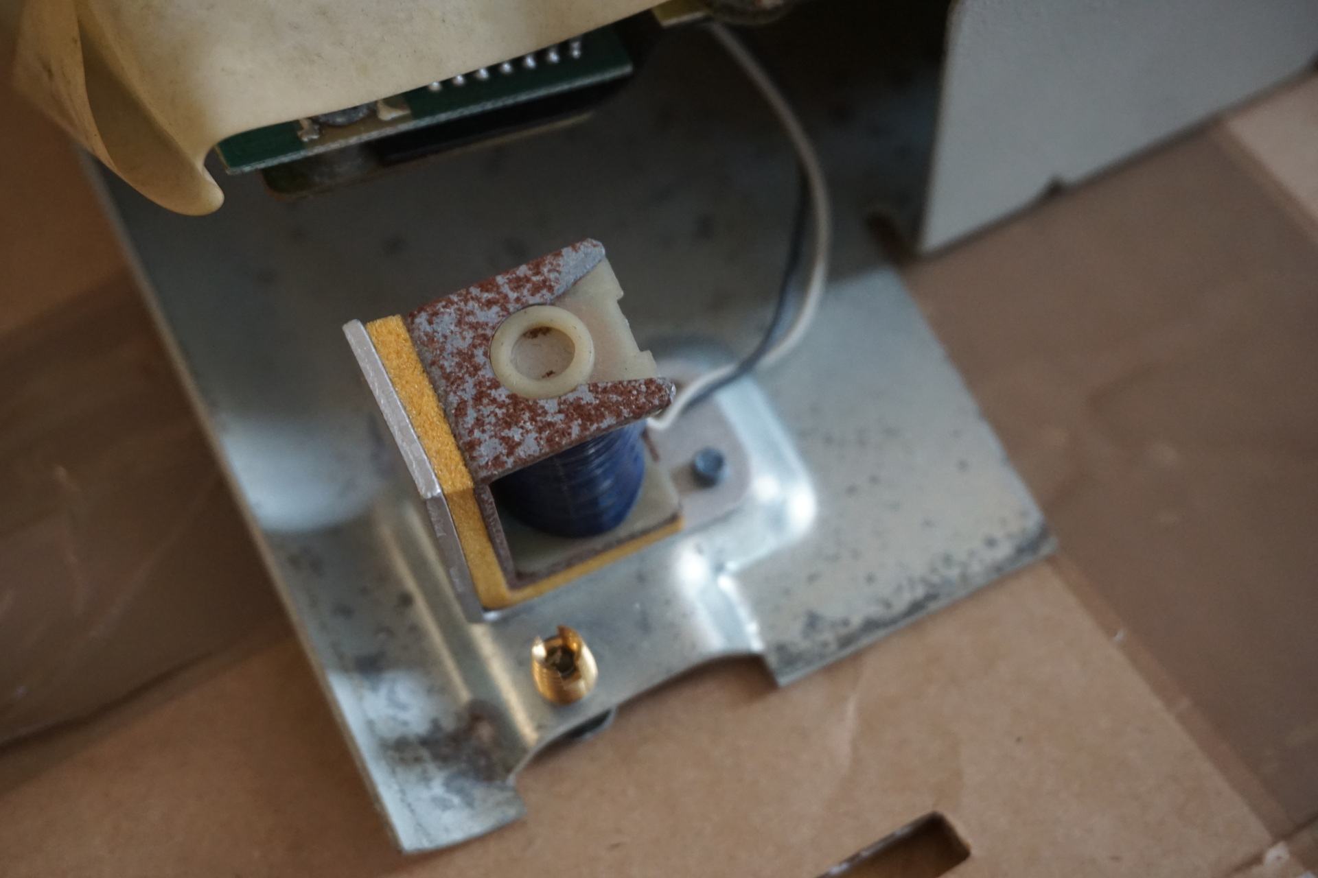

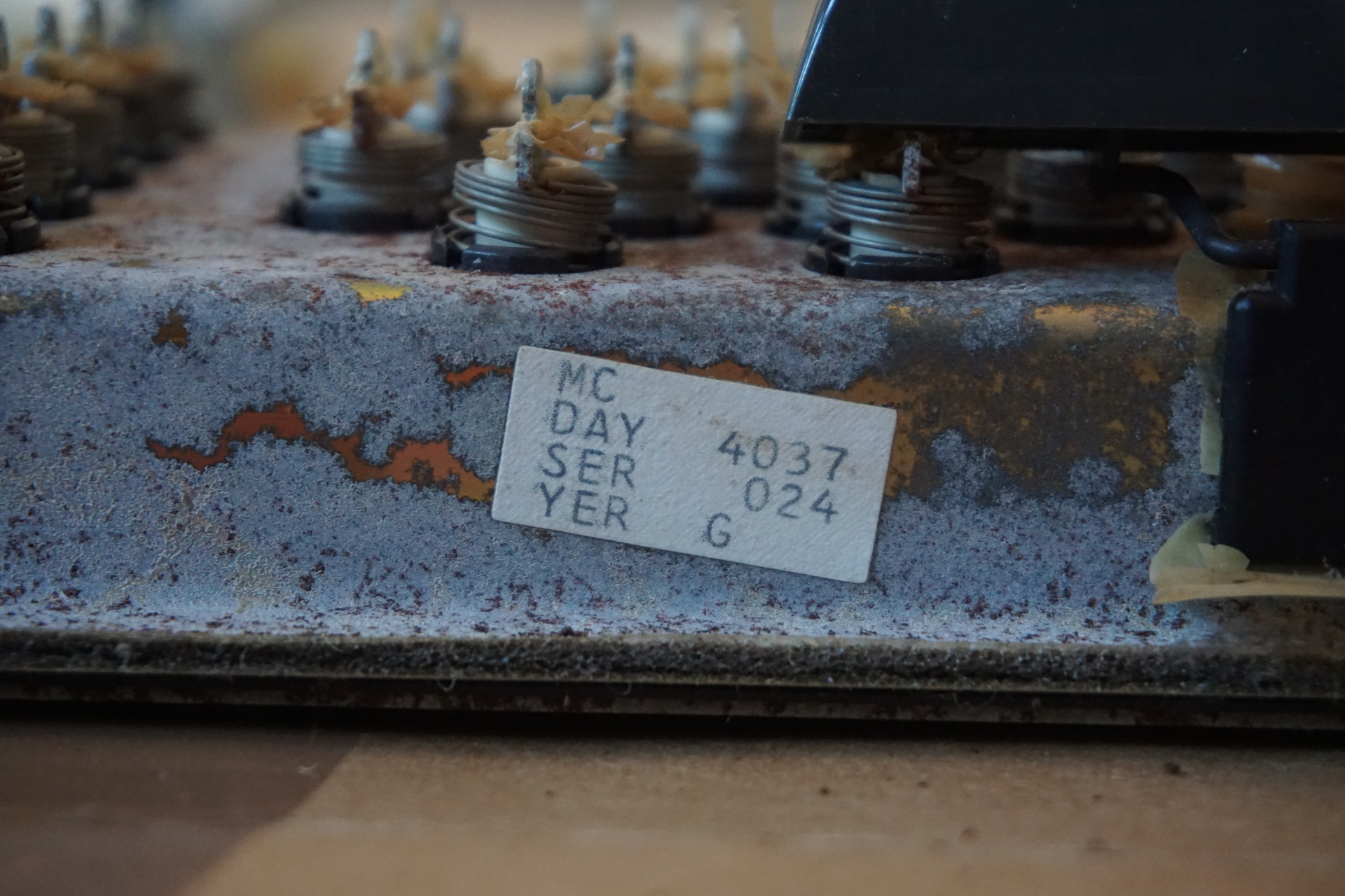

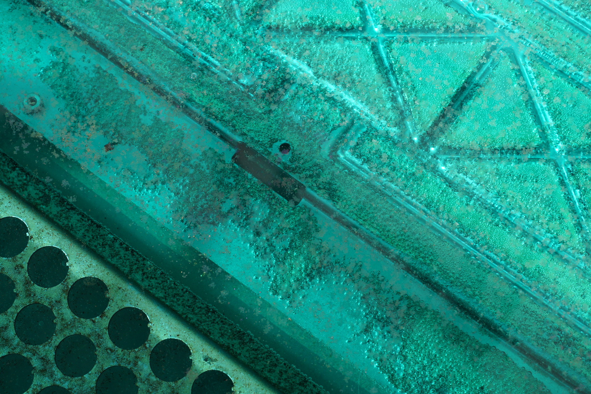

Ok, lets forget this little incident, and move along. The contamination shield is one the most aptly named keyboard parts I met so far. Also we see our first signs of rust on the stems and the solenoid.
contamination shield.JPG (562.63 KiB) Viewed 7603 times

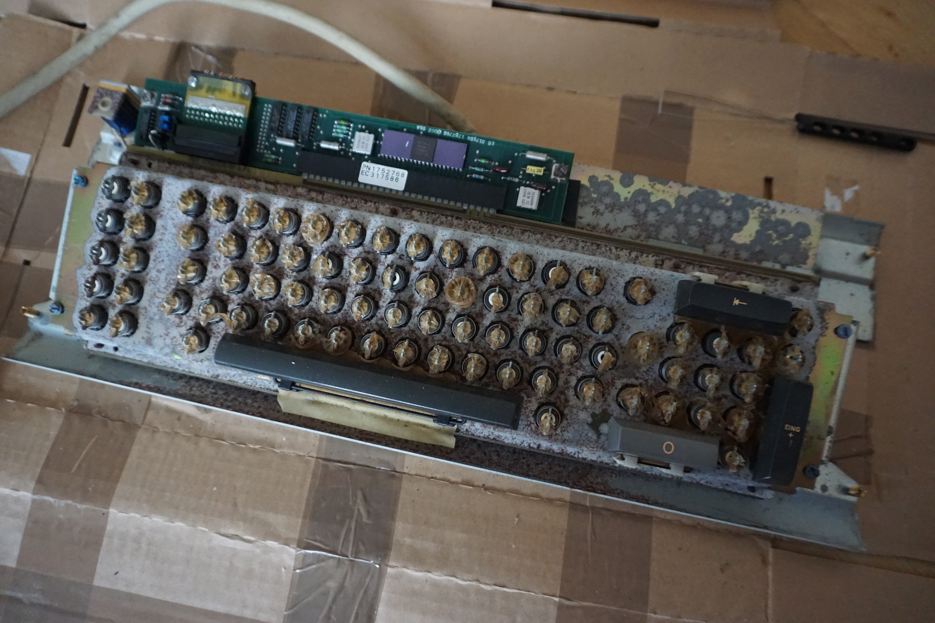

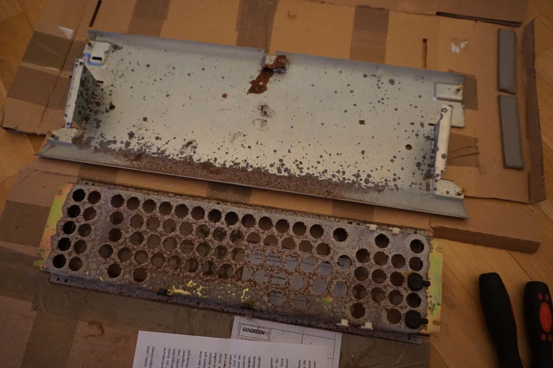

Off with the keycaps and the contamination shield, on with the horror :) Rust, lots of rusty rust. I will need to buy quite some vinegar on Monday it seems.

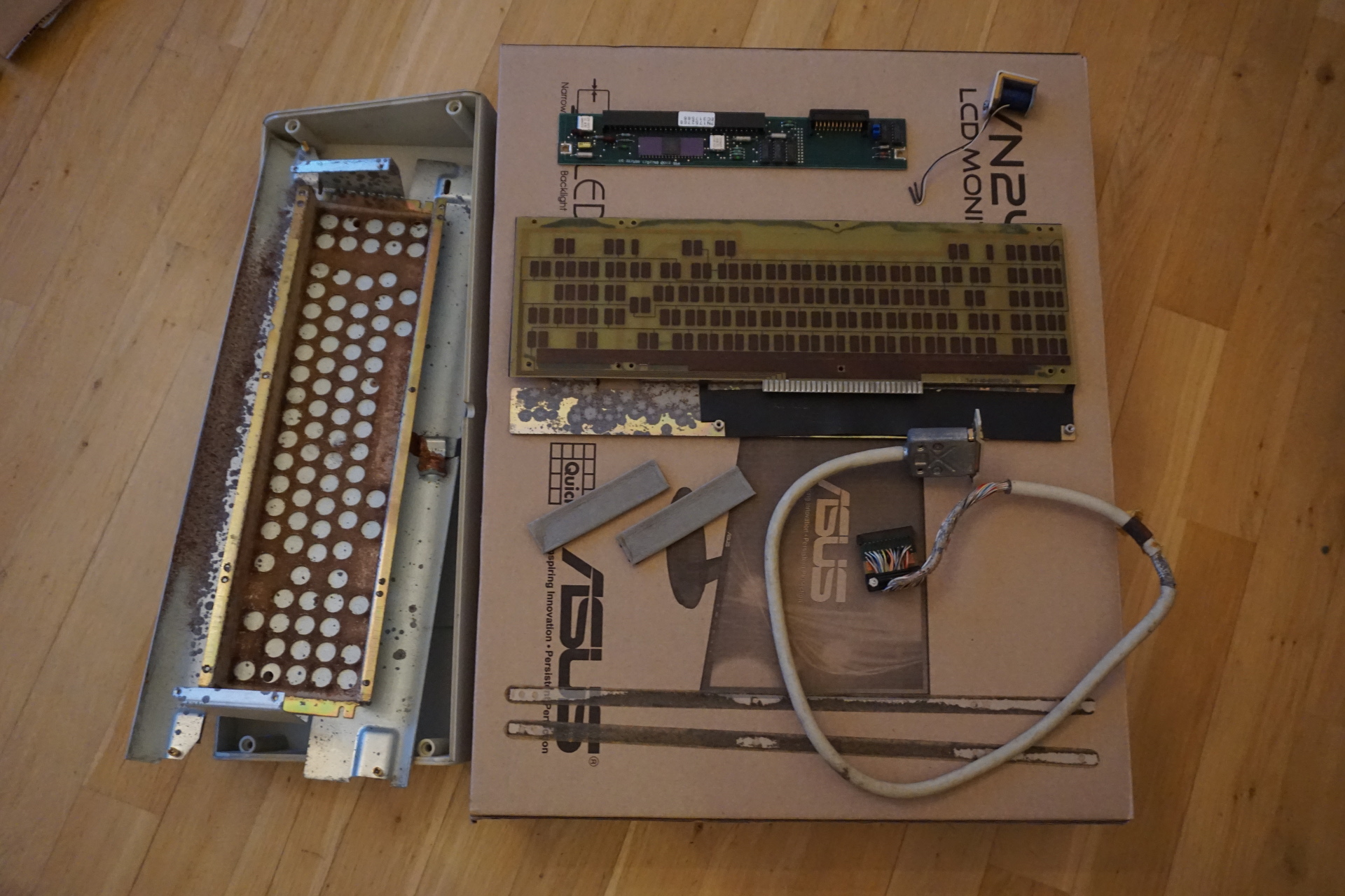

Loosen 4 screws between the switch sandwich and the lower case, unscrew the solenoid and the cable, inspect some more rust ...
Here's a pic that includes the back of the case. That brown stuff where the cable has been? That's rust, who would have guessed.

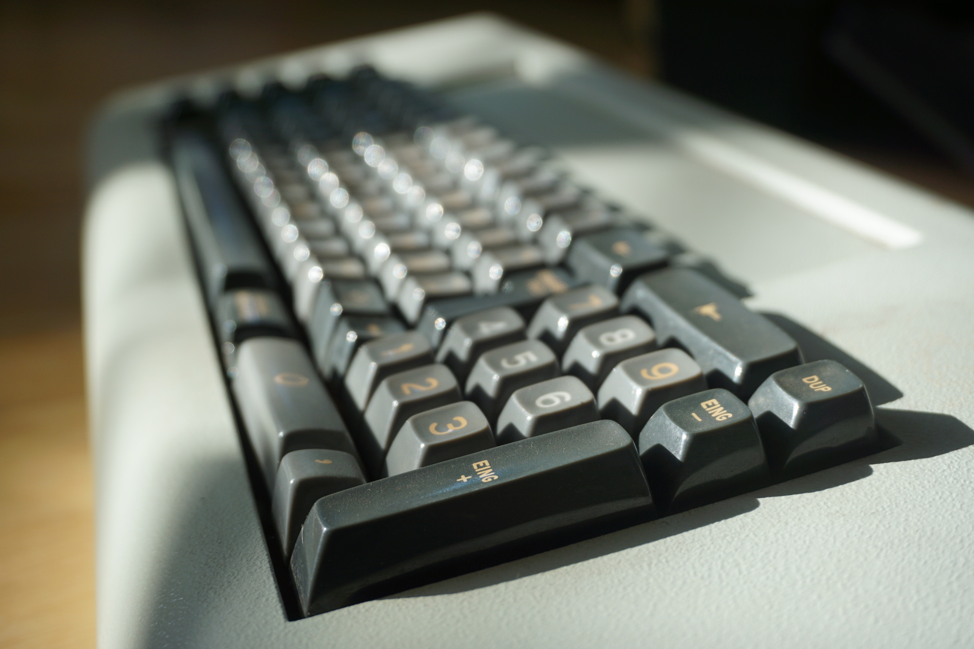

Ok, I got bored with grit pictures at that point. Enough of the expected (rust), here's some bonus pictures of some unexpected things.

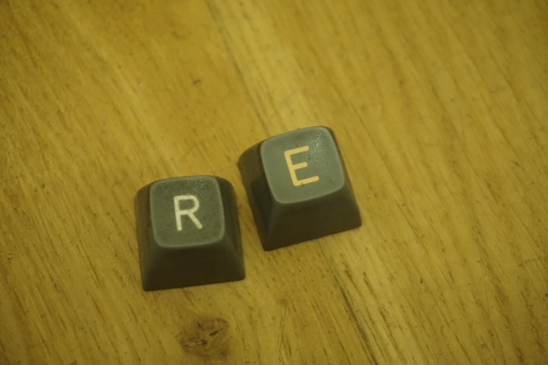

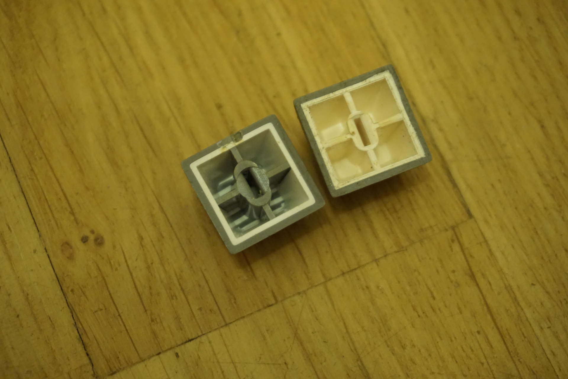

A lot of the 5251 that I have seen so far have mostly very yellowed legends, and then some that are white as snow. I always wondered if these where maybe replacement caps or something. Well today I found out that they are a completly different mold from the yellow ones. Note the stem color and the stripes inside the keycap. Also the yellow ones seem to have another color even inside the keycap. Maybe the color difference is not only due to yellowing. Maybe the caps had different colors even when new.

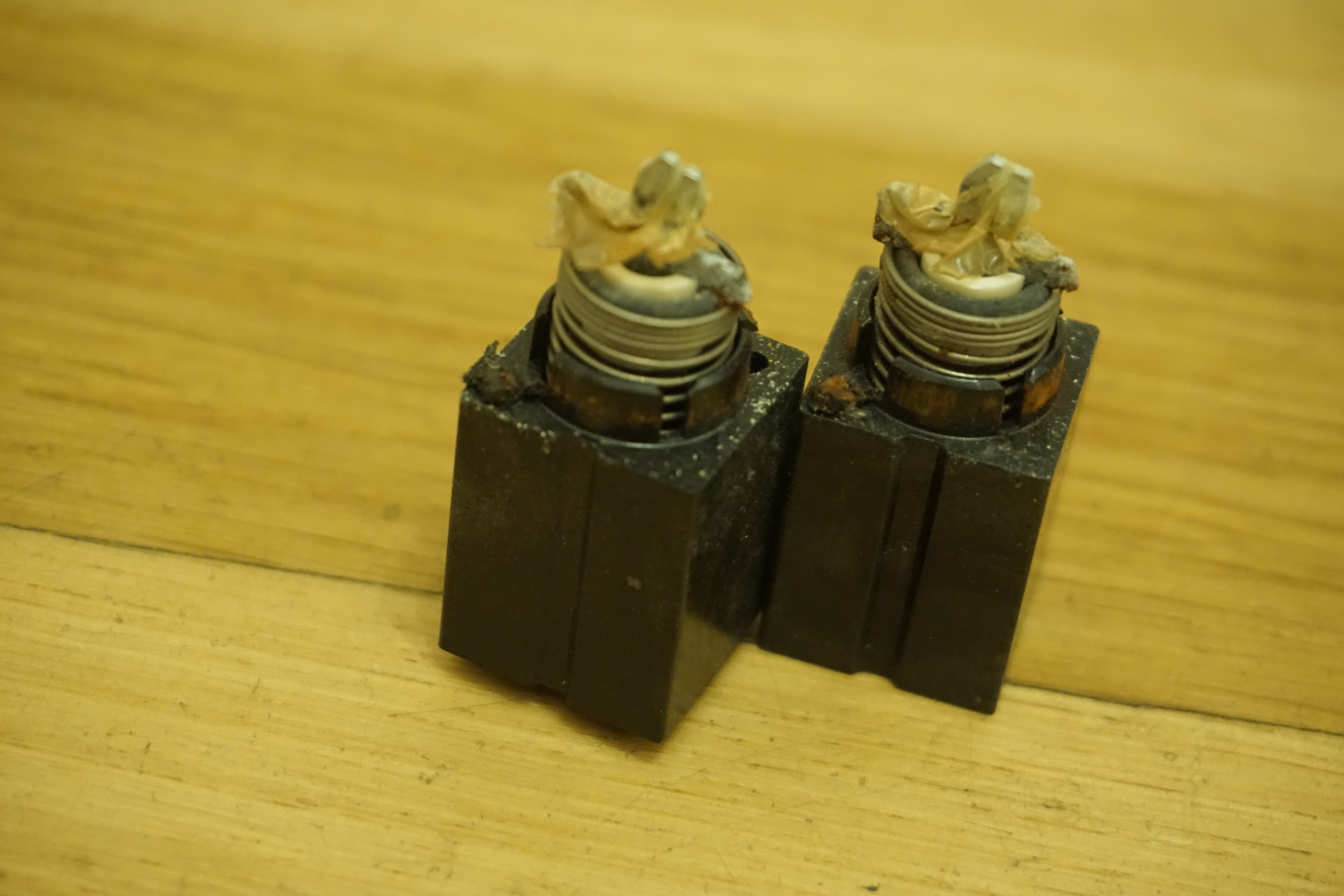

When I removed the switches I found that two had one of the little tabs that hold them in the plate broken. Something is broken and it wasn't me :shock:. I think they got stuck on the foam when the keyboard was assembled. Between this nasty foam and the contamination shield, foam and foil would have been an apt name for these keyboards, don't you think :P

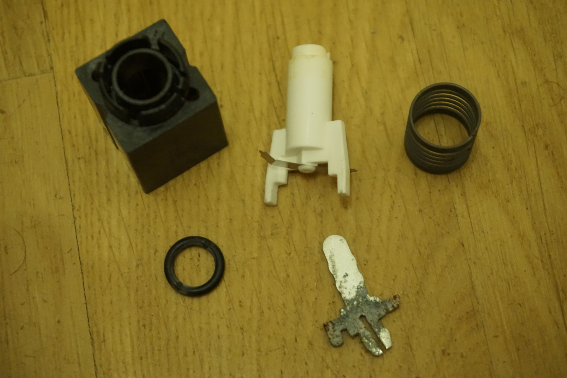

One last thing for your beamspring nightmares: When I got the board, one of the switches wasn't clicking. I used this one to test disassembly of the switches themselves. Gloves help! Turns out that one of the springs on the sliders was bend and almost completely ripped of. Thankfully there is the second space bar switch which I can use as a replacement :)

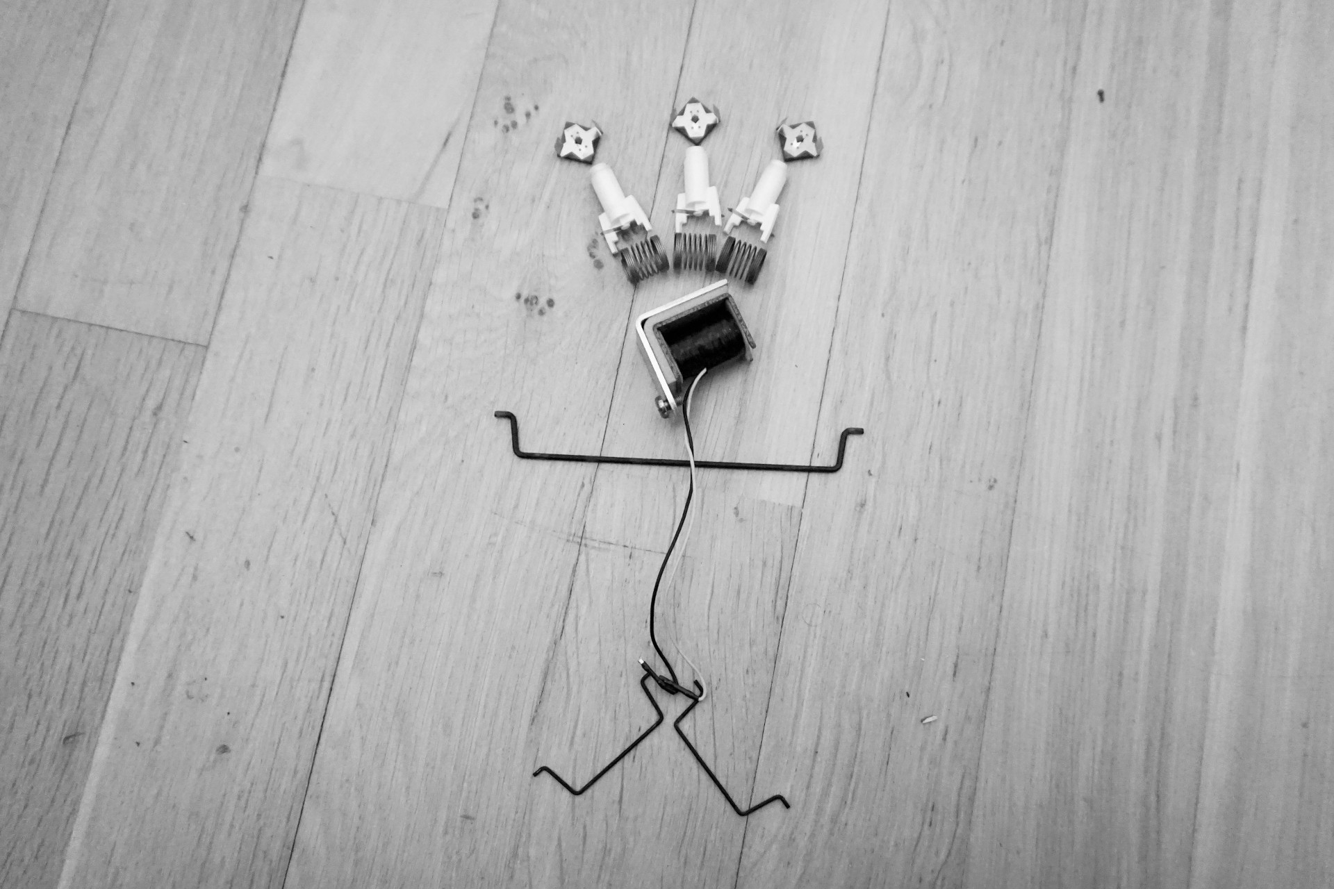

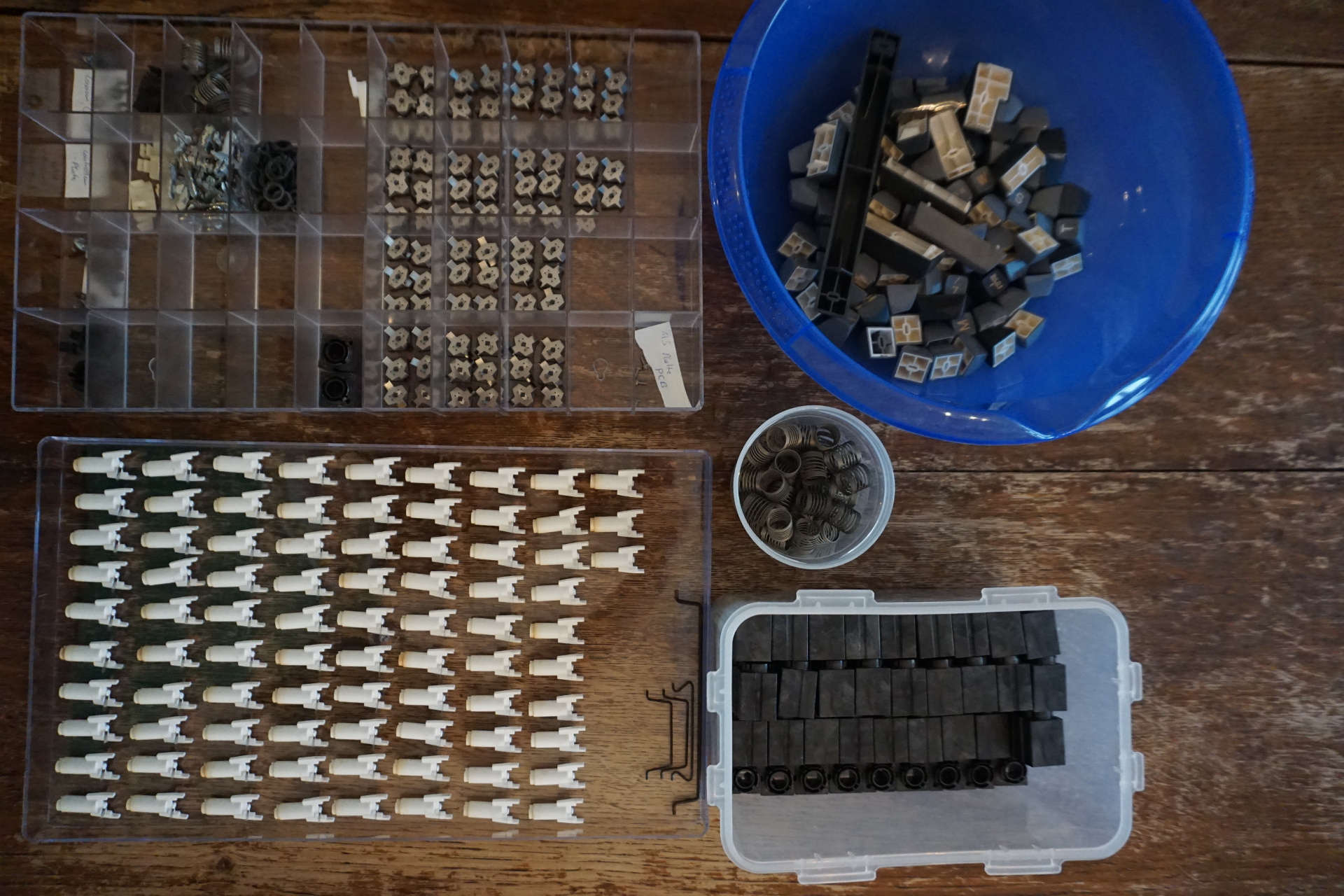

Beamspring part overview:
This foam is no more! He has ceased to be! 'E's expired and gone to meet 'is maker! ... THIS IS AN EX-FOAM!!

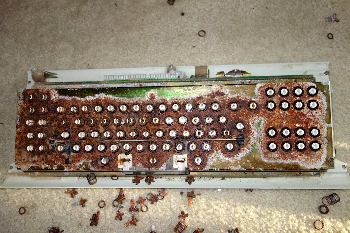

Hey, I want that nastiest beamspring crown!

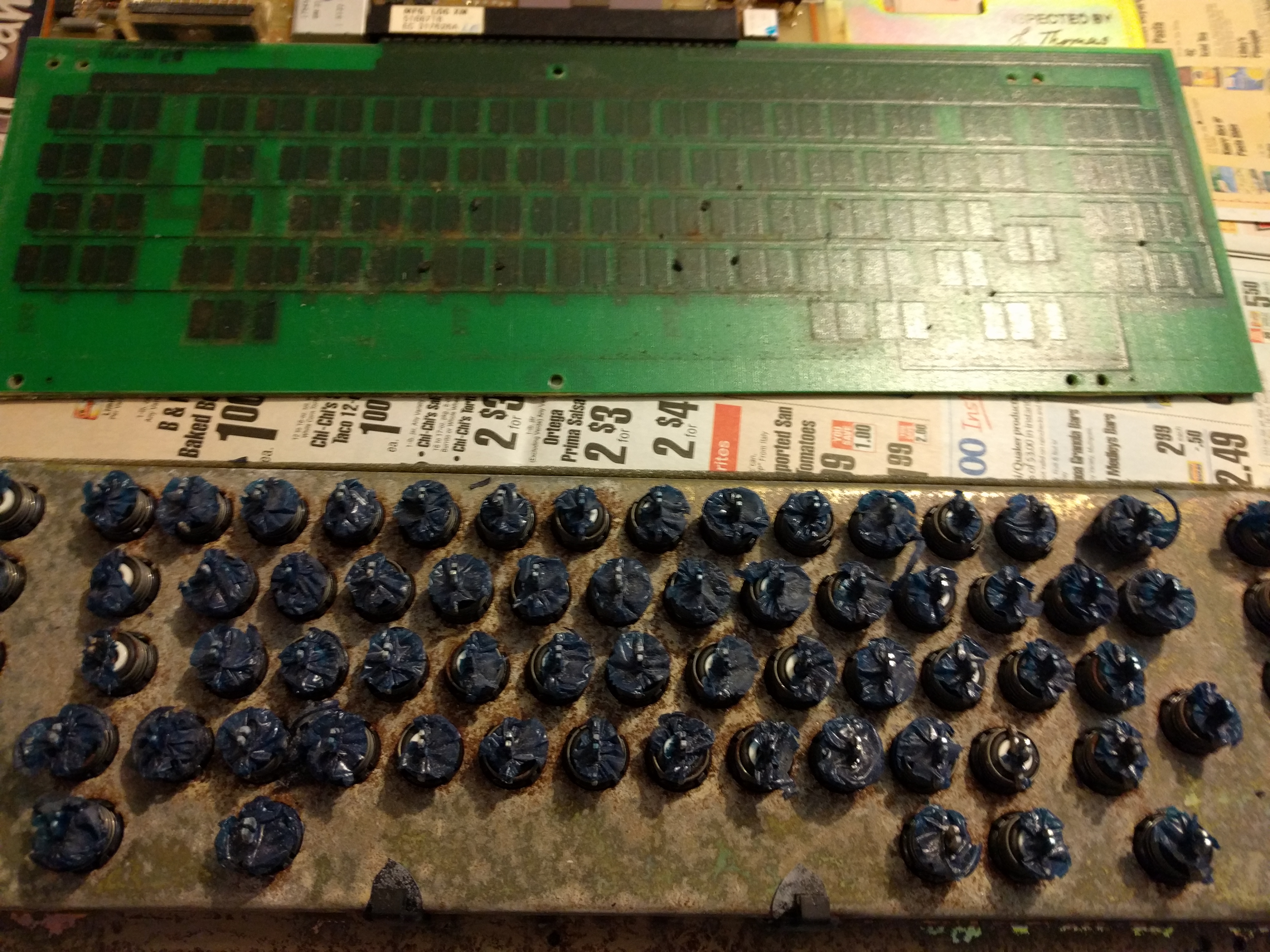

This displaywriter had so much rust that all of the springs were completely rusted through, making it unrestorable without replacement springs which I haven't been able to find a close enough substitute for to actually use :/

orihalcon wrote: Hey, I want that nastiest beamspring crown!
Would it be possible to commission replacements ?
Everything else looks fixable
even the stems of the switch , a good soak in oxalic acid
This displaywriter had so much rust that all of the springs were completely rusted through, making it unrestorable without replacement springs which I haven't been able to find a close enough substitute for to actually use :/]
That looks hardcore indeed.
Oh boy :o
Normally I find living and moving things way more nasty than "just" mechanical rust, but this is a very serious claim indeed.
Maybe Ellipse or the MF team can help. They have worked with spring manufacturers, haven't they?

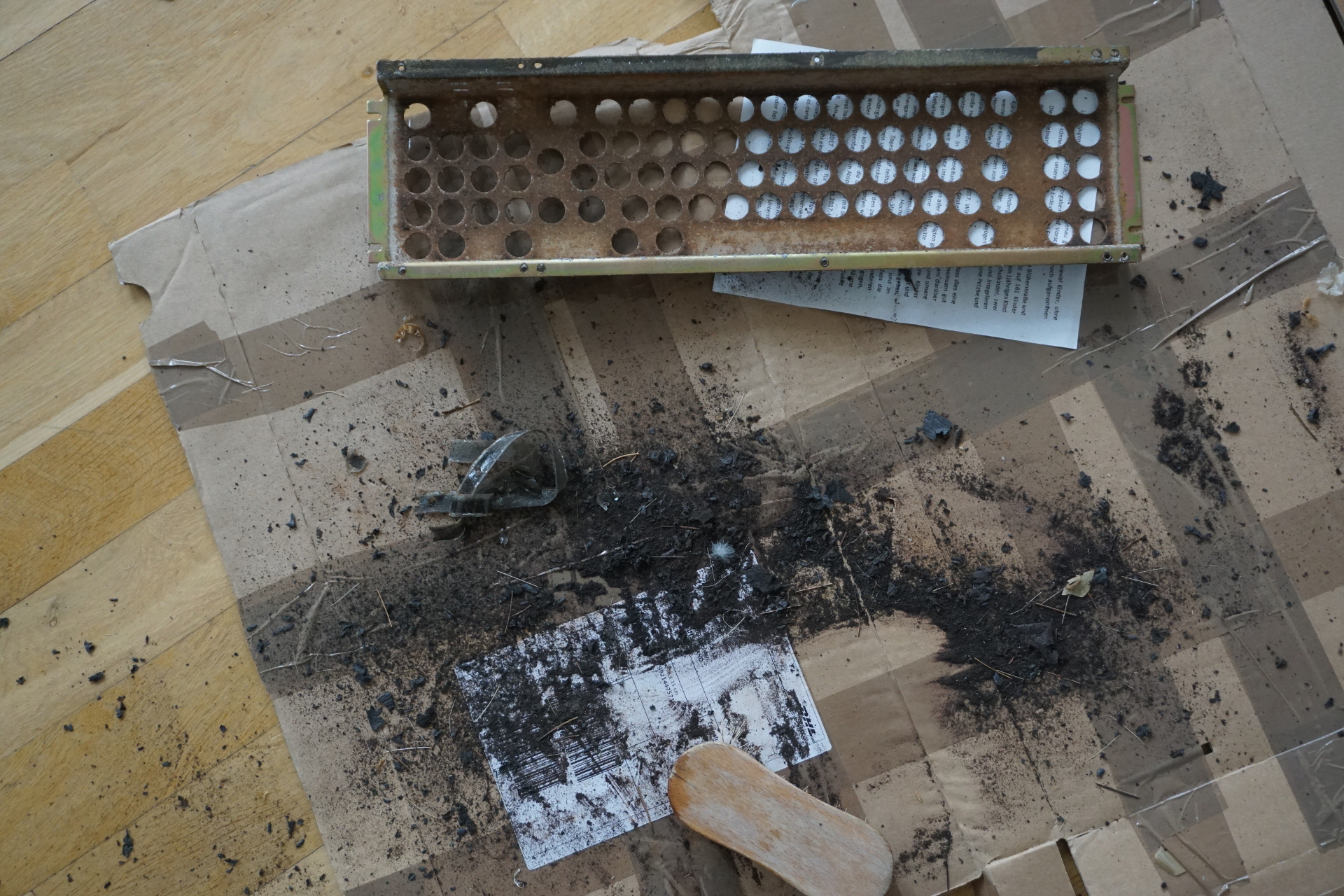

Dug through the archives to find a pic of the dirty switch plate of my beamer

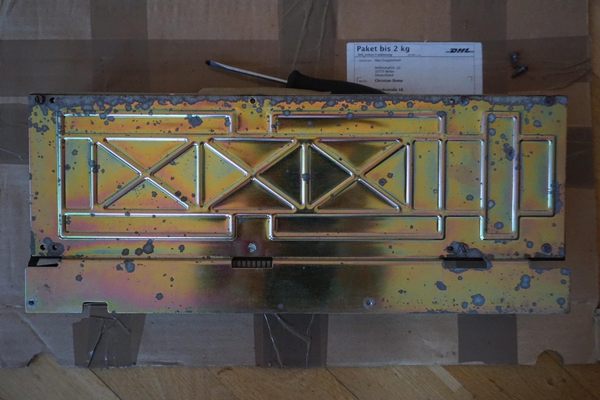

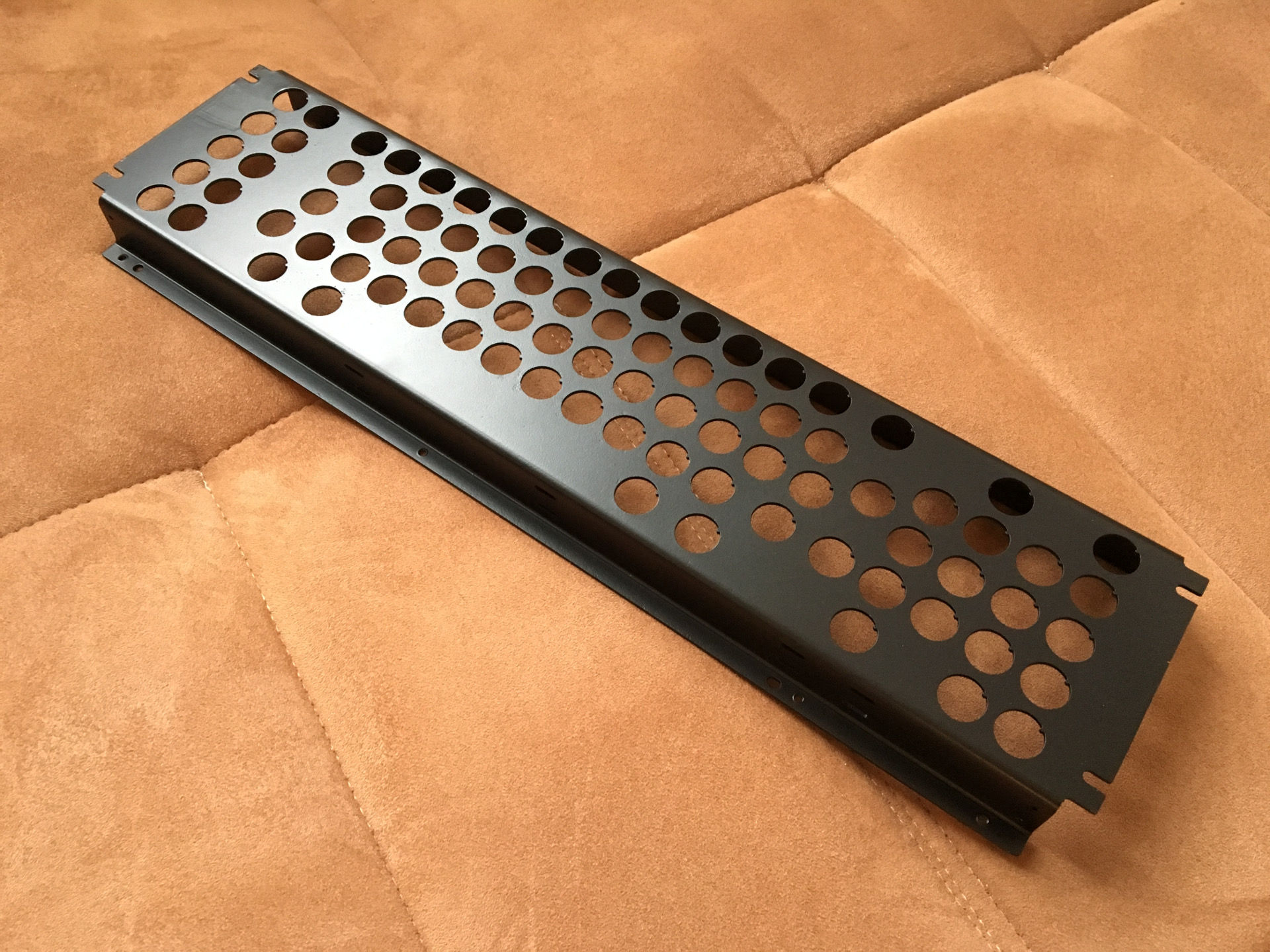

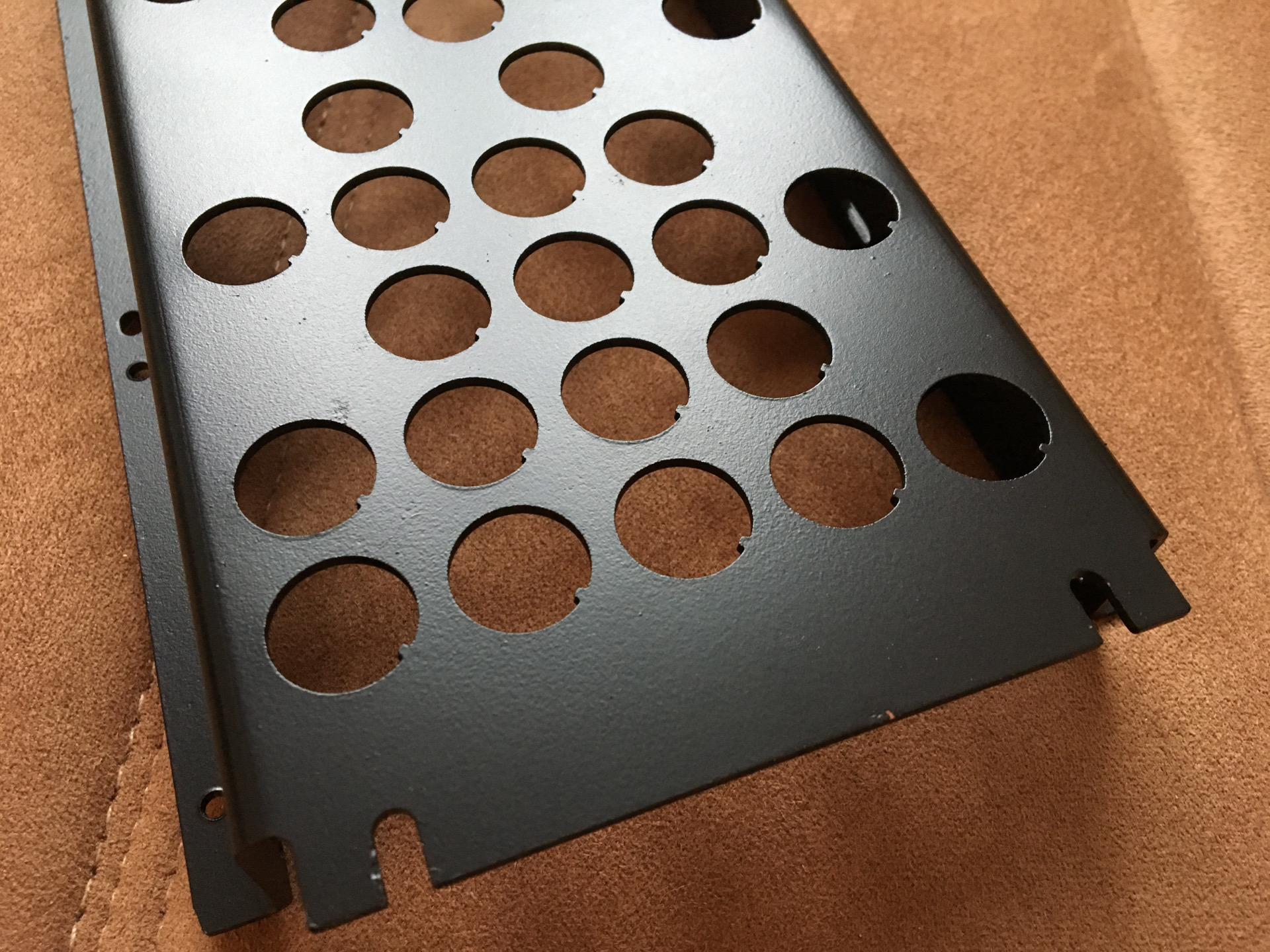

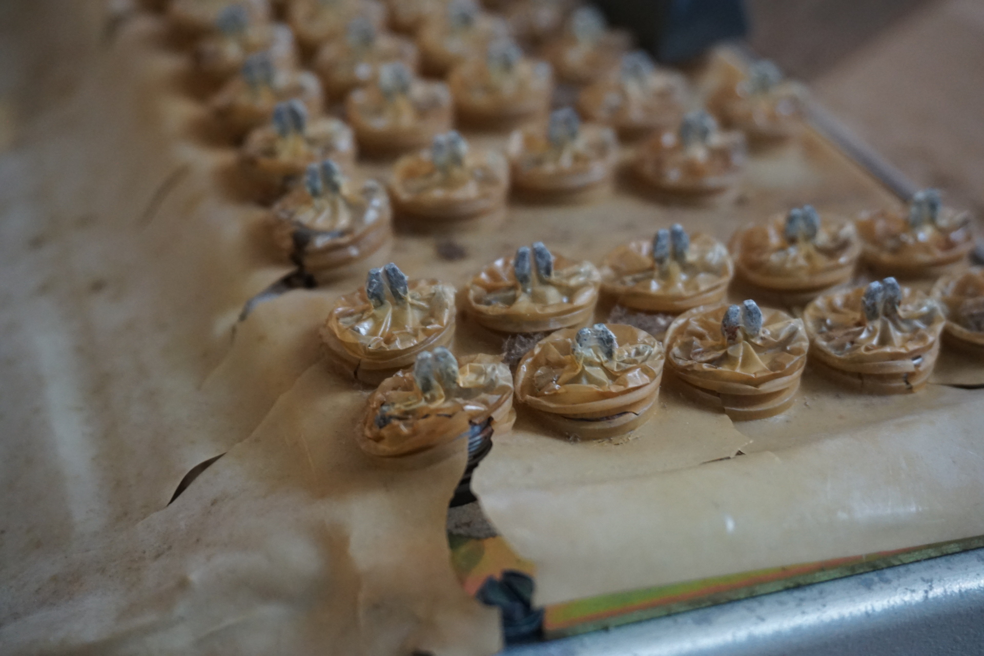

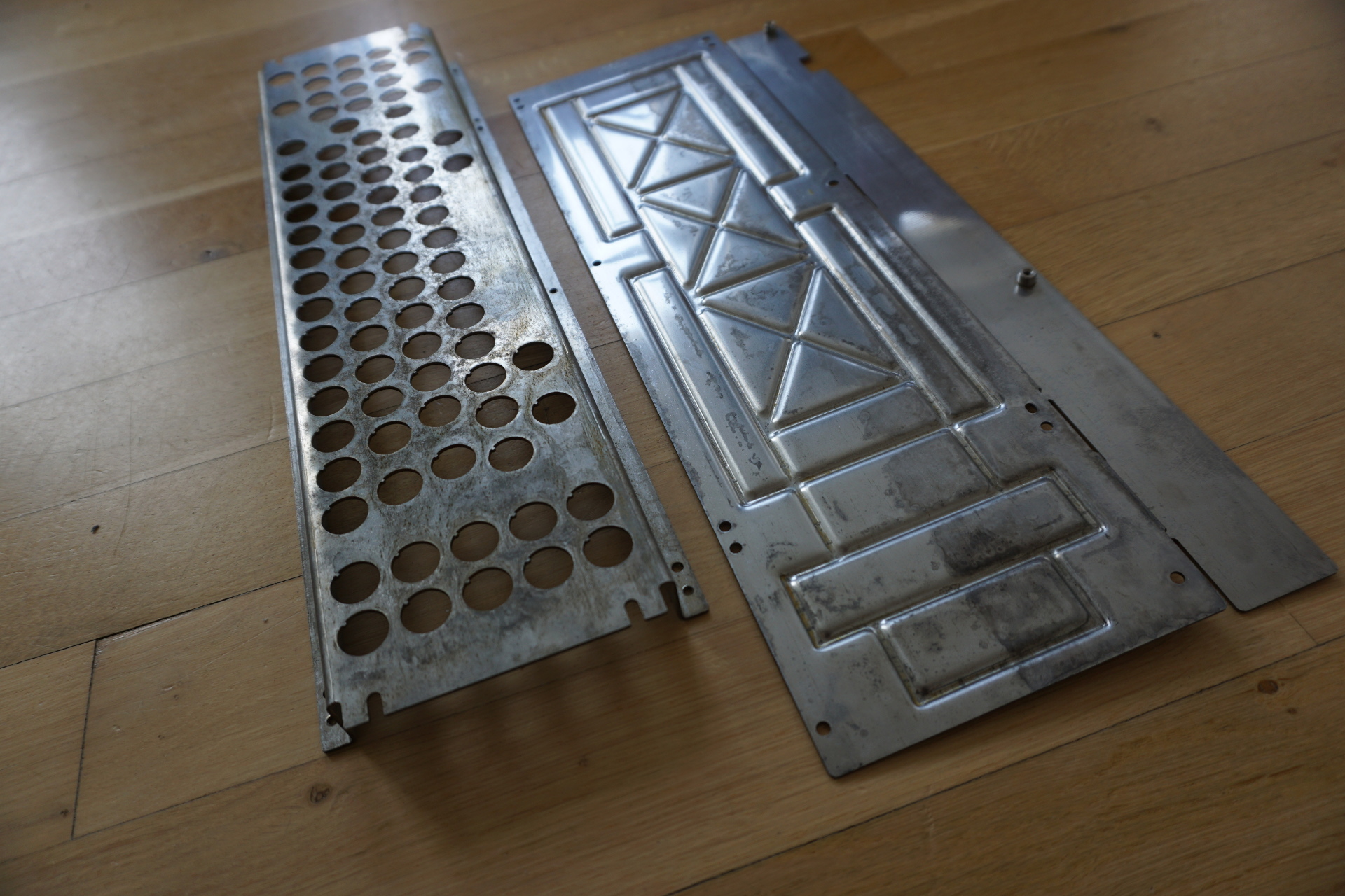

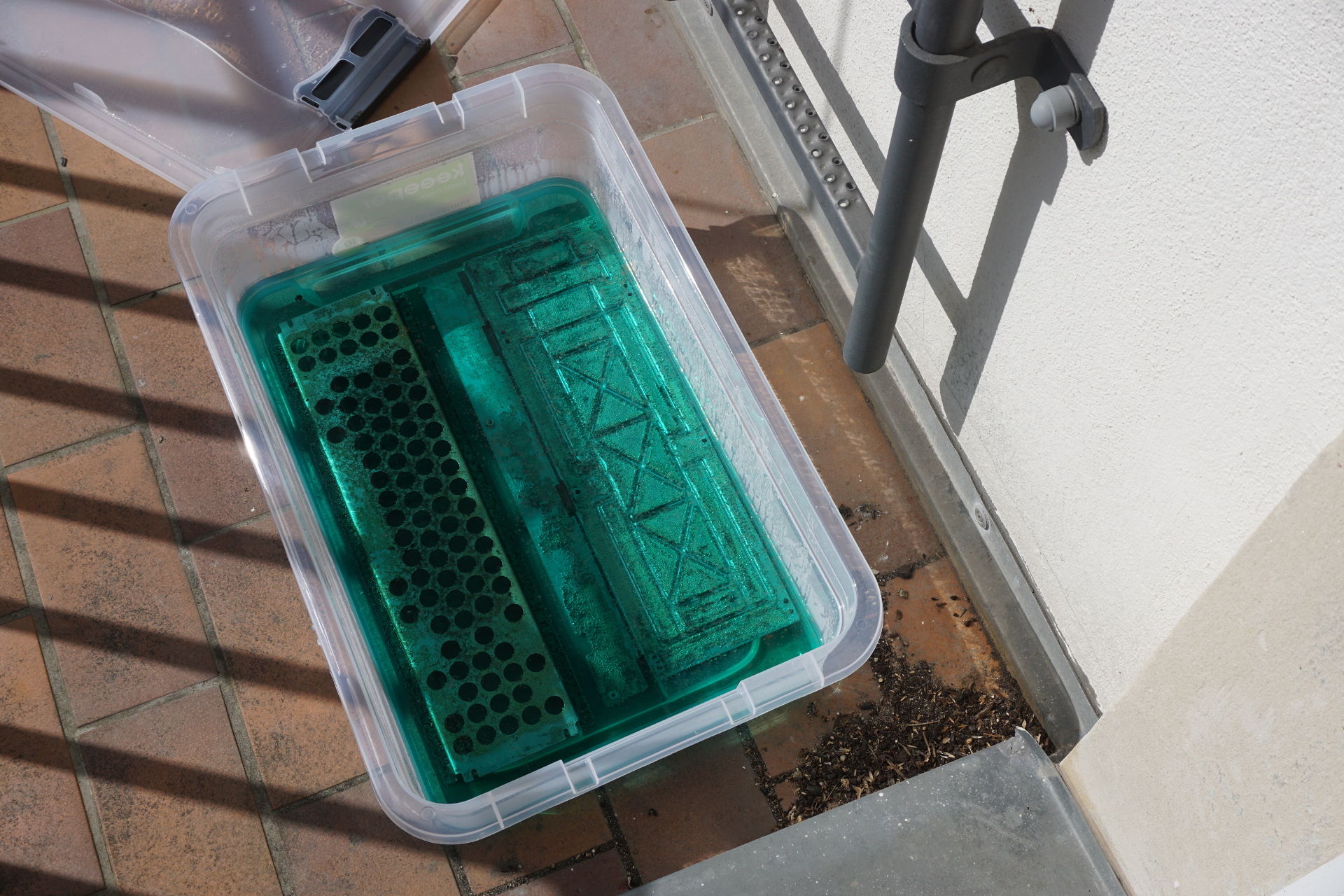

Some progress: Citric acid fighting rust ...
rust remover 1.JPG (1.07 MiB) Viewed 7190 times
rust remover 2.JPG (1.13 MiB) Viewed 7190 times
acid wins :D
plain metal.JPG (725.84 KiB) Viewed 7190 times
added some spray paint ... first time ever doing this. Came out okish, fucked up the upper left corner :/
painted detail.JPG (785.09 KiB) Viewed 7190 times

Actually I'm now pondering to sand down and redo the left edge. Or remove all the paint and start over ...
Wingklip wrote: Where can one gets the acitric acids
I used this: http://www.hammerite.com.au/product/rust-remover-dip/. According to its product sheet it is a "Water solution of citric acid and other ingredients".
ohaimark
Kingpin
09 May 2017, 08:16
Did you sand or scuff the steel before painting? If yes, good. If no, redo.
I would just touch up the corner, frankly. Spray paint isn't durable enough to survive without a few texture and chip issues anyways.
