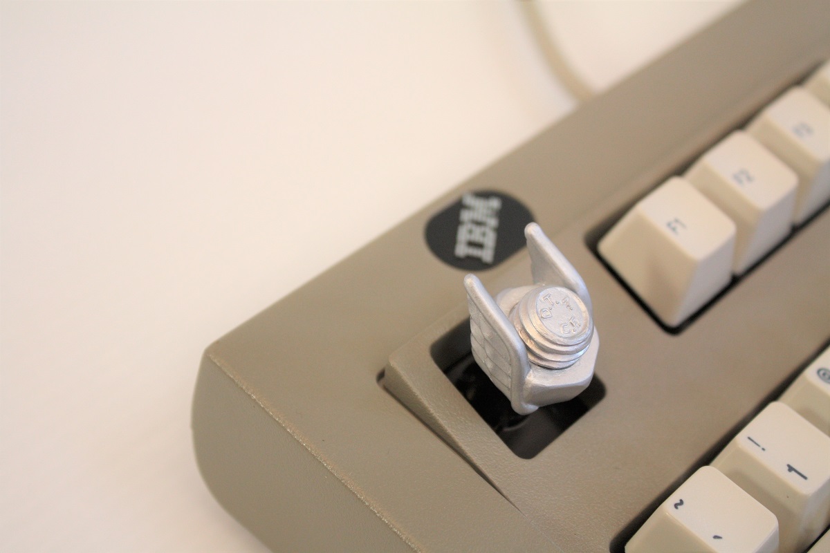

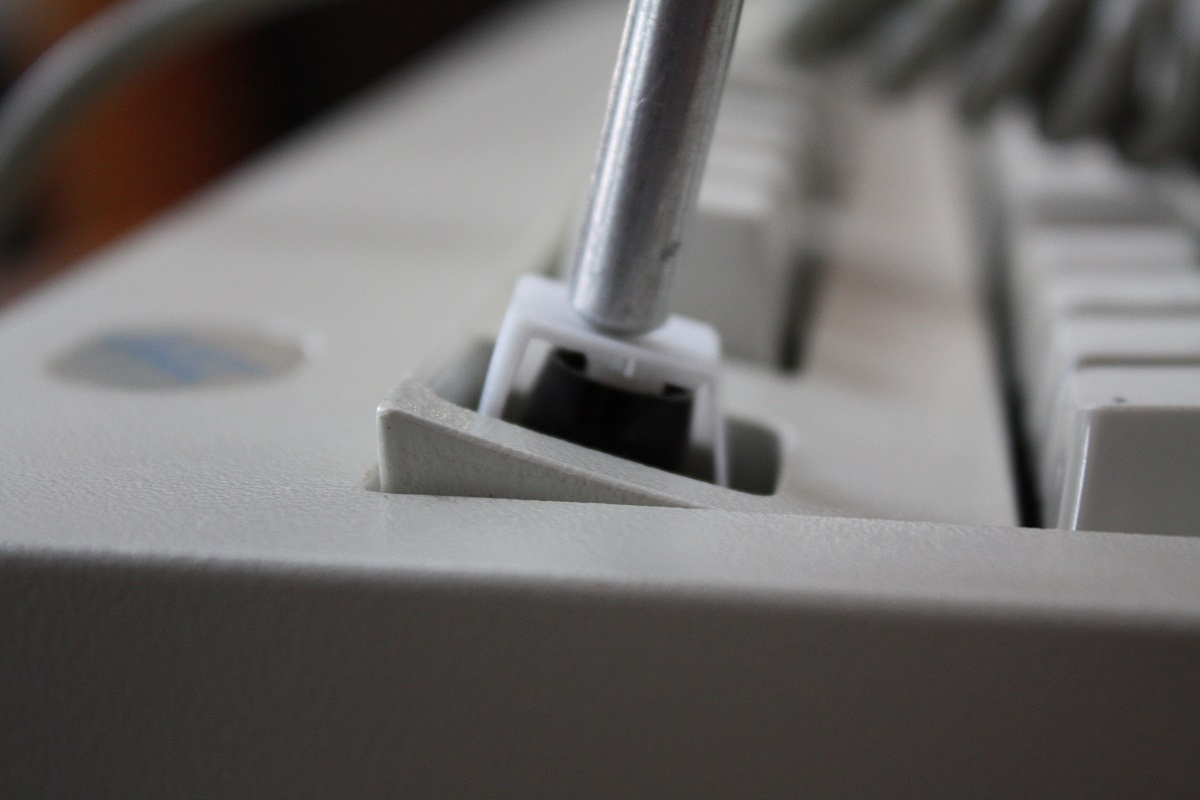

This was the true reason I was playing around with switch adapters. After being bestowed by two honours in January, I had this project in mind but wasn't sure this would work. For the record, I won a DTA6 Wingnut for Best Vintage Keyboard or Cache with an industrial Model M rescue at a Ford plant. The second honour was by our very own Daniel Beardsmore who adorned my personal Wiki page with a Wiki Stars badge.

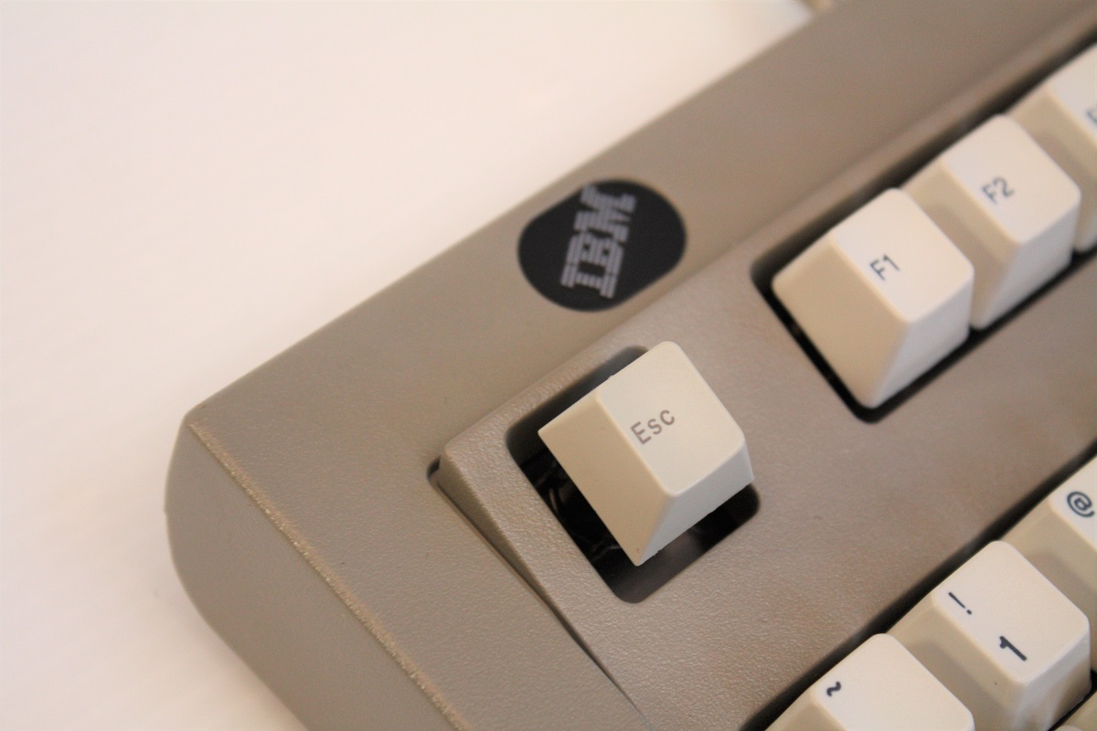

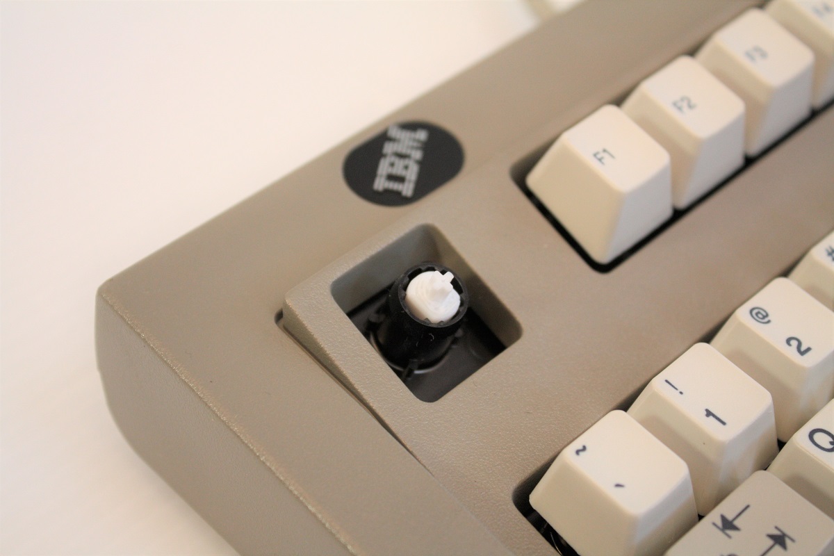

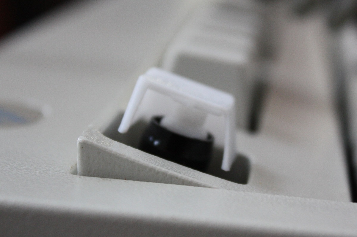

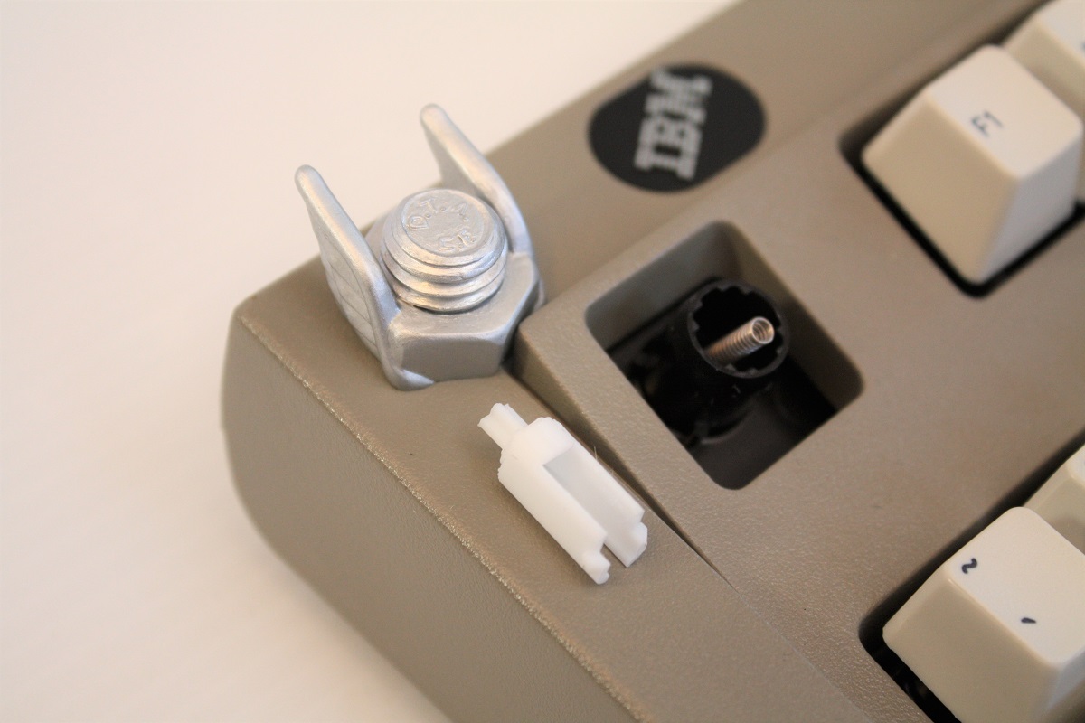

I wanted to have the Wingnut on my best keyboard from the Model M find so I worked on an adapter because the Wingnut has Cherry MX mount. Well, this was the best I can do. Unfortunately, this will NOT work as the key cap is too high and it cannot be lowered anymore. The adapter needs some work to prevent it from spinning (it's a little too narrow) but there is no use as you cannot put Cherry MX key caps on a Model M and make it work. Mind you, the Wingnut is still clicky just like any other Model M key cap :) Of note, the key cap does travel inside the Model M barrel but it's still too tall. You would need shorter springs and that would mess up the Model M completely.
Here are some pics:
Yikes, that doesn't bode well for future MF projects. Is that true of "regular" Cherry type caps as well?
04 Mar 2017, 23:56
Now you see the problem with making discrete buckling spring modules that take Cherry keycaps. IBM sliders (and integrated mount keycaps) have to be the shape they are to keep the height down.
While you could resolve the aesthetics with a longer keycap skirt, it would make more sense to simply make the correct keycaps in first place.
With that said, the mounting shaft inside the keycap is taller than the keystem, so you could put Cherry keycaps onto some grinder or what not and remove some of the mounting shaft so that it sits lower down. Whether the Wingnuts are adaptable in this way, I don't know.

Is it close? Would topping the barrel by a couple of mm make it work? Just asking.

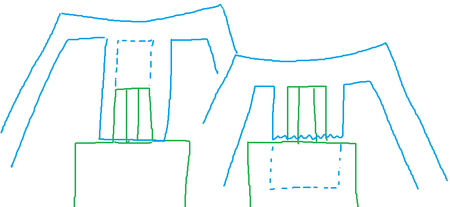

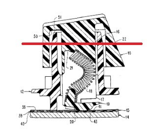

Gringind might work but it will jeopardize the stability of the MX key cap. What I've done is trimmed down the Model M key stem down to the red line and put the MX cruciform on top. Any shorter and I hit the spring pin inside the key stem (what is inside the Model M key cap). It's approximately cut at the red line beyond the normal length. There's not much more room to play. The Model M key cp skirt is pretty long when you look at it and it is very thin on top.
Note that this illustration has the key cap depressed. My picture above is not depressed.

Probably a bad idea for a reason I've not come up with yet …
Bad idea.png (21.99 KiB) Viewed 9091 times
Maybe Cherry M8 keycaps would work better …

The current design is pretty tight as it is. I printed an MX key cap and cut it away so you can see the normal (resting) and depressed state. I do have a millimeter or two to play with so I'll toy around with it a little later today. I don't think the Cherry key cap type matters as the underside key cap stem goes into the Model M barrel as it is.

I would have been happy to share what I have for you to build on Snucci (sure Matt3o would have done the same). PM me with the file format you are using, and I will send over my design. You might need to adjust slightly based on the printer you are using to get the movement right. It took me quite a while to get the design to turn over into actual print dimensions since these are so small (so be warned... there are "tolerance" comments everywhere).
For what it is worth, my distance between the base of the MX mount floor and ceiling of the spring is only .5mm, and you are able to lower the ceiling (I can't remember the dimensions... been a while) and not impact the functionality of the switch in any noticeable way on a stock M spring. Obviously if the spring is shortened and thinned somewhat, the ceiling could be lowered even further. The issue I had on height was more in regardless to the ceiling of the MX mount bottoming out on the BS barrel top that I believe Fohat was mentioning.
There are multiple problems with trying to do this on a complete board if you wanted mixed MX and BS caps. As you say, the skirts are NO where close to the BS ones. On a full board with universal caps, compensations can be made though (future designs). I currently have the wingnut on a modified design that looks really nice, BUT I am using on an F switch where the barrel is unique compared to its brothers (ground down) and the spring is our from our lighter tension experiment. Works quite nicely though... but I don't think you would want to grind down your M barrel since it is an integrated frame.
Moral, I have something that works with an F if you want it, but with an M... I'm not sure you do. As Beardsmore pointed out, we really have to make something unique altogether to get this to actually be desirable if we want MX and BS to like each other.

I tried a couple of other things with this design but gave up for now. I have an issue with the key stem spinning and needed to make it slightly bigger. In any case, I couldn't make it any shorter for this to work with normal MX key caps without a noticeable increase in length.
