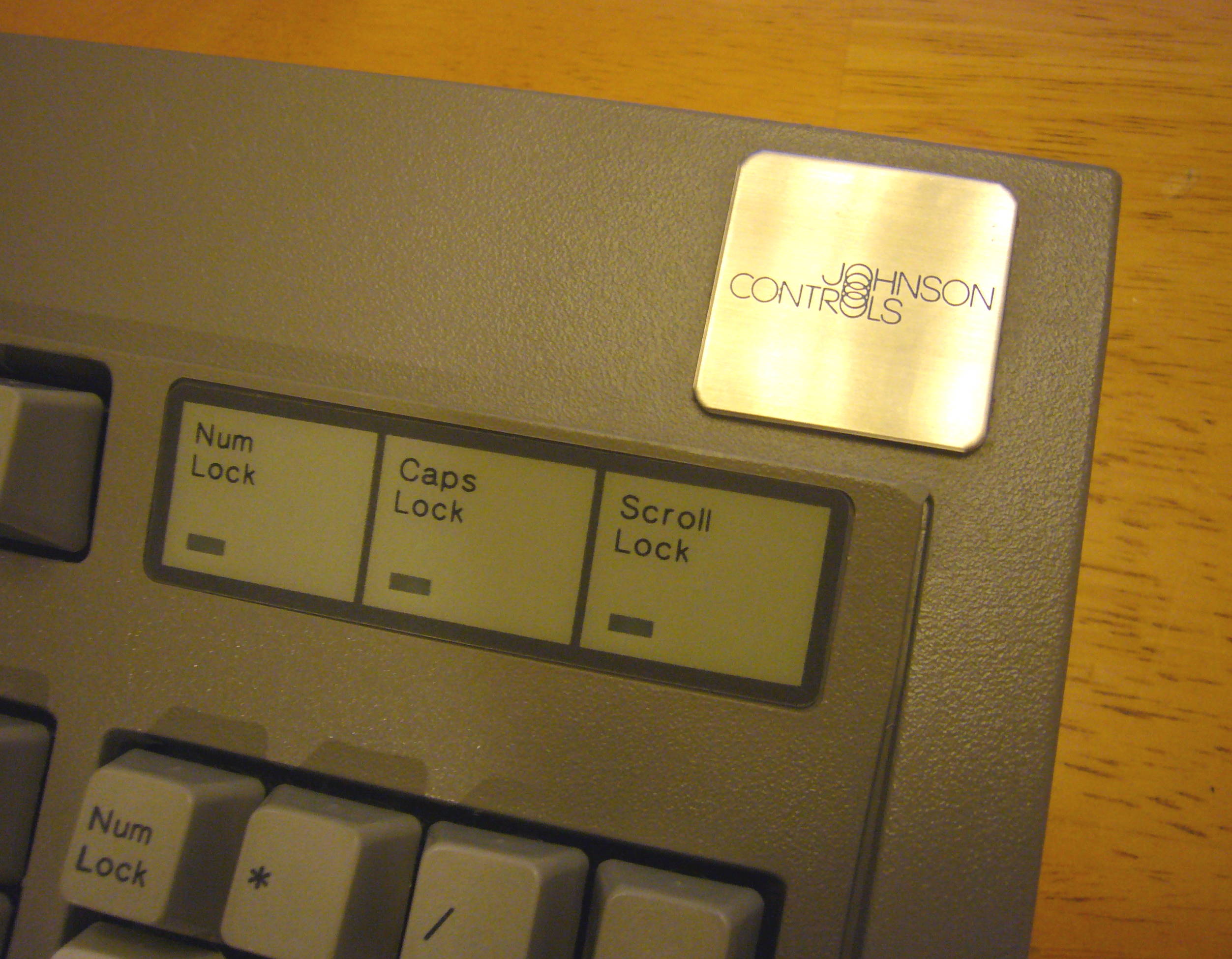

Anyway, guys, the keyboard is exactly like his, just 25 units down the production line at # 05278, with a handsome "Johnson Controls" badge that is bigger, thicker, and shinier than the IBM standard one. There could even be an IBM badge underneath it, for all I know, but I don't want to mess with it.

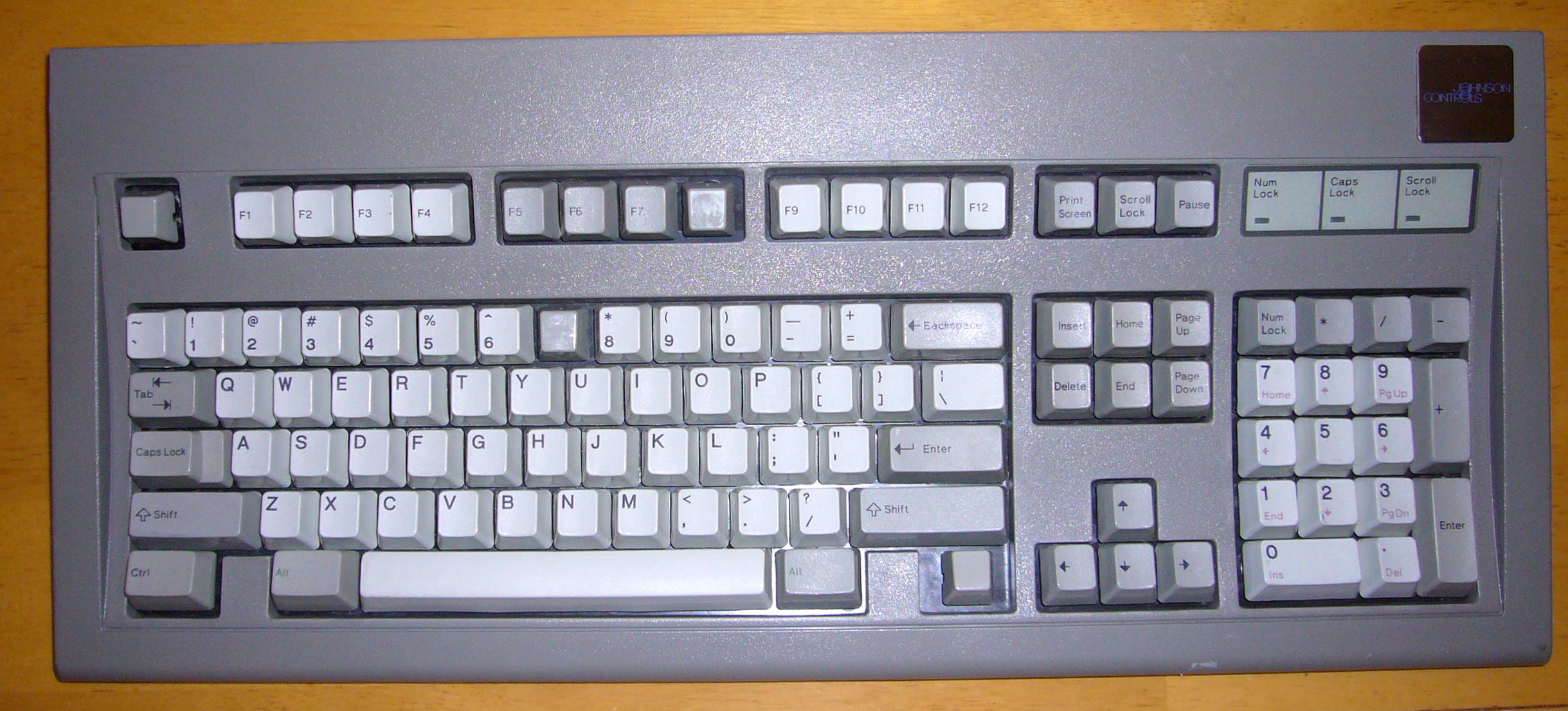

Here are a couple of photos in case any of you guys are interested in this specimen.
Cindy will replace the missing caps, I'm sure.

- 1388032-top.JPG (351.82 KiB) Viewed 1562 times
- 1388032-badge.JPG (428.57 KiB) Viewed 1562 times

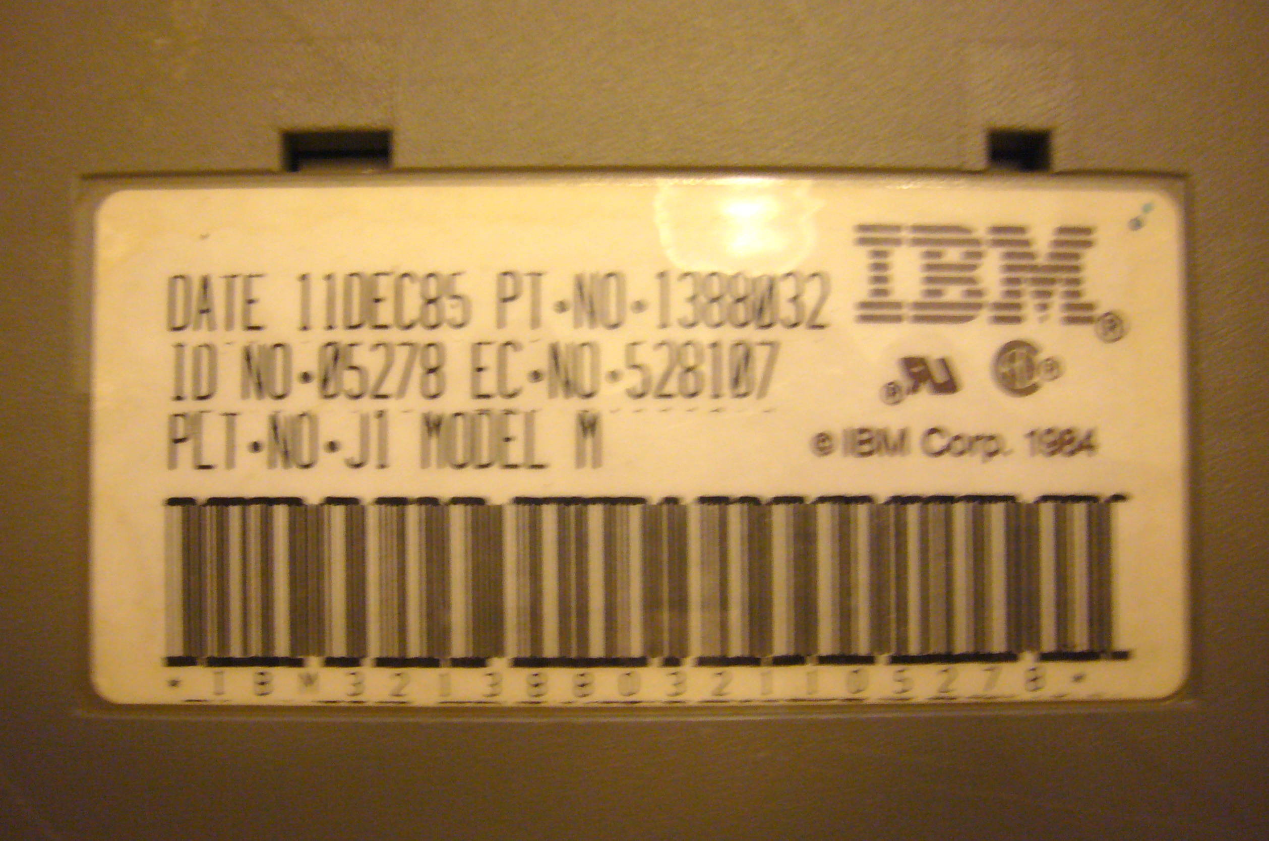

- 1388032-label.JPG (364.28 KiB) Viewed 1562 times

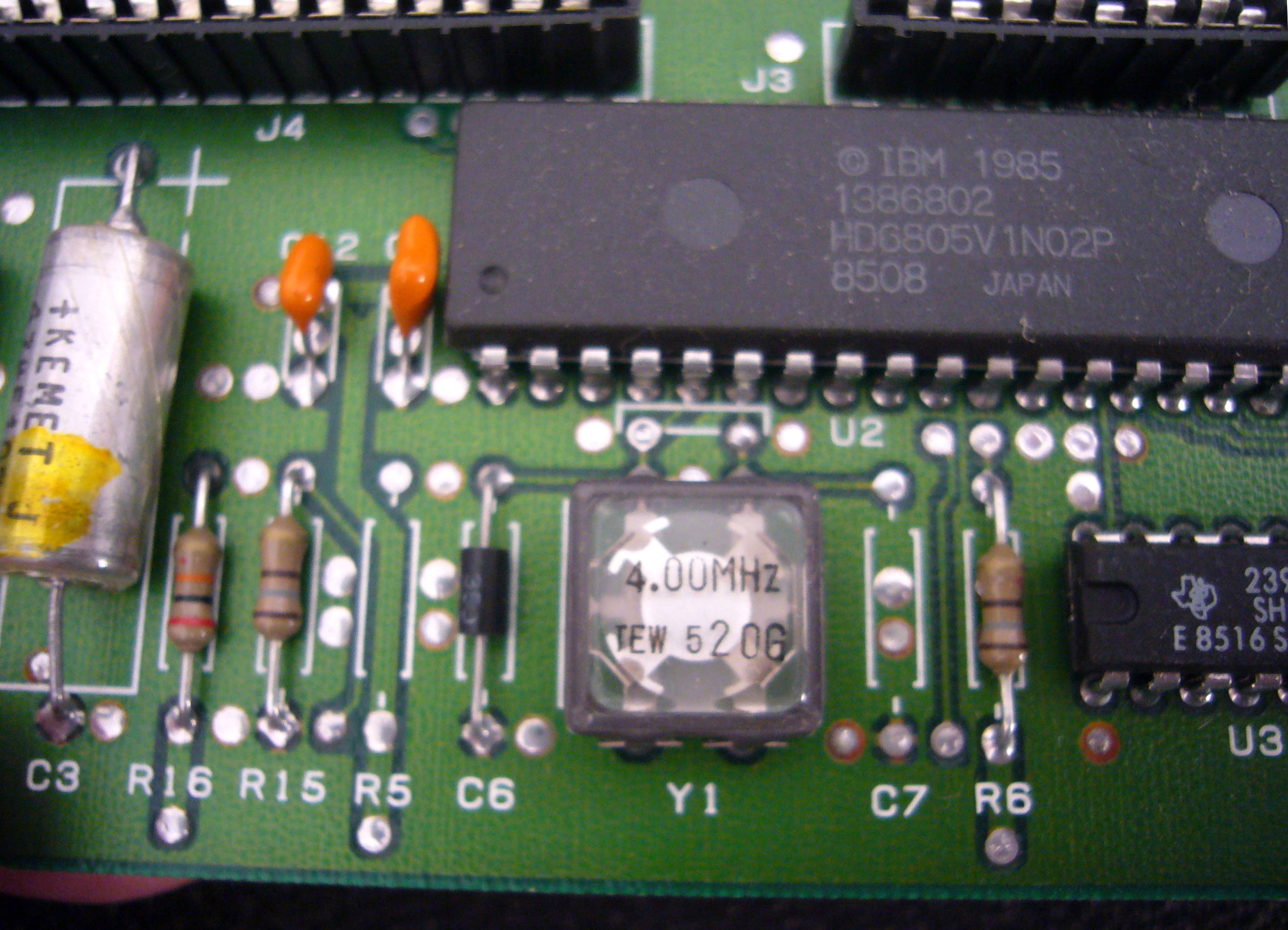

- 1388032-controller.JPG (553.43 KiB) Viewed 1562 times

I realize that this is a very old thread, but since it may help others in the future, I'll relate that I had the same experience with my 8032. It also had the flickering leds and nonresponsive keys.
What worked for me was to just swap the main controller chip from a similar vintage Model M controller. That allowed me to keep everything else original on the keyboard except for that one chip.
Of course you will want to use a proper desoldering setup and ESD protected workspace, but it's not a difficult job.
