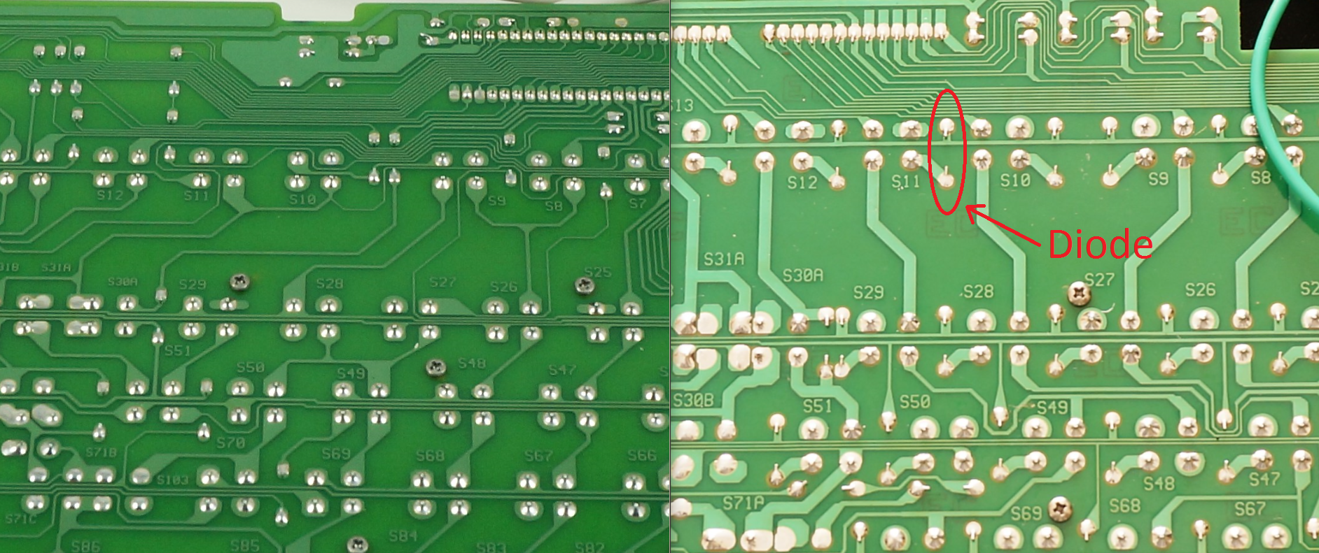

Most of the space invaders boards made in the late 80's are NKRO. So a few later 2nd Gen, all 3rd Gen and the early 4th Gen boards all are fully dioded and support NKRO. The later 4th gen boards like the common RT-8255C+ does not have diodes.
Here is comparison of a 4th Gen boards with (right) and without (left) diodes:

Note that those aren't particularly common models though. NKRO Space Invaders keyboards aren't quite as ubiquitous as them might seem.

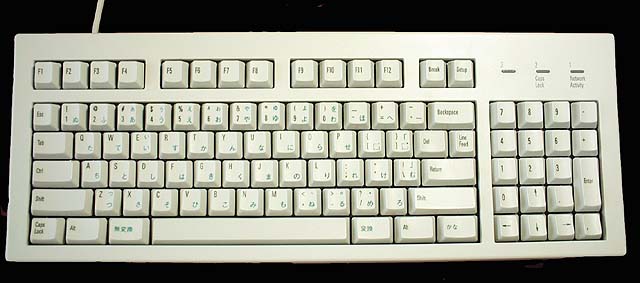

At some point I'll be asking for the Japanese K-97 Kana keyboard with linear space invaders... it's a pretty rare thing by my estimation, so if anyone has it, please keep hold of it for me :)

It's a layout thing. The arrow keys below the numpad and the ctrl key where the caps lock key is, now that's close to a perfect layout for me because you get the benefit of a slightly reduced footprint without losing the numpad or the nav. And being an emacs user, it's handy to have the ctrl in that position. Plus all those kanji / hiragana / katakana symbols make the board look really cool. Unfortunately it sounds a complete pain to source one, I mean, google N-97 kana keyboard and you get Sandy's page and... that's it.
It's even an ANSI layout, which is preferable. Less distance to hit the enter key. Actually looking at it again, it's not an ANSI layout. It has the single-height enter key and the two unit backspace, but the special characters block is extended one unit to the right to fit in 4 extra keys. How bizarre!
