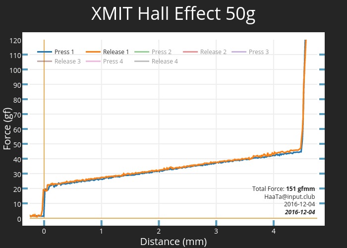

https://plot.ly/~haata/306/xmit-hall-effect-50g/
XMIT Hall Effect 50g

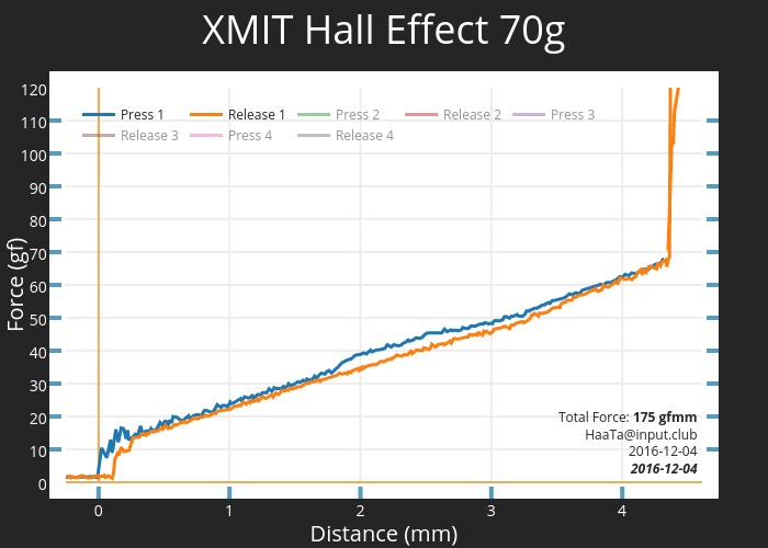

https://plot.ly/~haata/304/xmit-hall-effect-70g/
XMIT Hall Effect 70g
Some fascinating finds here:
* The 50g has 20g of preload and only hits 45g. Very light!
* The 70g has almost no preload and bottoms out at 65g.
* Both force curves have zero or negligible hysteresis since there is no switch action.
Thanks HaaTa!

Thanks! Data like this excites my engineer pleasure centers :) The graph seems to backup the perceived "smoothness". Do you know what the activation point is for these (forgive me if has already be stated).
[ XMIT ]
23 Dec 2016, 23:26
No worries. Activation should be right around 1.8-2.0 mm.

Wow, lighter than I expected. I love the potential smoothness, though. Looks very promising.
Rob27shred
02 Jan 2017, 02:32
Thanks for the info @XMIT! Can't wait to get my bamboo 60% from your GB, especially since I finally got to try out some linear switches & found I do like the heavier variants. The force curve for the 70g springs surprised me a bit as I was thinking they would have a heavier feel but from the chart they look to be comparable to Cherry Blacks, maybe a tiny bit lighter. I think that will end up being a good weighting for me, but I would love to see an even heavier spring available now that I've seen the force curves for the 50g & 70g springs. I think an 85g spring option would be awesome for the heavy handers out there like me.
